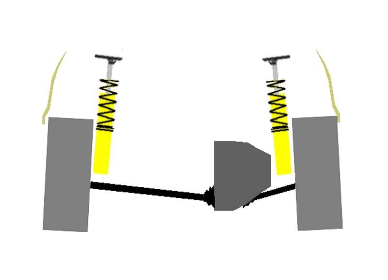

Right this tolerence thing has started to bug me, the fact that I can forsee one side catching and the other being plenty far enough away.
Please excuse the crude drawing, but can anyone point out any accurate points of measurements where I can measure from side to side to see why my tyre-to-wing meeasurements aren't the same.
I can think of obvious points to measure, but they're not 100% accurate as they need to be identical on both sides. They obviously need to start from a solid chassis point as opposed to any moving part, suspension etc...
It doesn't look much on this crabby drawing, but there is a good 15mm, which is far too much for my liking...
http://i136.photobucket.com/albums/q...ure/nc1169.jpg
