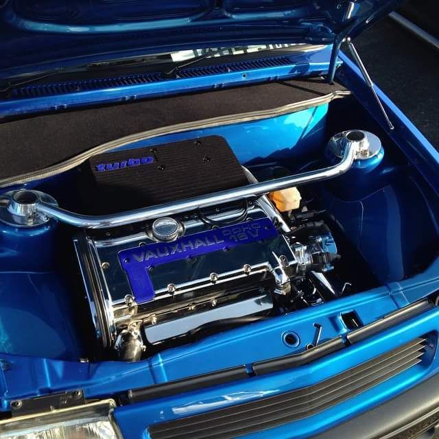

On the way to PVS the car felt a bit off, after queuing in the heat the car was just crap to drive.. Felt like it was missing every so often. Then when i dipped the clutch it would just stall...
Back to work so i got ordering. New cap and arm and new Let plugs, rather than RS turbo plugs.
These seemed to have helped and it idles better now and no missing so far.
When fitting the new cap i added in to P clips. I was never happy that the hall affect sensor wire hung down in the bay.. (crap pic i know)
http://img.photobucket.com/albums/v3...psmvuaorum.jpg
Added a Pclip to the front and bottom bolt to hold it wire in tight and out of the way.
http://img.photobucket.com/albums/v3...psaveh04nn.jpg
http://img.photobucket.com/albums/v3...psayhudqex.jpg
Oh and no the cap isn't staying orange.
