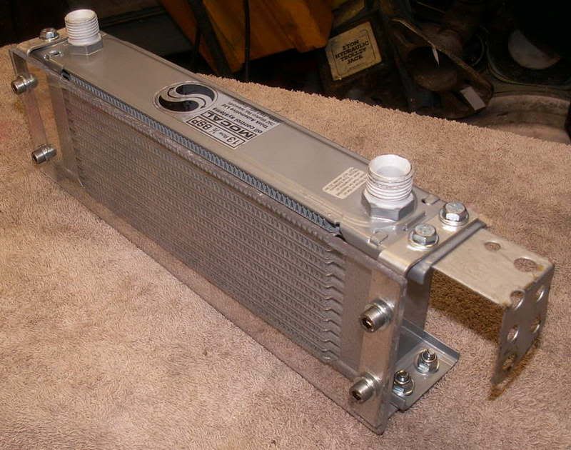

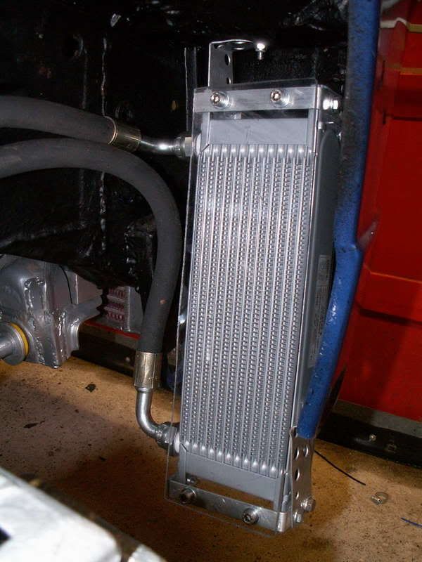

Got a new oil cooler from Rally Design with 1/2" BSP connections, made up a crud catcher to protect it on the rear side from anything thrown up by the wheel as it will be living in the offside wheel arch ....
http://i2.photobucket.com/albums/y15...ilcooler4a.jpg

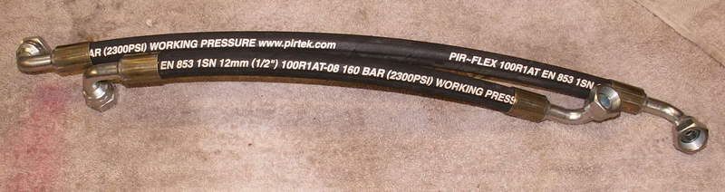

Next job was nip into Hull to Pirtek and get some new pipes sorted . Nice chaps , gave me some good advice - cheers :thumb:
http://i2.photobucket.com/albums/y15...ilcooler3a.jpg

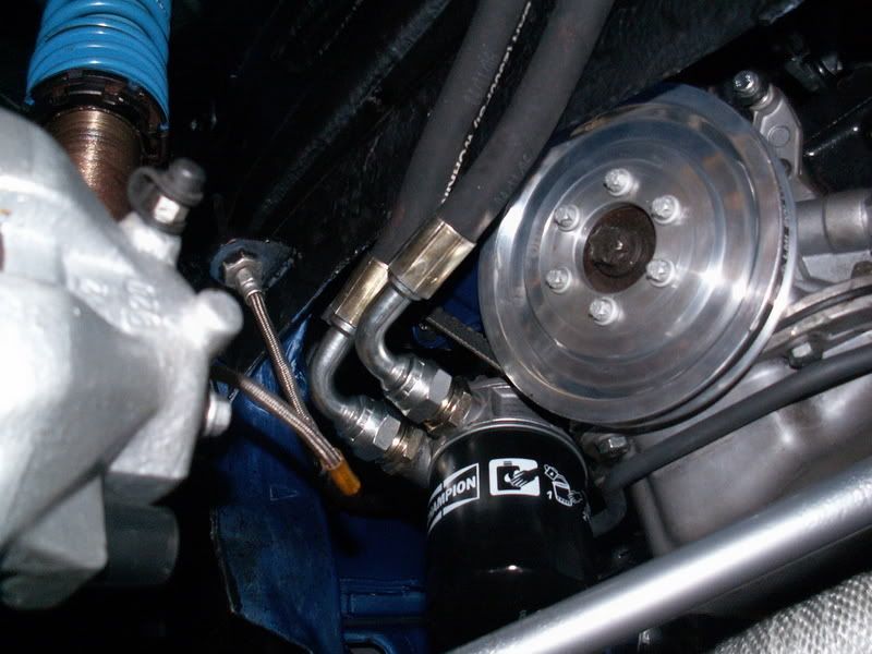

Then came back and get everything mounted up. The pipes were a bit of a pain to get sorted as they don't have much give in them but got there in the end ....
http://i2.photobucket.com/albums/y15...ilcooler1a.jpg
http://i2.photobucket.com/albums/y15...ilcooler2a.jpg

Joff i had my hoses the same as yours and found they would end up fouling the wheel, they had to go almost verticaly from the sandwich plate, and the elbows off the plate need to be heated up to clear the inner arch, but that was on 45mm off set
joff can u please post some pics up of your tie bars where you've lowered them, the bit im interested in is how youve raise the horizontal bolt on the front, looks quite beefy lol, you can just see it in this picture here:

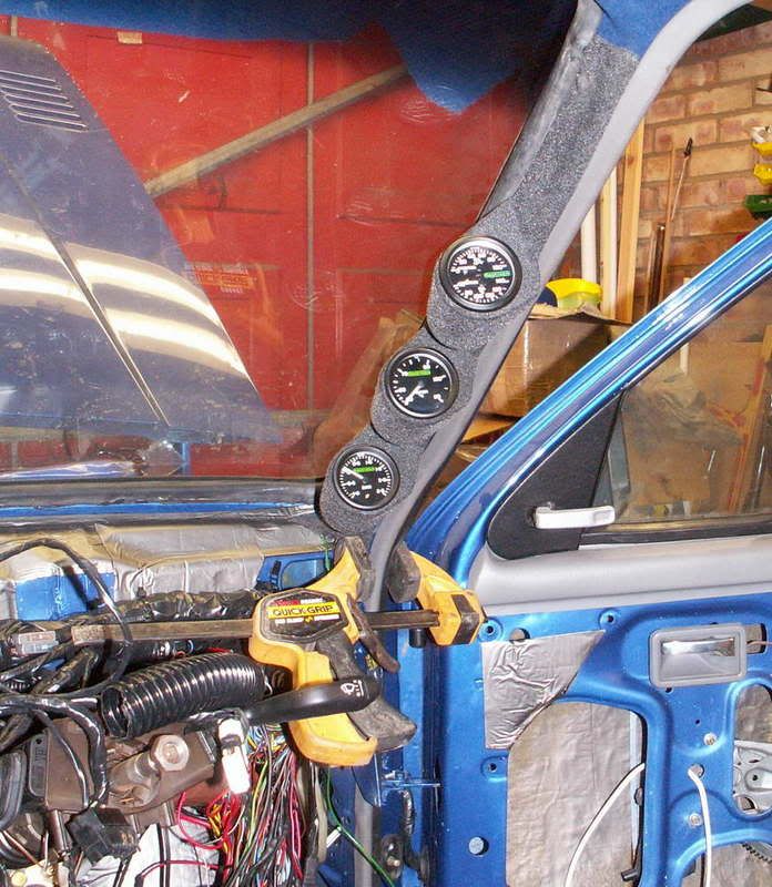

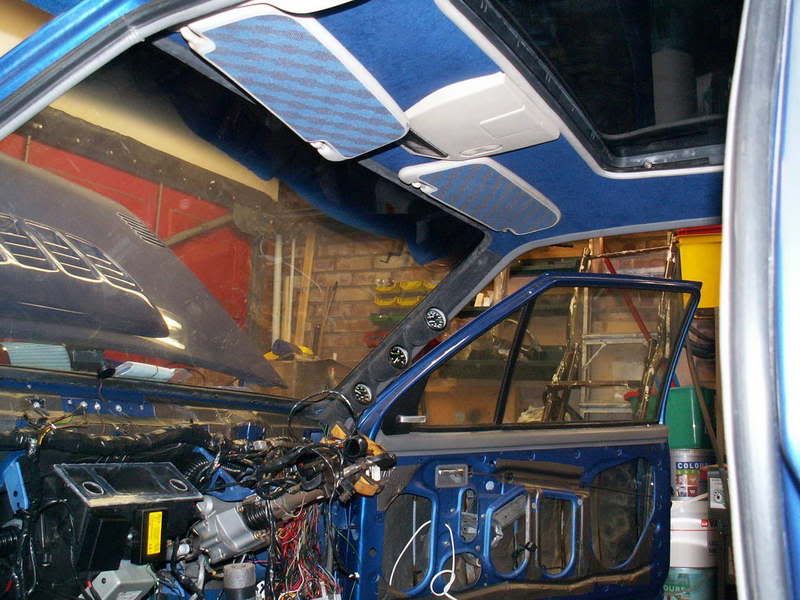

Right , with the help of Racetech I now have my gauges sorted, put into the pods and nearly plumbed in .....
http://i2.photobucket.com/albums/y15...nova/pod1a.jpg
Once some glue holding the bottom of the pods has gone off we are ready with the dash installation - all the piping for the screen vents and side vents is now sorted and the wiring sorted for the EPAS system.
http://i2.photobucket.com/albums/y15...nova/pod2a.jpg
This pic reminds me that I need the sun visors retrimming when I get the door cards sorted.
