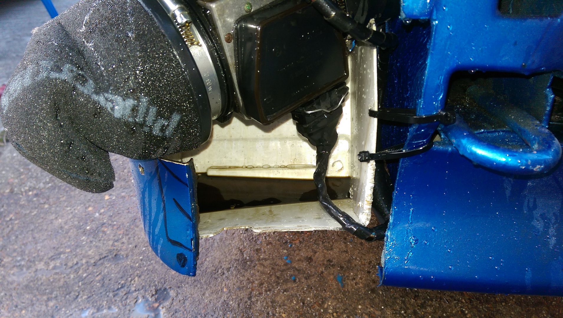

Found oil was dripping from the bumper so took it off and found two thing.
1, my air filter has been quite badly squashed by the bumper.
B, my air "box" is good at collecting oil...
http://img.photobucket.com/albums/v3...psaeshzi3j.jpg
http://img.photobucket.com/albums/v3...psxym0nf2g.jpg
Removed it and its been fully cleaned.
Arched were then dried as best i could and re waxed and sealed, then look better now as they needed a good clean anyway.

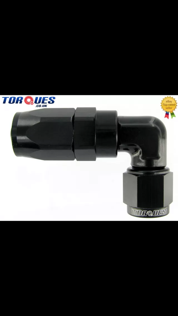

Looking at your cooler take offs mate, the radius of the 90 is quite big, your route is similar to mine but i dive left across the car to my cooler where you go right.
http://i27.photobucket.com/albums/c1...D076F5B1D1.png
These would keep the hose tighter to the engine, you could then double clip it to the inderside of the chassis leg on the engine bay side of the lip so they're protected from the tyre?? Can use them with rubber hose similar in coiloir and style to what you have now (from the pics)
You should avoid using forged fittings on oil. Swept every time.
