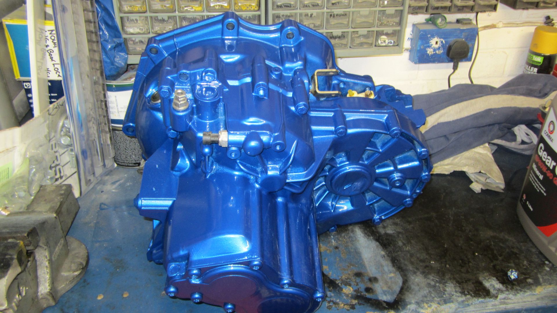

Gear box looks like this... Pretty enough.
http://img.photobucket.com/albums/v3...psayttfgz1.jpg
De masked, new drive shaft seals fitted Chrome clutch arm fitted.
http://img.photobucket.com/albums/v3...psttlsjs51.jpg

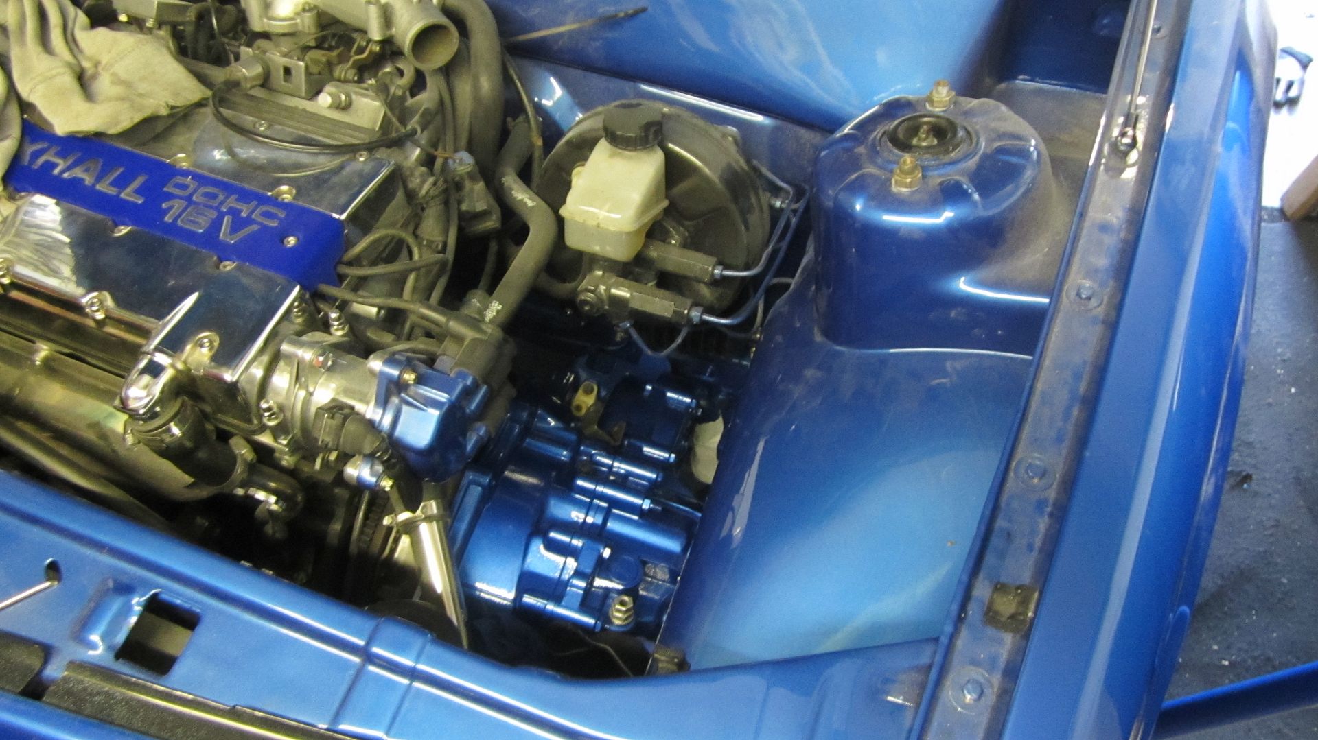

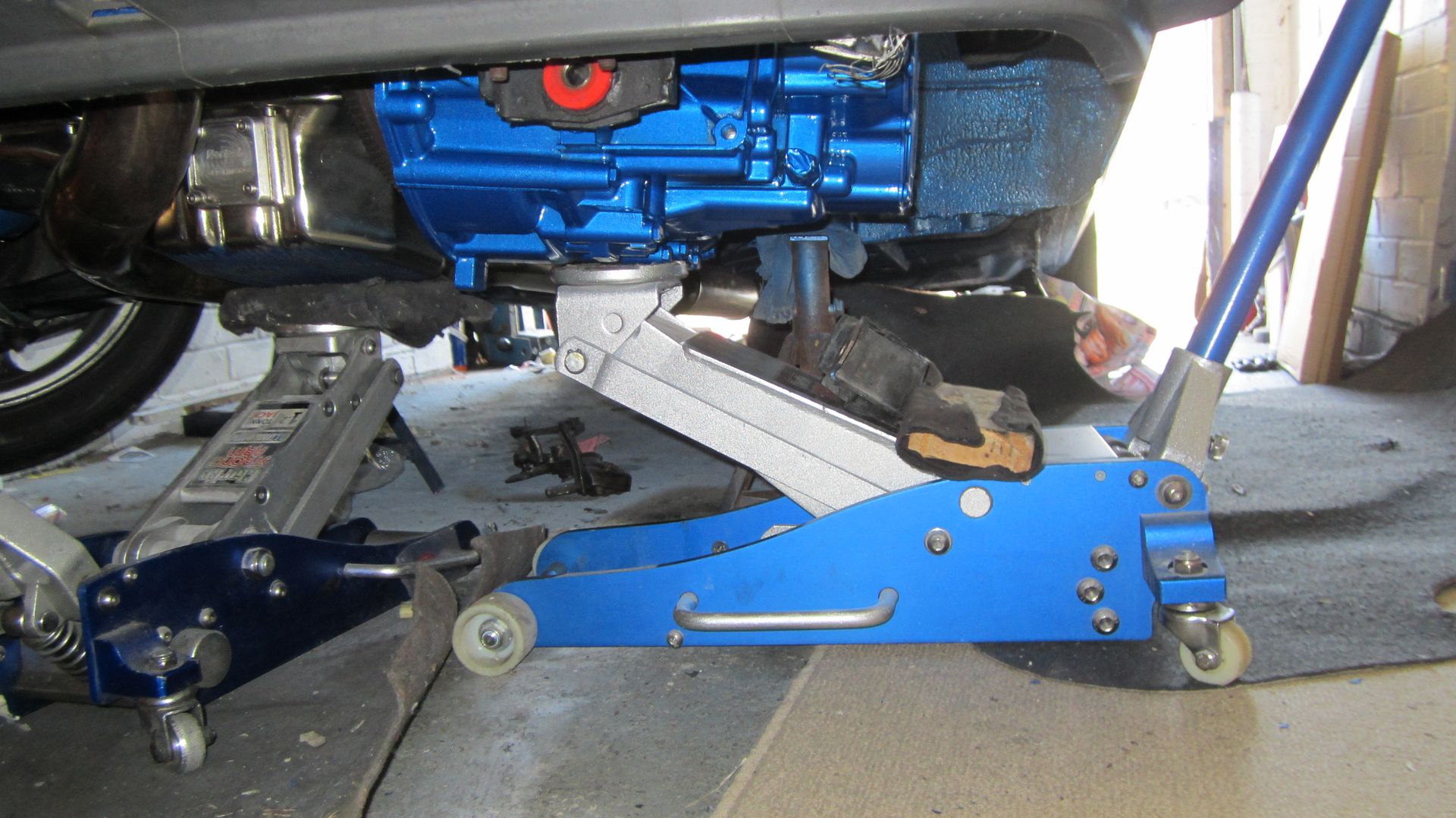

With a jack under the engine i lower it to kinda point the engine down to make fitting easier i hoped. Gear box on other jack..
http://img.photobucket.com/albums/v3...psfouubwkp.jpg
This is where i needed two hands, top and bottom to shuffle the box in to place...
http://img.photobucket.com/albums/v3...psevfti8cp.jpg
As i got to this point, Dan and Petor turned up...
The box almost fell in to place, like amazingly easy.. Just pushed on and bolted up. Dan said we should buy a lotto ticket as we must of had good luck that day.....

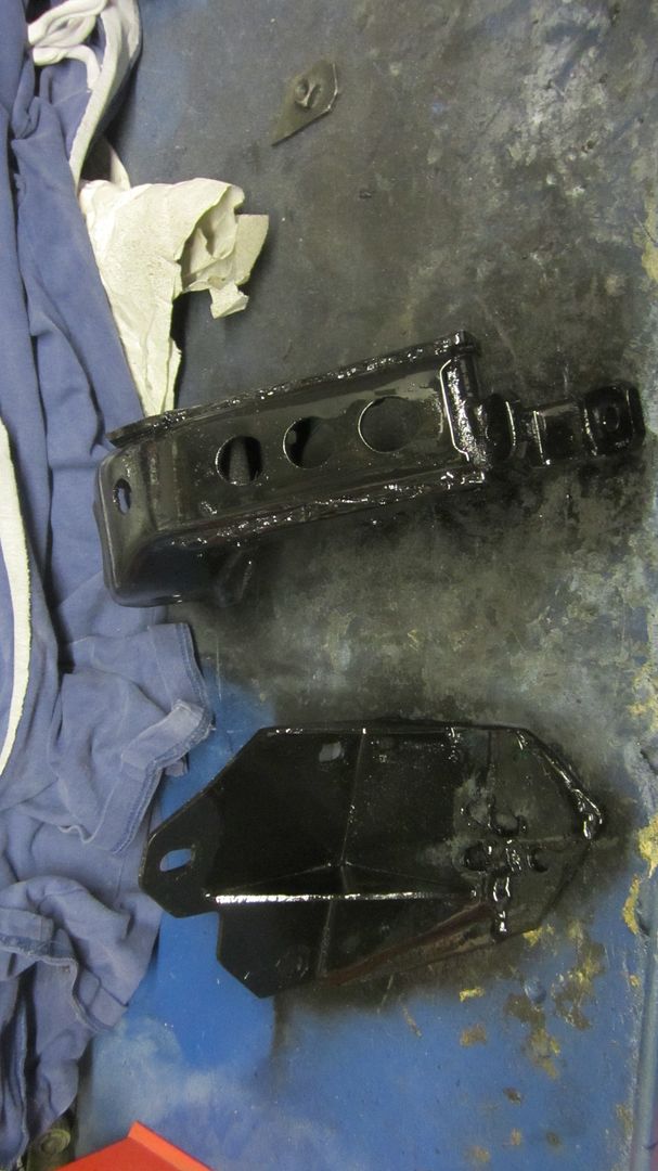

I had bought a new rubber bit as mine was knackered and painted the metal mount bit..
http://img.photobucket.com/albums/v3...psyg9sdk5c.jpg
Bolt the mount to the box... Then it was miles off the floor holes... Fit it to the floor and its miles off the box... Over an hour later of pushing, pulling, giggling, swearing, adjusting it was finally bolted up.

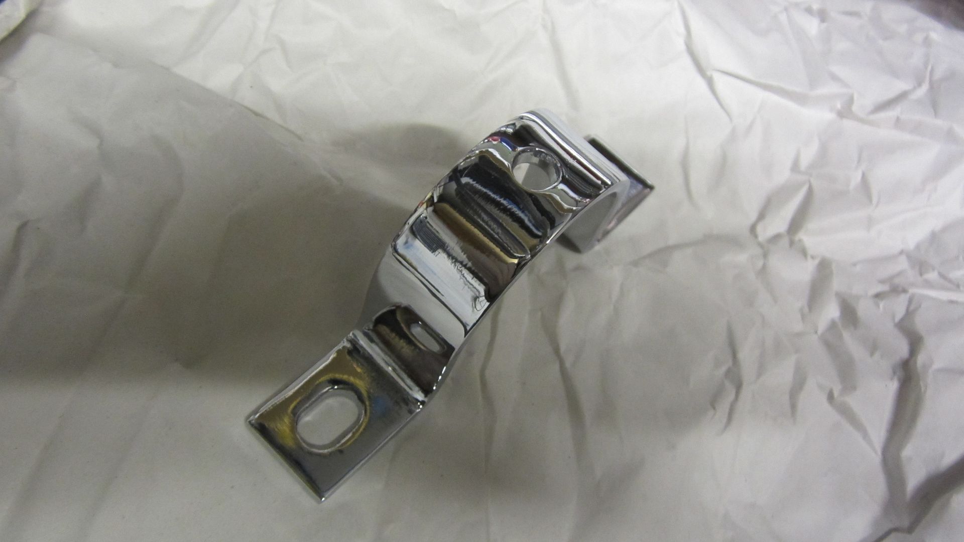

Chromed Clutch bracket back in, and cable on.

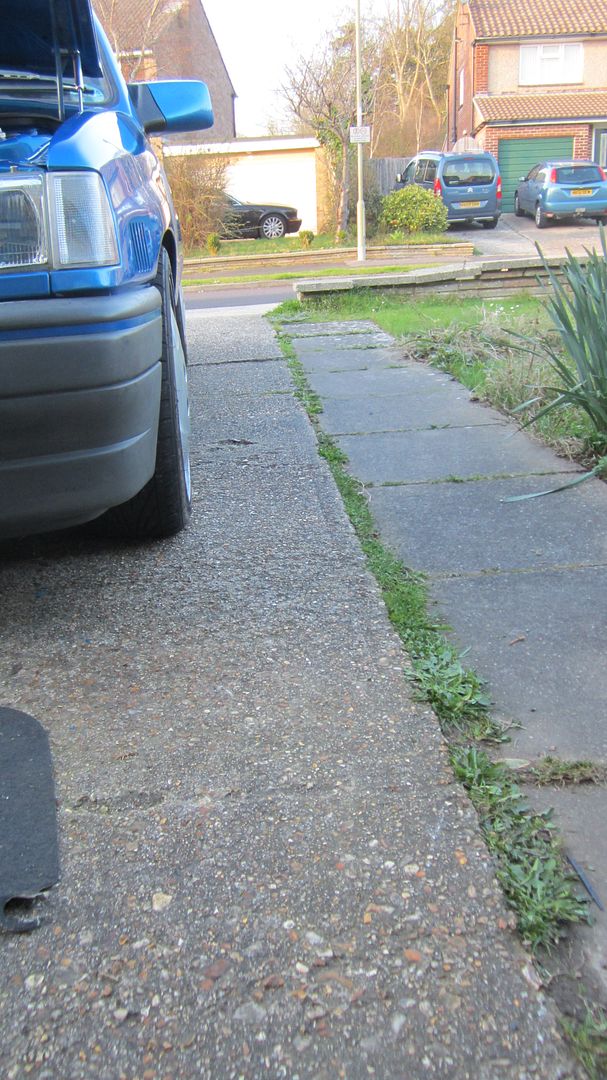

Turn using momentum, Where i have just driven is in a deep dip... Coast down. Have to push up other side... not easy. People on my road park like **** holes. (back ground info, all house have big drives, but people still park on the road, but people will only park outside their houses, no matter what the other cars are parked like.
Even a nova is hard to push up a steep hill. Nice man i think from next door helps.. As i notice i've left a line of oil all the way down the road....
