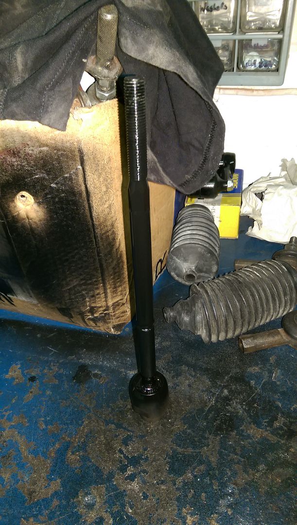

I wanted to renew everything on the rack before refitting it. Finding steering arms in a good make was looking tricky. ( i like these Moog ones are they are a good make, well made, the ends are thicker than most with a more enclosed ball joint cover) Then i found one... Few months late a 2nd. Had a plan of getting them chromed... Took them to the chromed, open the boxes and find i've got two different. Looks like some greasy mech has had two boxes open and then put the wrong arm back in the wrong box... Queue the search for another.
Finally find one. Not i dont really have time to get them chromed :( as my chromer is very busy and i wanna get cracking.
They come in black, but the finish isnt great so...
Flatted back..
http://img.photobucket.com/albums/v3...pshoohrmdo.jpg
This is where i find one arm has been lost... Either here or while at work.. GGrr so start searching again. No one has anything.
Painted the arm i did have. Much better finish.
http://img.photobucket.com/albums/v3...psifhe8l5u.jpg
In the mean time i stripped a arm from my old rack.. Sanded and painted that too.
But i wasn't happy with fitting all new and one old arm... OCD/just wanted all new. Luckly the one i've ordered about 6 times has finally come in! Yay!
http://img.photobucket.com/albums/v3...psayudfhl8.jpg
Got them home, sanded and painted...
http://img.photobucket.com/albums/v3...psqktqvfsc.jpg
Rod ends where the same, in a lose light coat of paint.. Couldn't have that.
Sanded back..
http://img.photobucket.com/albums/v3...psvnask5ym.jpg
http://img.photobucket.com/albums/v3...psu9iu8ixo.jpg
Painted. Look better i think.
http://img.photobucket.com/albums/v3...ps7msrt6x0.jpg
http://img.photobucket.com/albums/v3...psxd2pcsqn.jpg
So now i can build my rack up and get that fitted all in.
