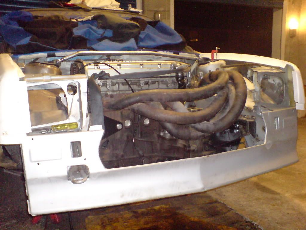

if you were to lower the engine you could always copy my manifold to help with the problem?
Is yours the 'up and over the gearbox' jobbie?
That'd help me significantly reduce the bayboy, wouldn't it lol
4inches anyone lol
yea it is, and you still have loads of room behind the engine, and because it came of a btcc car its perfect flow
Pics of your badboy ? lol
I shouldn't go down this route, it sounds expensive dagnabbit, you guys are fecking bad influences! :mad:
yea ill get a pic just have to find one on pb. but it wouldnt be expensive as you would have one to copy. then you could sell the manifold you got now
If you need better pics just ask
http://i241.photobucket.com/albums/f...newnova012.jpg
http://i241.photobucket.com/albums/f...newnova014.jpg
http://i241.photobucket.com/albums/f...newnova008.jpg
