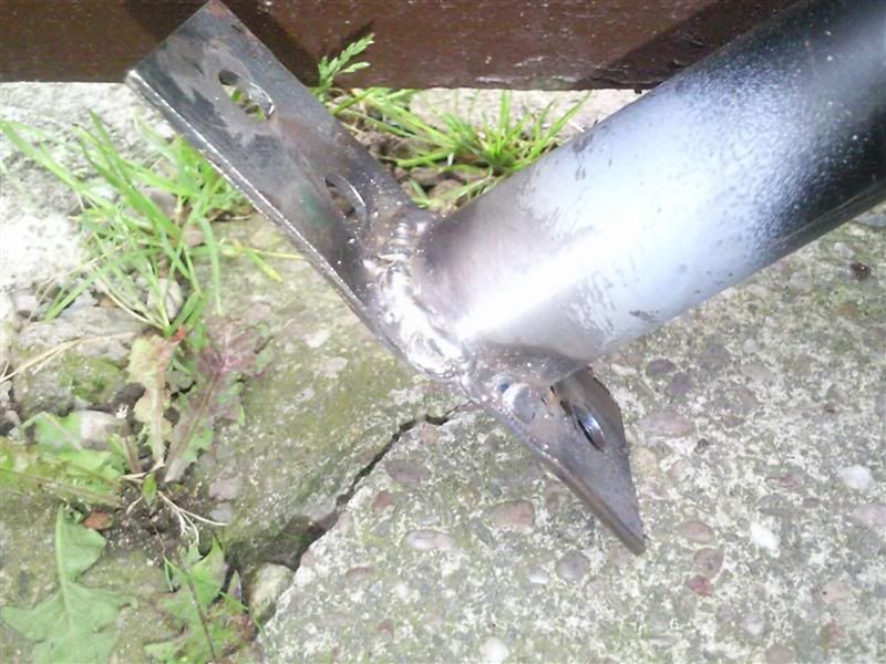

Managed get about an hour spare tonight, so got the A-pillar bars feet welded back on.
My 90A welder really struggled, on full power setting wasnt getting much penetration, leaving weld just sitting on top of the tube. But started moving the torch much slower, which gave a better weld, not amazing but should do the job :)
http://img.photobucket.com/albums/v8...P/Photo062.jpg
http://img.photobucket.com/albums/v8...P/Photo061.jpg
Tother bar
http://img.photobucket.com/albums/v8...P/Photo063.jpg
http://img.photobucket.com/albums/v8...P/Photo064.jpg

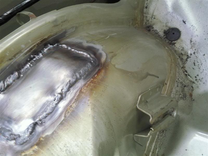

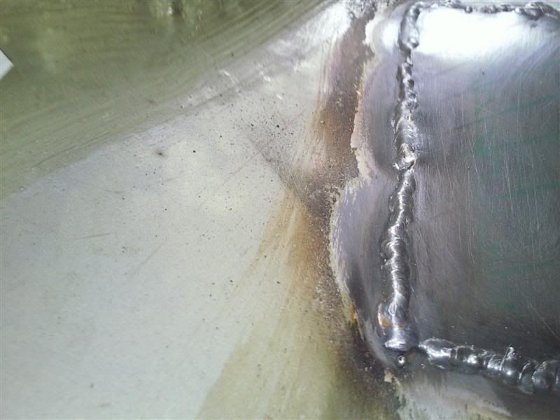

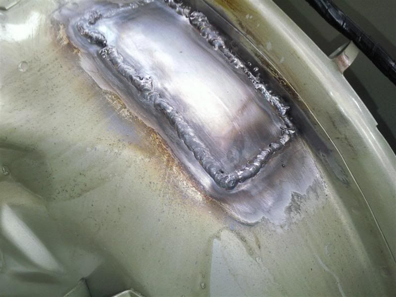

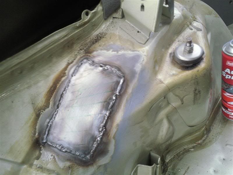

Had an hour after work today, got the rear spreader plates cut to size and welded in. Made quite a good job of the welding, set fire to the wheelarch underseal several times lol
Could only weld a 2inch seam before thermal cut out came on :roll:
But it came out pretty well :d
Drivers side
http://img.photobucket.com/albums/v8...P/Photo065.jpg
http://img.photobucket.com/albums/v8...P/Photo066.jpg
Pass side
http://img.photobucket.com/albums/v8...P/Photo067.jpg
http://img.photobucket.com/albums/v8...P/Photo068.jpg
And because of where it is on the car(wheelarch), the weld may have put tiny holes in the metal etc(dont want rain water getting in there), so i decided seam seal it to be on the safe side. You wont see it anyway as i'll be refitting arch carpets...
http://img.photobucket.com/albums/v8...P/Photo069.jpg
Just need get the holes drilled for the bolts.

I would just weld it on the underside of the car? Thats what im doing on mine, doing the rear plates inside the arch too. Cant see why it would cause a problem, its still strengthening the mounting points
Got the front spreaders welded in today. Ended up welding them on the inside of the car/floor, just about managed to get the cage back in position, the legs are wedged solid against the dashboard lol
And then drilled the bolt holes for the front and rear cage feet :)
