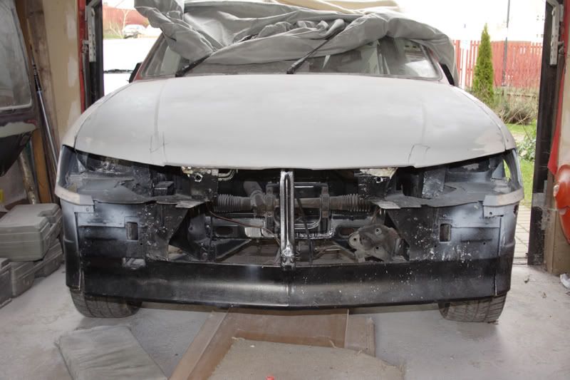

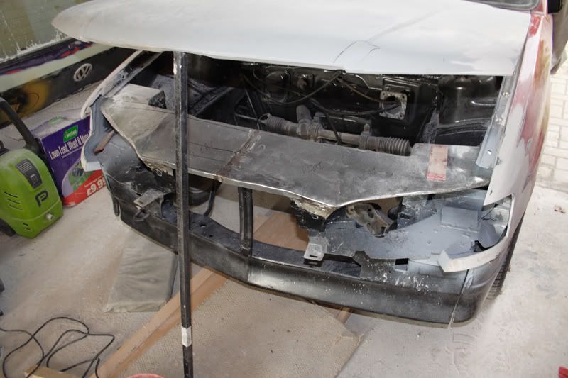

Started by finishing off welding the additional panel I'd made to the top of the slam panel. Went round all the edges and then ground back the excess. Now both panels are joined they give the top front section a pretty smooth finish. It still needs some work - more tidying up than anything else but it looks much better than the other rivitted bits and it adds more strength to the whole front section...(at this point I curse myself for not learning to weld when I did the rivetted sections!)
(before it was fully cleaned up -front looks a tad uneven)

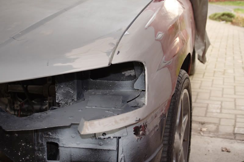

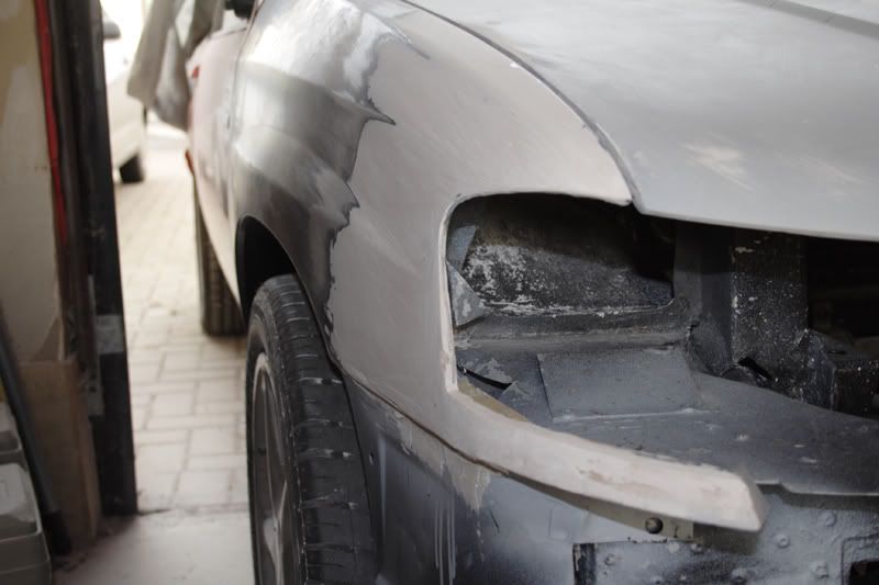

I then started cleaning up the wing extensions. I needed to sand back the 1st layer of filler I'd applied earlier in the week to get the basic shape then build it up further so it was flush with the original wing, following the new curve at the front. Here's a wip...
http://img.photobucket.com/albums/v1...ingfil0002.jpg
http://img.photobucket.com/albums/v1...ingfil0009.jpg
http://img.photobucket.com/albums/v1...ingfil0007.jpg
As you can see from the last pic the top curve doesnt match the bonnet curve and between the lights and the bottom of the curve theres a small gap. It's only about 4mm so nothing a bit of filler wont sort out easily enough.

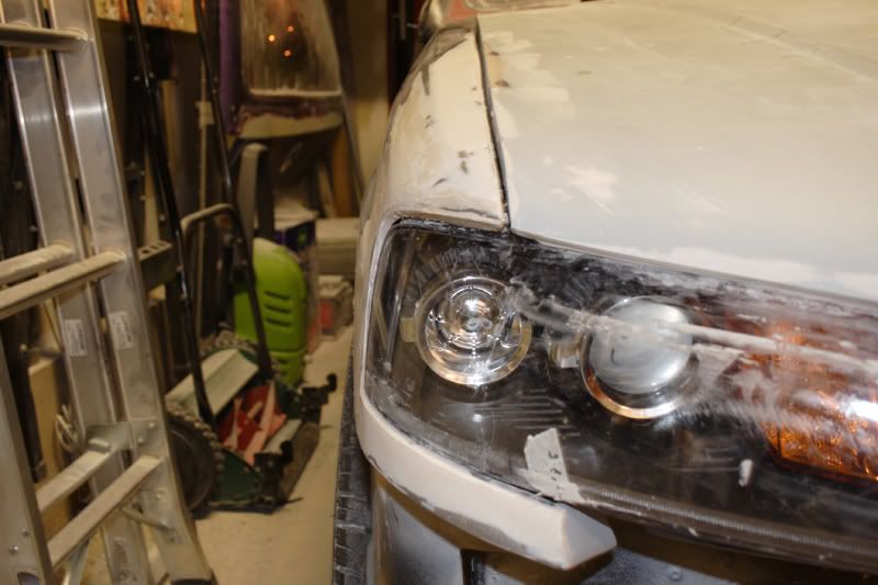

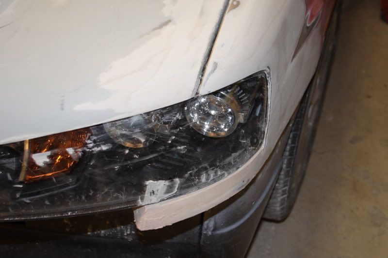

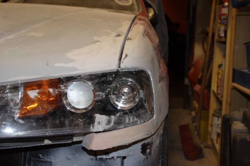

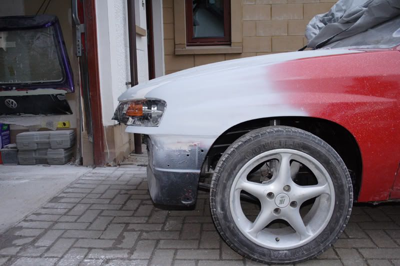

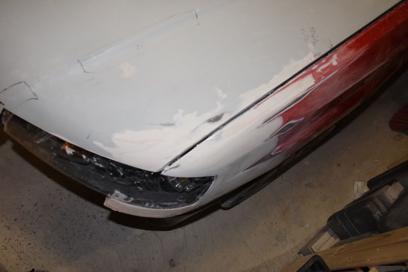

Next stage was to refit the lights and then skim the edges of the lights to where they wings butt up to them. I also skimmed the top curve to match the underside of the bonnet. Just before the filler totally cures I trimmed about a 5mm gap round the edges (except for the top) - this sounds like a lot but allows for light unit adjustments. The actual additional material once the gap had been removed was minimal which I'm pleased about as it means 95% of the extension is metal! Once set I then removed the wings and tidied up the inside edges, smoothing the excess filler back and blending it into the wing from the inside. this will be totally sealed with underseal once finally painted for added protection.

http://img.photobucket.com/albums/v1...ingfil0022.jpg
http://img.photobucket.com/albums/v1...ingfil0020.jpg
http://img.photobucket.com/albums/v1...ingfil0019.jpg

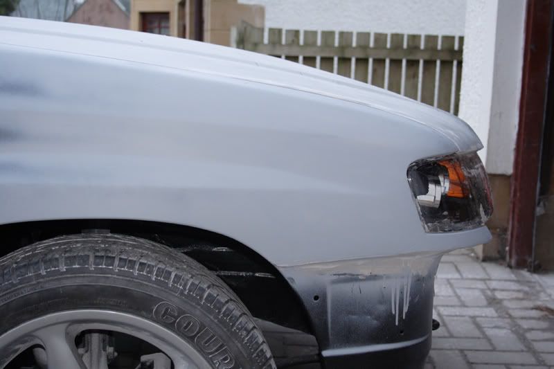

Didnt have too long in the garage today as the wife wanted me to photograph her jumping her horse! Spent most of the morning cleaning up the wing extensions I'd skimmed the night before.

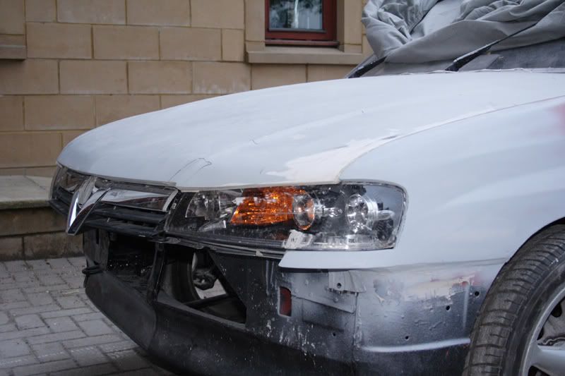

After much sanding I gave them a quick coat of primer to get a look at how they were coming along.
http://img.photobucket.com/albums/v1...ingfil0031.jpg
http://img.photobucket.com/albums/v1...ingfil0027.jpg
http://img.photobucket.com/albums/v1...ingfil0032.jpg
http://img.photobucket.com/albums/v1...ingfil0033.jpg
http://img.photobucket.com/albums/v1...ingfil0034.jpg
The next task is to tidy up the lines. I need to extend the classic nova arch bit that sticks out on the wings as well as the line that runs the length of the car. The last bit is to make a straight line that the bumper will butt up against at the bottom of the wing...
