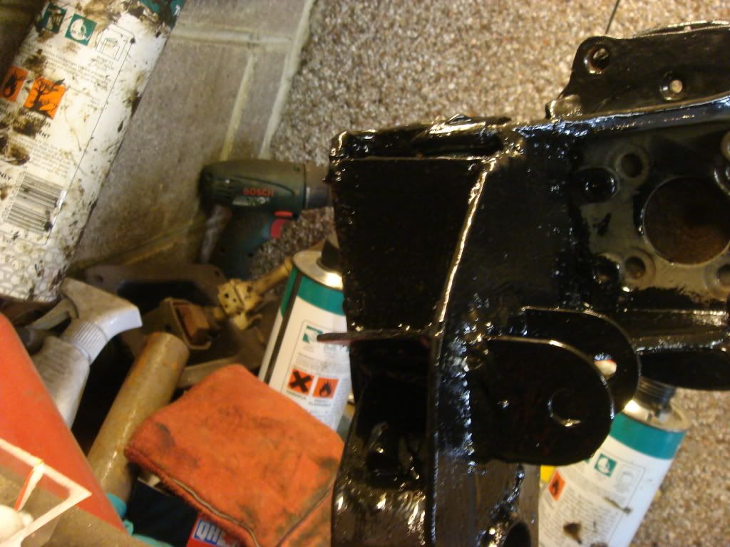

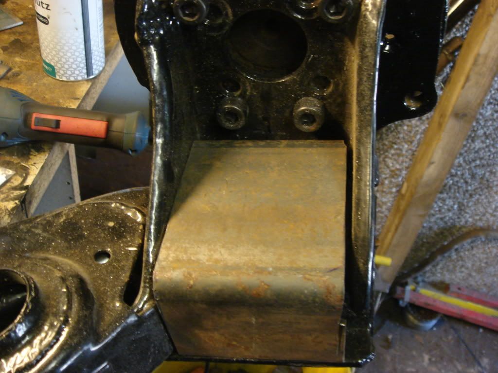

Well I managed to get something done today even thought its not much.
I started refixing the rear brakes but then noticed I have been supplied the wrong disks.
http://i761.photobucket.com/albums/x...0/DSC03244.jpg

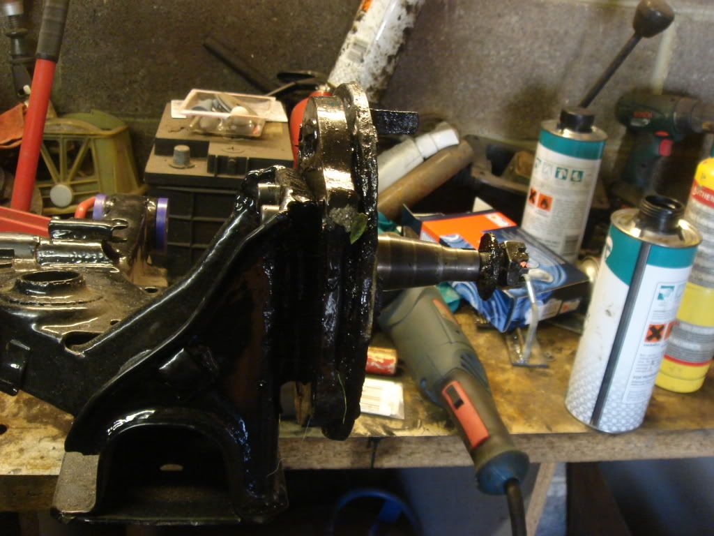

So I decided to mock fit the rear axle to make sure the coilover lines up for the new bracket.
http://i761.photobucket.com/albums/x...0/DSC03245.jpg
made the bracket to suit.
http://i761.photobucket.com/albums/x...0/DSC03246.jpg

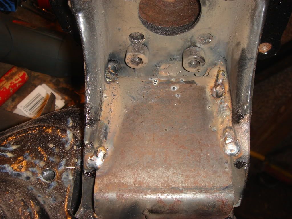

welded it in place
http://i761.photobucket.com/albums/x...0/DSC03248.jpg

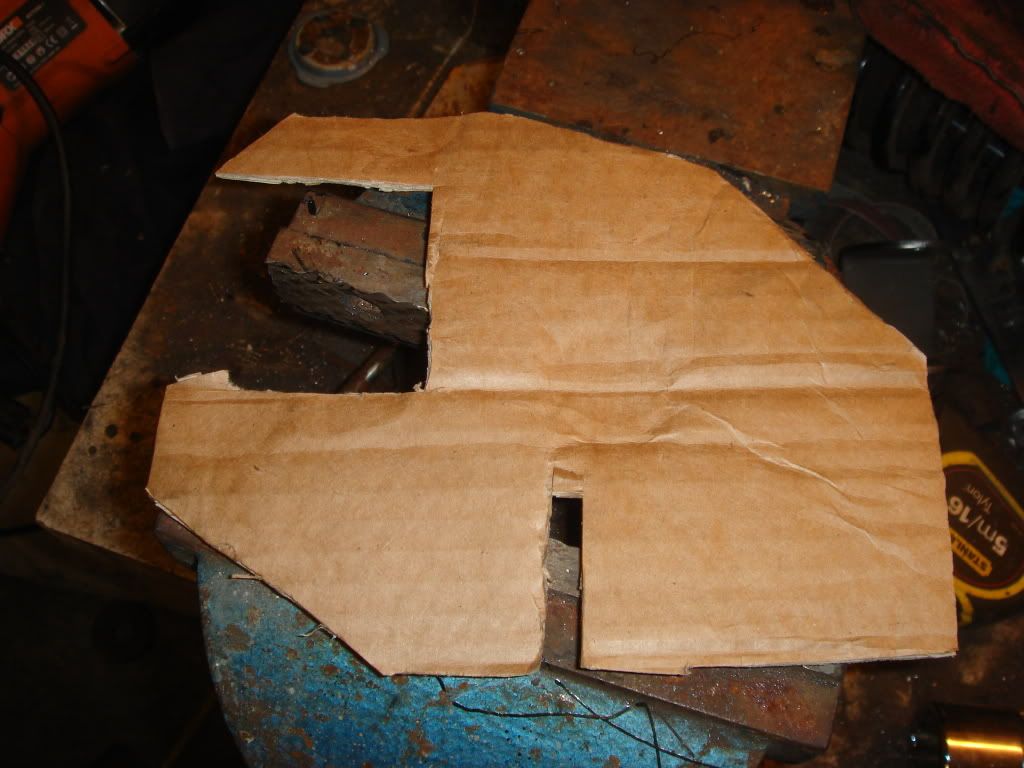

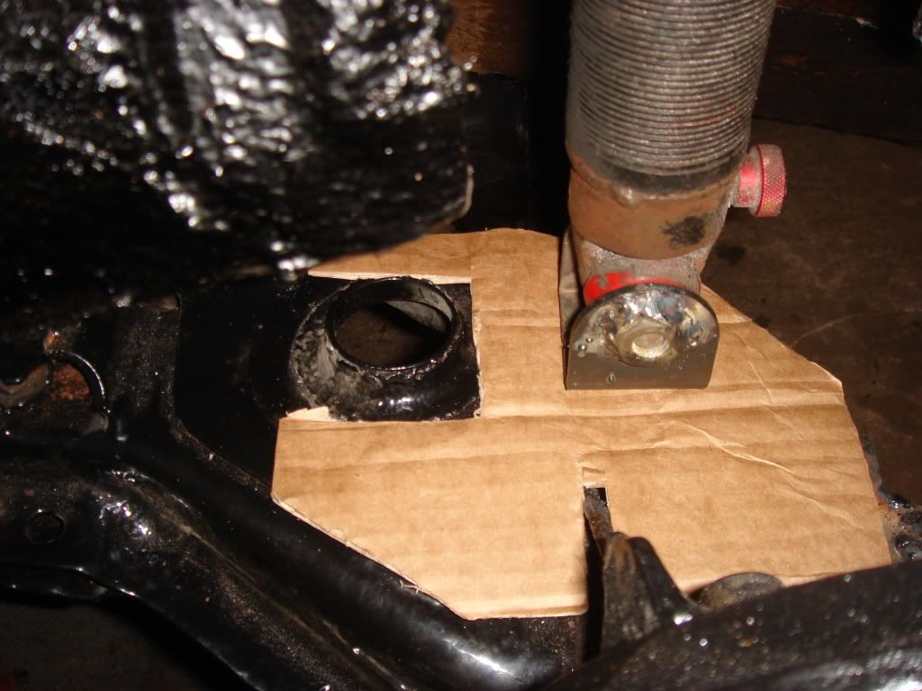

And everything was going so well until when we held the axle up in place the new bracket that bolts onto the strut base was too far inward :cry:
so out came the 3mm plate and made the template to suit (starwars comes to mind)
http://i761.photobucket.com/albums/x...0/DSC03250.jpg
http://i761.photobucket.com/albums/x...0/DSC03251.jpg
http://i761.photobucket.com/albums/x...0/DSC03252.jpg

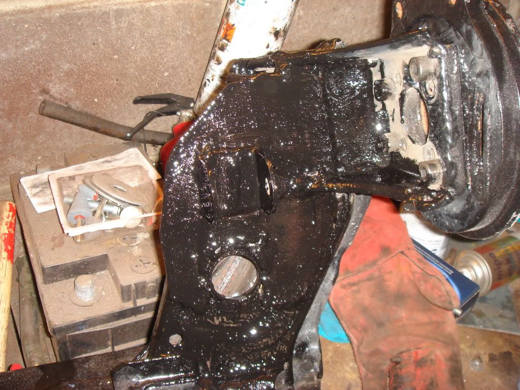

I have put a single triangulation underneath but I think I may need another
http://i761.photobucket.com/albums/x...0/DSC03254.jpg
Ill get the other side finished tomorrow and start with other pressing things
Cheers Gareth
for the beam, you can just weld in a piece of box under your new plate, will be plenty strong enough, pretty much what i did on mine
