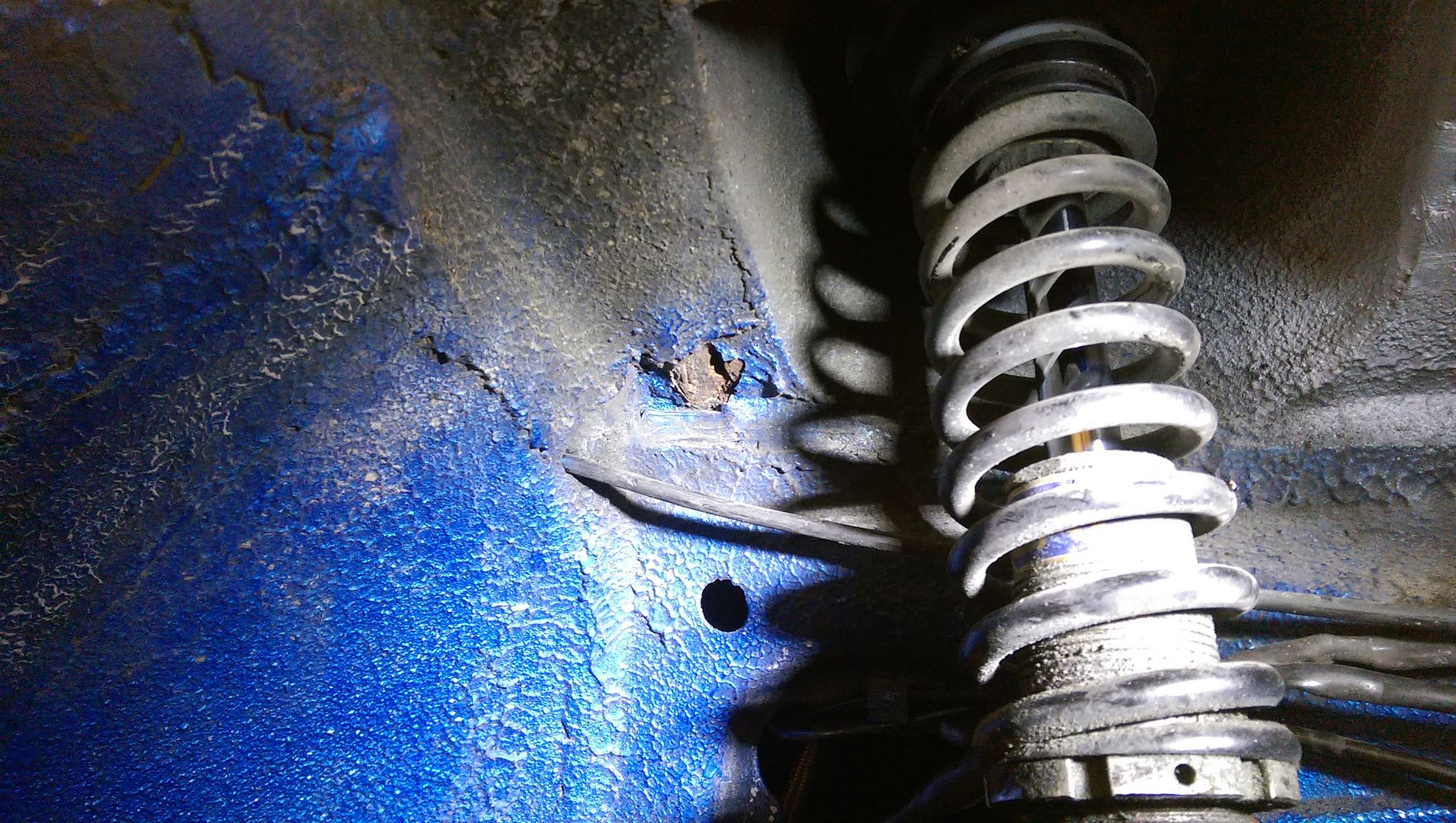

While the hubs have been away i've been doing a few bits. Found my battery tray had been welded/patched. Badly. Dan noticed you could see light thought it when he was under my dash... With a bit of grinding i cut the crappy patch out. This is mid job.
http://img.photobucket.com/albums/v3...psb0206ec5.jpg

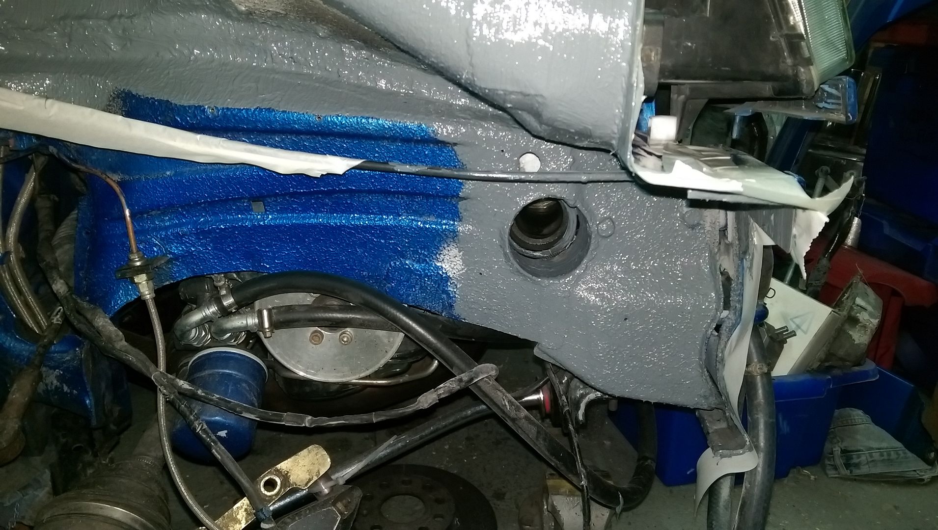

All done, etch primed and no re sealed with 3M sealant. I also took the chance to remove my "airbox" and seal all of that part of the arch as when i built it up in the summer the bodyshop didn't have any bag's of sealant i could buy. So it was painted and left... For now.

Two days later when it was dry, i masked the car up and started to paint...
http://img.photobucket.com/albums/v3...psbb75f82e.jpg
Flash makes it look a bit untidy. Sure it doesn't look that bad.
http://img.photobucket.com/albums/v3...psfc9c0c66.jpg

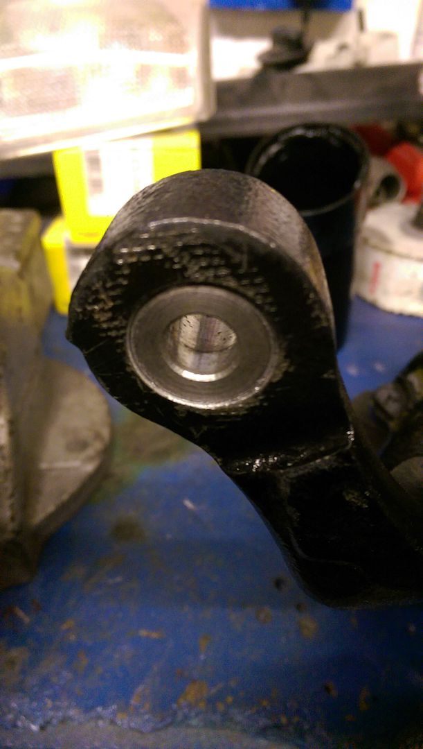

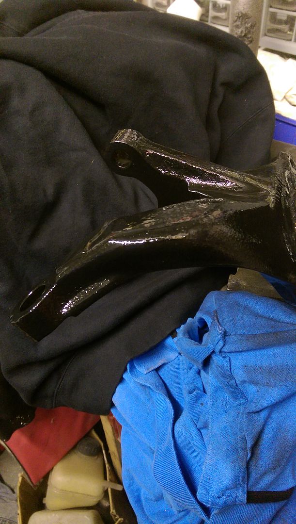

While i was painting stuff, i bared off and repaint my hub flange.
http://img.photobucket.com/albums/v3...psf0a791e1.jpg

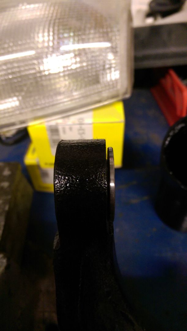

Fitted the sleeve,
http://img.photobucket.com/albums/v3...pscpsoougt.jpg
Had to use my big vice and lean on it. It's a very tight interference fitting.
http://img.photobucket.com/albums/v3...psnmcftrzk.jpg
Fitting....
http://img.photobucket.com/albums/v3...ps198af06c.jpg

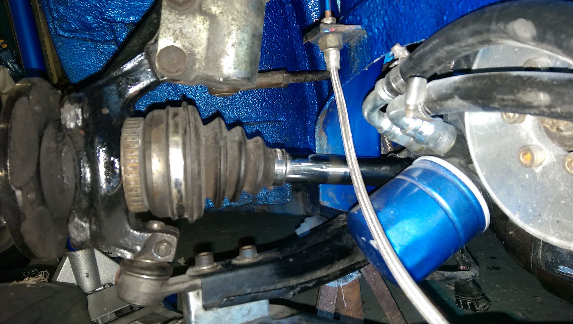

Held on the jack here
http://img.photobucket.com/albums/v3...psxsgzqirh.jpg
Looks in line/same kinda angle as/with the lower arm.. Which is the best way to correct bump steer from what you guys have said above.

Gen me up on the 3M sealant?
Looks a lot like original?
Top effort!
Is a 2pac stuff in a bag,(bag has a join in the middle you tease apart and have to mix it all together in the main bag) meant to be sprayed (you buy a gun and spray with a compressure) is a rubberized sealant, so it take a knock or bang.. Nice and flexi but strong. Best stuff ive used (home or in the bodyshop, used ut there on all restos being painted underside)
Way better than anything gm use.
Not cheap tho. What i did there was most of a bag(worse when sprayed) get them them cheap at 18quid a bag.. via the body shop... Need a proper trade supplier to buy them from too...
