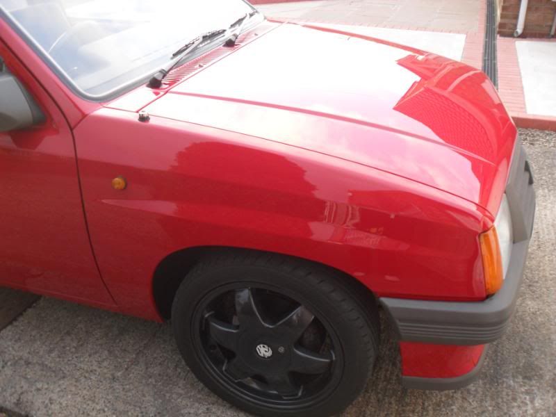

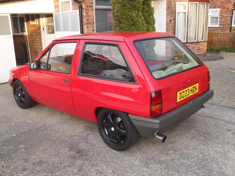

It's a beautiful example Nick, rare in that condition. Did you run a paint micrometer over it for paint depth and repairs? How did it come out?

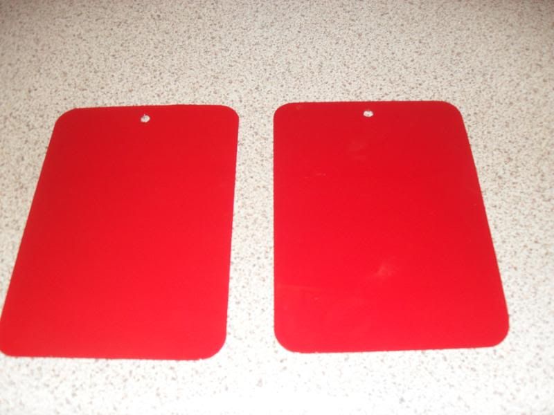

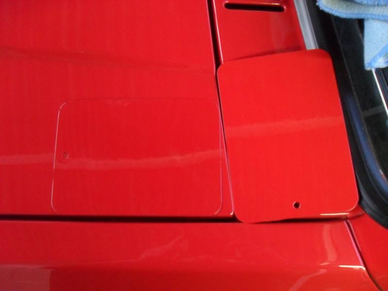

Doesnt look much in it above does their? But below you can see the clearer better option to go for........
http://i84.photobucket.com/albums/k2...bowip012-3.jpg
With a good match sorted I started making someplans with my foreman. Now Im sure you can see were this is going but I'll have to leave it at that for tonight! Hopefully more tommorow.

That is bloody awesome, well done Sir!
Dude i reckon it would be ashame to respray it as its got such good condition body work thats all original and not resprayed..
Looks amazing btw.
I'd be happy if one of the panels on my car was as good condition as your whole car, definitely got a gooden there nick :thumb:
Wow it's cleaned up brilliant, love red Novas when they DO actually look red, top job Nick.

Yes I did Jeff....... The cars paint was completely original apart from some dodgy work just below the rear windscreen on the tailgate Which has since been rectified.

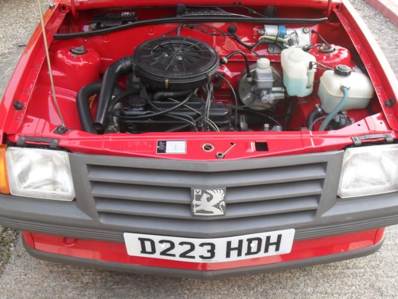

The engine bay/ancillaries then recieved a similar going over that the outside had. A huge degreasing session on everything I could get my hands to followed by clay bar then compounding via a damp cloth and by hand. This was then also sealed and waxed..... small block novas are so easy to work with as I could get my hands in almost everywere which was a bonus!
http://i84.photobucket.com/albums/k2...mar2012044.jpg

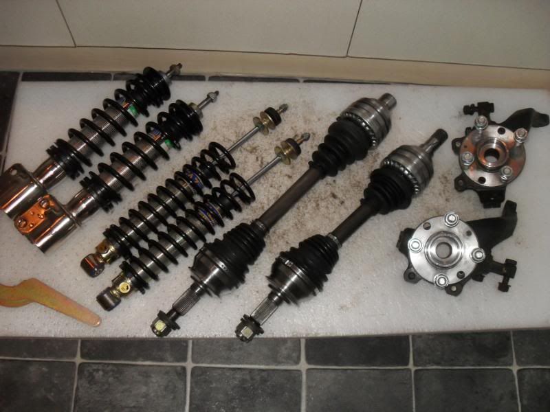

Then with the bodywork massively improved I turned my attentions elsewere sourcing a low mileage gear linkage. Broke it down and left it to soak in vinegar for a week or so which resulted in it coming out like so........
http://i84.photobucket.com/albums/k2...bowip011-3.jpg
http://i84.photobucket.com/albums/k2...bowip168-2.jpg
Works well that old vinegar trick! I finished it with a wire wheel/brushes at work then etched it up and sent it out to Swedge with the nylon bushes for rosejointing. Then with the future conversion in mind I bought this little lot below. Almost new hardly used Gaz coilover set and a built up set of David Dixons equal length shafts with conversions flanges etc. All were degreased and cleaned up before storing as you can see their looking pretty spanking! All were sourced second hand to keep costs down as Id said initially I dont want a huge costly build and dont mind using second hand quality parts as long as their in good condition........
The gaz's came spec'd with 250lb front springs and 180lb rear so Ive ordered some 300lb springs that Ill use for the front and swap the 250's to the rear..........

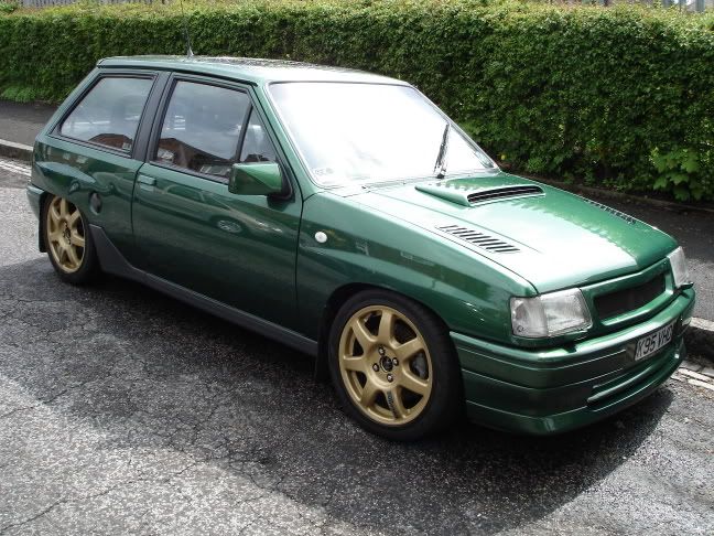

Ive only seen one set of RL7's in 16" on a nova in fifteen years and that was Gary hopes old motor shown below which I think they look fantastic on........
http://i84.photobucket.com/albums/k2...o/7bc4b6c6.jpg

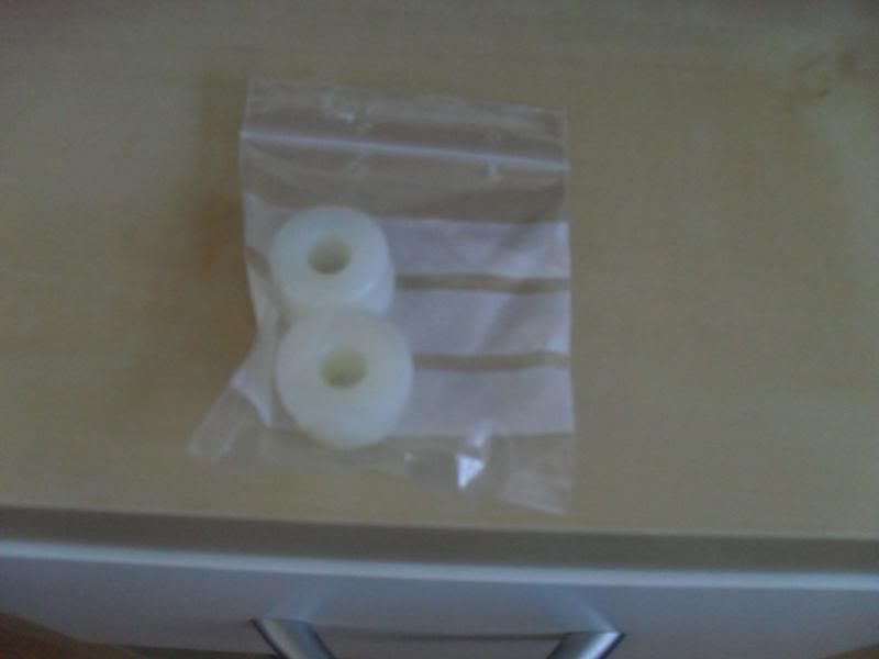

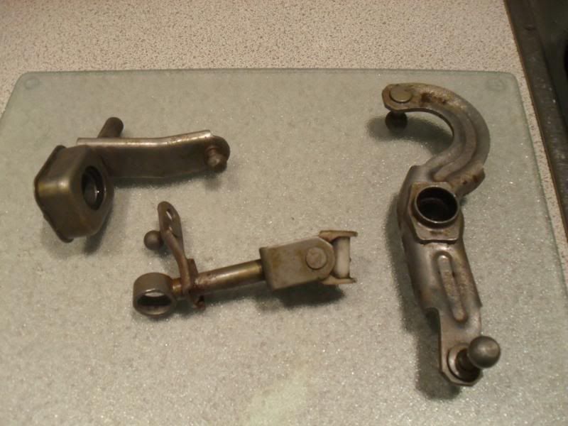

Where did you get the linkage nylon bush from too please?
Lmf sell them i think
EDIT:
& Nick what intermediate shaft and mount do you plan on using? Astra z20let ones?
Here you go Simon...........
http://www.lmfvauxhall.co.uk/M-Tech-...on-Bushes.html
Exactly the same as I ran on my last project fella being the dummy shaft/bracket available from most vauxhalls that ran the c20xe's in the 90's.... Calibra, Astra gsi and so on. Same principle as the zlet item but Im unsure If one would fit or not. where as whats shown below is a direct fit.
http://i84.photobucket.com/albums/k2...g?t=1299434324

Think maybe the wheels might looks a little large with the small bumpers tho ? Just imo, but with wheels most peoples opinions are different :)

Cheers Edd, Looking at c20tbo which runs 16" mo's with small bumpers I think I'll be ok as long as the stance is right. Interior wise It will always be a complete full interior for this build. Maybe a gte one If I can find one in good enough order so its in keeping with the mk1 theme. That will be later into next year though with other goodies etc.
http://i84.photobucket.com/albums/k2.../TotalVX39.jpg

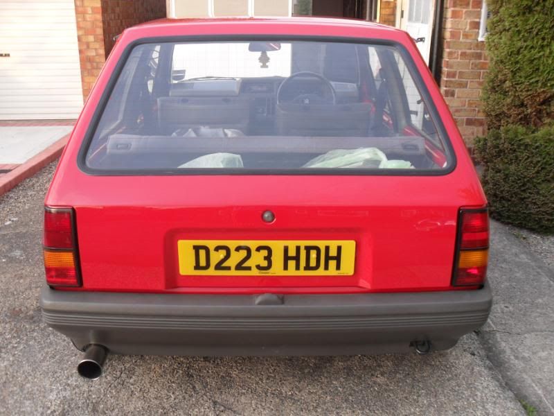

Perfect rear panel........
http://i84.photobucket.com/albums/k2...bowip012-5.jpg
