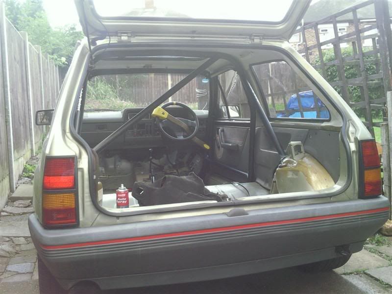

Got the sound deadening ripped up after work today. Its left the glue crap but i will get rid of that with a wire wheel. Good to see NO rust AT ALL :cool:
Also got the cage in place to see where/what needs changing/modding.
Few test fit pics, fits quite well :)
The primer is just to mark an outline where the cage sits.....
Excuse the phone pics, i dont carry a digicam around with me lol

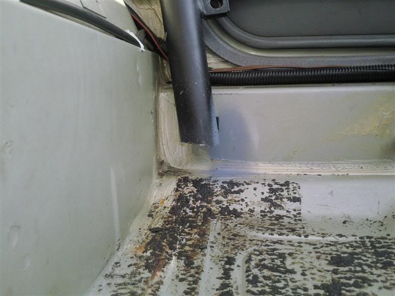

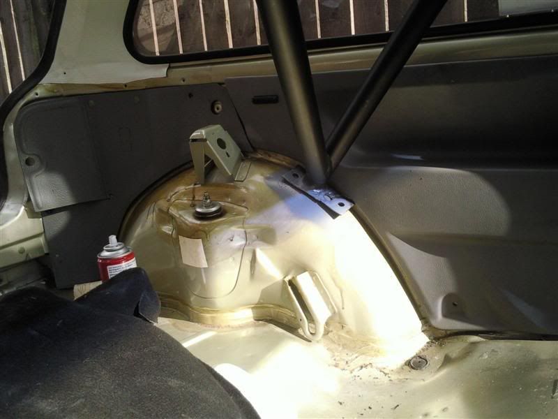

Heres a problem, the previous owner cut the feet off and shortened the b-pillar legs (to get the cage to clear a gsi sunroof)
http://img.photobucket.com/albums/v8...P/Photo057.jpg
So im going to have to make a 90deg kind of metal plate, welded to the floor and sill, and then boxed in at the ends.
Will probably just weld the cage feet back on, and weld that bit of the cage directly to the floor spreader plate. (Looks a bit tricky to try and get bolts through there, with it not sitting flush on the floor)
Front legs, again will weld the feet back on, then weld a spreader to the floor and bolt it down.

Looking good. cages are a pain to fit as i found out lol

Already managed to t**t my head on the cage twice when getting out the car, thats without seats fitted lol.
Also trapped my finger inbetween the top door bar and the door seal :( lol

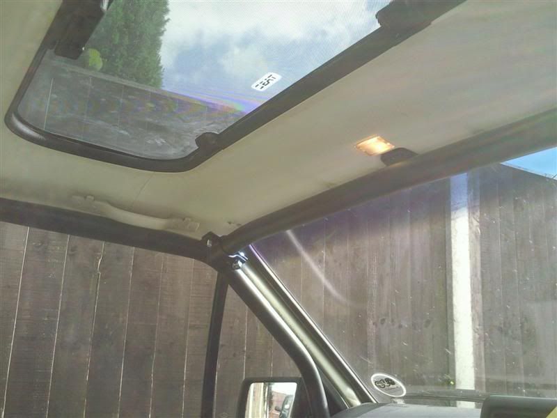

that say 'seat' on the sunroof??
cages rock. good stuff.
Its a Seat sunroof......
Aftermarket non vaux conversion.....
Just noticed you had to lose the rear view mirror as well lol. Gonna get a stick on one for the windscreen?

Rich, the mirror should go back on, i removed it just to get the windscreen bar in place.
Thanks Nick, your opinion is always very welcome to me :)
The cage obscures one of the mirror screws IIRC, so you might want to leave it out incase the mirror needs to come off for any reason.

3mm for cage spreaders I think? Just weld some feet to the cage and weld it to the spreader plates on the car, you know it makes sense! And box out the B pillar legs.

The mirror should clear, the angle of the pic makes it look tighter than it actually is.
The visors will just stay removed, hope top tint screen provides enough shading against the sun.
If not you can get a massive sunstrip.
My top tint wasnt really enough on its own, If I didn't have the visors I'd have definately fitted a sunstrip.
