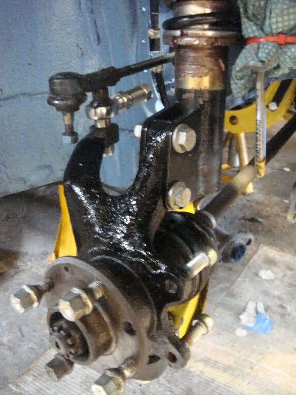

But after about an hour of that it didnt really go to plan as i struggled on my own with the suspension. Fitted up the coilovers ok and did the usual bit of touching up along the way,

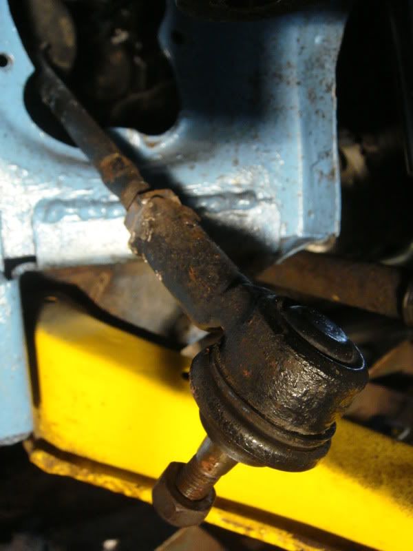

But then the old o.e track rod ends i did maul and can't get those off :-(

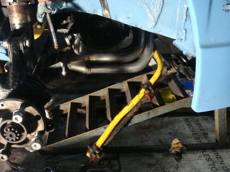

Also the rollbar/tie bar got me in a tizz. Now i left the rollbar on for the mo as a number of the fixings are seized too.. so its easier just to fit the lot and run one. But as i didnt really pay much attention months ago when we took it off; which way does it fit on??

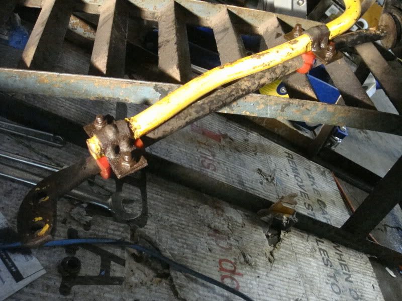

Like so; with the threads on the antiroll bushes U-fixings pointing up?

Have you cracked the nuts on the track rod ends? If not put the ends in the hubs and wind the nut on to hold it still. Looks from the pics like your trying to undo them while they are moving around.

hi rich, the lot of it is seized.. i am trying to undo the lock nut, tho tbh i wasnt sure which way it goes.. so just gave it hell both directions..Quote:
Originally Posted by Rich
If your looking at it from end of the rack, the lock nut should go in a clockwise rotation to wind it onto the rack.
Get a spanner and a hammer on it, can be very tight. Alot of the time at work they need heating up, if you have a blow torch its worth a go. Definatly put it through the hib to do to hold it in place or your making alot of work for yourself.

Roll bar goes on the underside of the tie bars.
