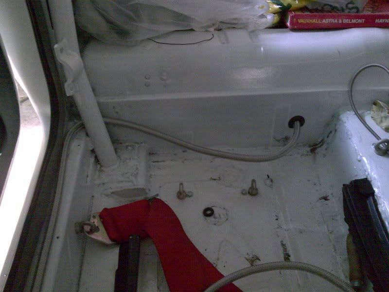

Bit more done...
Fuel line into the car...
http://img.photobucket.com/albums/v3...a/Image144.jpg
... Along the sill to the bulkhead
http://img.photobucket.com/albums/v3...a/Image145.jpg

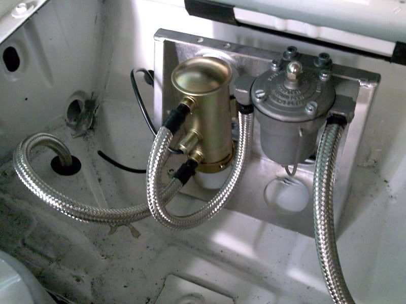

And into the bay
http://img.photobucket.com/albums/v3...a/Image142.jpg
I'm waiting on delivery of some hose finishers and jubilee clips for the fuel line, and also an inline pressure gauge before I can complete the line to the carbs. And also need to get a rivet gun sorted to get the line P clipped in.
Really happy with the outcome.

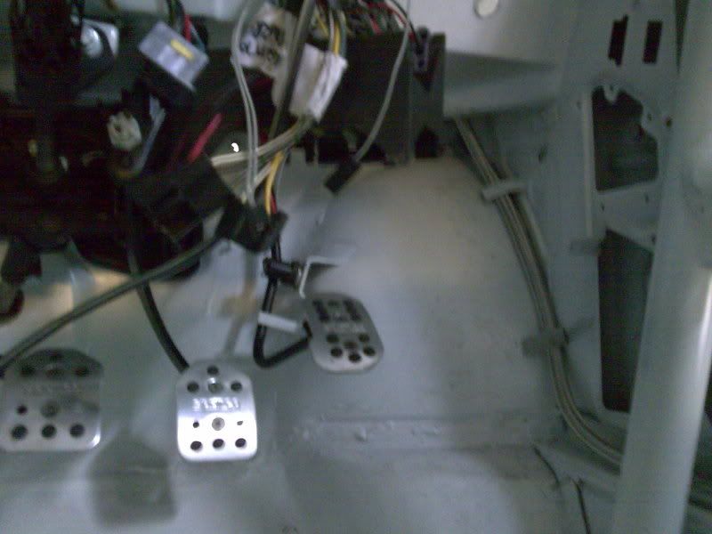

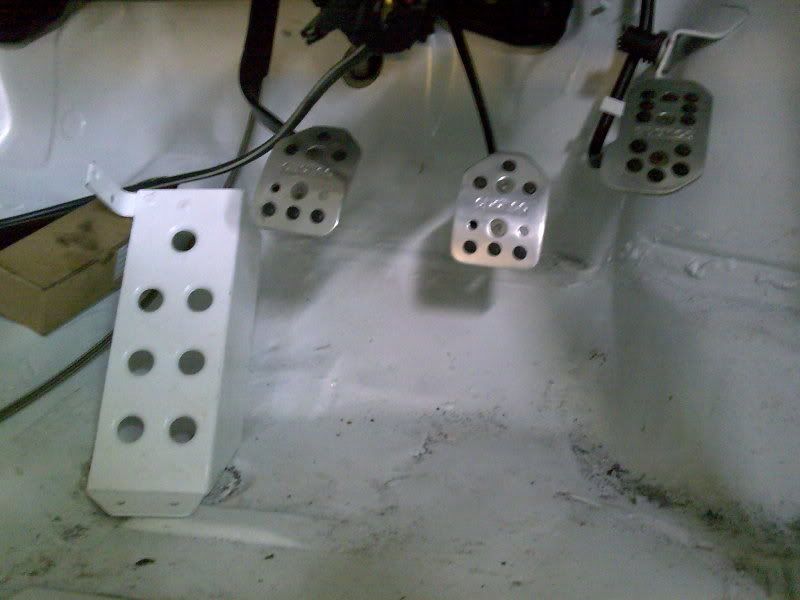

Also had a look where I'm going to mount the footrest when I get the rivet gun :cool: Also got my shifter finally bolted in, but had to make the hole in the tunnel bigger as it wasn't quite big enough
http://img.photobucket.com/albums/v3...a/Image146.jpg
