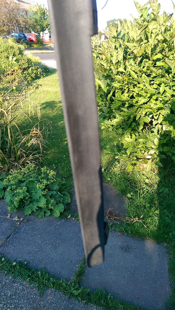

Something alot of people miss/ dont think of. Wiper arms, they can look tatty as funk.
http://img.photobucket.com/albums/v3...ps3efb4b27.jpg

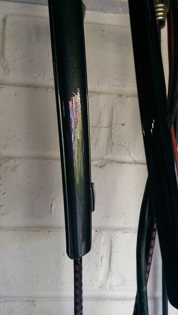

And the spoilers.
Before.
http://img.photobucket.com/albums/v3...psd268bb2b.jpg
After.

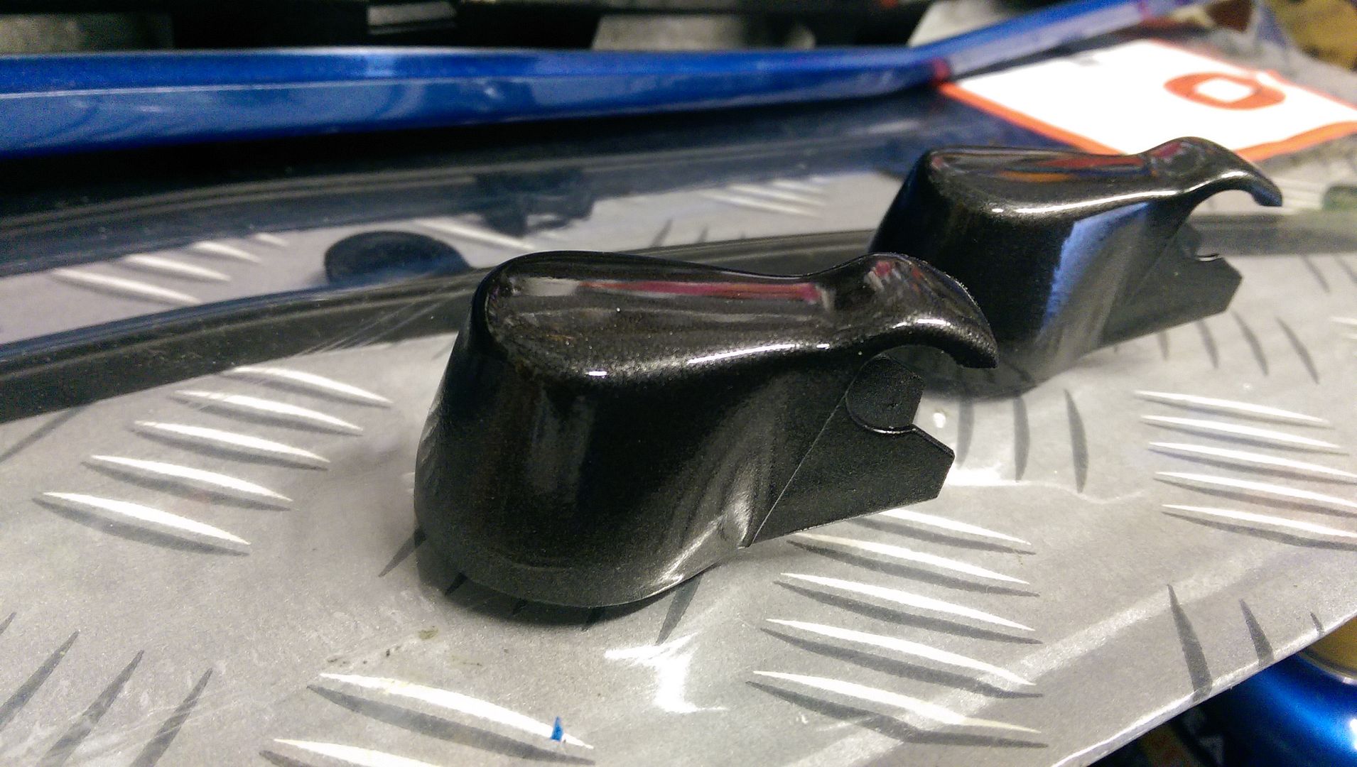

And the hinge covers.
http://img.photobucket.com/albums/v3...ps3ddb052b.jpg

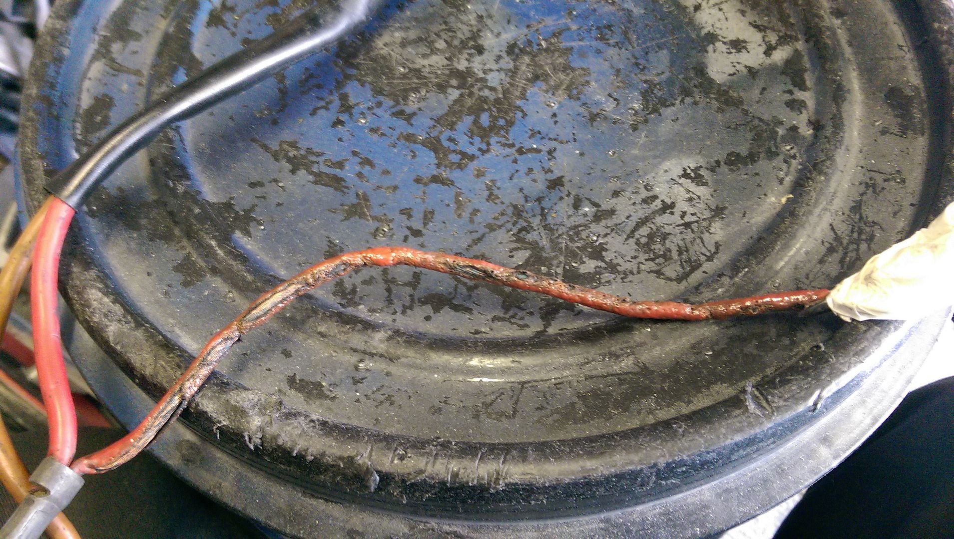

But when i had been under the car i noticed the power cable from the alt to started had got very hot when the alt seized (burning the ground loom out)
So i set about removing it and fixing it.
Oh, that's crispy...
http://img.photobucket.com/albums/v3...ps447214c4.jpg
Eek.
http://img.photobucket.com/albums/v3...psd9b181db.jpg

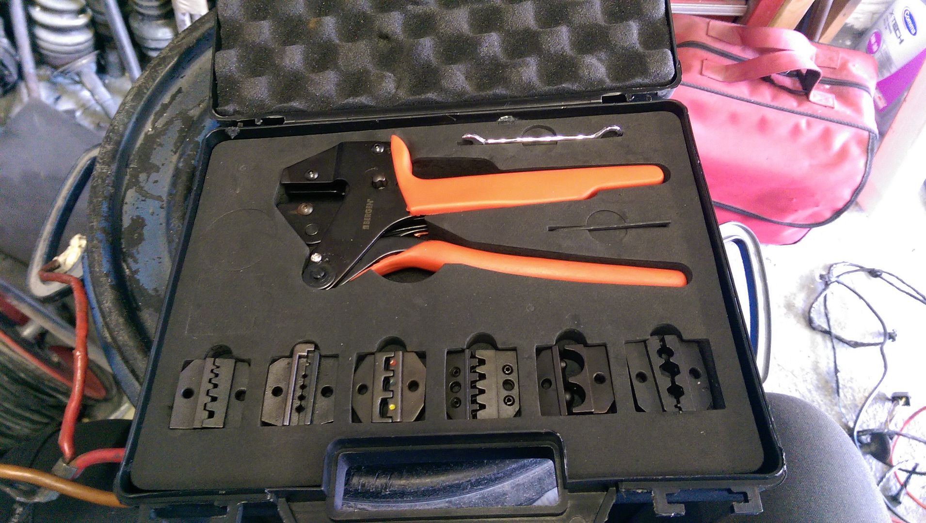

While at Billing i saw this nice crimping tool, saw it at PVS and didn't buy it. But this time i saw the need as it can do battery/power cables...

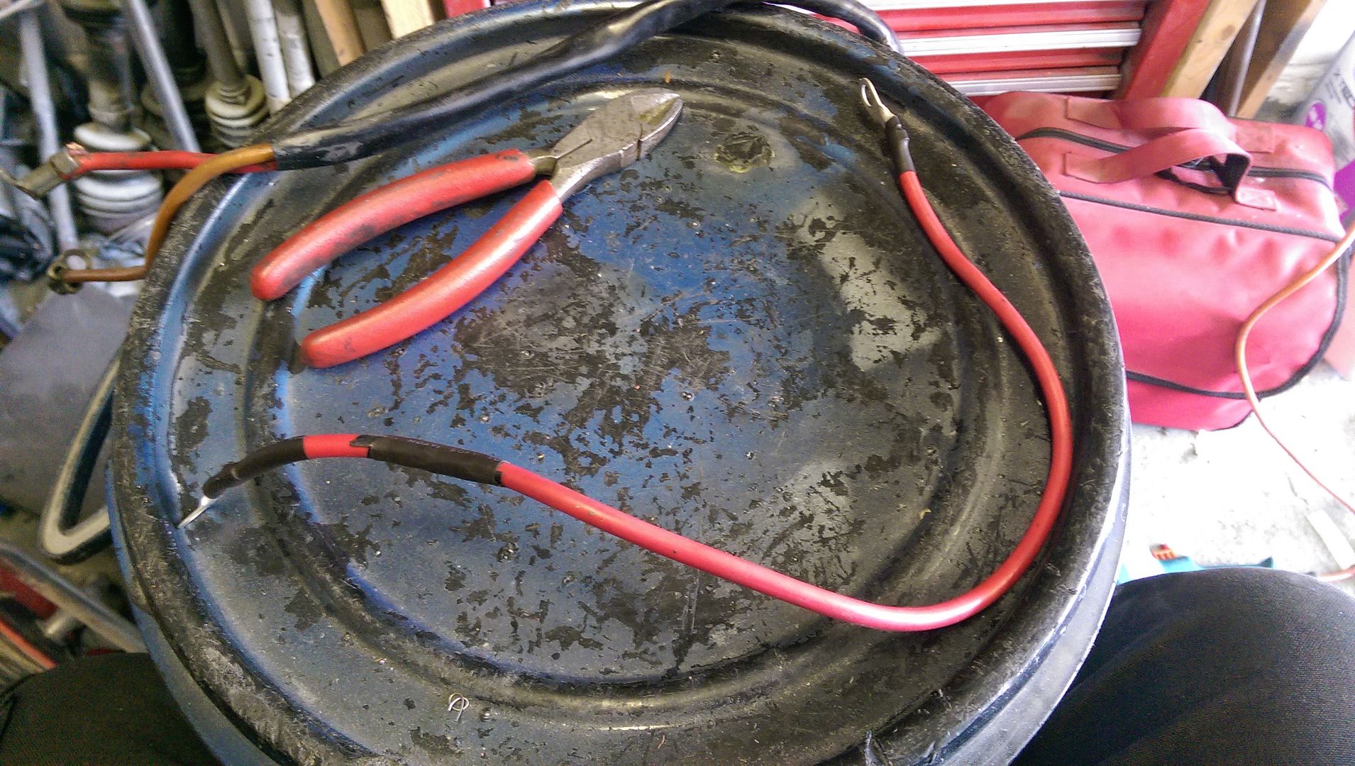

Went though my box of cables/wire/wiring looms and found a nice bit of power cable from a Calibra. Chopped it out, cut a a lil longer than the Nova bit. Found my battery crimps...
http://img.photobucket.com/albums/v3...ps6b1cff01.jpg
Used the new tool, added a lil solider just to make sure the joins where good, heat shrunk..
http://img.photobucket.com/albums/v3...ps2a4d7821.jpg
Sorted.
http://img.photobucket.com/albums/v3...ps68db04d1.jpg
