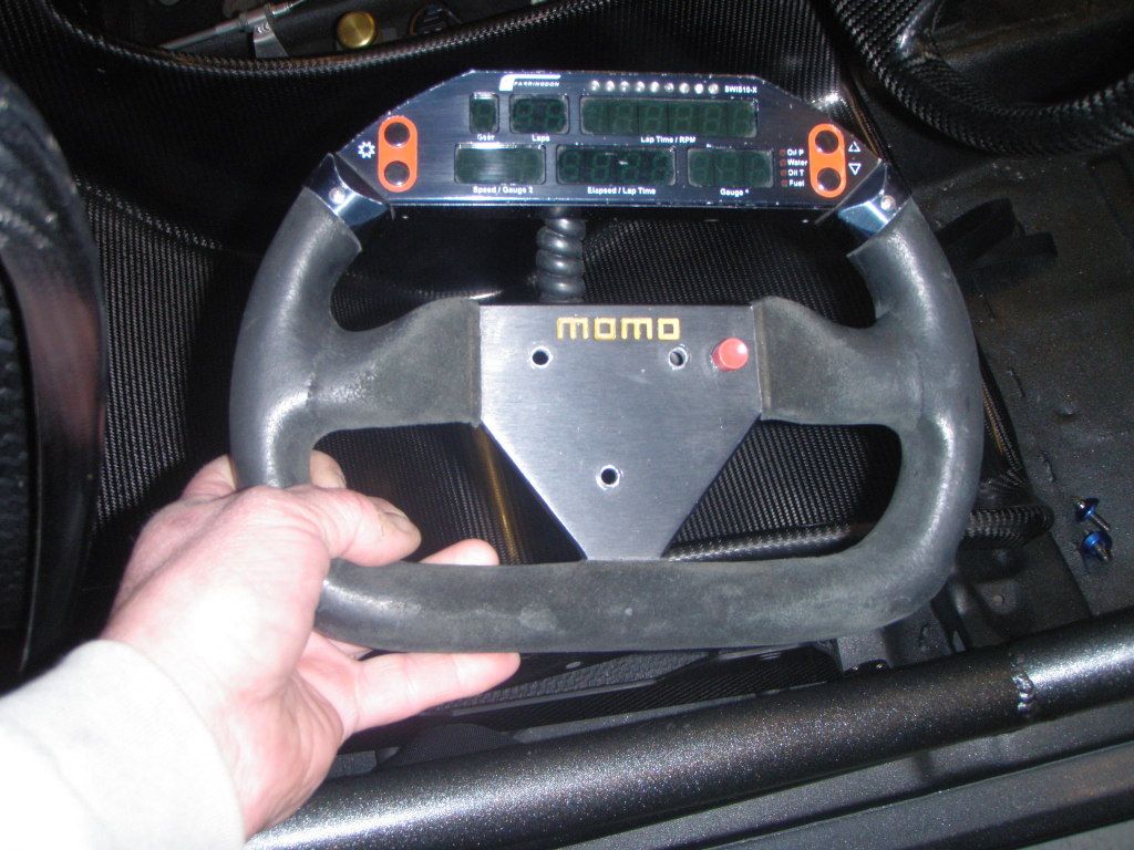

This arrived in the post yesterday;
http://i285.photobucket.com/albums/l...ort/001-44.jpg
http://i285.photobucket.com/albums/l...ort/002-80.jpg
It was cheap as whoever removed it from the car had simply cut through the cable going into the back of the module (!). I've had a word with Farringdon Instruments who make these, and they're going to repair it at a very sensible price.
Not sure whether I will replace my STACK display with this one eventually or not - obviously I won't be using the steering wheel which came with it!! It's a tiny 250mm one out of a single seater.
I'd keep the stack & have something to shroud it in either carbon or ally. Gogo on the floor & pedals!

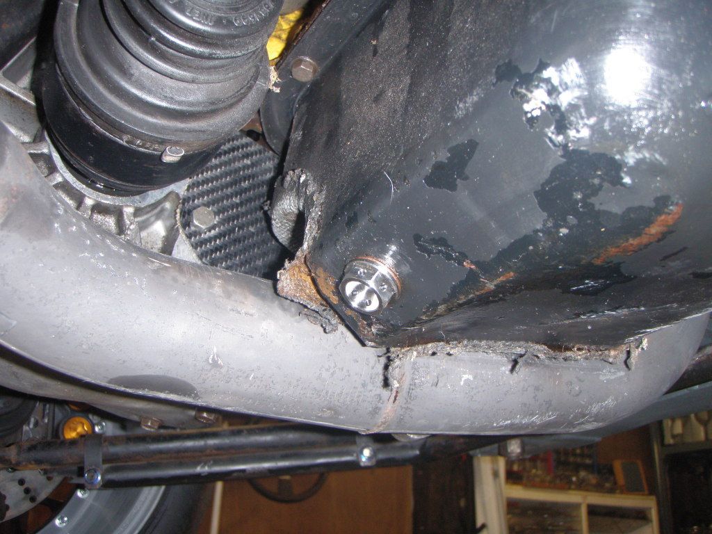

Scarcely an update, but I did fit my titanium sump plug today (it's a racing motorcycle item!). Looks lovely, and saves a tiny fraction. Another one that can't be seen normally though;
http://i285.photobucket.com/albums/l...ort/031-10.jpg
In the backround you can see a honeycomb carbon fibre plate I made for the gearbox (the bit that covers the flywheel).

I can't work out the relative positions of your sump/manifold/gearbox though. has the sump been modified, or am I up too late?
