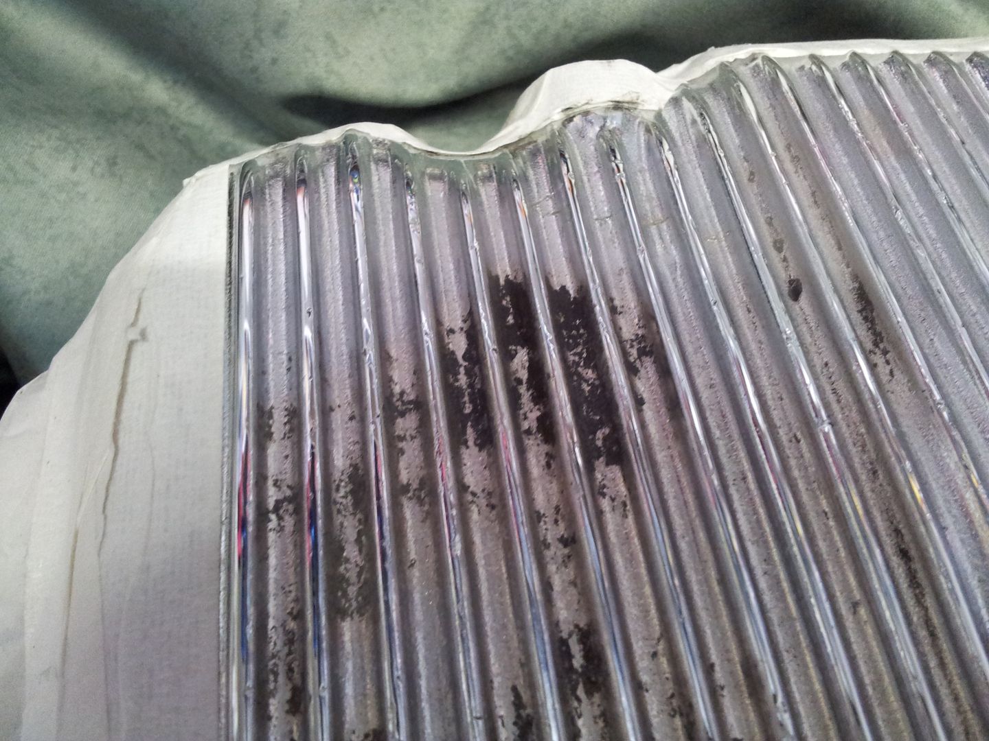

Other was corrosion in the fins.
Here..
http://img.photobucket.com/albums/v3...psd7e7de77.jpg
http://img.photobucket.com/albums/v3...psc3b8f23a.jpg
Needed to be sorted as it would look utter ****e.
Mask to the edge of the fins and lightly sand.

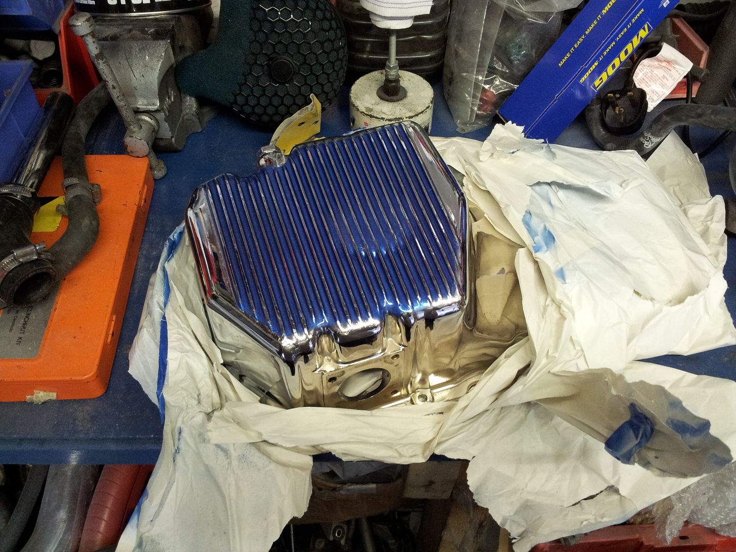

Lacquer and let dry then un mask... Leaving me with a tidier job.
http://img.photobucket.com/albums/v3...ps3e1d403d.jpg

Refit new chromed sump.
http://img.photobucket.com/albums/v3...ps9be5326f.jpg

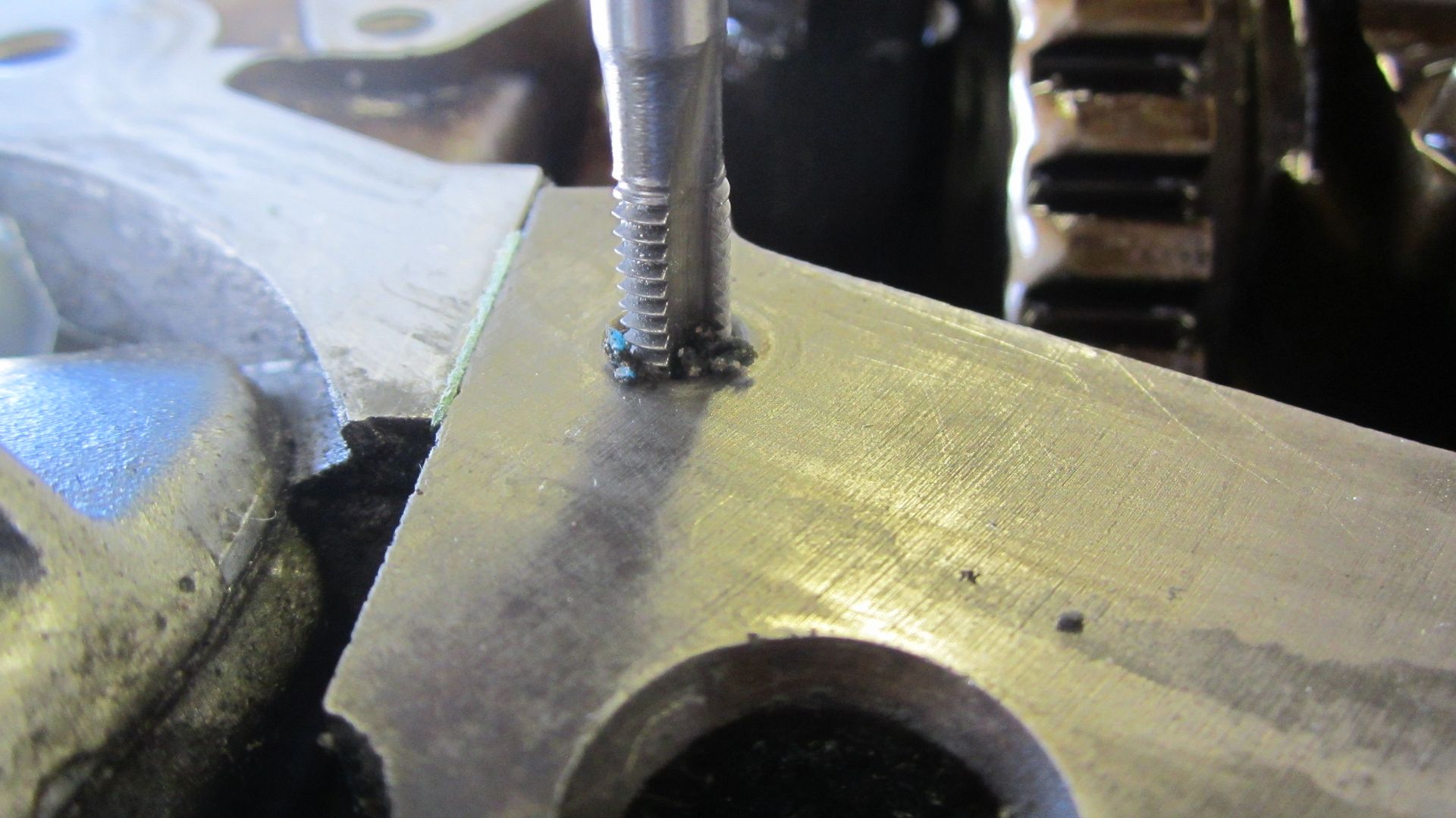

Nut and bolted on the pump end, as i'm using a Zlet pump and they have M8 holes. Last time i tryed drilling the holes in the gasket and sump to be M8, this didn't work on the gasket and could of made a leak from there...
http://img.photobucket.com/albums/v3...psda79a037.jpg
Finished.
http://img.photobucket.com/albums/v3...ps00a916b5.jpg
