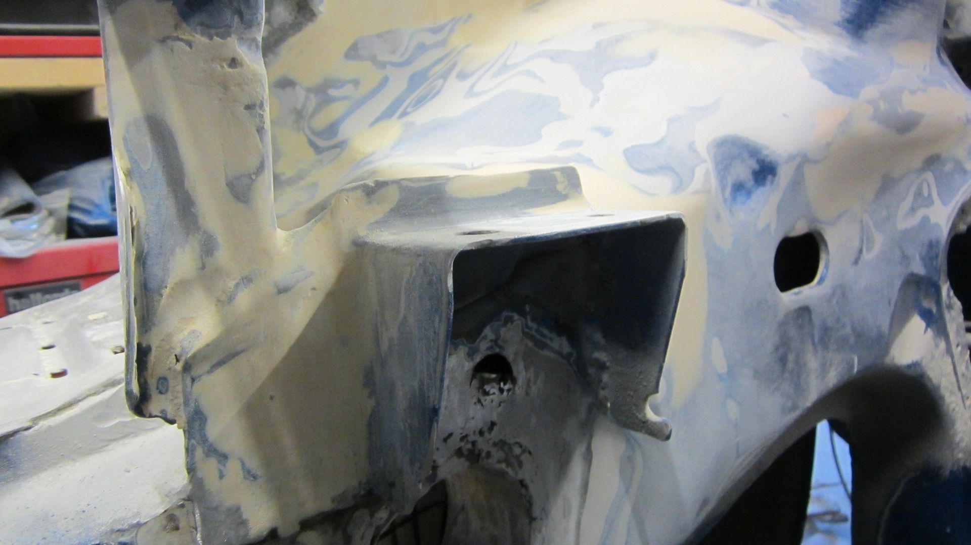

Small update.
Been in the garage.. Grind, weld, grind, fill, sand... Repete. :( Sick of it.
Started by welding the other side of the leg tube, then filling the small cut away at the top. (and the small hole) My welding isn't the tidiest tho)
http://img.photobucket.com/albums/v3...pse672bdbf.jpg
The started to lay down a coat of black fiberglass.
I wanted the mount fully smoothed in as it will be much more on show.
http://img.photobucket.com/albums/v3...ps7f620371.jpg
Didn't like the loom going thru here, as it was on show. So it got welded over and smoothed.
http://img.photobucket.com/albums/v3...ps096e3822.jpg

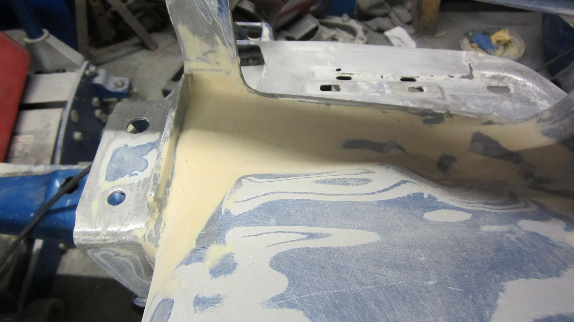

Sand all that down, then use a finer nicer filler/stopper.
http://img.photobucket.com/albums/v3...pse1bb7909.jpg
As you can see i made a few repairs and maybe smoothed a few bits off again..lol
http://img.photobucket.com/albums/v3...pse2668ab1.jpg
http://img.photobucket.com/albums/v3...ps47621797.jpg
Main bit behind the mount.
http://img.photobucket.com/albums/v3...ps7bdfa1e6.jpg
http://img.photobucket.com/albums/v3...psd8e9bb0b.jpg
Next up is primer and then paint, soon hopefully.
Benn you need gas for your welder that weld has no strength
When the bay stay stay ready he looks sweet.
No? I was getting alot of brown dust when welding, i think my reg is a bit dodgy. As some times its ok and i get a much better weld.
It all holds strong, think it's work going over the top? Or a flat plate over the top for extra strength?
