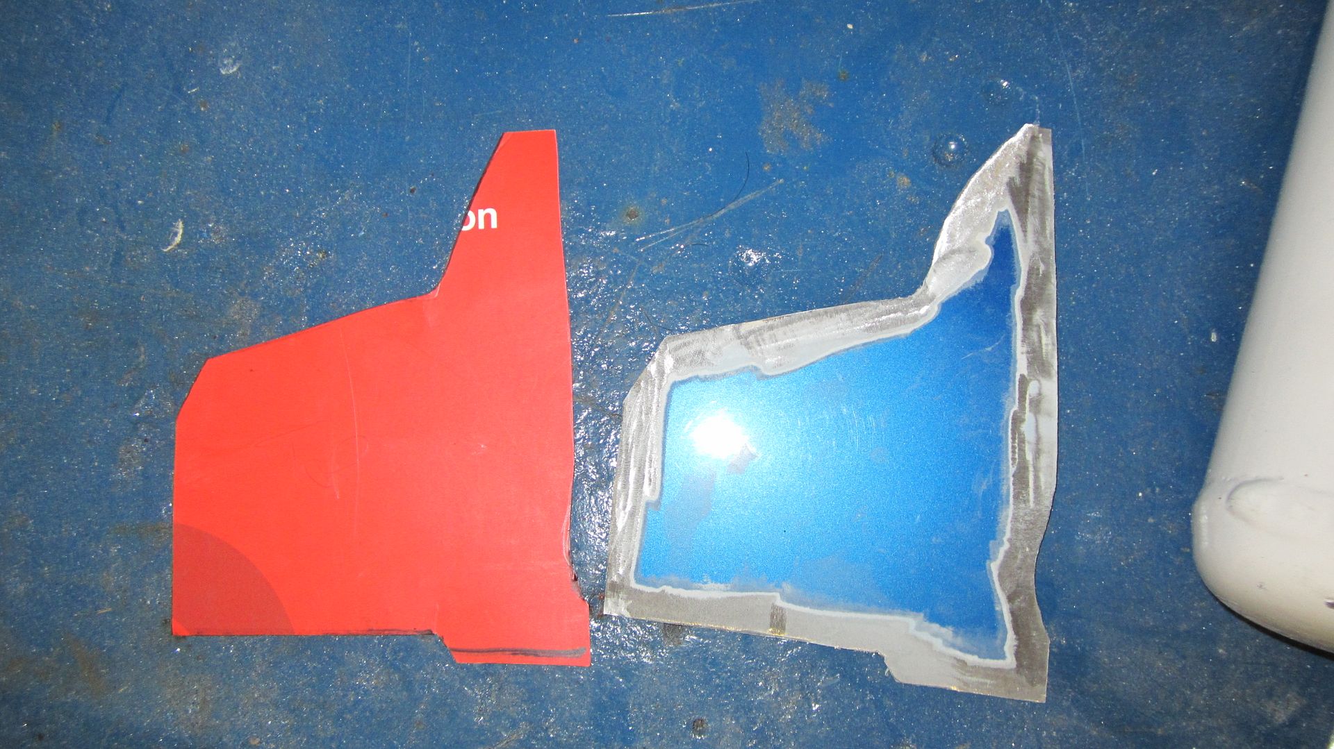

Now on the drivers side behind the mount, theres a kinda dip. With my air pipe on your couldn't see it, but it was untidy and would pool up with water. We all know that isn't good... So i wanted to fix that as there will be no air pipe over the top...
Out with the CAD.
http://img.photobucket.com/albums/v3...ps6cc71f7f.jpg

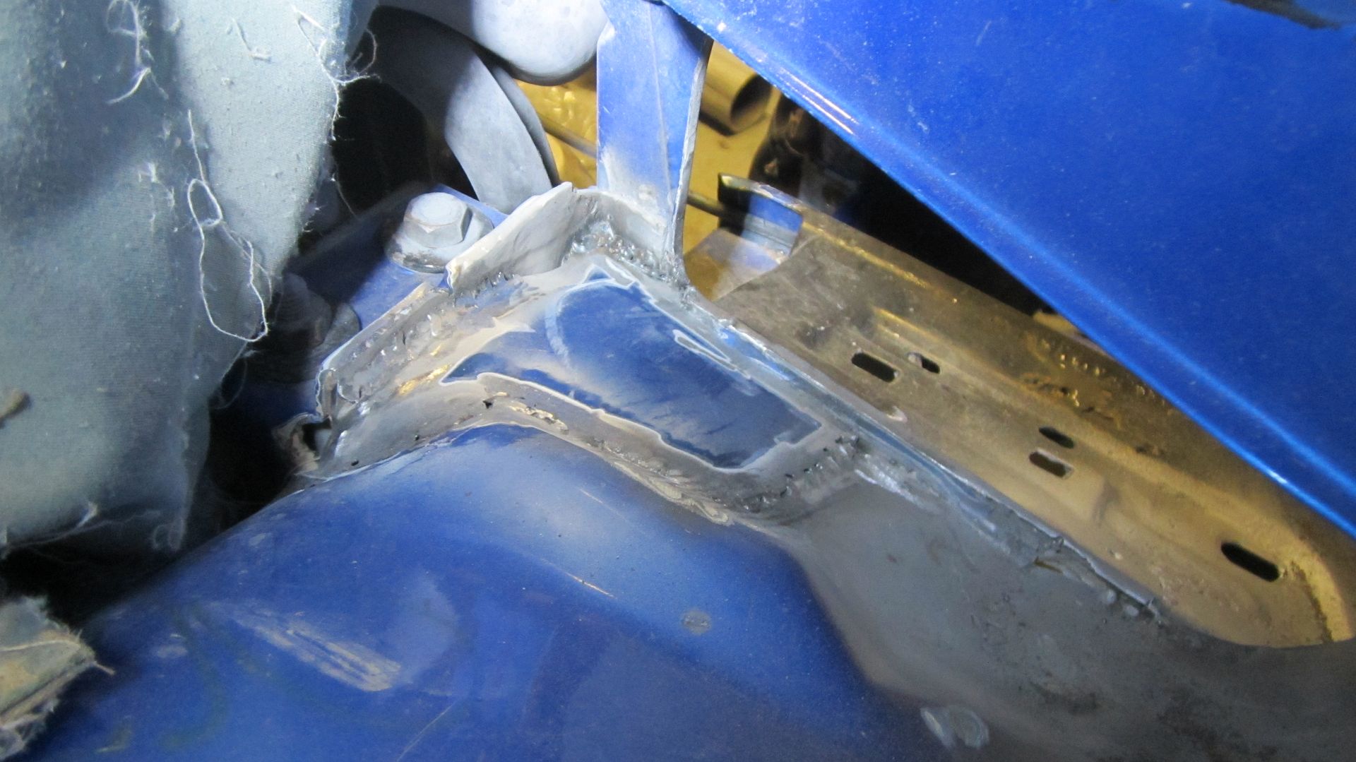

Lots of trimming and messing about later...
http://img.photobucket.com/albums/v3...ps4a421b27.jpg
http://img.photobucket.com/albums/v3...ps9bf64028.jpg
Now before someone says it, yes there is a small gap right by the mount. But this will be fixed when the engine is out as i need space to get in there more.
http://img.photobucket.com/albums/v3...ps234b697b.jpg
Under this plate, i've also tagged the back on the mont to the chassis leg. Just for added strength.

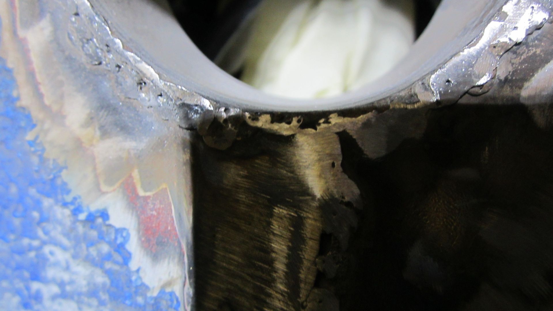

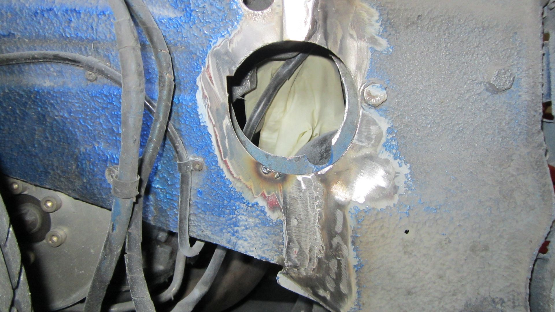

Next on to my hole... hehe
I've welded the seam above and below, for added strength.
http://img.photobucket.com/albums/v3...psb64f333e.jpg

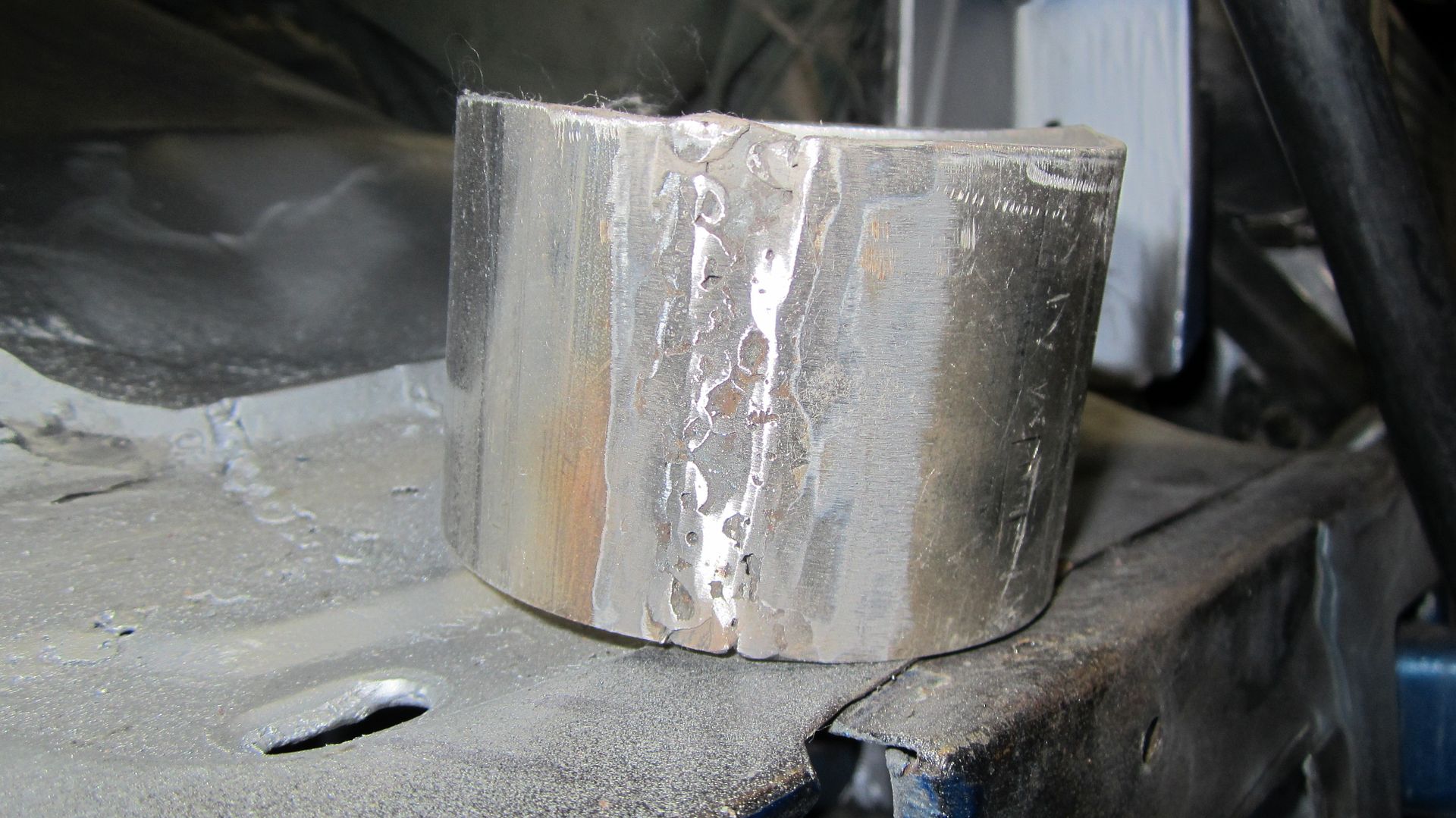

Tube to be welded in, was a lil small, so had to add a bit of width.
http://img.photobucket.com/albums/v3...pscbe166fb.jpg
http://img.photobucket.com/albums/v3...ps83e6ea5b.jpg
While welding in...
http://img.photobucket.com/albums/v3...psd4df385f.jpg
Got a bit more angle on the pipe too.
http://img.photobucket.com/albums/v3...psd00b9d89.jpg
