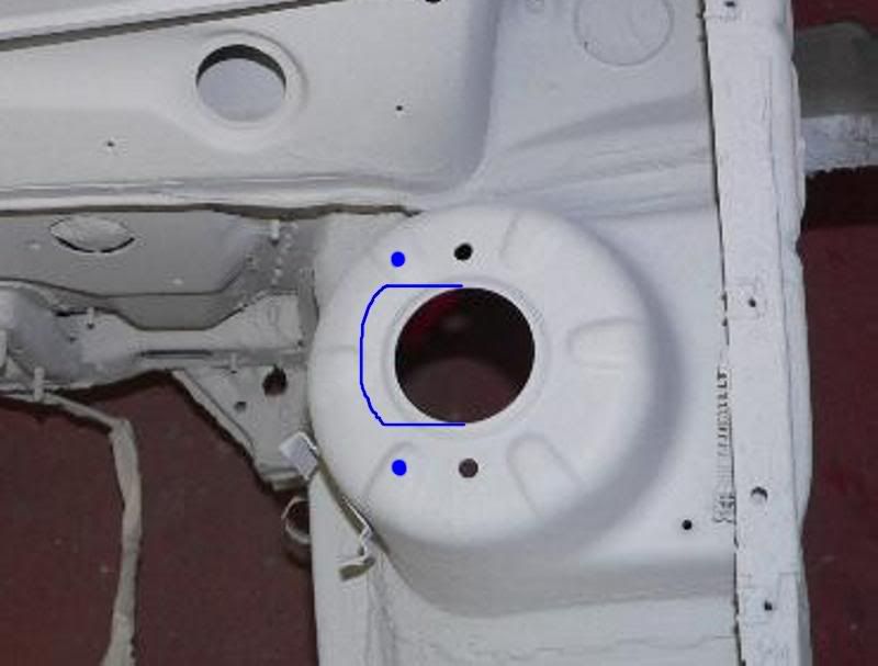

Belt sander? As in air type 10mm wide belt type belt sander? How much elongation are you planning? I take it you dont need much elongation as you only want the clearance for the tyres, so your tool of choice doesn't need to be that heavy handed but any of the above will achieve the desired effect.
I have an air die grinder with dimond edged metal cutting elongational type tool on it that would mash up your strut tops no problem in it proper bo style!
But anythin will do as long as you can get it in the whole i can assist you when ever bud!
I'm saying belt sander as its easy to do it with. Have done it in the same way on a 1/4oval track nova..
http://i136.photobucket.com/albums/q...e/turret01.jpg
or
http://i136.photobucket.com/albums/q...e/turret02.jpg
However, I think thats a drastic over exageration to what I need lol
perhaps a little but for illustrative purposes its spot on do you need the extra castor pic 2 would give?
I take it you've already got your eccentric mounts positioned fully inwards and backwards?
Yep, certainly have, and upside down ;) lol :D

Have u still got the full lip or have you filed it out?
My turrets are currently 100% standard, and untouched. Not even got the plates on top...
Just thought, by doing the above, I'll have to ditch my strut brace, which isn't so much of a biggie :)

just try filing it out 1st (you'll probably then be able to run the bearing the right way up! lol
Another option...
Could you get some blocks made up, one to bolt inside the shock lower mount where the knuckle would to stop it closing up while... you use a block either side with 4 holes in to join the strut and knuckle? This way you wouldn't need to cut the shell or weld the shock, and its completely reversible.

Top down exaggeration:
http://www.xen0phobiak.f2s.com/noval...ckdiagram2.jpg

OK, here I come to the rescue to make your life easier again lol.
Instead of having to drastically rework the turret to allow the strut top to move inwards, just grind a slice off the strut tops themselved to allow them to sit further in without fouling the inside of the turret.
As you said, you dont use them to adjust castor anymore so it wont matter if they're no longer round.
