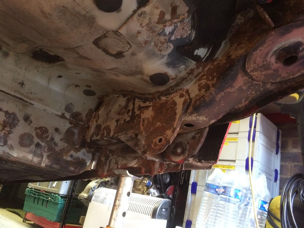

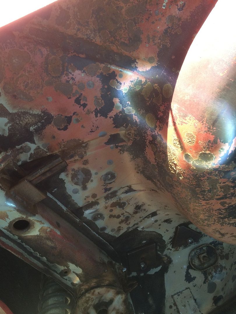

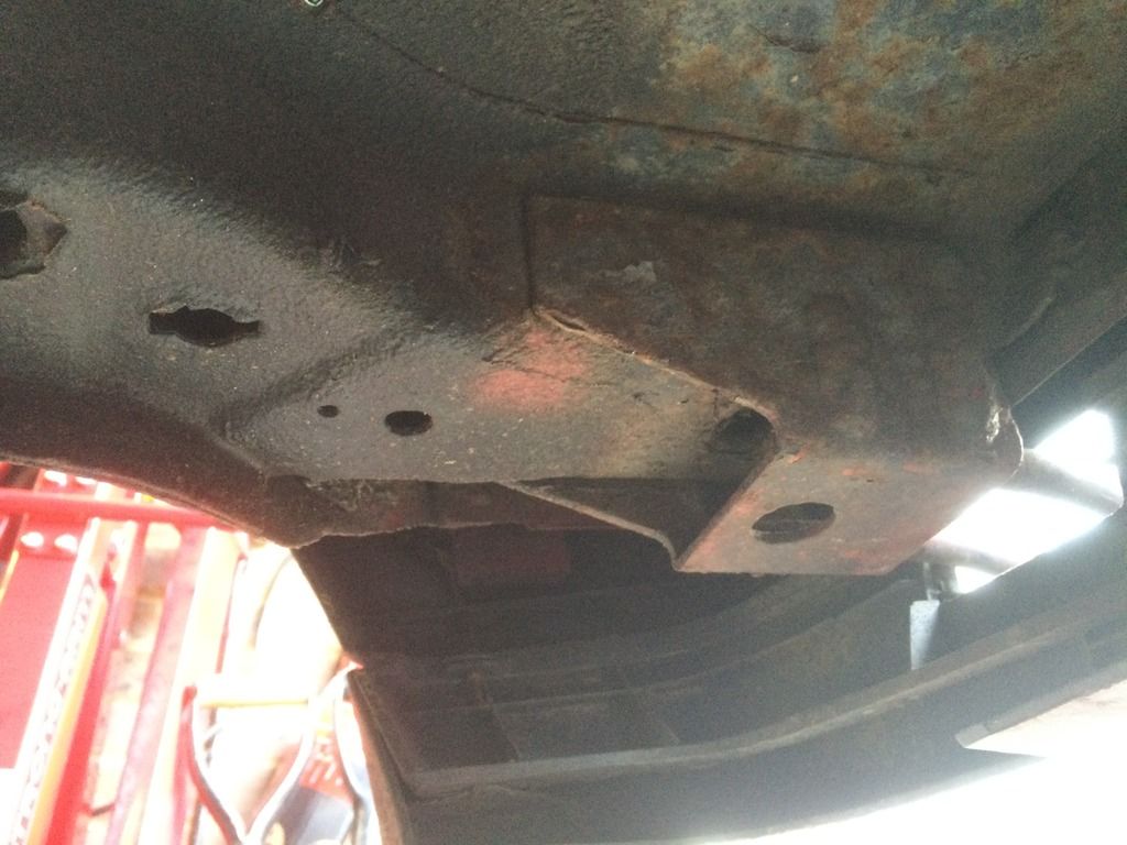

https://uploads.tapatalk-cdn.com/202...1c3b4f94d5.jpg
First time drilling the shell since it was finished.
Need to weld these in, which is even more scary
https://uploads.tapatalk-cdn.com/202...30e1730fda.jpg
Something like this
https://uploads.tapatalk-cdn.com/202...4b96a8a7d4.jpg
It's a tight fit, even if the picture doesn't look like it.
I'm gonna knock that riv nut out too and stick a boss in there. Need to bore the bosses out for M10 threads too, thought about going M8 but it needs M10 as the splitter bracket is M10 slots too.

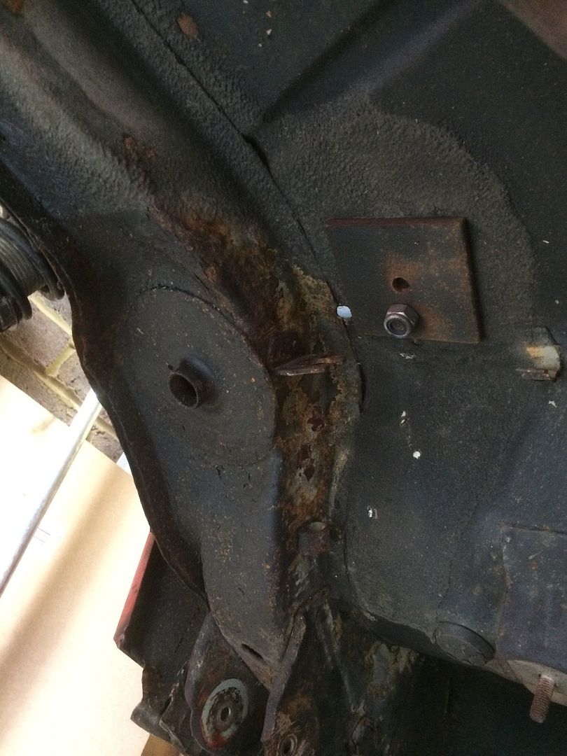

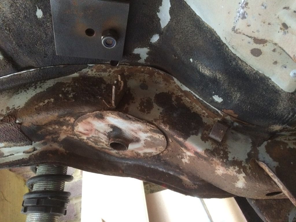

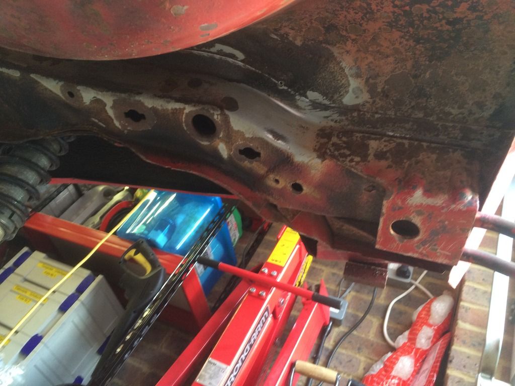

Got one side buttoned up
https://uploads.tapatalk-cdn.com/202...02cd8e30c1.jpg
https://uploads.tapatalk-cdn.com/202...6d5300f5da.jpg
https://uploads.tapatalk-cdn.com/202...c99deb1f68.jpg
https://uploads.tapatalk-cdn.com/202...8fbf15a875.jpg
First time welding in about 3 years, decided I need a new welder cos a poor work person always blames their tools!!
