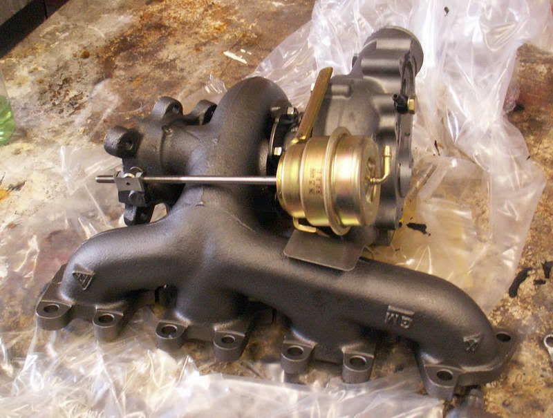

Got a bit busy today - first of all I needed to know where the water pipes from the turbo would go - so I needed to mount up this little turbo technics jobbie :-
http://i2.photobucket.com/albums/y15...va/Turbo1a.jpg

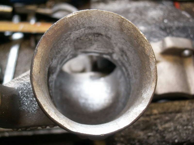

However the intake pipe has a rather large lip on it so off it came . Here's a pic with me just starting the smoothing off with the die grinder :-
http://i2.photobucket.com/albums/y15...a/Intake1a.jpg

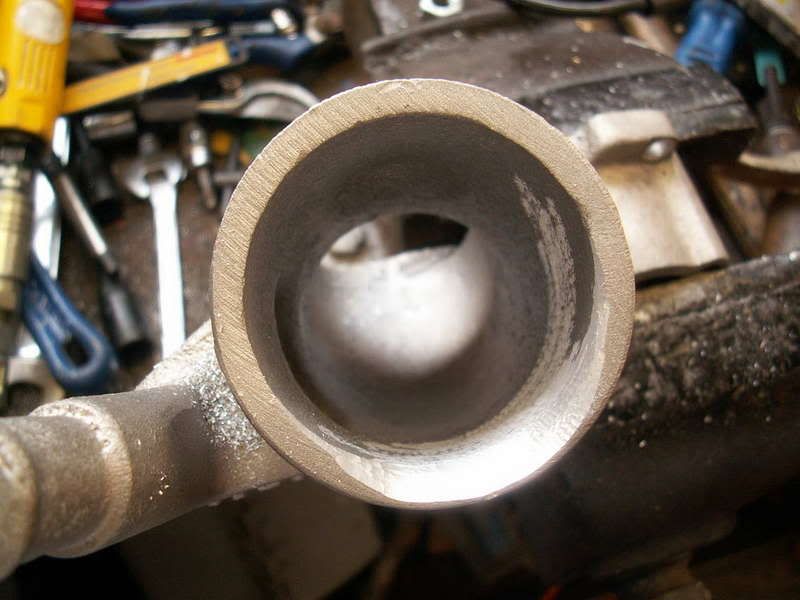

And after a bit of grinding we have ended up with this :-
http://i2.photobucket.com/albums/y15...a/Intake2a.jpg

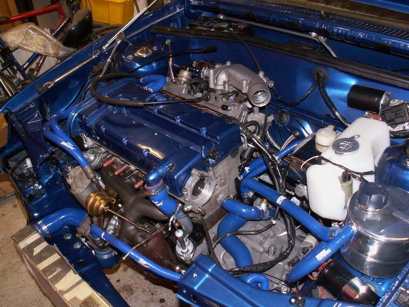

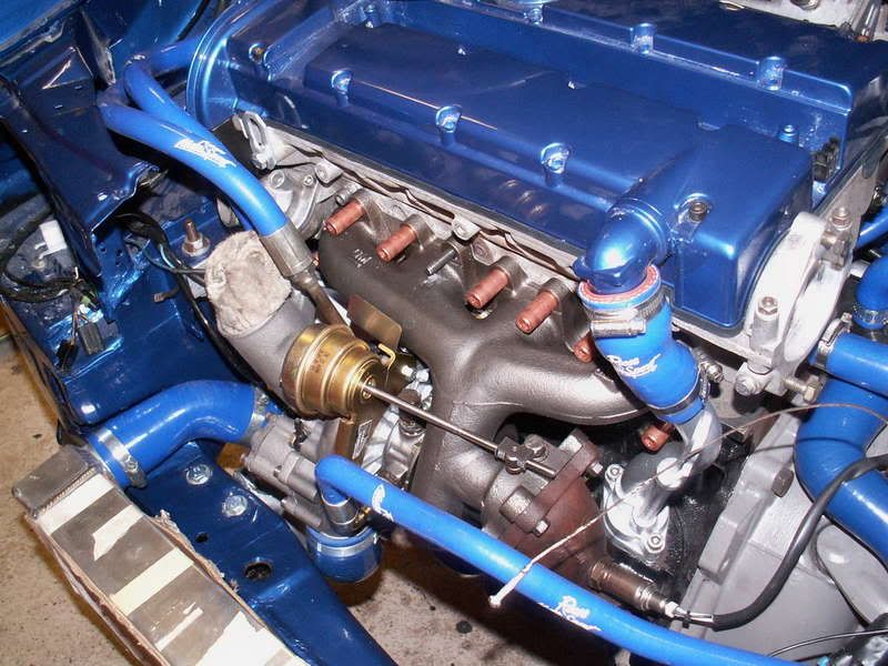

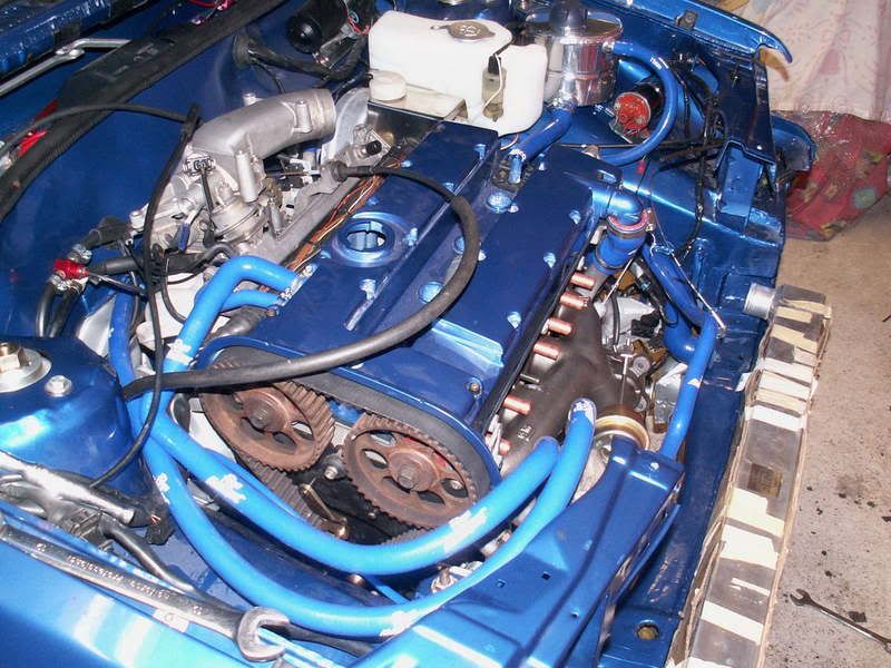

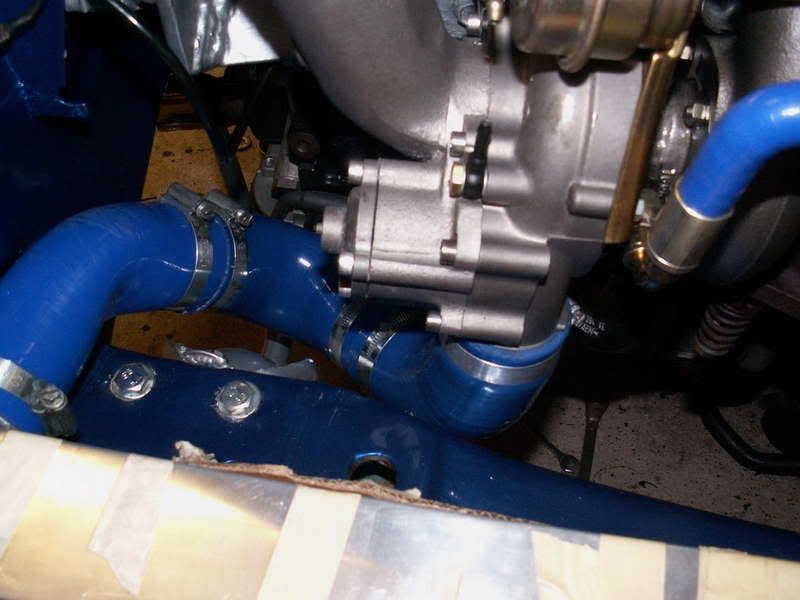

It was then on with the fitting and getting all the pipes to attach to the various parts and getting the turbo to intercooler pipes sorted and here we are :-
http://i2.photobucket.com/albums/y15...nova/Bay1a.jpg
http://i2.photobucket.com/albums/y15...nova/Bay2a.jpg
http://i2.photobucket.com/albums/y15...nova/Bay3a.jpg
http://i2.photobucket.com/albums/y15...nova/Bay4a.jpg
Next jobs are getting the next 2 tighening sequences sorted on the head bolts - get an equal length driveshaft sorted and plumb in the guages.
