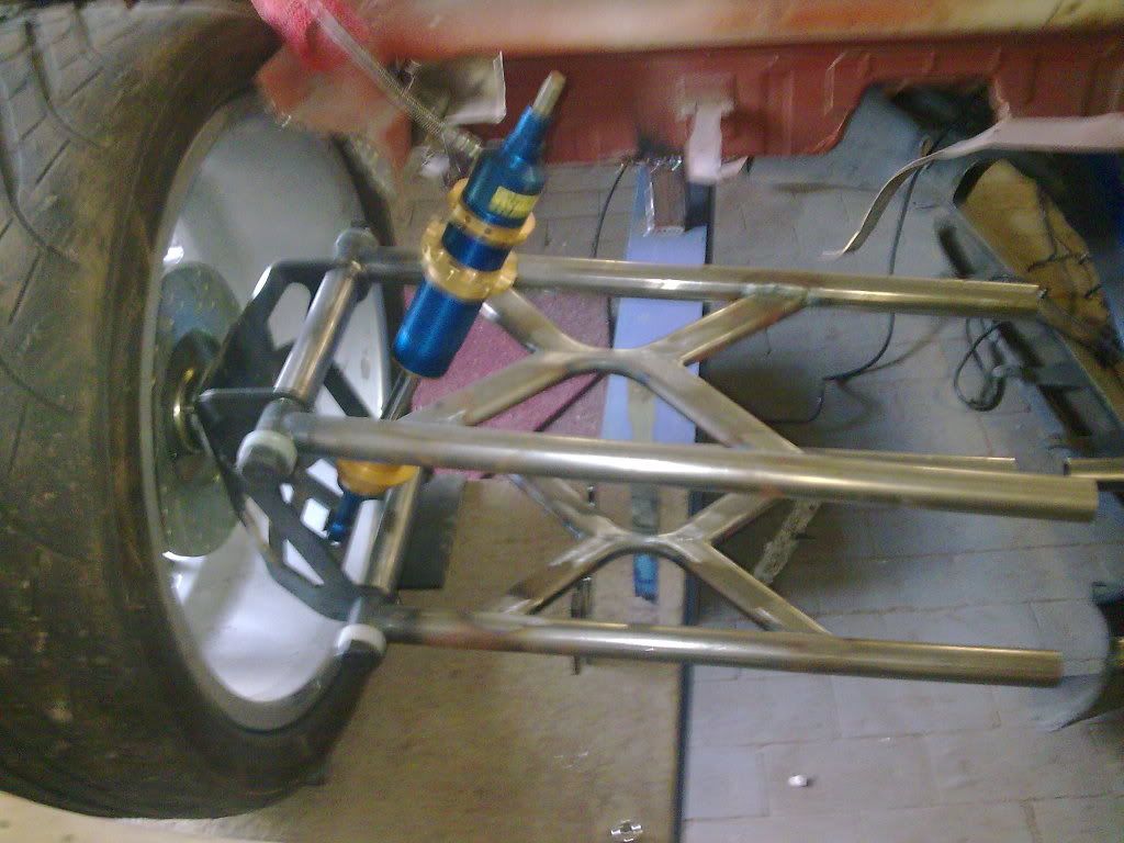

It was then time to make a start on the wishbones.
Started off by cutting 8 lenghts of the same CDS tube that we used on the stub axle carriers. We then profiled one end of each tube. I also parted off 8 32mm pieces of CDS to used for the bush housing.
I then welded the 32mm pieces to the profiled end of the tube:
http://i227.photobucket.com/albums/d...ndweldedon.jpg
No bush:
http://i227.photobucket.com/albums/d..._ed/endon2.jpg
Once all 8 were welded up i could press the nylon bushs in using the enerpac. These have to be aight fit as i donnt want the spinning in the housing.
Going in:
http://i227.photobucket.com/albums/d...hingbushin.jpg
Finished item:
http://i227.photobucket.com/albums/d..._ed/bushin.jpg
Now i have 8 complete bush housings and all the washers i could start making the bolts that hold the wishbones to the carriers. These all had to be made as sets so once the washers were matched up to the housing they had to stay with bolts. So i marked the washers and bushes to keep them in these sets.
I started off with 32mm high tensile bolts i then turned them down to match the inside dia of the bush and washer. The length of the turned down part is determined by the width of the washer and bush housing. The rest of the bolt was then turned down to acept an m12 thread. I dont have any pics at the min of the bolt un assembled, will get some later. Heres the bolt loosley assembled with the washer and housing into the carrier.
Once tightned up these are the pivot points for the wishbones/carriers:

The wishbones will probably need some fine tuning maybe even re-designing will have to see how they perform. In THEORY they will work...........
