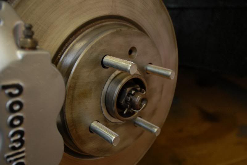

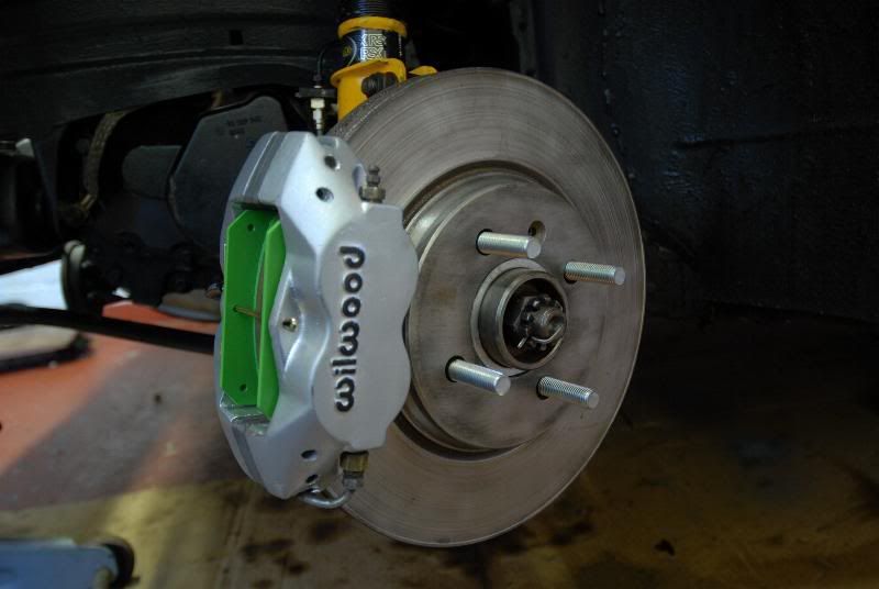

been out in garage for an hour, done bolt to stud conversion, with plenty of loctite thread locker! lol , fitted disk spiggot ringsfitted strut brace, finished off oil cooler, fitted filter and checked for leaks - none, and finally done other passenger side brake conversion
here are some piccies
studs and spiggots on/ in

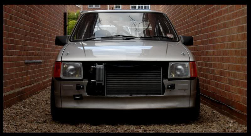

bumper and grill back on, plenty of air getting to oil cooler

can you not move the bracket on the oil cooler, and bolt to the other side of the slam panel? so effectivly it's inline with the rad?
may have to come you cutting a tiny bit of plastic out of the grill then?

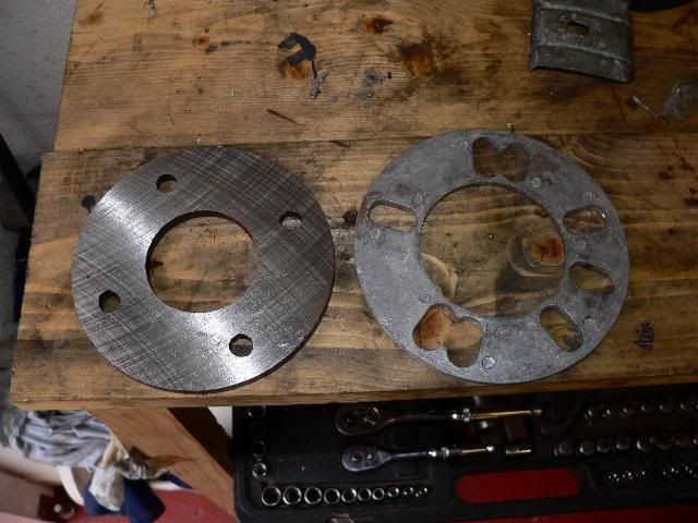

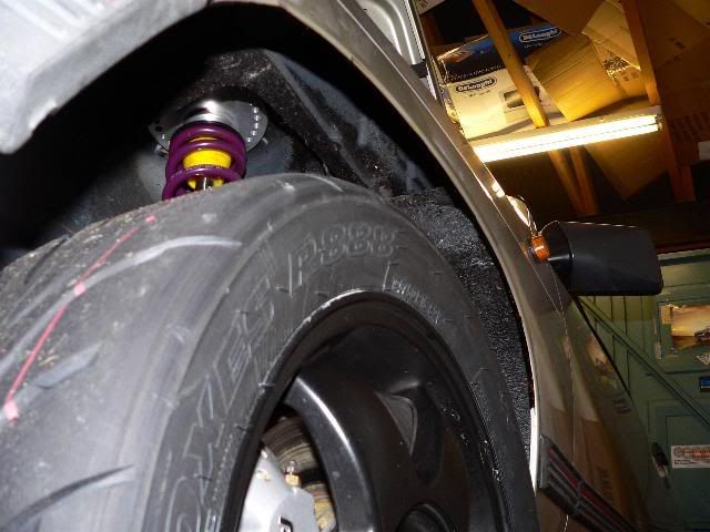

had some spacers made up for my wheels to replace the universal jobbies
http://i136.photobucket.com/albums/q...ure/nc0403.jpg
they're 7mm instead of 5mm, which gave me more brake clearance (but wasn't necessary)
but after a test drive, the front arches were catching too much and didn't want it raising anymore, so i put my 5mm's back on, to take them in all of 2mm (every little helps tho)

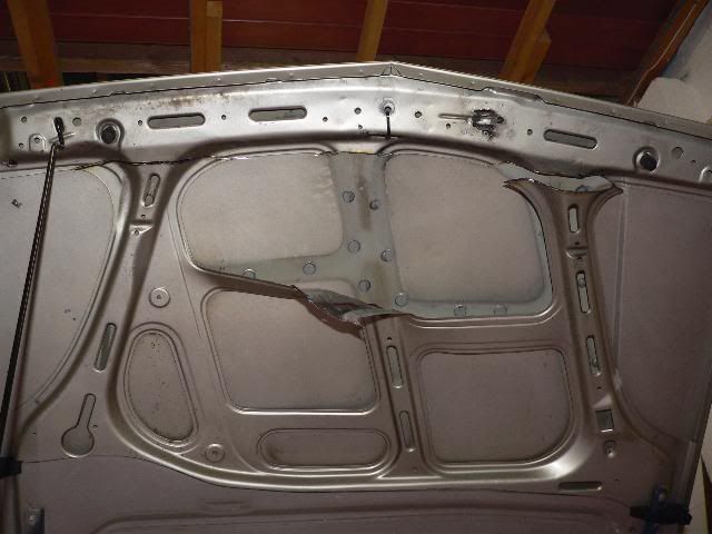

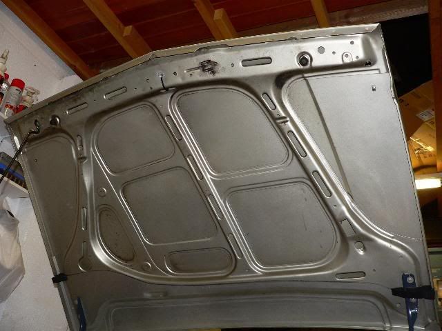

also done some more weight saving, completely removed front lips from the front wings
http://i136.photobucket.com/albums/q...ure/nc0399.jpg
and finally, until a cheap enough second hand fibreglass one comes up, more weight gone from the right place :)
http://i136.photobucket.com/albums/q...ure/nc0400.jpg
http://i136.photobucket.com/albums/q...ure/nc0401.jpg
http://i136.photobucket.com/albums/q...ure/nc0402.jpg
until next time folks
nice work chap :thumb:
lol extreme weight saving lol
still looks awsome though
Cut out the part which holds the latch and the bonnet pin, that bits will save quite a bit of weight.

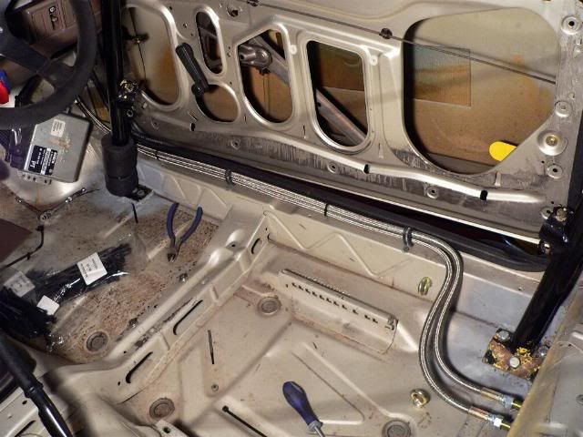

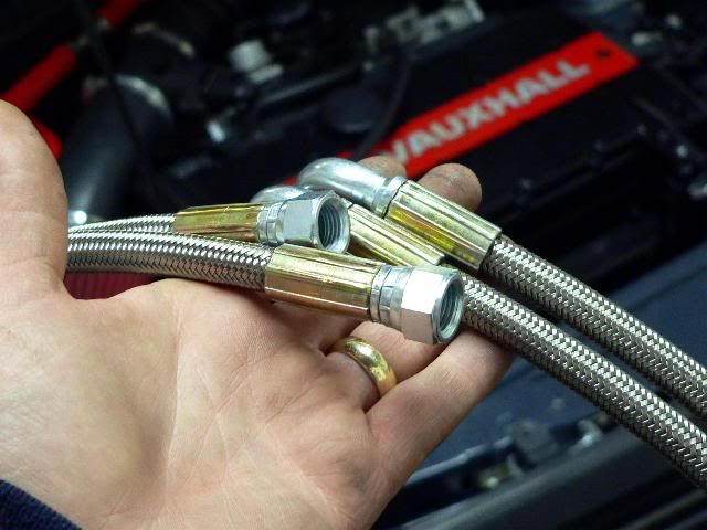

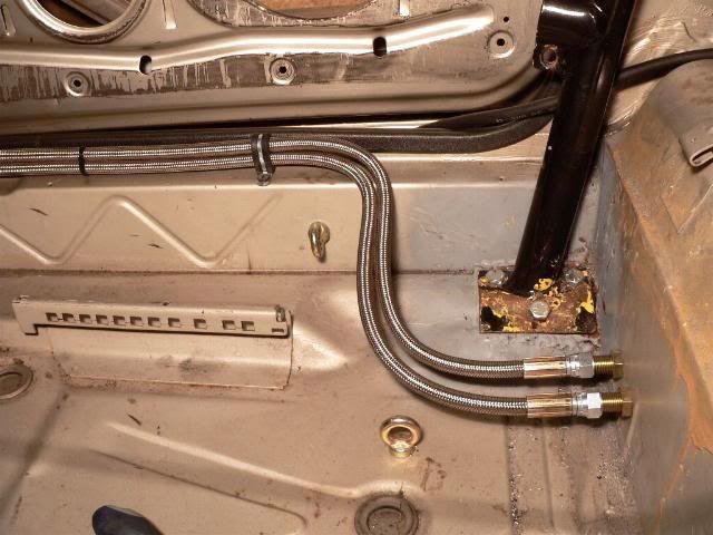

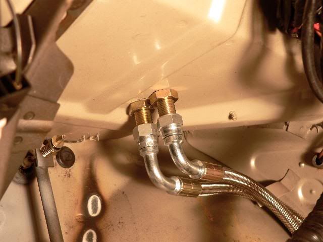

Firstly - big thanks to Dar for sourcing me some braided fuel lines so I could run them inside the car...
http://i136.photobucket.com/albums/q...ure/nc0404.jpg

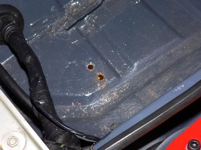

Holes in battery tray for feed & return
http://i136.photobucket.com/albums/q...ure/nc0405.jpg
Up inside the car (getting sprayed inside shortly)
http://i136.photobucket.com/albums/q...ure/nc0406.jpg
Entering the car behind the drivers seat (see above regarding spraying lol)
http://i136.photobucket.com/albums/q...ure/nc0407.jpg

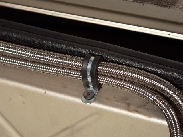

P-clipped to the inner sill
http://i136.photobucket.com/albums/q...ure/nc0408.jpg
Done diddly done
http://i136.photobucket.com/albums/q...ure/nc0409.jpg

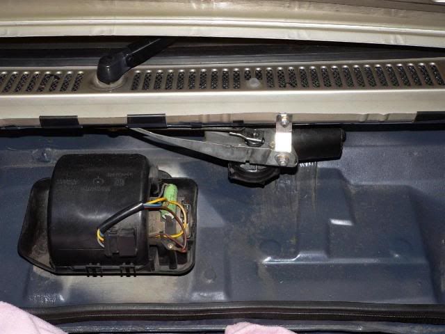

Last weekends work was to source a AX wiper linkage & motor, ended up scrapping the motor and using Nova one for easy of wiring, fits straight on the linkage with no alterations to be made... made up a supporting bracket to the scuttle panel so its well secure and a neat job
http://i136.photobucket.com/albums/q...ure/nc0411.jpg

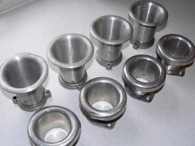

Complete firewall gone this time (left the wiper motor part in last time), in preperation for fuelling changes, and a nice set of shiney 90mms
http://i136.photobucket.com/albums/q...ure/nc0412.jpg
..shiney 90mms?

peester - 90mm trumpets :)

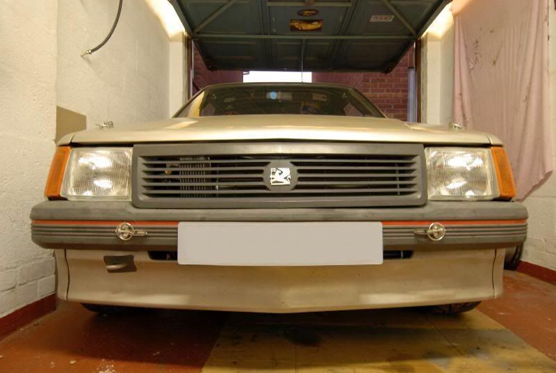

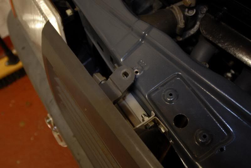

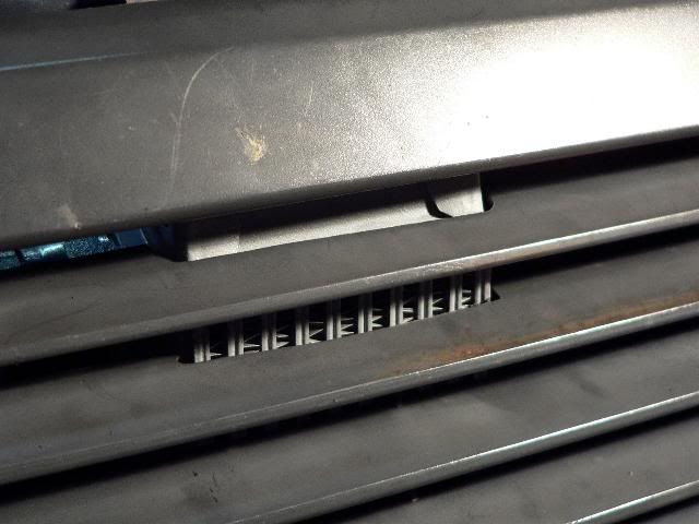

Anyway, finally finished off 'fettling' the grill to fit very very snug around my Mocal oil cooler, as i've decided against chopping the front panel out in favour for an alloy bar, neat job
http://i136.photobucket.com/albums/q...ure/nc0413.jpg
Pic of the wiper position, would sooner it lower down to be honest, but I'll do it when I have more time
http://i136.photobucket.com/albums/q...ure/nc0414.jpg

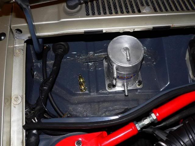

Fuel Swirl pot setup and installed, just need a couple of bits to actually get it running, loom hidden to junction box, and extended to heater blower to allow the rest to be hidden
http://i136.photobucket.com/albums/q...ure/nc0415.jpg

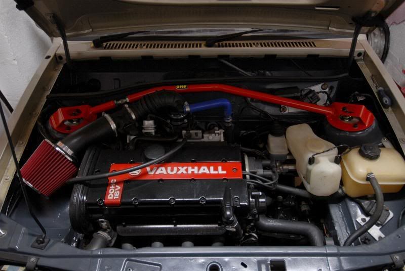

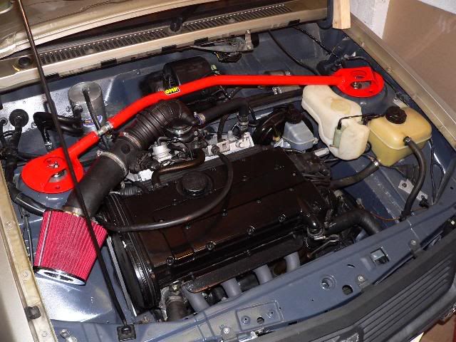

And just for Keith - flat/ black plug cover... next up for the black paint is the strutbrace!
http://i136.photobucket.com/albums/q...ure/nc0416.jpg

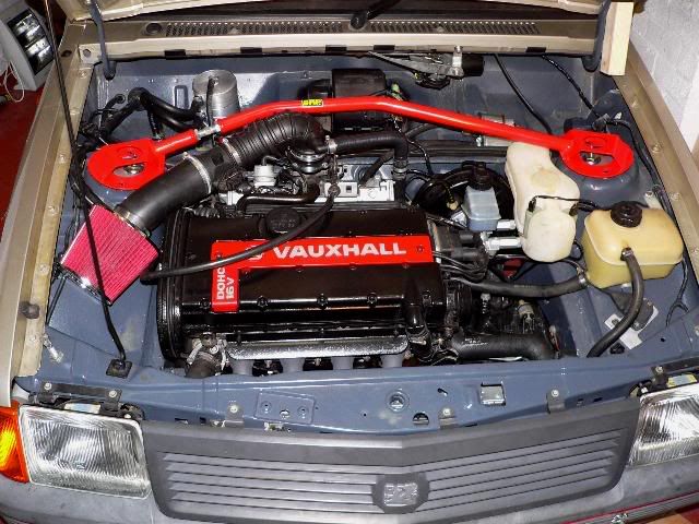

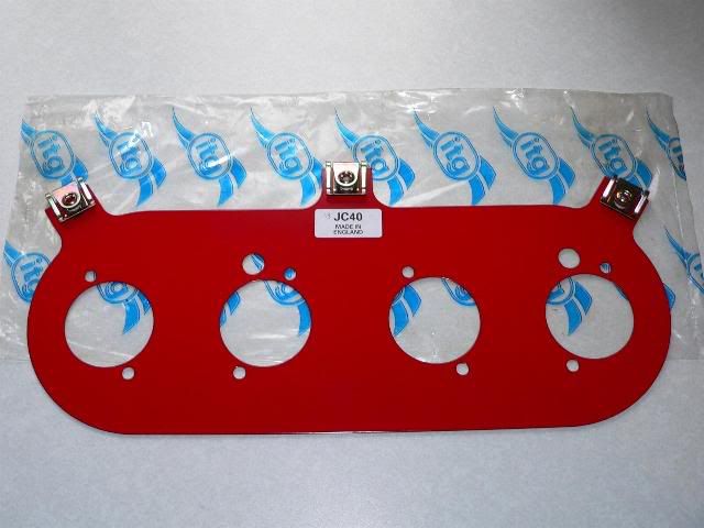

Putting the red plug cover back on now, as some bits I've been buying are red - which I don't want to change the colour of, so I guess that'll be my 'theme' - Black & Red

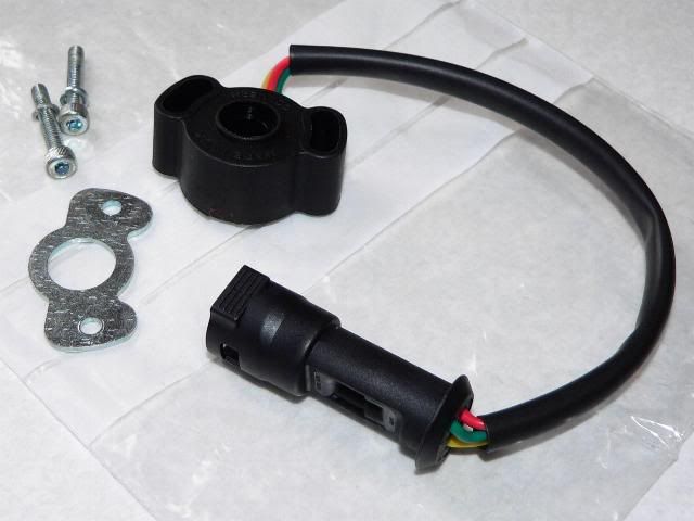

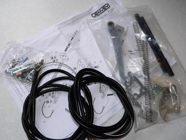

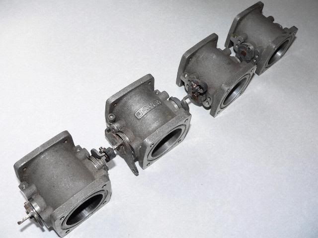

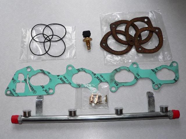

The other red bits in my engine bay, which I collected today are:
http://i136.photobucket.com/albums/q...ure/nc0417.jpg
http://i136.photobucket.com/albums/q...ure/nc0418.jpg
http://i136.photobucket.com/albums/q...ure/nc0419.jpg
http://i136.photobucket.com/albums/q...ure/nc0420.jpg
http://i136.photobucket.com/albums/q...ure/nc0421.jpg
http://i136.photobucket.com/albums/q...ure/nc0422.jpg
http://i136.photobucket.com/albums/q...ure/nc0423.jpg
http://i136.photobucket.com/albums/q...ure/nc0424.jpg
http://i136.photobucket.com/albums/q...ure/nc0425.jpg
http://i136.photobucket.com/albums/q...ure/nc0426.jpg

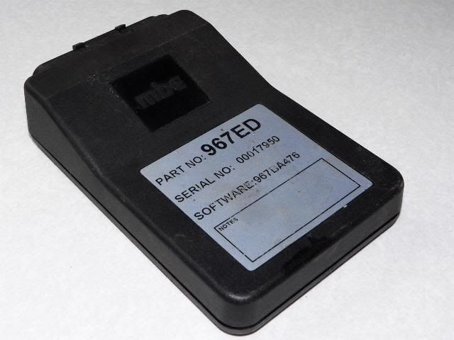

Jenvey 45mm Tapered Throttlebodies with MBE967 ECU, loom and all the other gubbins - yay!
