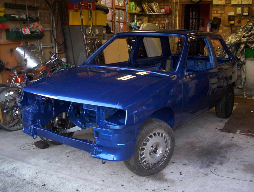

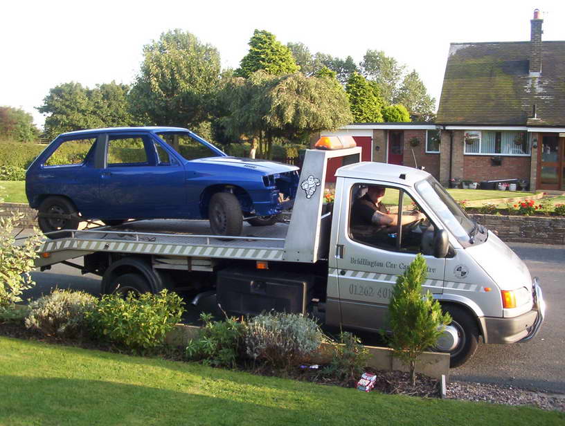

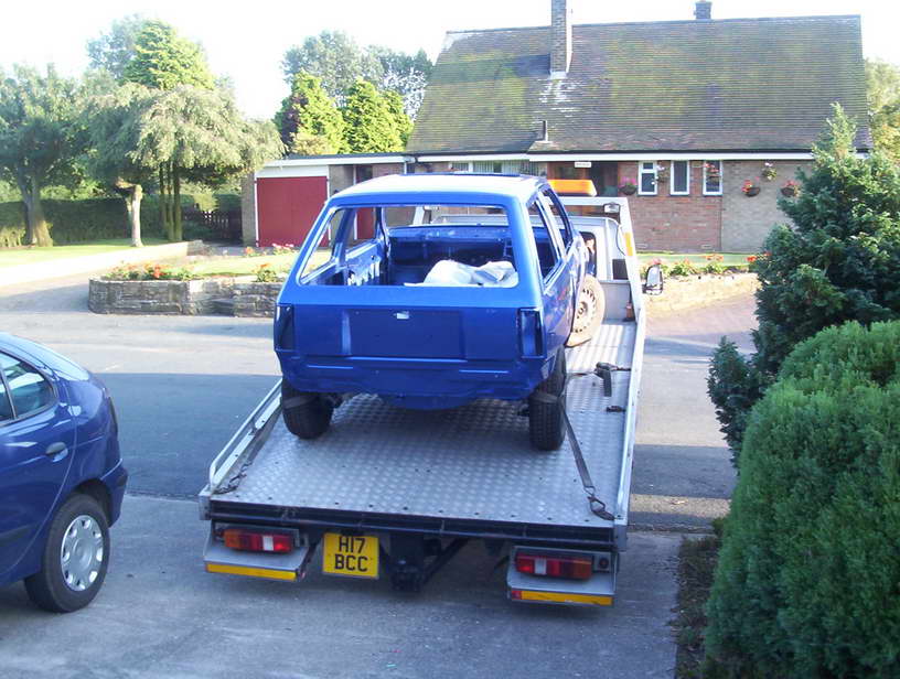

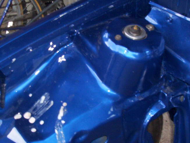

Well I've been able to take delivery of the shell tonight and she's now sitting in my garage -
its been flattened and mopped - just needs another cut and polish to get it gleaming!!!

Next job is sound proofing then waxoyling everywhere!!
Joff
let the rebuild commence. this is one nova im looking forward to seeing
was going to say make sure you waxoil under the arches and under the floor, paited chassis looks good but wont last long on an everyday car,
cant wait to see how your going to finish this car off now,
excellent glad to see you've finally had her back.

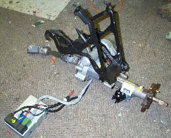

- wired in the EPAS power steering

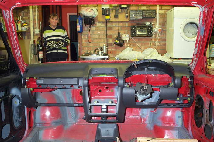

Been doing a bit more work to the shell this week - I've finished all the sound proofing and
interior waxoyling (thank goodness it stinks!).
I've now put the first fix in for the wiring loom :-
http://www.elsamak.karoo.net/loom3a.jpg
As you can see I have also put in the pedal box and have also attached the servo on the otherside :-
http://www.elsamak.karoo.net/Bay1a.jpg
