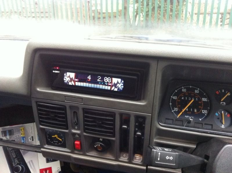

Finished fitting me head unit in the nova, got all the wiring tucked into the smallest of spaces (theres bugger all room on a mk1 :cry:) got the cage in, squeezed it home and rebuilt the dash :d
Also took it our for a drive for an hour or so as its still missing for a bit, i think something must be damp/not liking lack of use, as its fine after about half an hour of driving :thumb:
