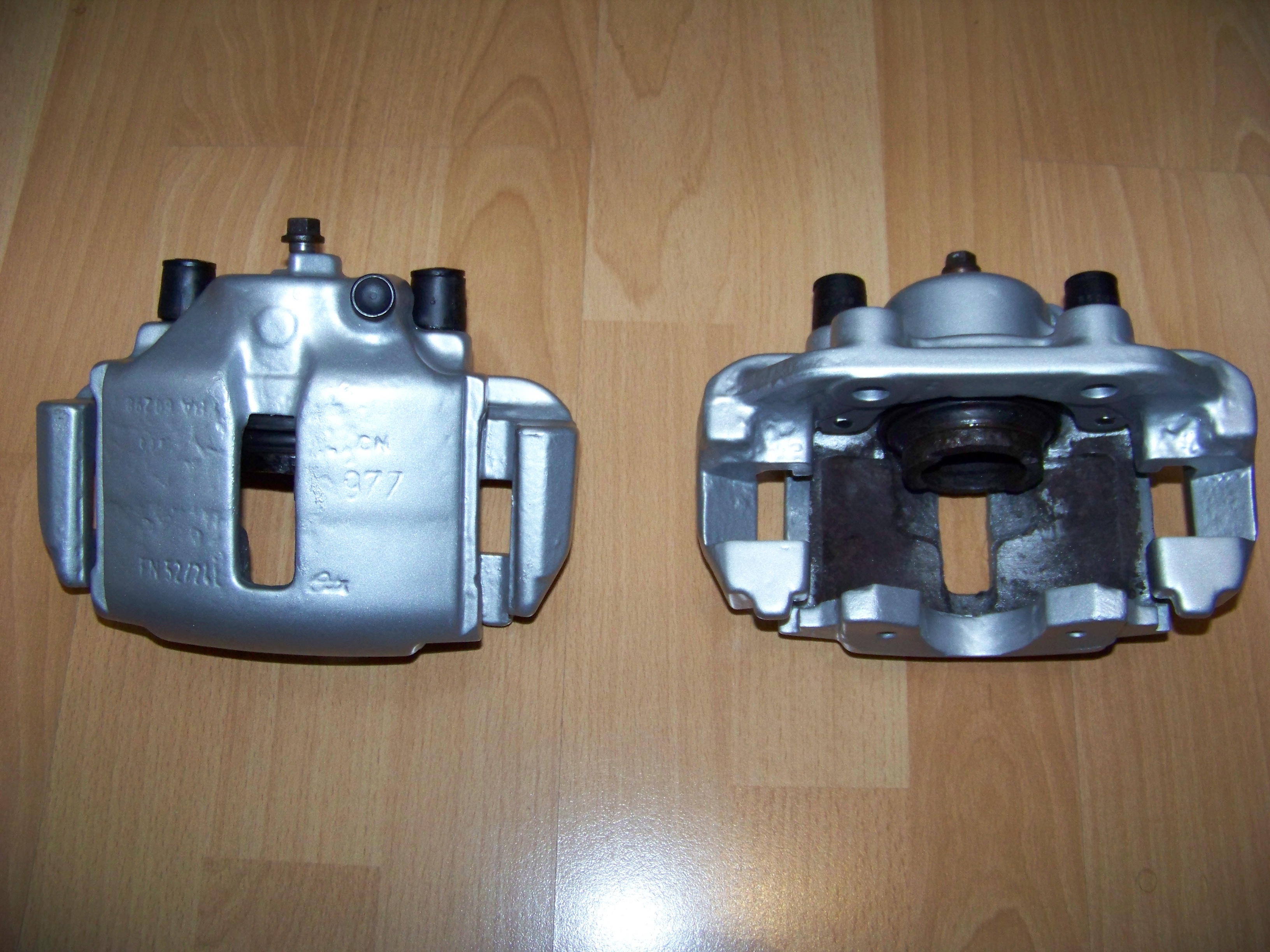

I decided to refinish the calipers I painted a while back. This time I painted them in Hammerite silver just to give them the 'new' feel.
https://images2.imgbox.com/cc/78/RhelO1q8_o.jpg
https://images2.imgbox.com/84/3b/6YRlEm3j_o.jpg
I left those to dry. Once dried off, I'll be fitting the caliper refurb kit.

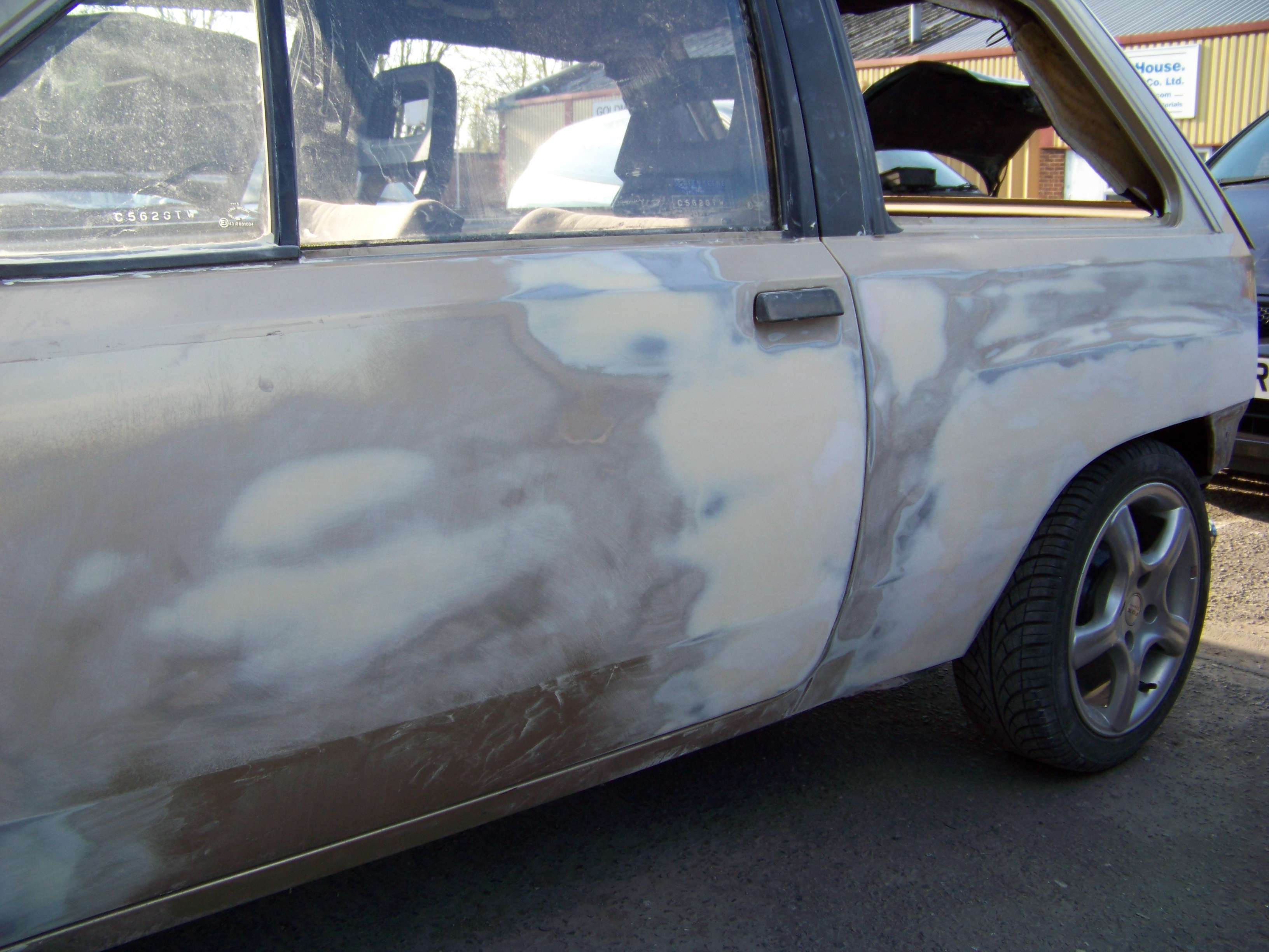

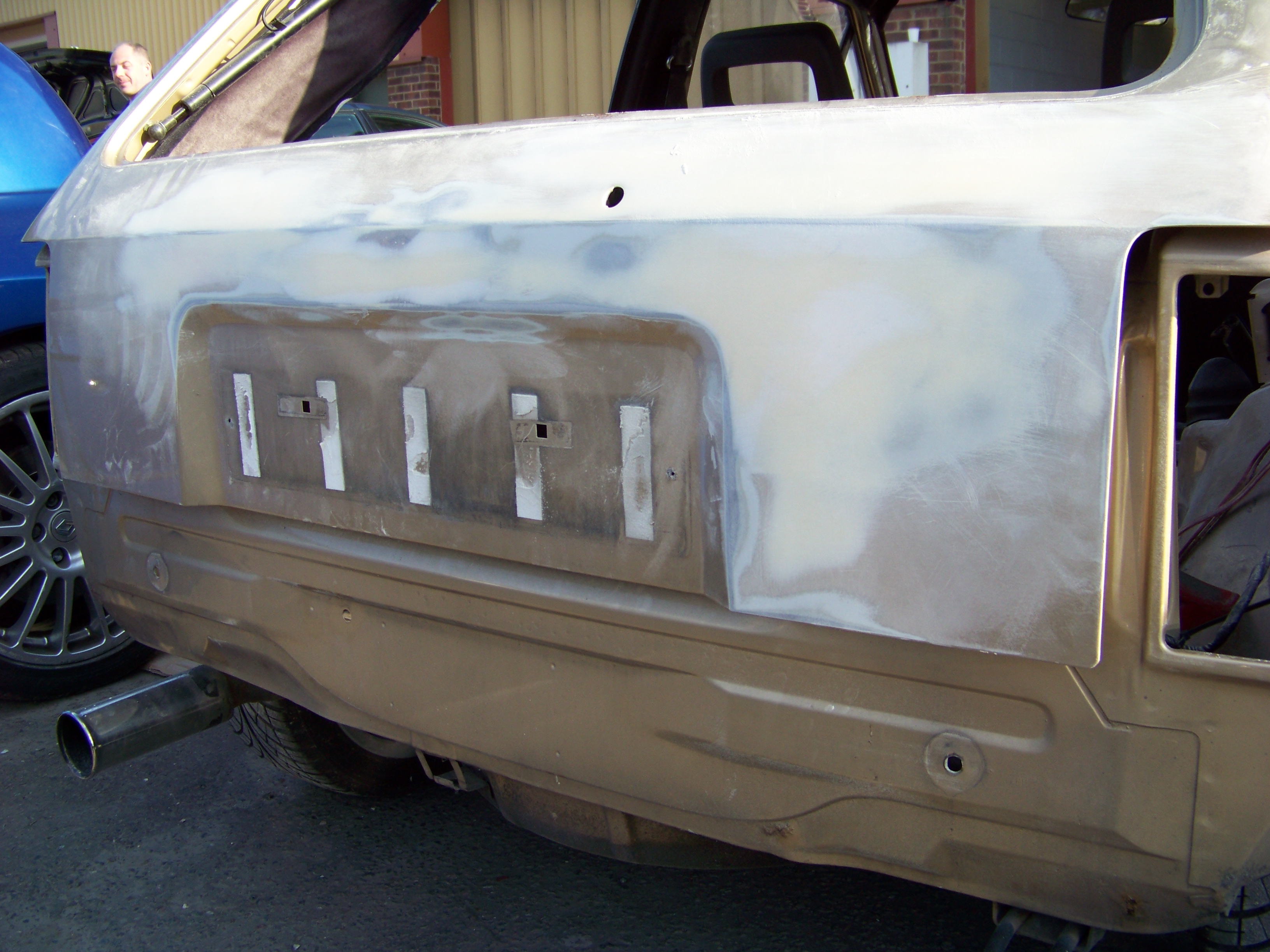

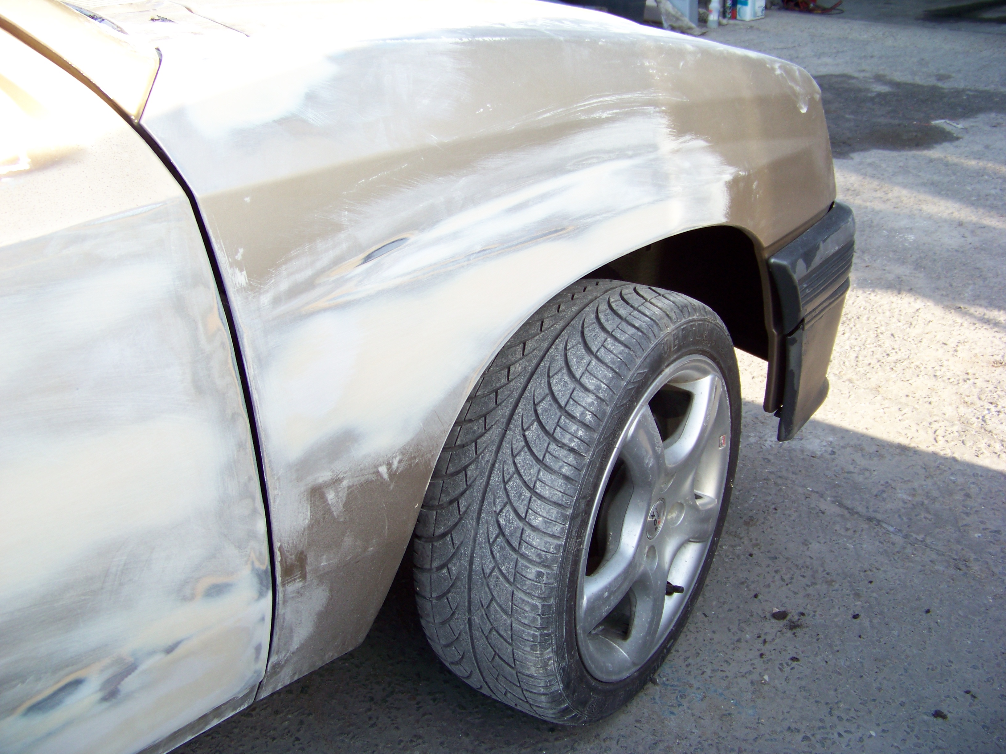

Made my way to the bodyshop again, as you'll have noticed I go there everyday now as things have started picking up. They had applied stopper to the fillered areas
https://images2.imgbox.com/d3/fe/0imDlrPX_o.jpg
https://images2.imgbox.com/47/57/8ADMG3oS_o.jpg
https://images2.imgbox.com/db/75/2skREsyl_o.jpg
https://images2.imgbox.com/80/58/ZI1Mw2V7_o.jpg
https://images2.imgbox.com/9a/b6/SIcPJLch_o.jpg
https://images2.imgbox.com/fd/3b/cKXVAK0l_o.jpg
https://images2.imgbox.com/e6/53/lKjimHCC_o.jpg
Then they rolled it in the shop and continued to machine it down.
https://images2.imgbox.com/d4/e2/zMS2UmLD_o.jpg
https://images2.imgbox.com/6d/12/ueGk1nCG_o.jpg
Left the chaps to it. All the glass will be coming out for the body to be properly machined down smooth. The current paint has aged quite badly so will need a good rub down to prepare it for primer.

A tiny one for now. Weather is, for want of a better word, sh*t! So I grabbed the calipers from the garage as they are now dry, again, and brought them indoors.
I started fitting final bits of the refurb kit. TBH this was a piece of pish, just a load of rubber bits. Inserted the rubber guide bush, greased up the guide bolts and slid it into place and fitted the guide bush dust caps. I then fitted the rubber bleed nipple cap (very important bit as the bleed nipples were full of crap when I got the calipers).
Done the other one and hey presto.

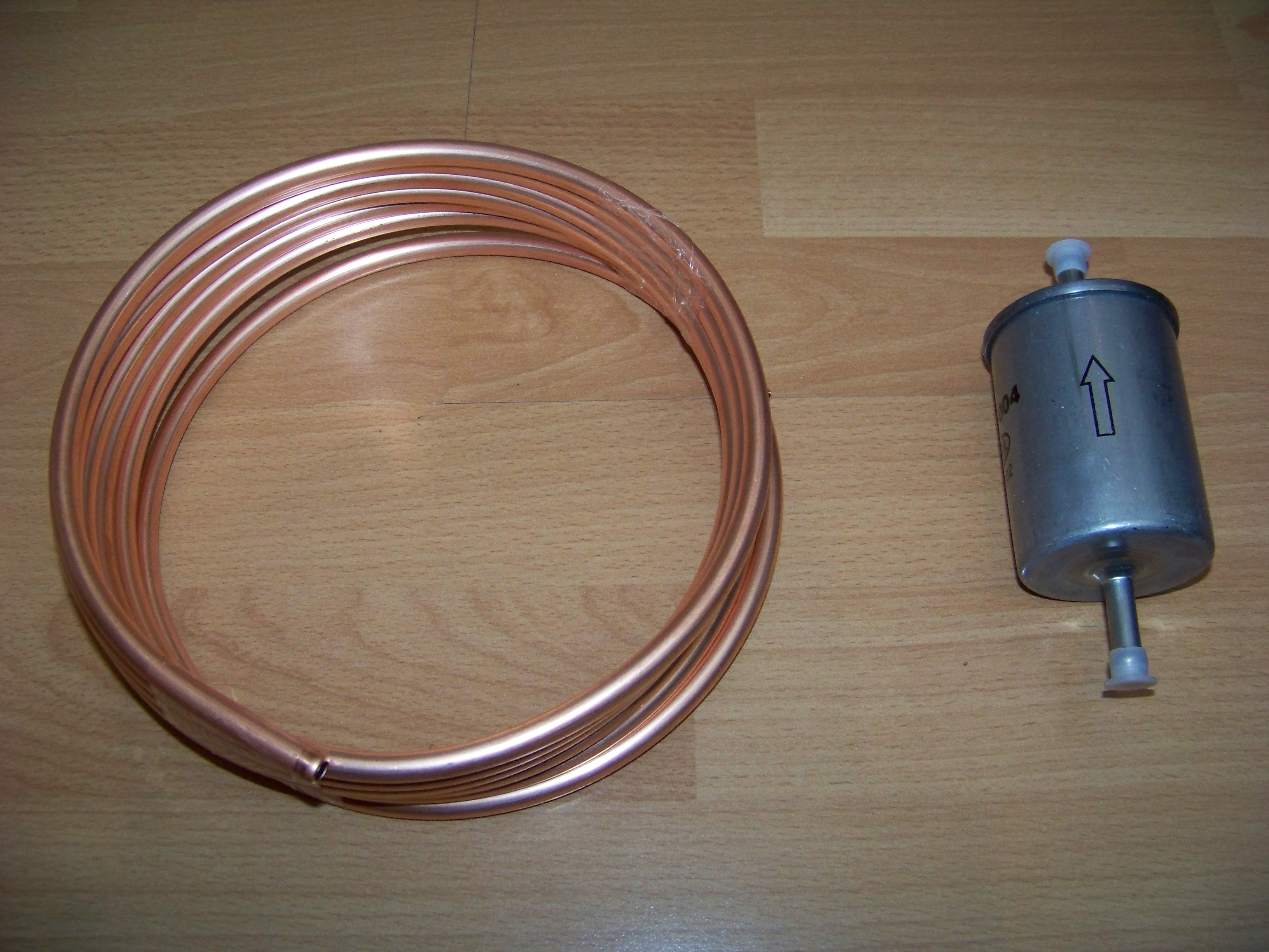

As I was finishing that off the postman arrived and I got my fuel filter and 4m of 8mm copper pipe for a bargain price off eBay, all for £15.
https://images2.imgbox.com/8c/ba/jtlIAcQt_o.jpg
http://img704.imageshack.us/img704/3893/1000712r.jpg

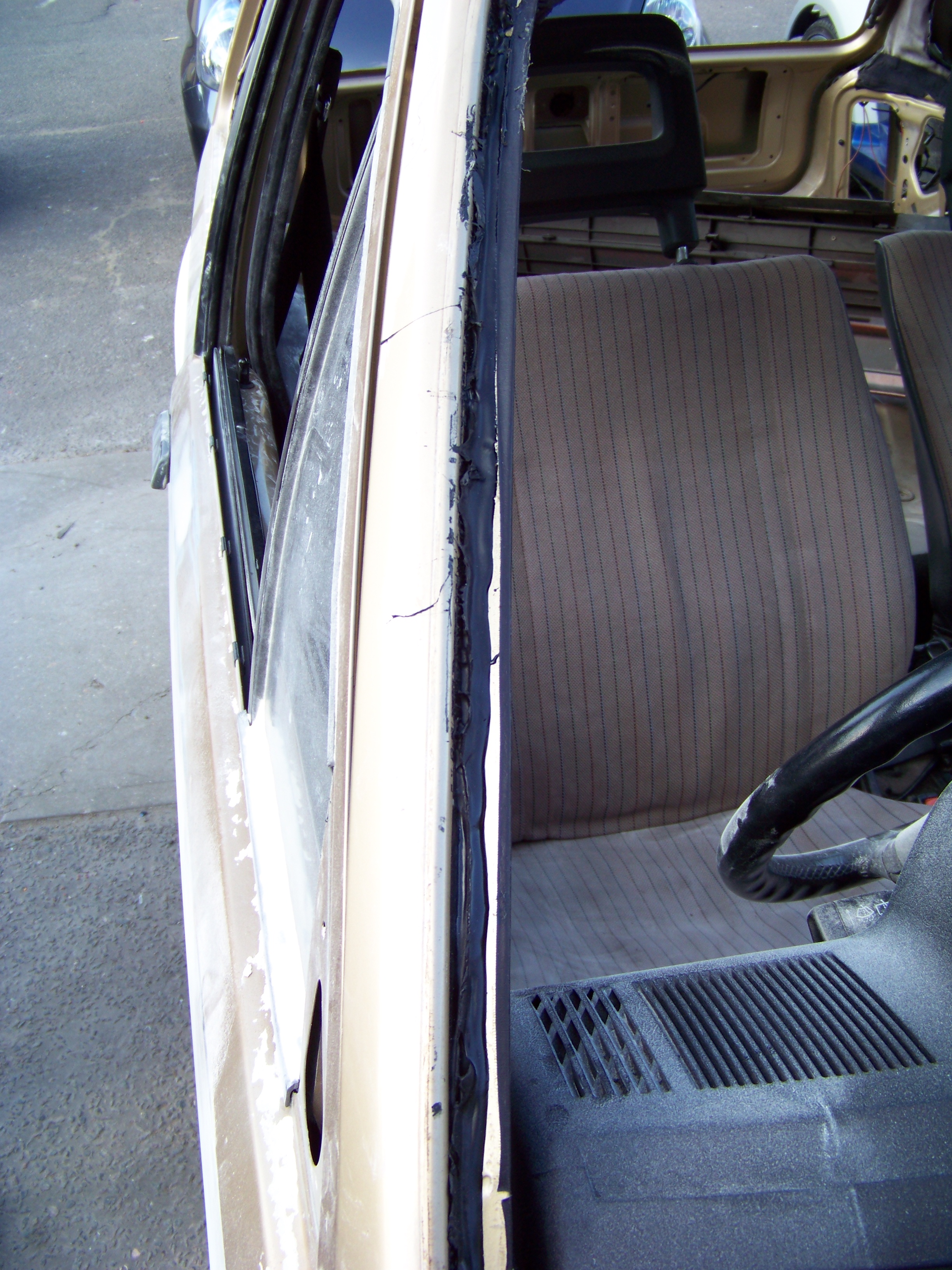

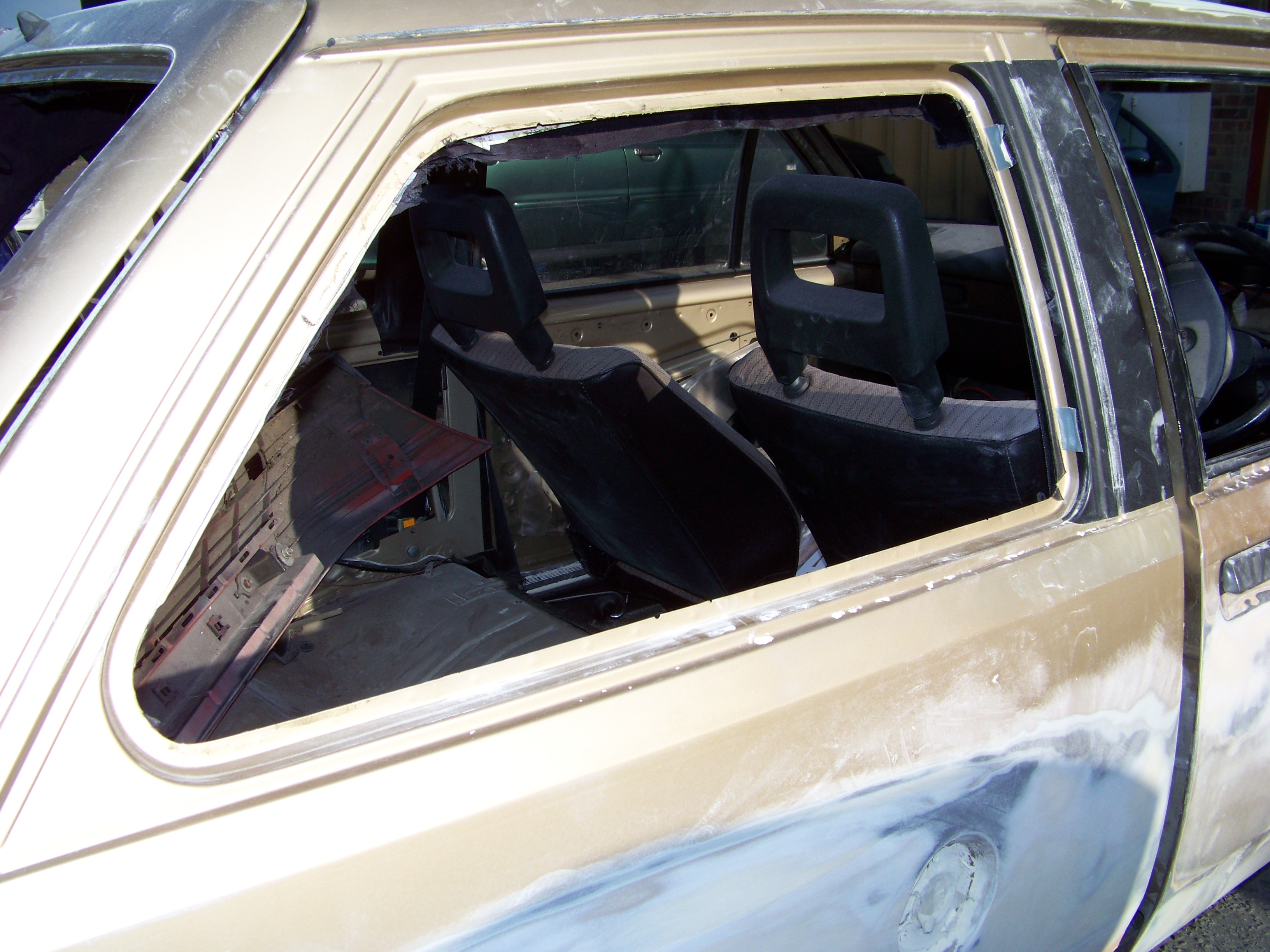

Went down to the shop and one of the guys was removing the side windows. He then moved on to the rear and front screen. I was able to give him a hand with him in the car and me outside. Got all the glass back into my bros car to take home.
Here's some pics of the windows removed.
https://images2.imgbox.com/0c/83/9qn2D9hp_o.jpg
https://images2.imgbox.com/b7/ac/msEQntYb_o.jpg
^ Only a tiny weenie bit of surface corrosion at the bottom of the boot under the windscreen rubber.
Thought I'd take a pic of the front screen sealant, It was some major sticky stuff and was still soft. I assume it's the same stuff as what Ricky recommended, non curing.

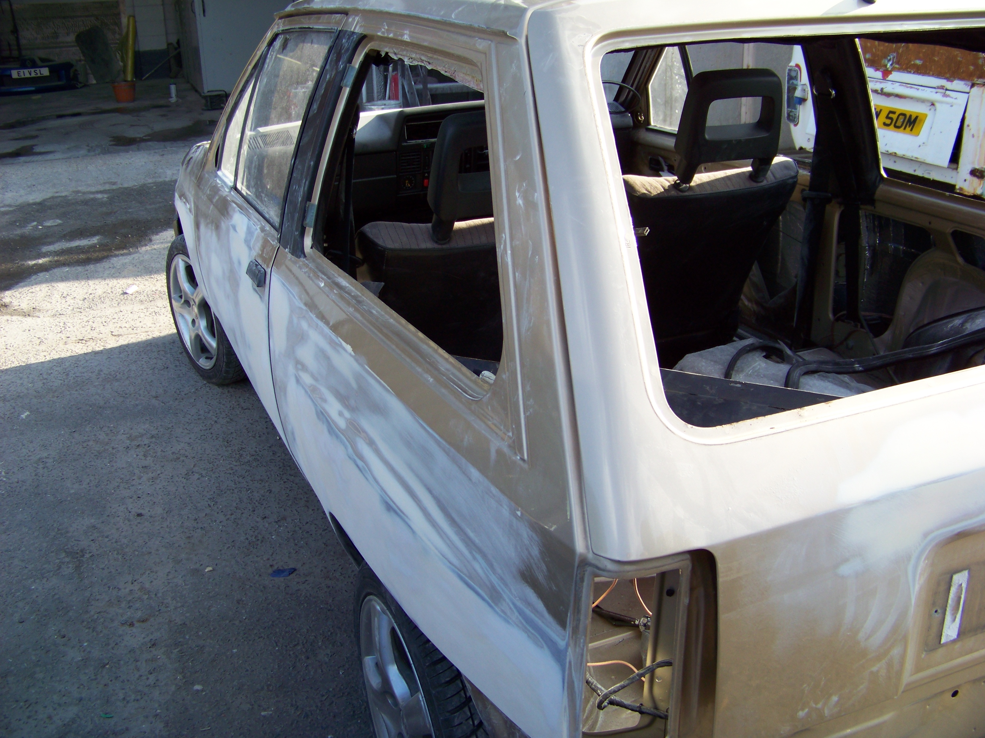

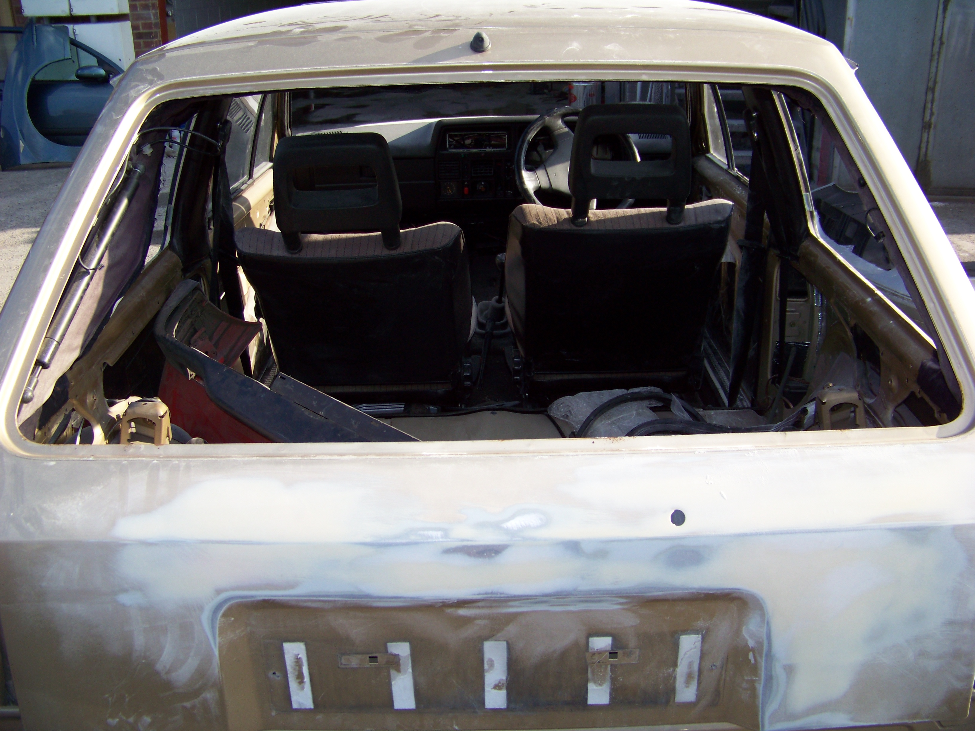

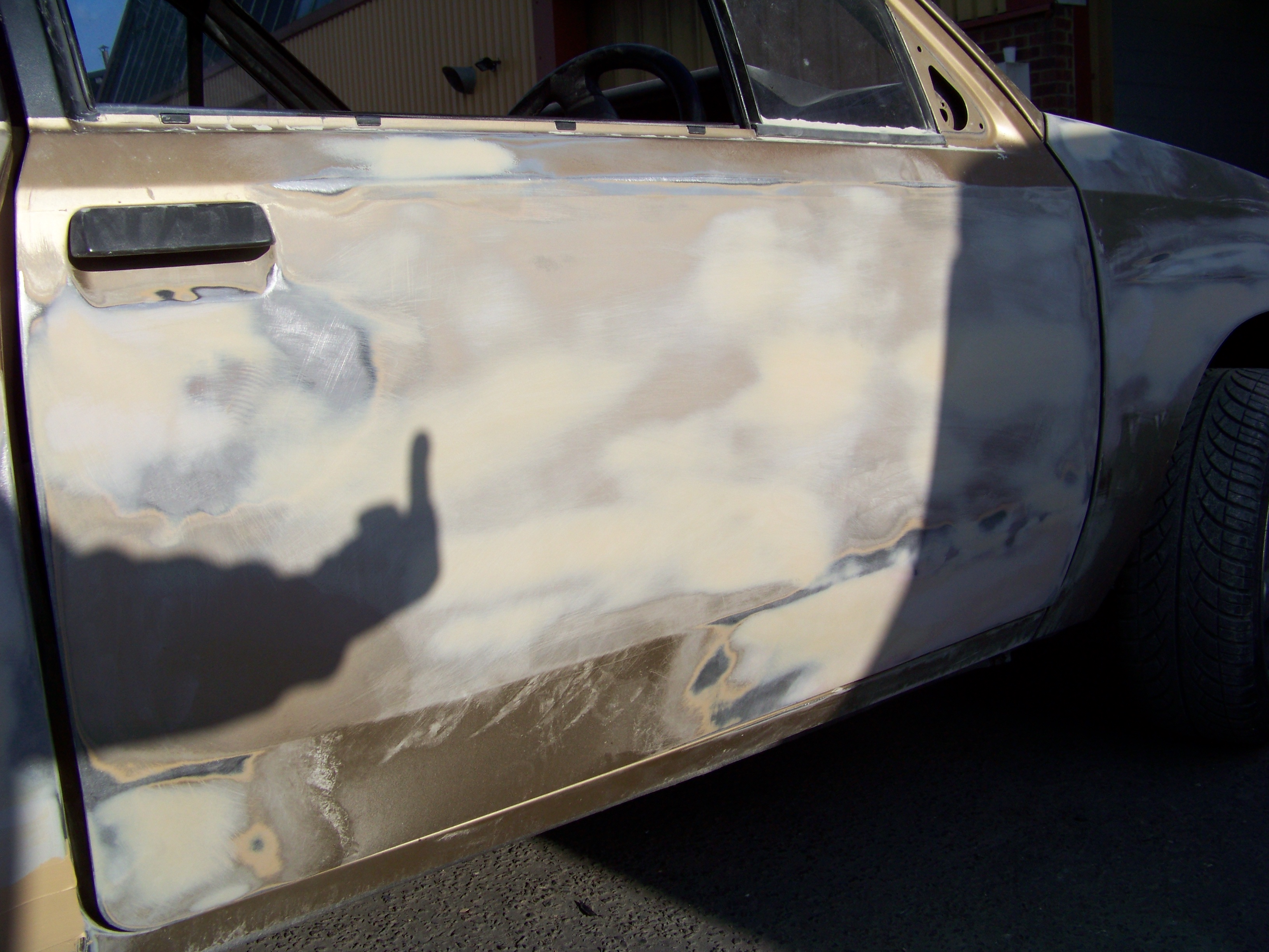

Here's some quick pics of the stopper smoothed over from yesterday
https://images2.imgbox.com/42/24/7od5FSBA_o.jpg
https://images2.imgbox.com/09/ff/y0qxaOtk_o.jpg
https://images2.imgbox.com/8a/0e/vdcMiH7h_o.jpg
https://images2.imgbox.com/80/5f/GlVeVBla_o.jpg
https://images2.imgbox.com/b9/84/cTgksIeF_o.jpg
https://images2.imgbox.com/33/7e/BgFeVpnD_o.jpg
https://images2.imgbox.com/e9/d9/FE00yVpk_o.jpg

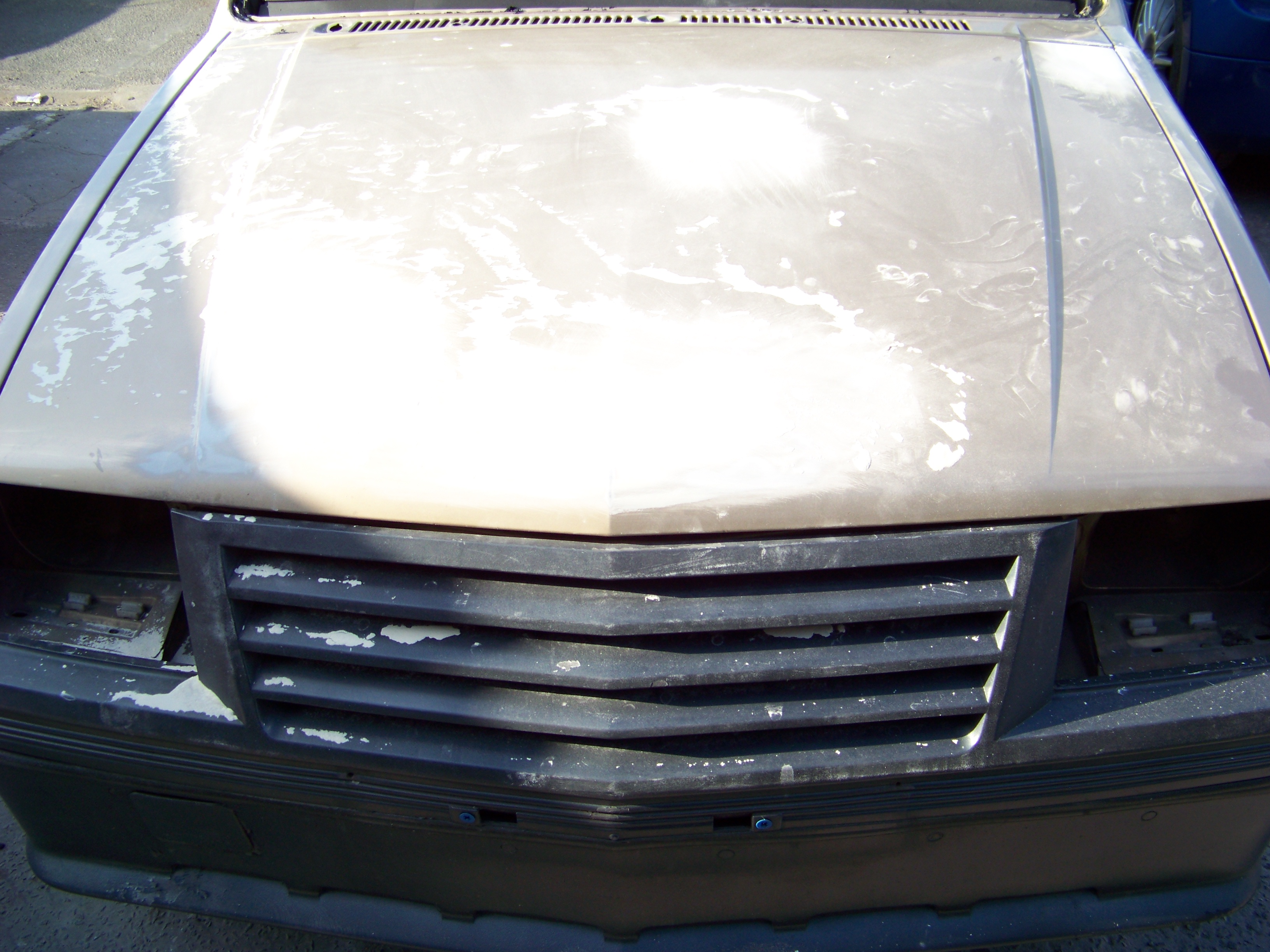

As the windows have been removed the car will be thoroughly DA'd smooth. The snowplough will be removed too, ready for some primer.

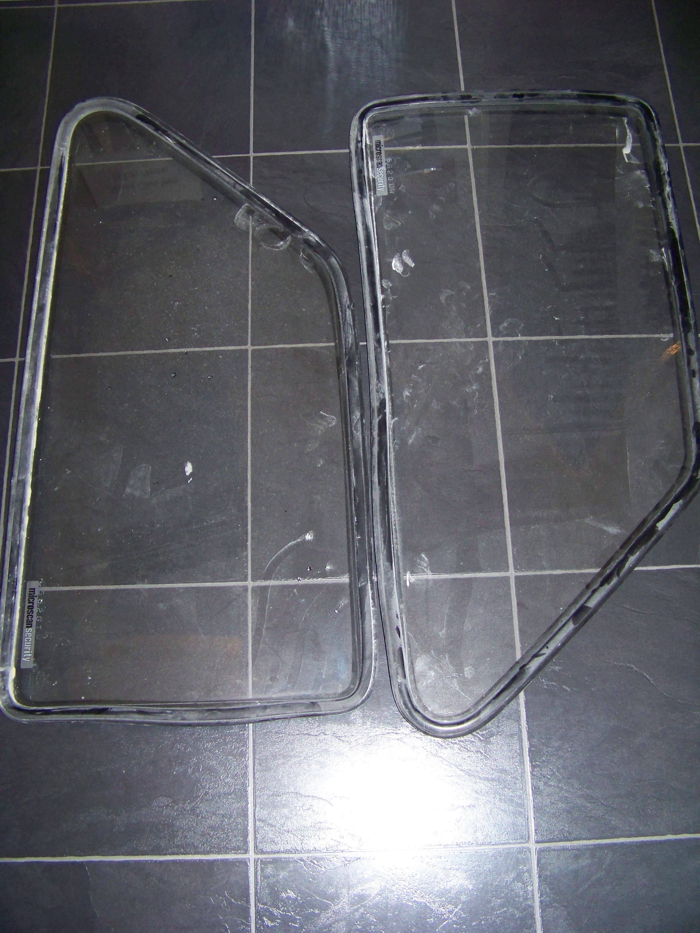

Jumped back in the Cav with my bro and come home. Unloaded the glass into the kitchen, really don't have much room in the house now.

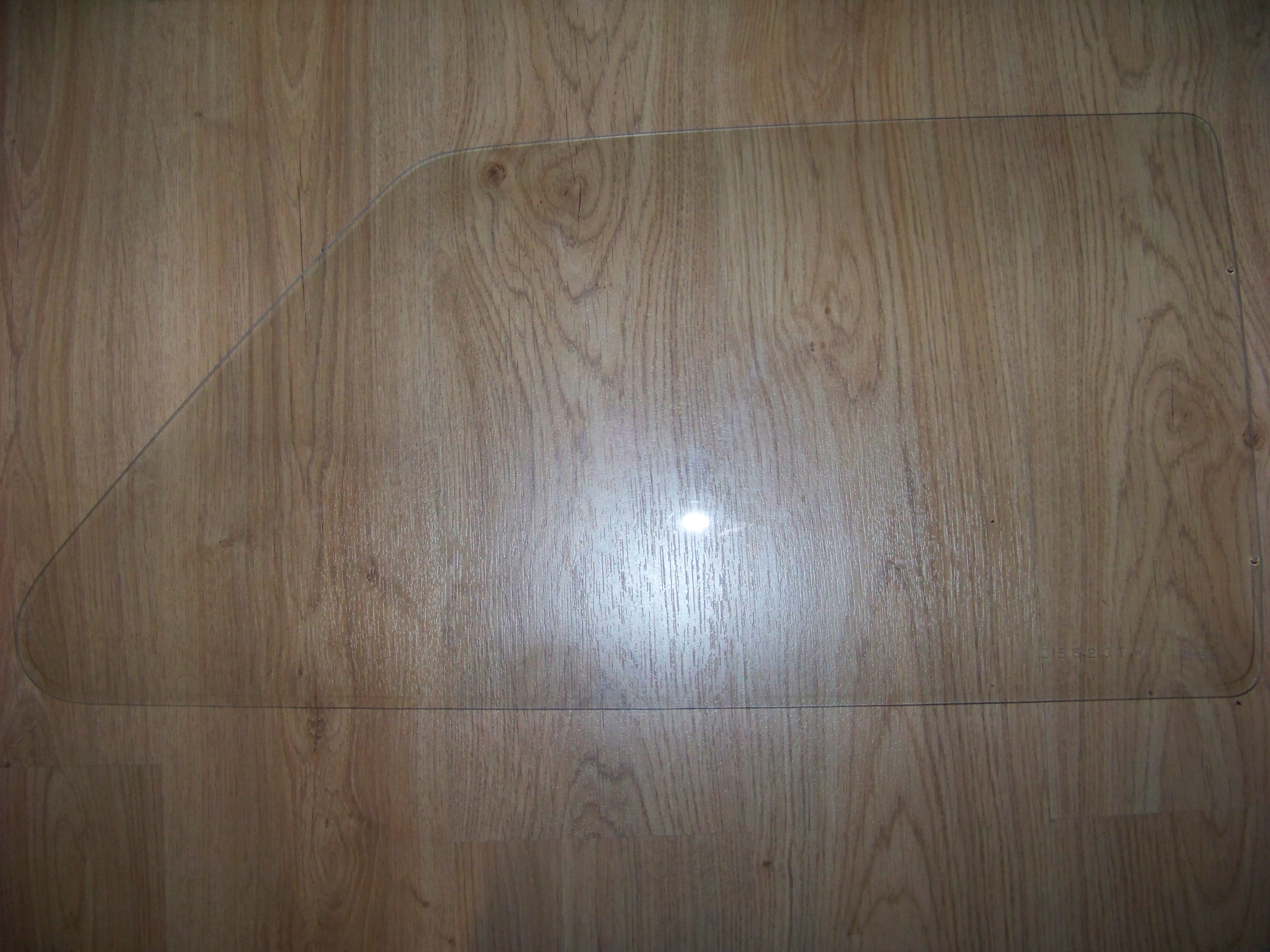

Started to clean them up.
Rear side glass as they came out
https://images2.imgbox.com/54/47/nLWzSd5n_o.jpg
After a bloomin' good clean with hot soapy water and then glass cleaner using microfibre cloth
https://images2.imgbox.com/1d/31/U5jF9PUb_o.jpg
Problem I had was tryna remove all the roughness from the exterior part of the glass. Seems to be a lot of grime/dirt fused to the glass. Need to try get all that off. I have some pvc/glass polish (ultra fine abrasive) from Halfords or Autoglym Glass polish. Wondering what one to use.

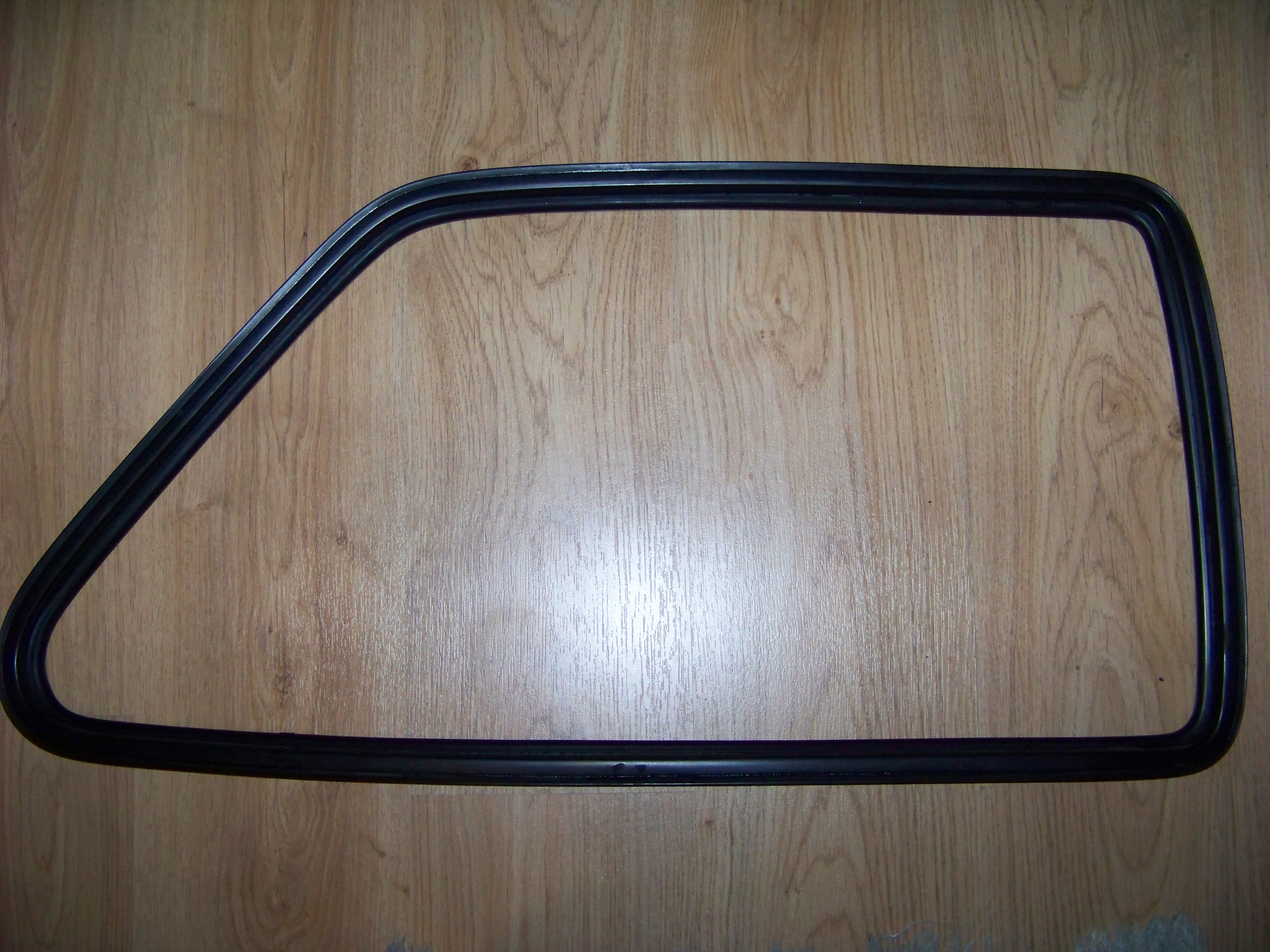

I took the rubber and gave that a good clean using hot soapy water. They came out a right treat, look almost new. All the rubbers look very good and strong. May go invest in some rubber spray to help nourish and soften them a bit.
https://images2.imgbox.com/a2/f1/hFqDdEfS_o.jpg
I started cleaning the rear heated screen but my arms were totally aching. Left that for a bit and will resume a bit later. Will also be cleaning the front screen rubber to fit around my heated front screen.
As the glass is out I'm really thinking about fitting the tints I got a while back. It's super light smoked and all my glass is totally untinted clear too, so it won't look silly at all imo.
t-cut should take the dirt of the glass. if it still wont budge you can use a brand new stanley blade sideways as a scraper.
Cheers Brains, will give that a go. Some seriously tough stuff on the glass.
lol at the shadow puppet!
i thought he was pointing to another dent lol (joke)Quote:
Originally Posted by maddogdaz666
lol was waiting for someone to spot that
