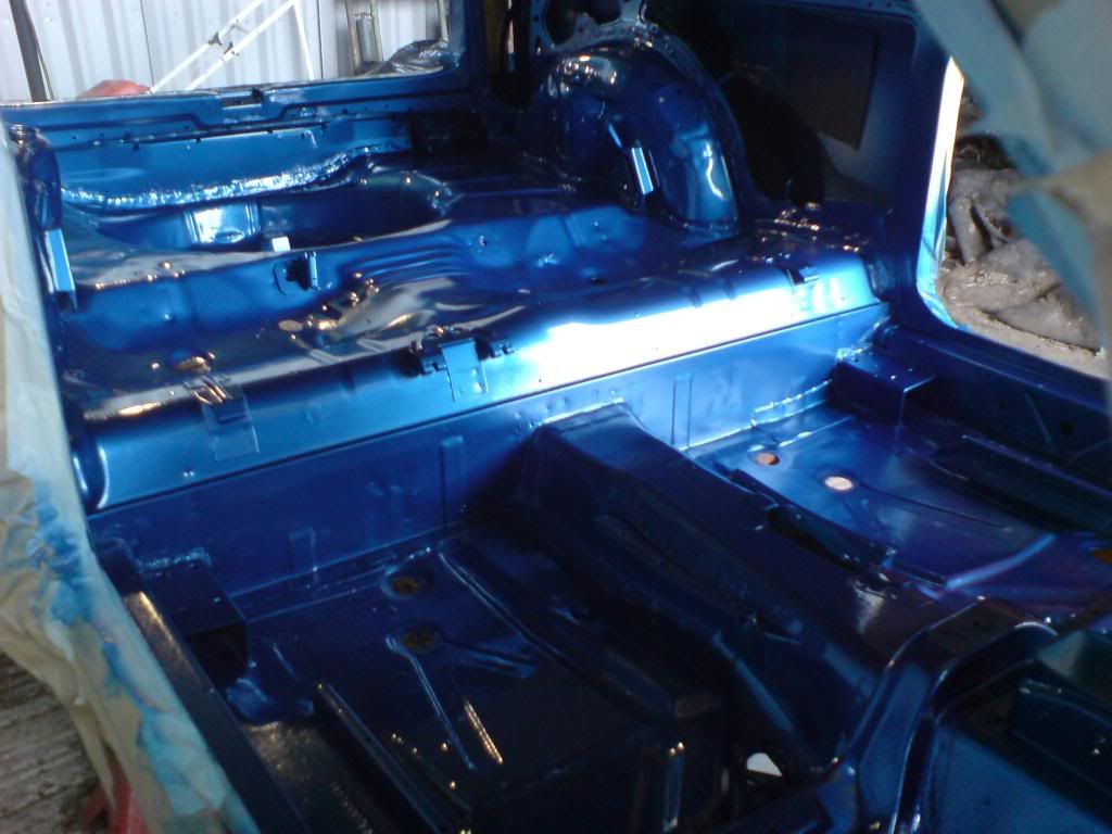

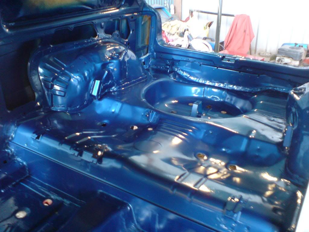

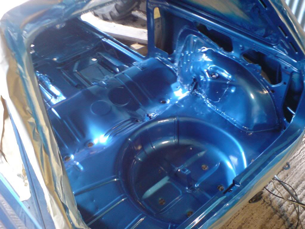

todays progress----
today i set about spraying the paint and laquer to the inside of the car.
mixed the paint to the correct ratios then gave the inside 3 coats of subaru sonic blue (world rally blue or 555 blue).
let this flash off then i applied my laquer. gave it around 5 coats. im quite impressed with the finish i got considering the sprayer i was using and im no professional painter. the conditions didnt help either but it will do.
sorry for the bad pics.

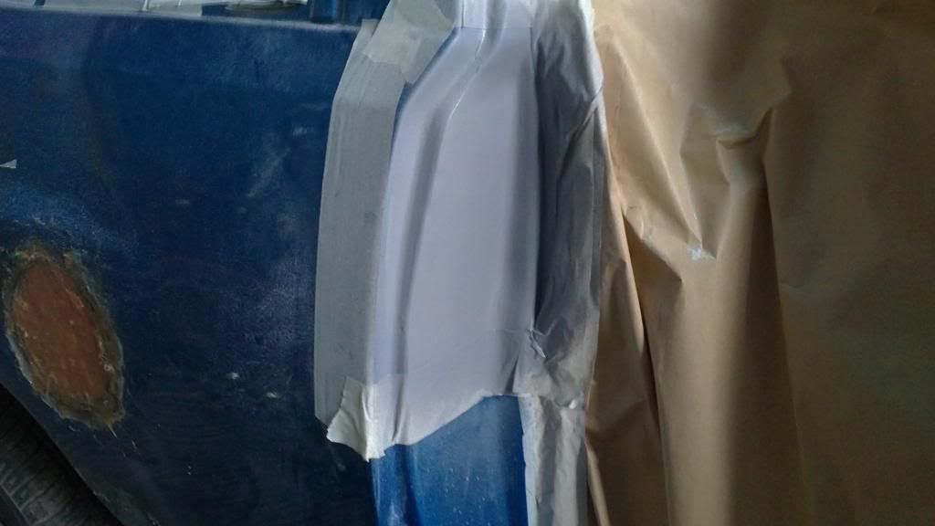

i then made a plate to weld to the inner part of the recess. then a larger plate to smooth the bodywork over. welded these in and ground down the welds. just got to fill it out now with fibreglass and filler.
http://i193.photobucket.com/albums/z...8/DSC00024.jpg
decided on option 3.
so i fabricated a plate to fill out where the vent would go, will weld this in tomorrow and drill out the hole for the cap.
http://i193.photobucket.com/albums/z...8/DSC00021.jpg

Inside looks mint now that it's been painted. :thumb: I like the fuel filler in the door but it's a bit inconvenient. Slowly taking shape.
this is class mate will look bang on! Good work any way mate!
thanks tek, yeh it is a tadge, but at least the outside will look a lot smoother.Quote:

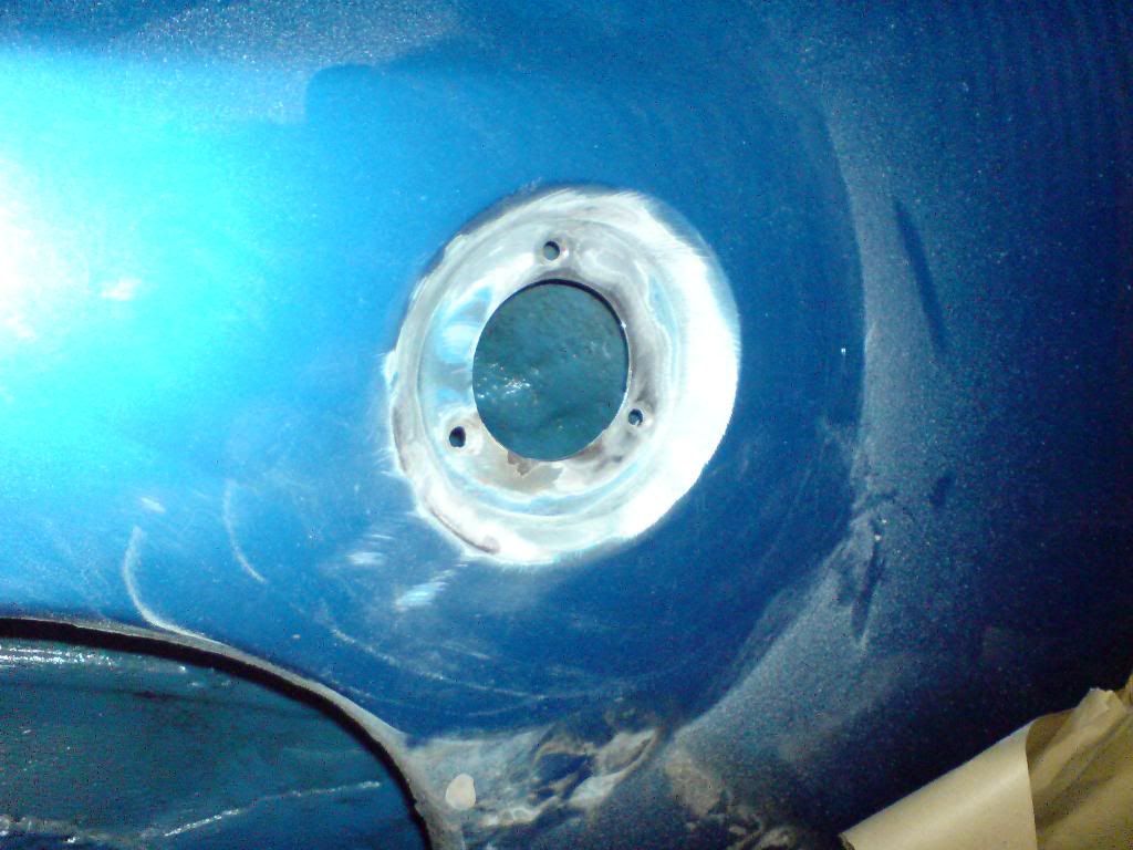

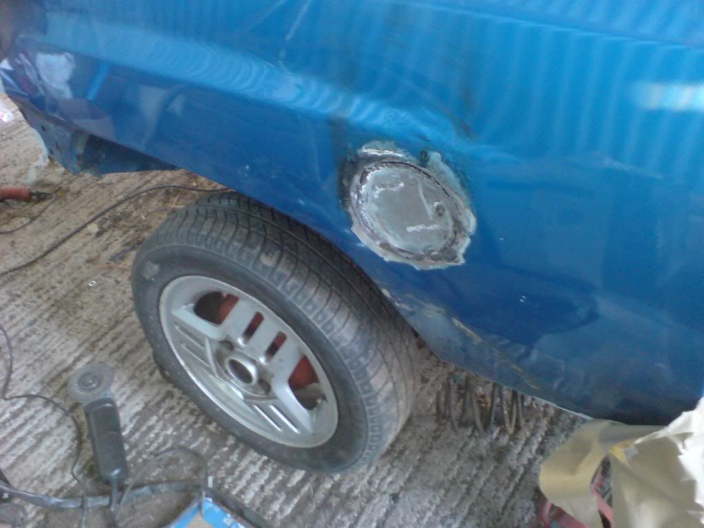

got a bit done today, welded in the plate where the vent should be. ground down the welds and then fillered it.
http://i193.photobucket.com/albums/z...3042010009.jpg
http://i193.photobucket.com/albums/z...3042010010.jpg
http://i193.photobucket.com/albums/z...3042010012.jpg
http://i193.photobucket.com/albums/z...3042010014.jpg
then i drilled the hole for the cap to fit into, think i mis-judged it as its a bit low. thinking about re-doing it, will have to weld a circular bit back in and drill another hole higher up. the striker is at the highest point it goes in this pic, it does sit lower when the door is on and closed.
what do you lot reckon?

Looks on where it is, bit low but should clear ok.
think ill leave it then. more hassle then its worth. will sort out pipe work once ive got the tank fitted back in.

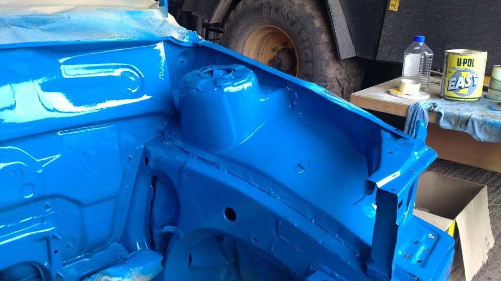

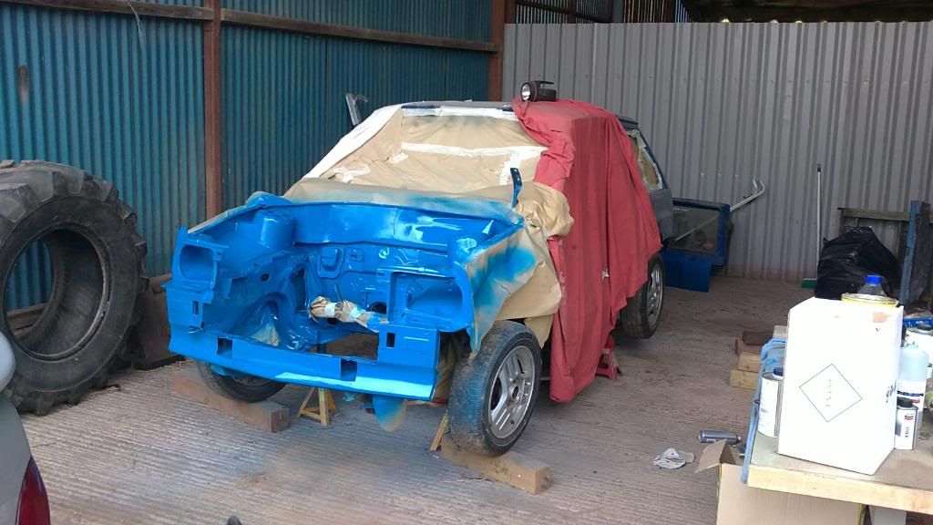

todays update saw the bay painted. rather pleased with the outcome even with the conditions i was in. heres the pics...

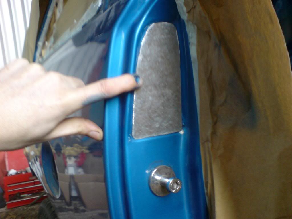

bought this off a member on here to replace the middle part of my slam panel i was missing.
http://i193.photobucket.com/albums/z...5052010111.jpg
i had made tabs on my old one to fit in place but looked untidy, decided to overlap this one as it looks neater. cut off the excess bits and fitted it down.
http://i193.photobucket.com/albums/z...5052010112.jpg
much better i think you will agree.

That colour looks sooooooooooo nice :thumb:
Looks great dude.
Nice progress dude, been that long already?
Great work in the bay :thumb:
its been 19months since i took it off the road, 6months out at my friends farm. once its been painted ill bring it back to my garages where i live. cant get hold of my painter though, hes had a bereavment in his family so its understandable.Quote:
