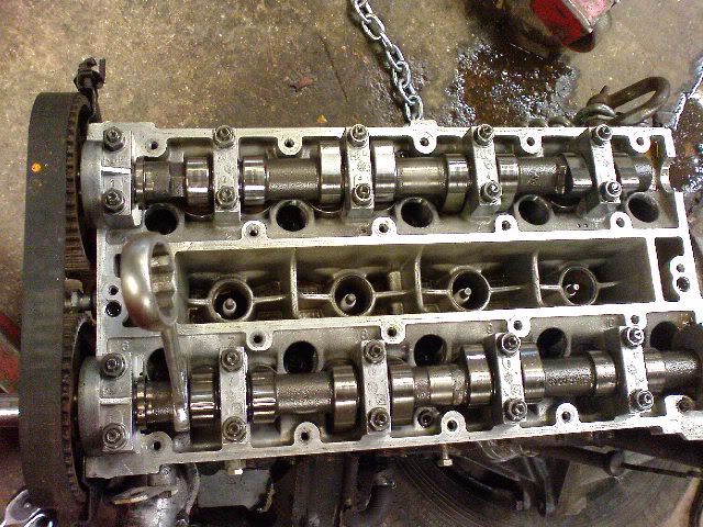

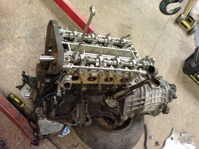

I removed the engine and box from it's old car (Carlton), it needed a fair bit of prep before it was ready for it's new home.
Exhaust cam change from LET exhaust to late-spec XE with sensor drive
Late spec XE cam end cap with sensor
Replace the modified breather pipe with a standard unit
Fabricate shortened oil pickup pipe to suit bigwing sump
Swop the old sump for the custom bigwing (reuse 2.0 8v one piece gasket)
Fit engine mount brackets and rubbers
Grind down the top gearbox support fins (the 2.0 8v gearbox I used to build the tunnel round doesn't have these fins on the top and therefore they would rub)
This engine was rebuild by me severel years ago, hence it still being sparkly clean internally:
http://i79.photobucket.com/albums/j1...c/DSC00269.jpg
http://i79.photobucket.com/albums/j1...c/DSC00270.jpg

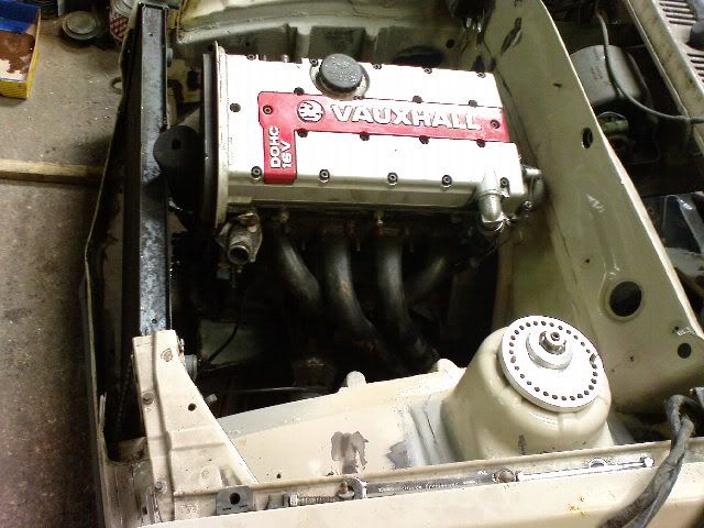

Engine in
http://i79.photobucket.com/albums/j1...c/DSC00272.jpg

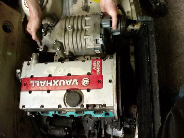

The rad needs moving forward to clear the supercharger I think

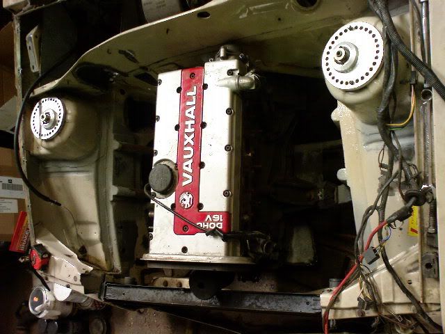

Exhaust manifold on
http://i79.photobucket.com/albums/j1...c/DSC00273.jpg
Right now lets see if it will fit!
http://i79.photobucket.com/albums/j1...DSC00274-1.jpg
http://i79.photobucket.com/albums/j1...c/DSC00275.jpg
That will be a yes then :D
