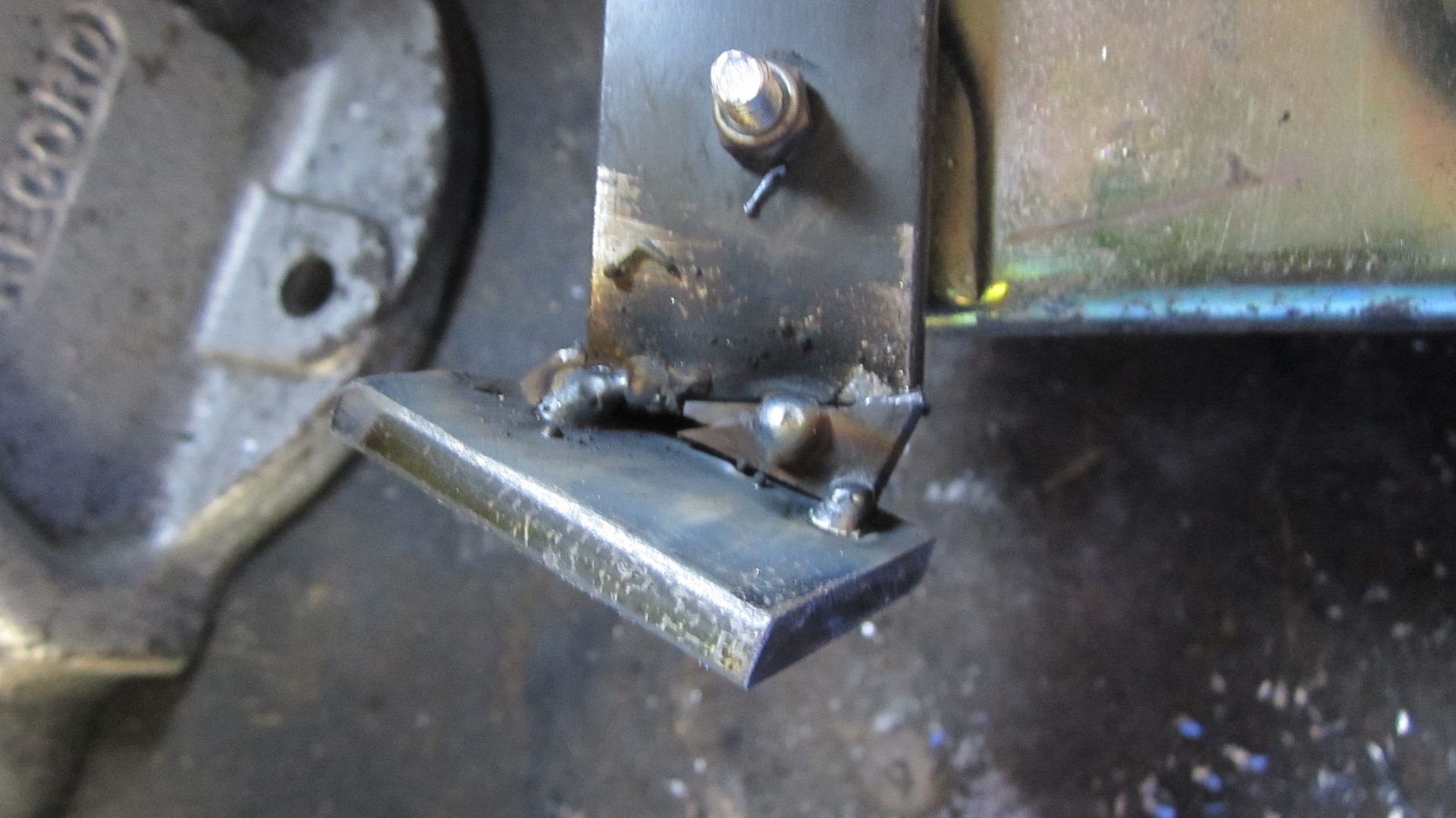

Worked out how to stand it, started to make some legs from 5mm steel bar i had in stock.
http://img.photobucket.com/albums/v3...ps66af299d.jpg

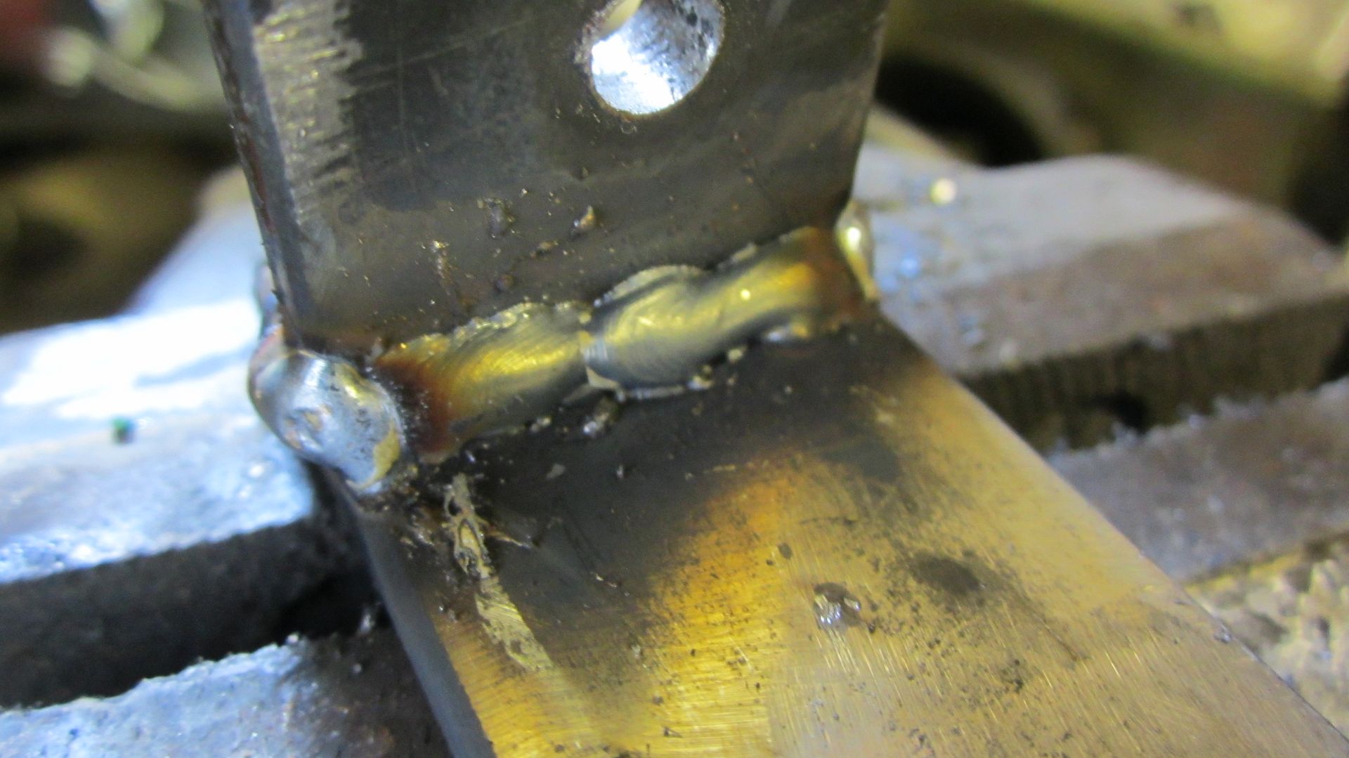

Welds so nicely.
http://img.photobucket.com/albums/v3...ps74b1b3a7.jpg
http://img.photobucket.com/albums/v3...psad5d3e4c.jpg
http://img.photobucket.com/albums/v3...psa3167896.jpg

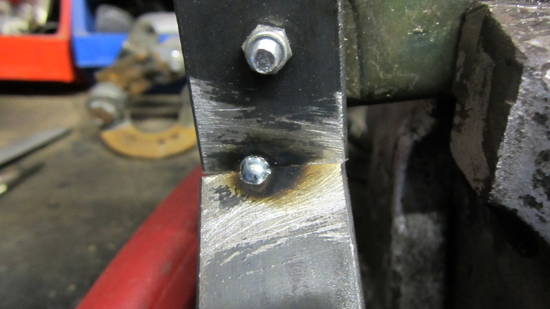

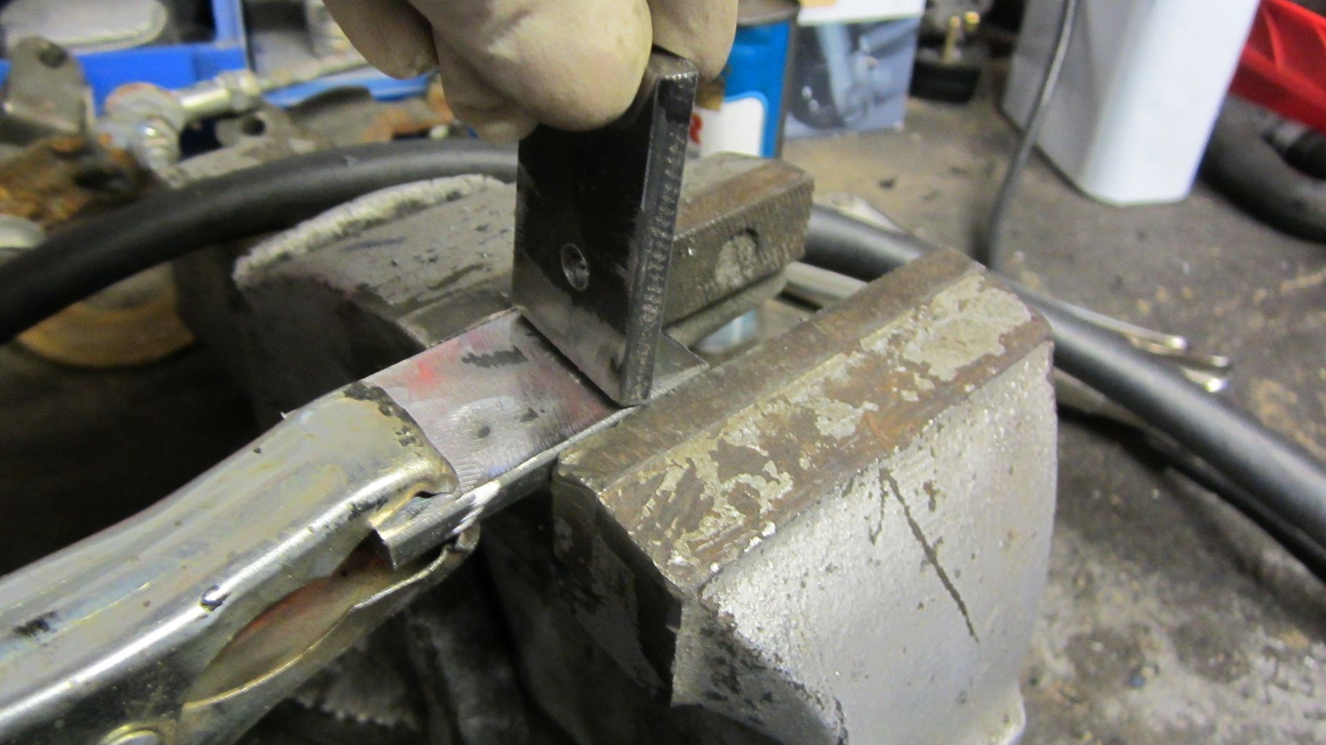

Now because of where it sit, there wasn't a flat surface on the pass side, so it had to be angled. So i had to hold it in place, tack the legs together then remove it all again!
http://img.photobucket.com/albums/v3...psfd37593f.jpg

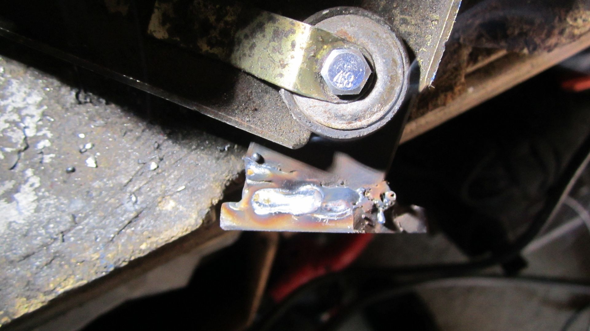

Yes there is a gap, wasn't an easy one to fab up due to space.
http://img.photobucket.com/albums/v3...psf89c071b.jpg

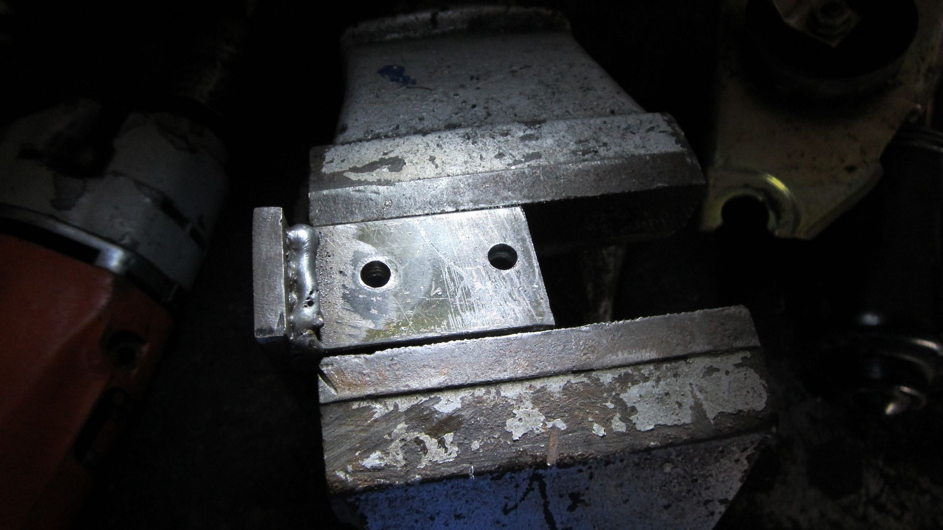

So use the bit i cut off, clamp in and weld in..
http://img.photobucket.com/albums/v3...psd04c0d55.jpg
Turn over and do the same..
http://img.photobucket.com/albums/v3...psd4c5e4e5.jpg
http://img.photobucket.com/albums/v3...psc2038565.jpg
Yes i know my welding isn't the tidiest.

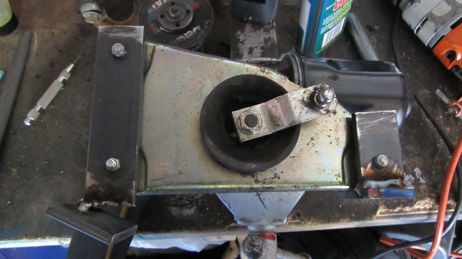

Two bracket/legs.
http://img.photobucket.com/albums/v3...ps6982a241.jpg
So refit it all, needs to people as it bolts up from under the dash...:mad:
Bend the Nova linkage a small amount so the end lines up with the ball joint.
Find the arm on the motor hit the base its bolted too..:roll:
Remove it for the 4th time. Raise all 3 holes...
http://img.photobucket.com/albums/v3...ps04071837.jpg
Refit again and test.
http://www.youtube.com/watch?v=37vlV...ature=youtu.be
Yay it all works, ok it's a bit shakey due to the rubbers.. Unsure what i can do there tho (Dan suggest nylon?)

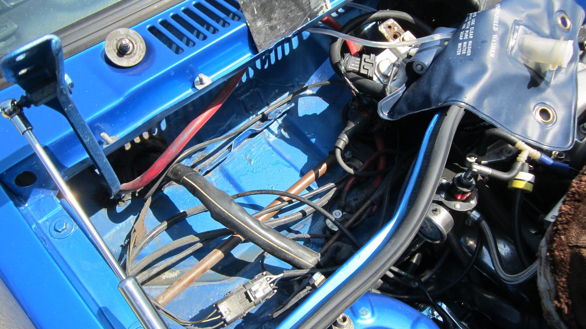

So while there, i did a bit of rerouting a tidying in the scuttle of pipes and vac lines, gave it a good wash out as it was still filthy from it's time at the bodyshop..
Before..
http://img.photobucket.com/albums/v3...ps513f2681.jpg
Wash out, dry in sun, then i used a sealant i've just got, for hard to work on arears (using it on the undersides of mine)

Good work on the wipers, sometimes its the simple ideas that work best (ie just moving the std motor)
Nice work, slow the wire speed down a tad on your welder and you will see an improvement :)
Cheers gary, yea i wish i had just tried it ages ago.
Thank you Jake, i set it up from the book when i got it.. now i just tend to change the power as needed.
it wasnt a criticism it was just an observation, wire speed can make a big difference. Things like arc length (how far away your contact tip is from the work peice) will dictate voltage drop too so its important to try and keep that as short as possible, dont be scared to play around till you find something that your comftable with :)
I didn't take it as one, i'm always happy getting tips. I have adjusted it a bit, to get what i feel is a better weld.. And yep was told to keep the tip as close as i can too.
