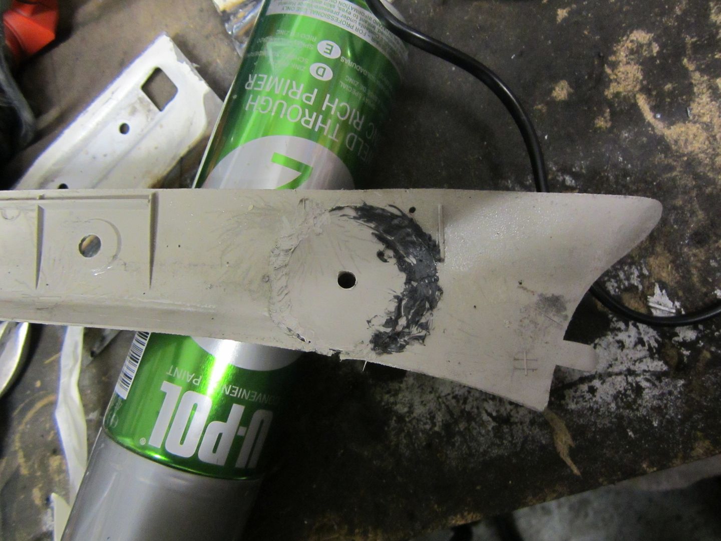

So i've been working on a Pillar pod, as i hated having the boost gauge just sat in the speaker van, so untidy.

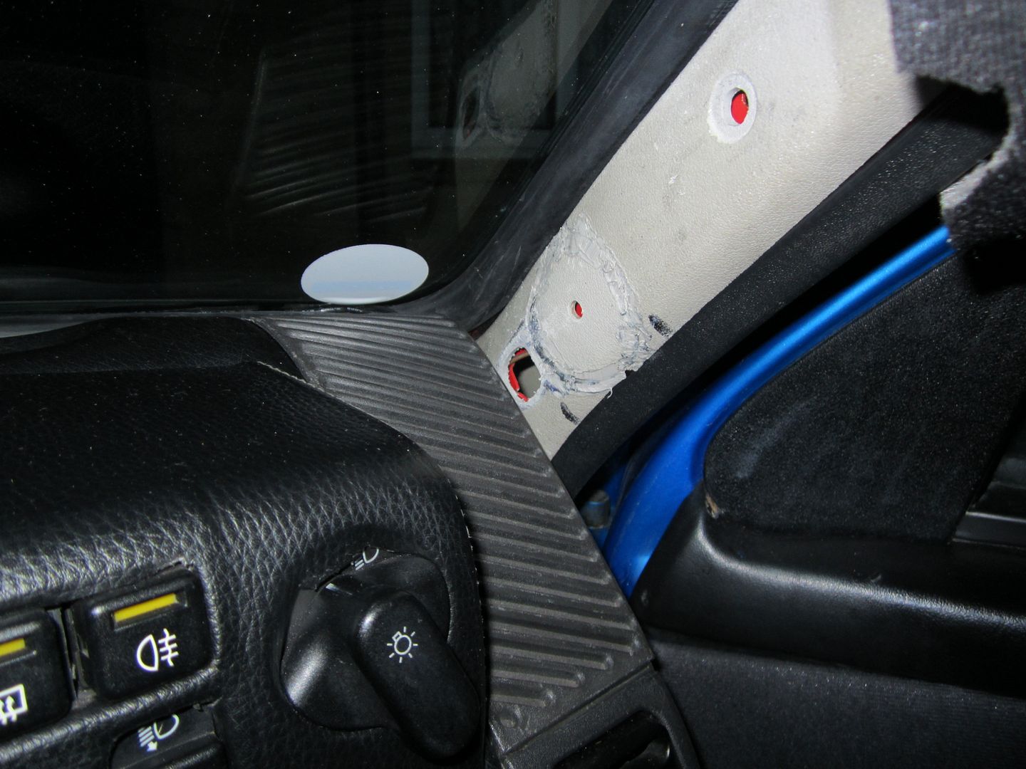

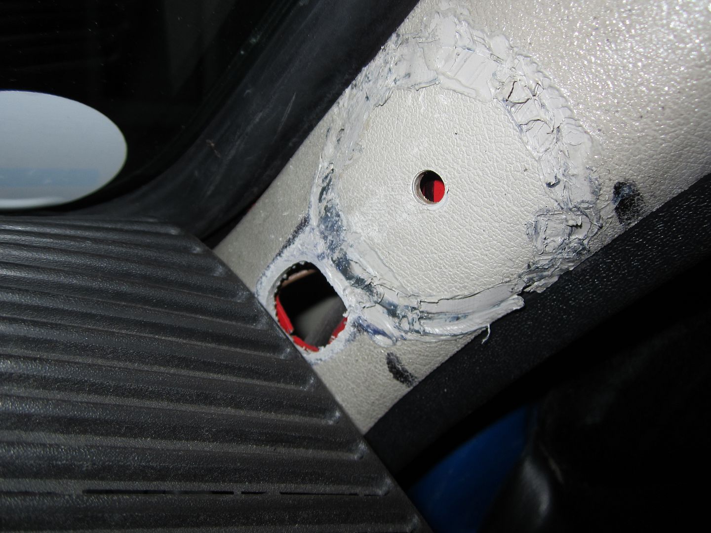

Really wanted it to be flush mounted in to the pillar trim, but i found cutting the A pillar wasn't easy and it still wouldn't of fitted nicely. Tried a few mounts... Nothing was right.
Then Mr South linked me too a proper heater mounted plastic pod and they do direct Nova fitment. So ordered one up. So start prep work on the trim.. As i had cut a hole in it..
http://img.photobucket.com/albums/v3...ps45dc9d7a.jpg

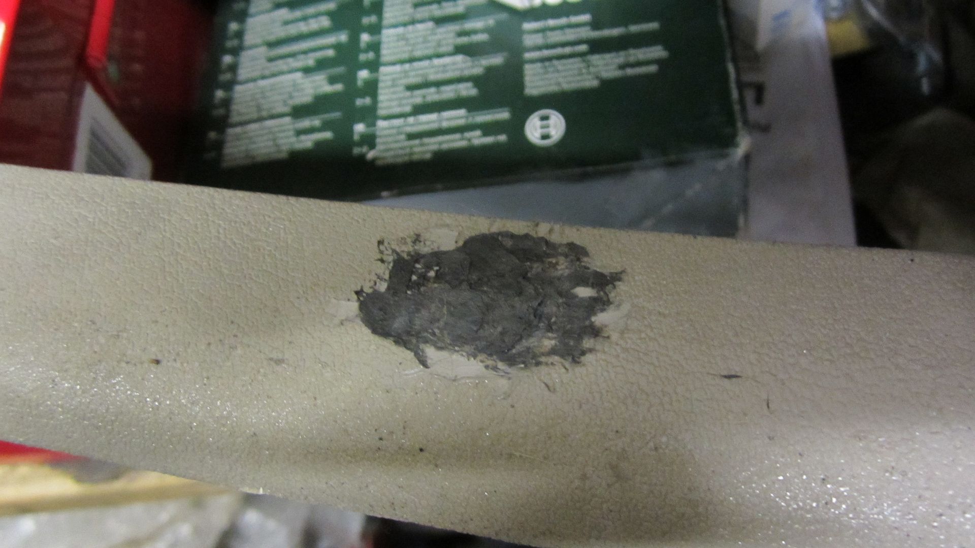

Plastic work bit back in...:roll:
http://img.photobucket.com/albums/v3...ps58dca157.jpg

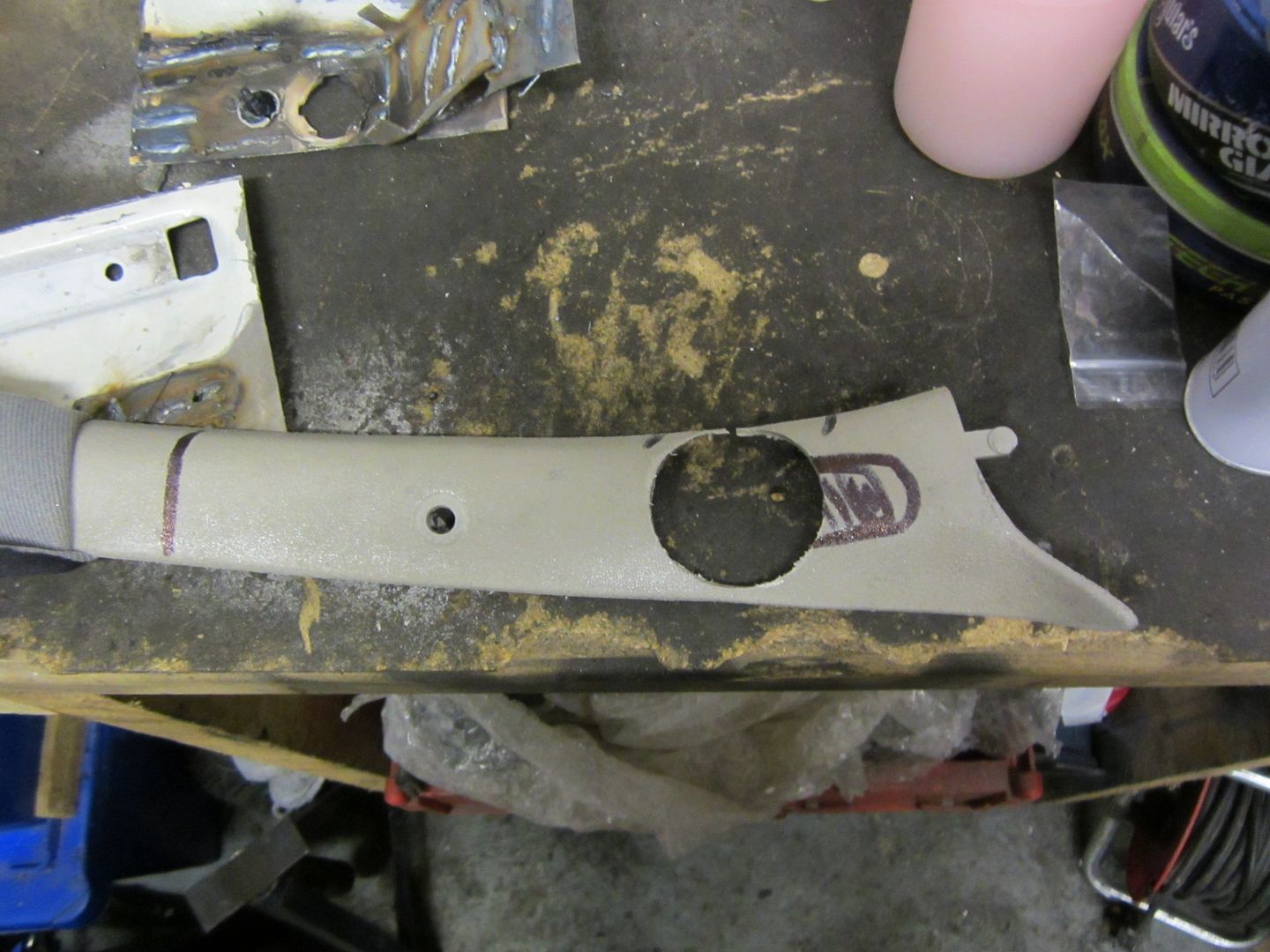

Refit and mark for fitment.
http://img.photobucket.com/albums/v3...ps62279c09.jpg
http://img.photobucket.com/albums/v3...psc6589bc4.jpg
Screw pod on, lining up marks..
http://img.photobucket.com/albums/v3...psd70a3f31.jpg
Then i used a 2pac glue. As i didn't want any screws of anything showing as i want it a flush as poss.

Smooth it into edge (that is important later on..)

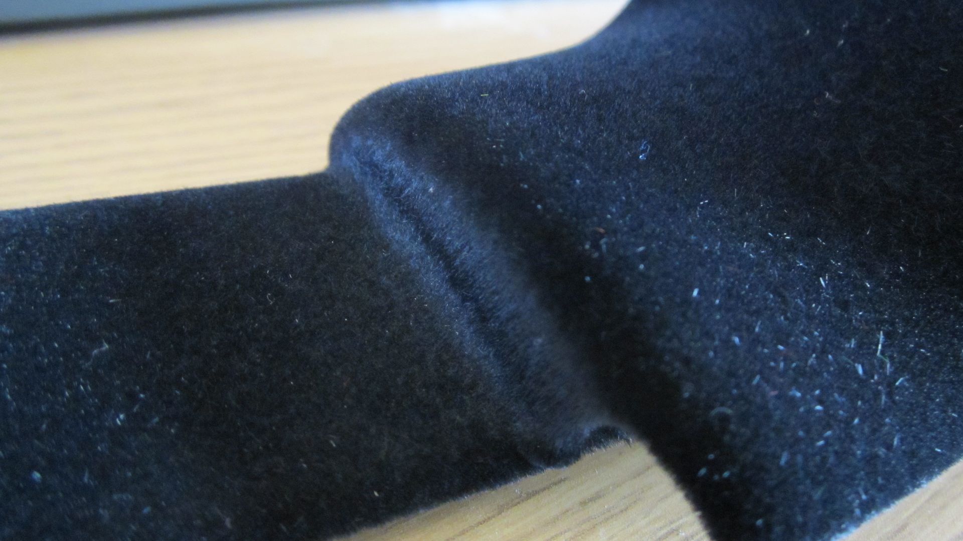

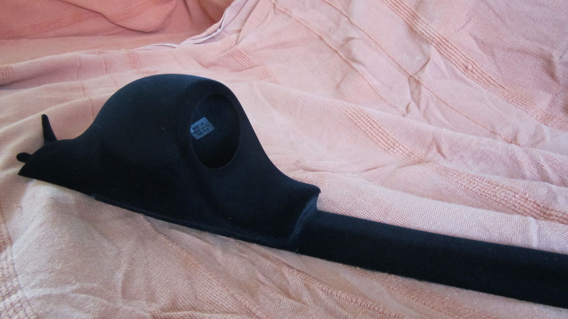

Due to the shapes and my anger at wrapping it, i had it flocked.
http://img.photobucket.com/albums/v3...ps68512767.jpg
http://img.photobucket.com/albums/v3...ps09a16ed3.jpg
Smooth join... See why i did it now?
http://img.photobucket.com/albums/v3...ps792839a4.jpg
