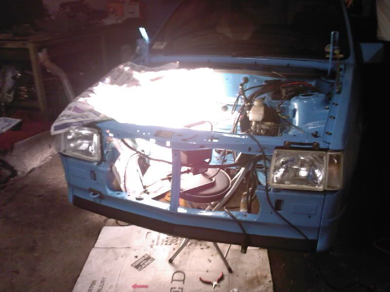

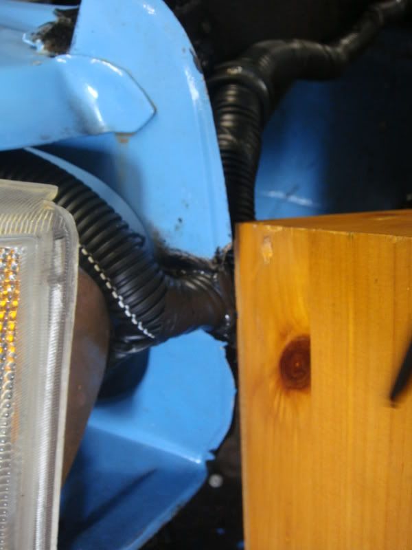

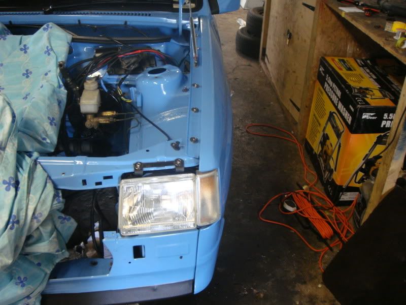

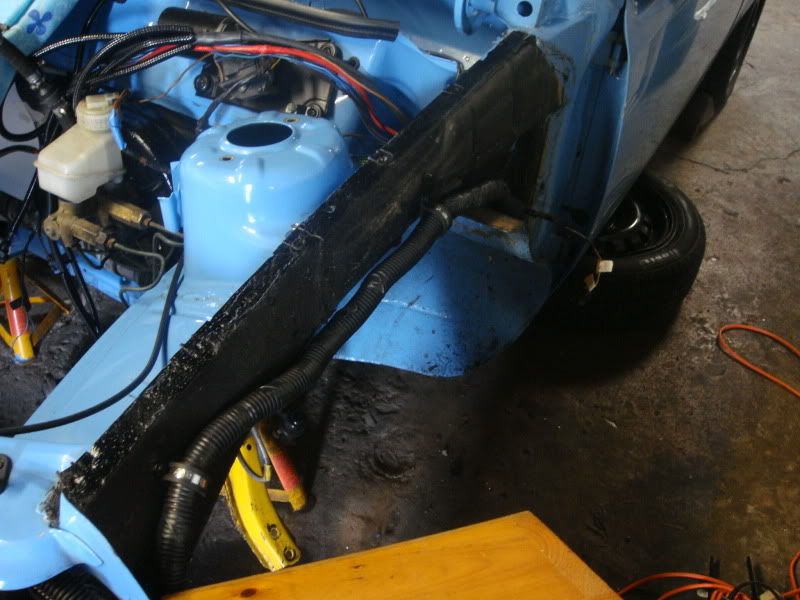

Finished the loom re-routing: (the big wooden box in pics is resting on the loom where is used some sealant, whilst drying)
http://img.photobucket.com/albums/v1...DSC00130-1.jpg
I gave the whole area a quick whizz-around of waxoil too, especially where i had made a bit of an incision into the slam panel for the wiring to run through.
http://img.photobucket.com/albums/v1...r/DSC00131.jpg
Wing back on, sorted.
http://img.photobucket.com/albums/v1...r/DSC00134.jpg

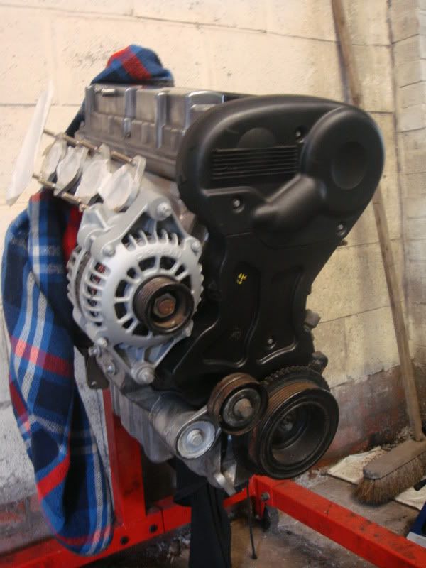

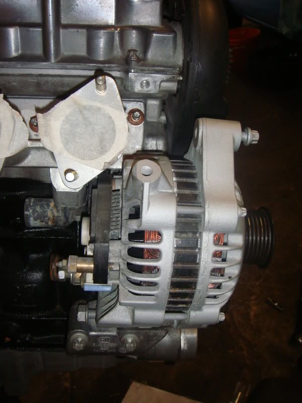

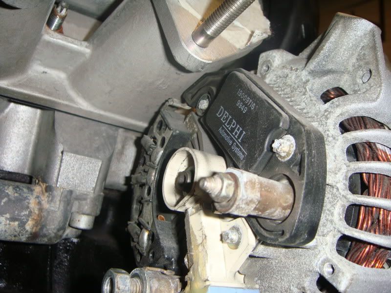

Did a little more picking and probing at the engine. Alternator issues..
http://img.photobucket.com/albums/v1...r/DSC00136.jpg
It only fits, at the mo, with the rear cover removed lol..
http://img.photobucket.com/albums/v1...r/DSC00144.jpg
http://img.photobucket.com/albums/v1...r/DSC00148.jpg
So a bit of work still to do with that..

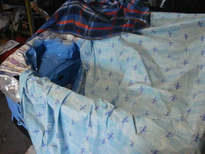

..also, today did a bit of painting, touching up parts of the engine bay, as it didnt really need a complete respray..
http://img.photobucket.com/albums/v1...r/SP_A1633.jpg
http://img.photobucket.com/albums/v1...r/DSC00158.jpg
http://img.photobucket.com/albums/v1...r/DSC00160.jpg
Left it to dry out , harden like this tonight, see the reveal un masked pics tommorow/friday.

looking good. is the loom hard to re-route?
Looking good, Shame you cant move the alt down a bit like 8v's.
Seeing the loom movment makes me think about moving mine.
nah i think the loom thing was pretty straight forward, even if working with wires is summat i do everyday virtually..
It does take a fair while tho, time-wise.
But its just like for like, colour to colour - you just cut and extend the loom..
The slight modification to bodywork for running the completed loom felt a bit bodgy at the time with me snipping the metal but as long as you take the time to dremel it tidy and once youve touched up the paint / underseal it looks as o.e i almost say. Use trunking and P-clips, all proper, you know.

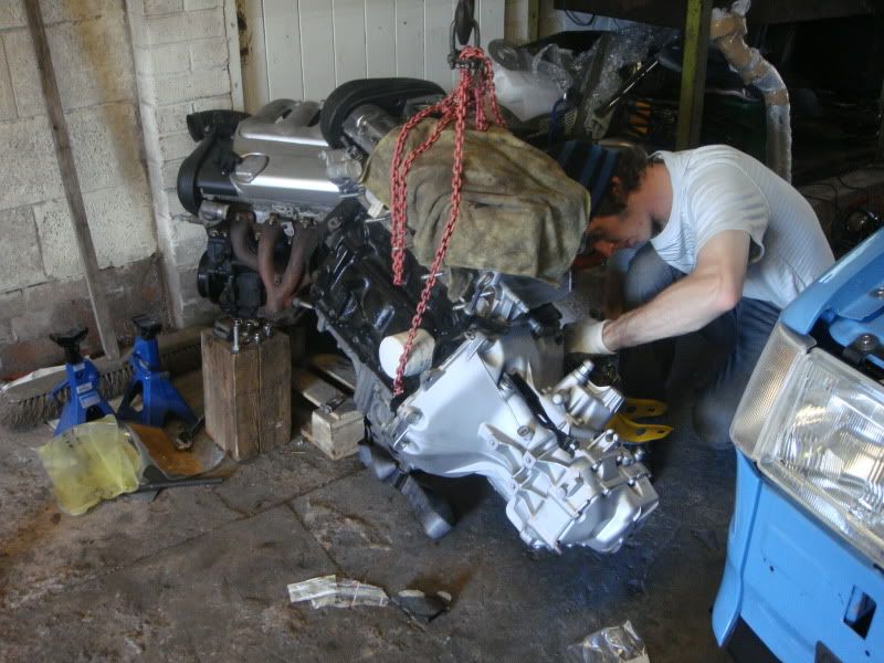

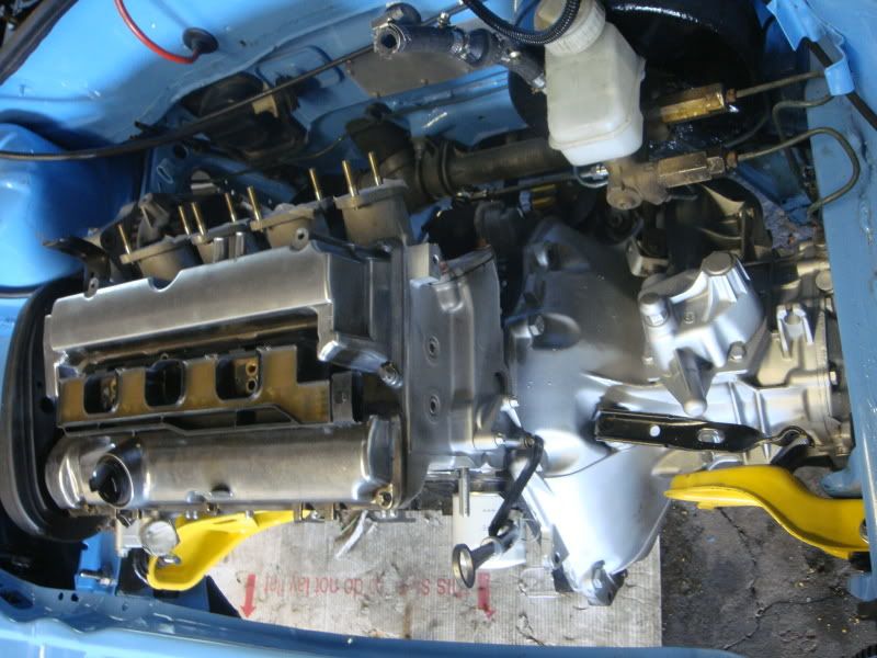

Yesterday we got the engine in. Migweb'ers might have seen mentioned in lee303's thread , but for the actual thread ive got my thru-the-stages pics:
http://img.photobucket.com/albums/v1...r/DSC00168.jpg
Off stand, v flywheel on....
http://img.photobucket.com/albums/v1...r/DSC00170.jpg
f15 on.. hello mr lee
http://img.photobucket.com/albums/v1...r/DSC00171.jpg
and in..
http://img.photobucket.com/albums/v1...r/DSC00173.jpg
bolted up.
http://img.photobucket.com/albums/v1...r/DSC00174.jpg
http://img.photobucket.com/albums/v1...r/DSC00176.jpg
So as planned, engine went in like any small block does. No real hassle. Like any competition mount puts up a little fight then get hammered into fitting.
There are some tweeks needed here n there with the new linkage and alternator mounting still and obviously lots still to do wiring fitting in and outlets...
