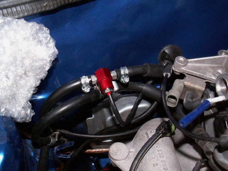

Been busy today finishing off the Nos installation.
First job get all the piping in the right place. Took a T out of the fuel line from the pump - there was already a handy join in the pipe so just T'ed in here ...
http://i2.photobucket.com/albums/y15...nova/Nos5a.jpg

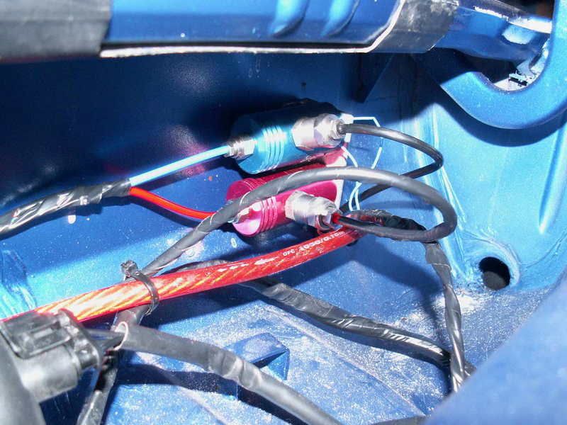

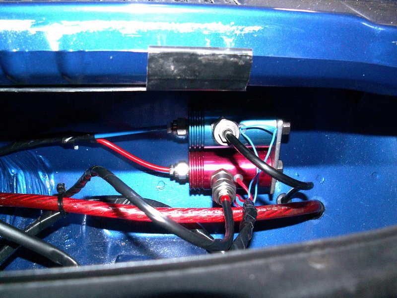

Next job was to get the soleniods plumbed in and wired up and mounted and here they are .....
http://i2.photobucket.com/albums/y15...nova/Nos1a.jpg
http://i2.photobucket.com/albums/y15...nova/Nos2a.jpg

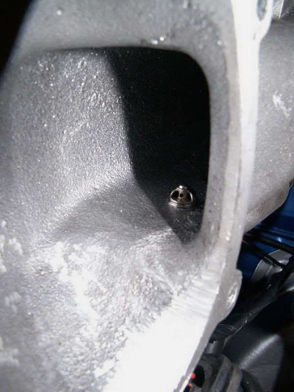

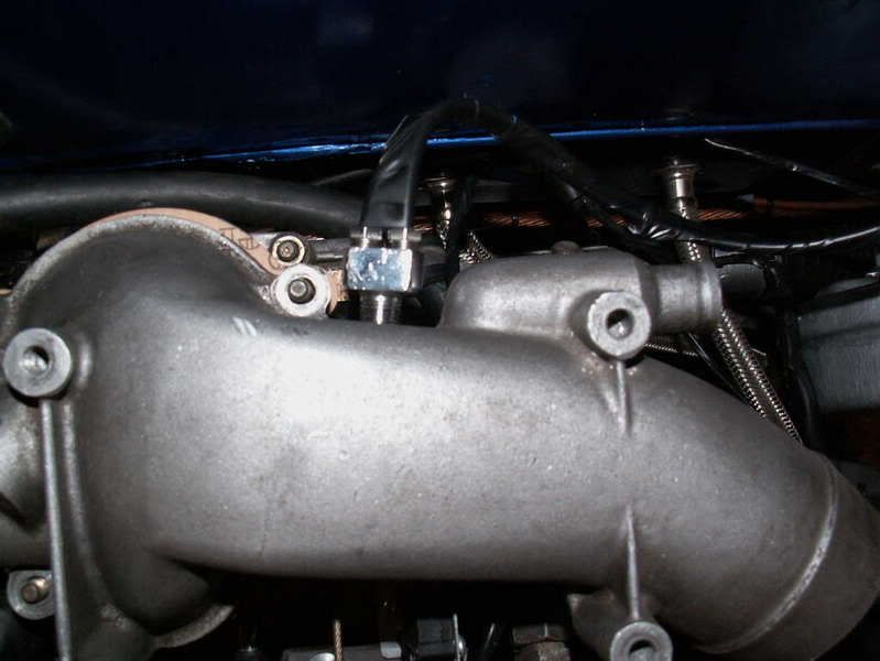

Also needed to tap a hole into the tophat to mount the nozzle ....
http://i2.photobucket.com/albums/y15...nova/Nos3a.jpg
Needed to make sure it fires in the right direction - i.e into the engine and not back up to the intercooler!0
http://i2.photobucket.com/albums/y15...nova/Nos4a.jpg

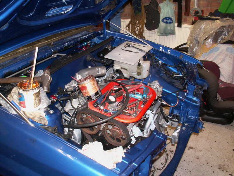

Finally this is how the engine bay is looking - lots of tools and a bit of a mess!!!!

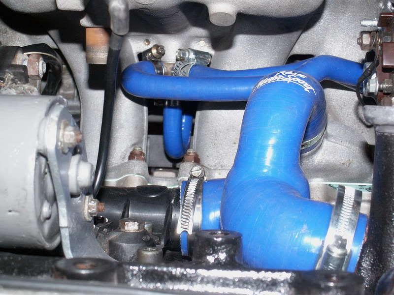

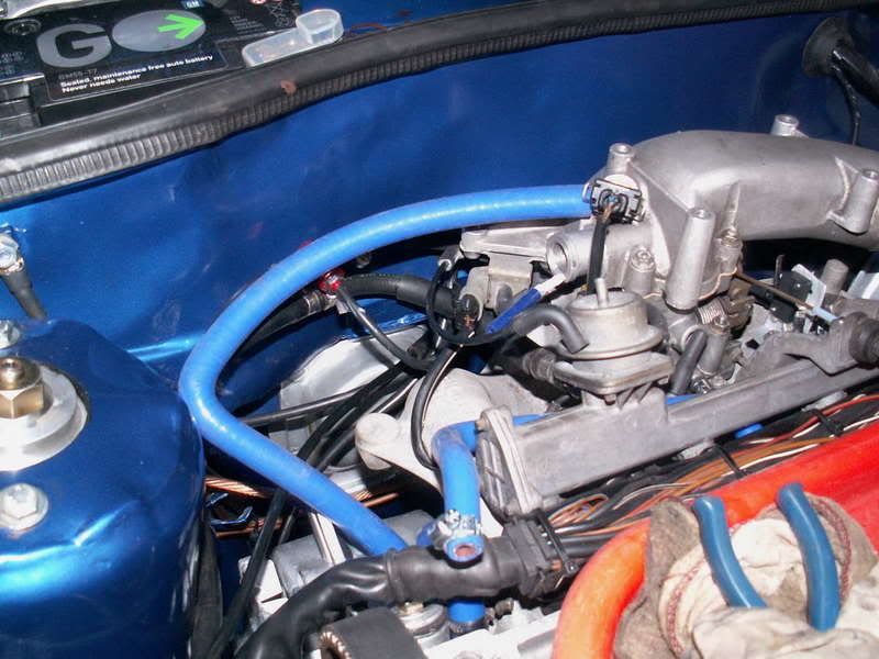

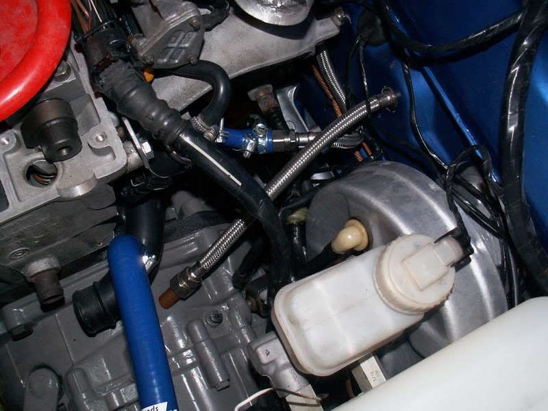

Got a replacement pipe (from Roose Motorsport in blue silicone) for the back of the water pump and also the
pipework that lives under the inlet manifold. WHAT A JOB getting access to these!
Anyway after a lot of grunting and moaning I have got them fitted :-
http://i2.photobucket.com/albums/y15...Backpipe1a.jpg

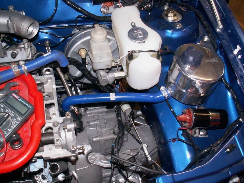

Also fitted the coil, header tank and sorted out a bit more wiring loom :-
http://i2.photobucket.com/albums/y15...ova/Pipe3a.jpg
http://i2.photobucket.com/albums/y15...ova/Pipe4a.jpg
http://i2.photobucket.com/albums/y15...ova/Pipe5a.jpg
