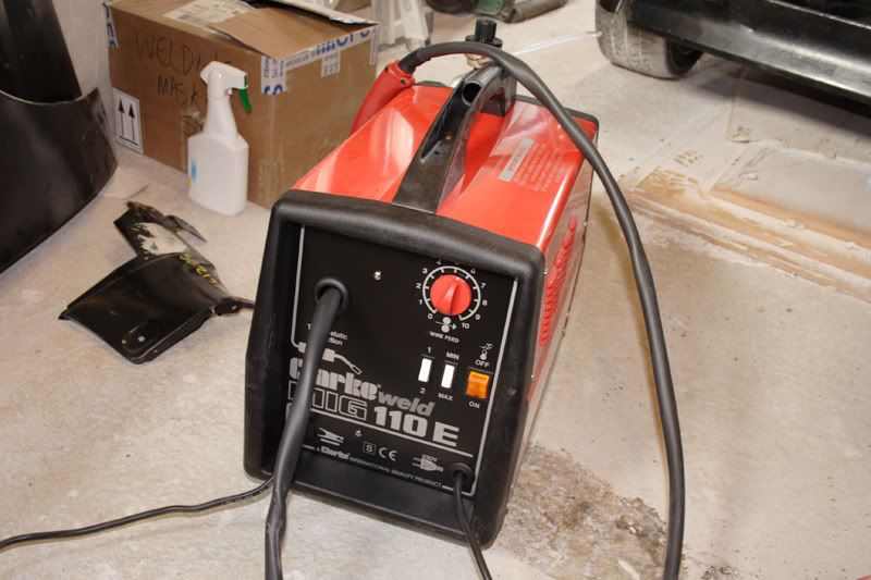

Here's my welder -

I started with some old cut off bits of metal from my old pattern wings - it's about 0.8mm-0.9mm thick so based on the welder instructions I set my gas to reg 4, my wire to about speed 6 and my power to MIN (I have MIN and MAX settings) and off I went!
BLOODY HELL! For starters you can'tsee a thing through the mask and trying to hold the gun at the right angle whilst trying to move it about is bloody hard!

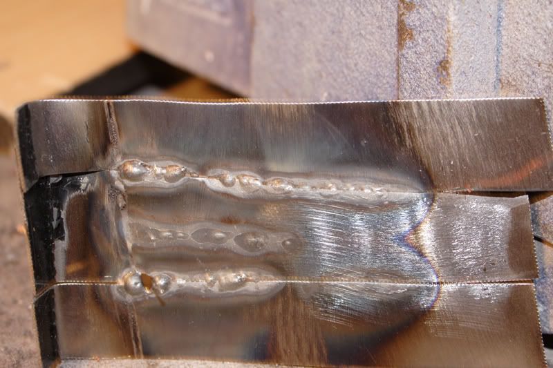

Here's my 1st attempt at trying to butt joint 2 bits -
http://img.photobucket.com/albums/v1...lding00016.jpg

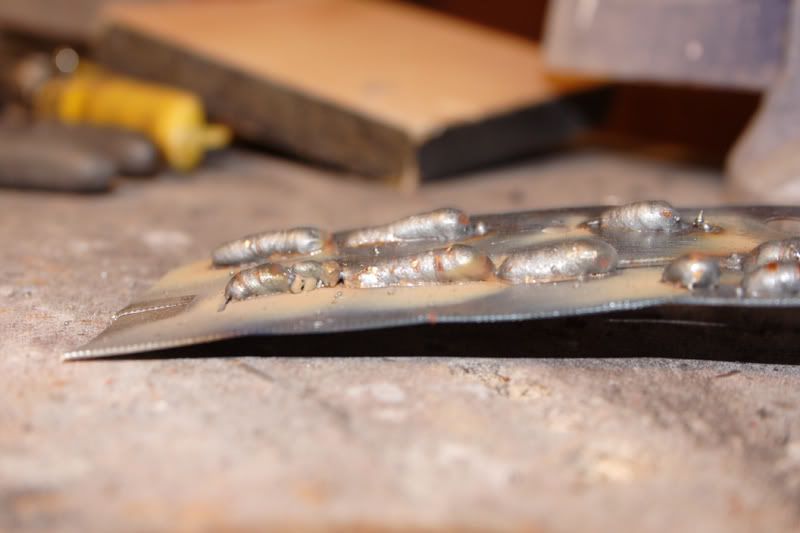

The problem was penetration - it didnt seem to want to go through -
http://img.photobucket.com/albums/v1...lding00017.jpg
As you can see - it just sat on the top in big blobs -
http://img.photobucket.com/albums/v1...lding00018.jpg

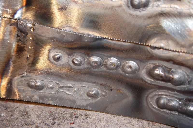

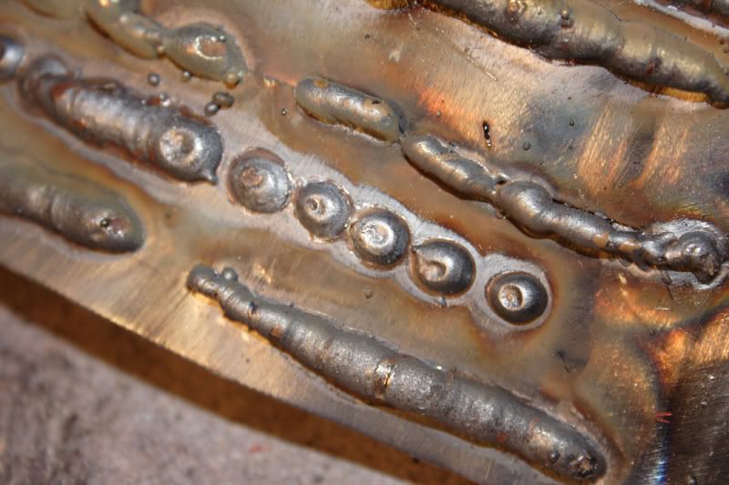

Turns out after reading the book that the power isnt high enough to penetrate the thickness of the steel so I wacked it on MAX and after blowing a ton of holes in the metal turned up the wire speed and eventually started to get the hand of it. here's some tack welds - front -
http://img.photobucket.com/albums/v1...lding00010.jpg
and back -
http://img.photobucket.com/albums/v1...lding00011.jpg
Granted these are on solid steel (no butt joints) but I was impressed to manage this without blowing holes.
