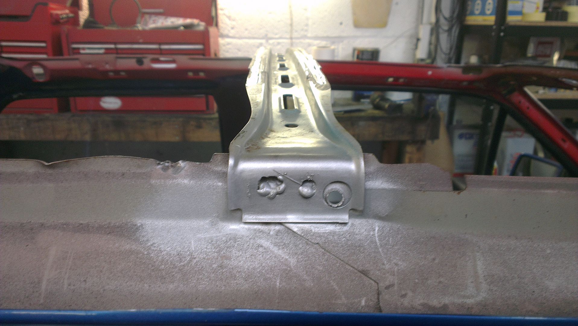

Remember the gap to the bar? I't much better now.
http://img.photobucket.com/albums/v3...ps94c4ff91.jpg
Gotta weld said bar in, you can raise and lower the bar about 3/4mm to fit right, so line it up with the skin on and marked it so it was almost touching.
