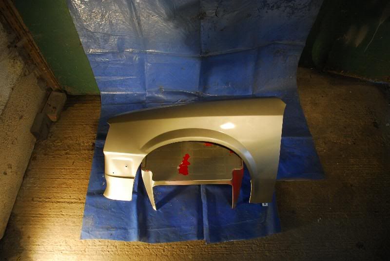

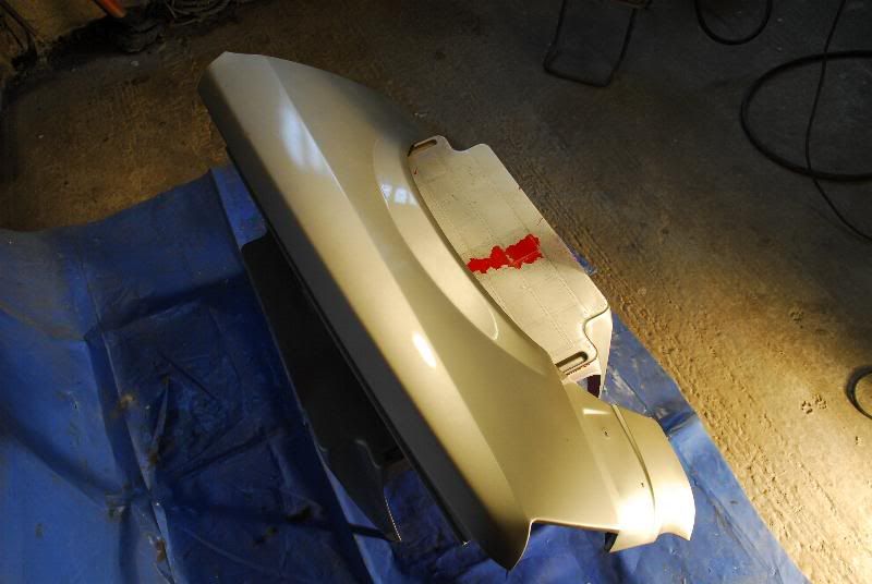

So, its been a week since they were painted, and we decided not to re-base coat them and then lacquer them, we just hit it straight with the lacquer, and it took to fine.
One wing in for the shine
http://i136.photobucket.com/albums/q...ure/nc1082.jpg
http://i136.photobucket.com/albums/q...ure/nc1083.jpg
One lacquered, but not flatted off, one not

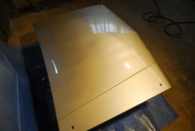

Bonnet before and after lacquerage
http://i136.photobucket.com/albums/q...ure/nc1085.jpg http://i136.photobucket.com/albums/q...ure/nc1086.jpg

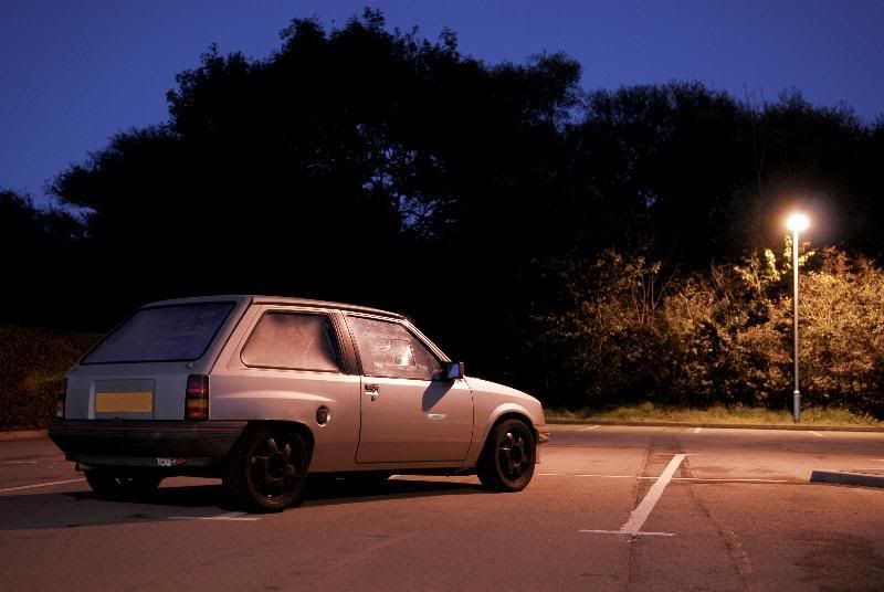

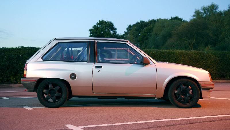

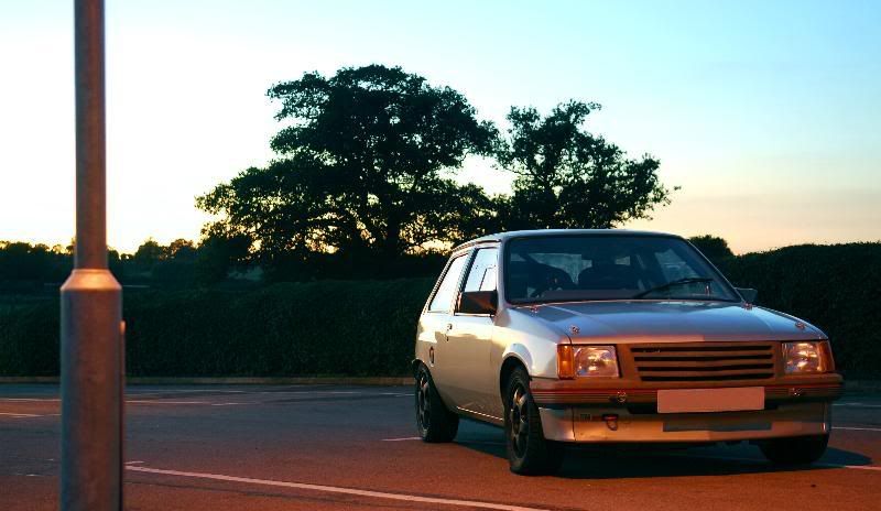

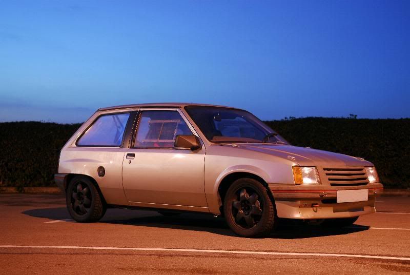

Got them home tonight, bolted them all up, refitted bonnet pins and catches, and decided to take some pics...
So then... 3 door hatch with front loon wings - you decide (I personally like it lol) - oh, they've still not been flatted back, gonna give it a couple of days to go 'ard

w000t, despite neither of us ever sprayed properly before, I'm happy with the results, thanks once again to nova ian for the help today.
I think the main aim has been acheived, as you can see I could drop it another foot at the front without it catching like it used to lol
Would like your comments :)
looking good! paint job is better than some of the bodyshops i know lol looks good wings seem to work aswell! 1 peice bumper looks loads better imo
olly, i've missed the reason why you've gone to loon wings? Thought you had f/g front wings?
lookin hard as btw! (front bumper needs heat gunning/painting imo.)
Kris - yeah, they're by no means perfect, but 10x better than I ever thought they'd come out, and still more to come with some flattage. The colour match is spot on aswell, which is always a gamble with such a peculiar colour, metallic, and the rest of the car being 20 years old lol
John - I had FG wide wings, well I actually still have them in my shed, but decided not to fit them due keeping standard rear width. Wide fronts, standard rears works so well on Oli's car, but didn't look right on mine. So I've gone for loon wings which are widee as standard than 3dr wings, and the fact they're round enables me to lower the car even more to lower the COG, and clearence is much better now they're lip-less, all function orientated :)
I don't think a darker front bumper would look that nice with the colour of my car, I like it light grey - but I might 'shop it, and see how it would look :thumb: Also I like the retro-ness of it being faded as hell, I wouldn't want it looking new
Ahh i see! i never knew loon wings were wider than hatch!
Top work on the spraying. Can do some mega slammage with those wings now :cool:
Personally i dont like the look of them, just doesn't go with box/square rear arches... But thats a minor thing considering they've solved a few problems for you :)
Paint looks good dude, come up quite flat good work.
I really like the loon/5door front arches on there.
Looks tastey.
Love it! the wings look good and the whole car looks purposeful like it could rip you in half. The paint came out really well and you deserve a pat (just one though) on the back for your efforts top job!

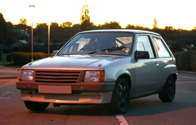

OK then, so today I achieved what I have been working towards for along time now, that it's all worked out fine, apart from uncovering some more problems that I will need to sort out.
Some daylight pics of my car to show the colour match and 'un flatted' finish on the wings and bonnet...
As you can see - I have been playing with the ride height just to see what my options are available to me, and I'm pleased to say that even at the height below, I get no scrubbing problems on either lock, or when just driving (albeit, only to my road and back, due to being full race slicks lol)
http://i136.photobucket.com/albums/q...ure/nc1095.jpg
So in a straight line, you can see that the lipless round arches are a godsend when it comes to clearence, as they'd usually have hit

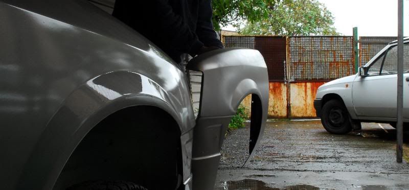

So... my right lock isn't a problem, it only stops night of "full lock" due to the inside of the rear part of the tyre hitting the inner arch, or the passenger tyre hitting the end case of the gearbox, neither of which is a problem

As you can see, I could afford to drop it even more should I want to, but I probably wont... or might lol

And my new fave pic of the car...
