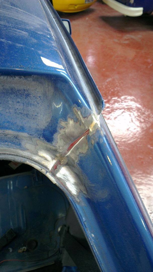

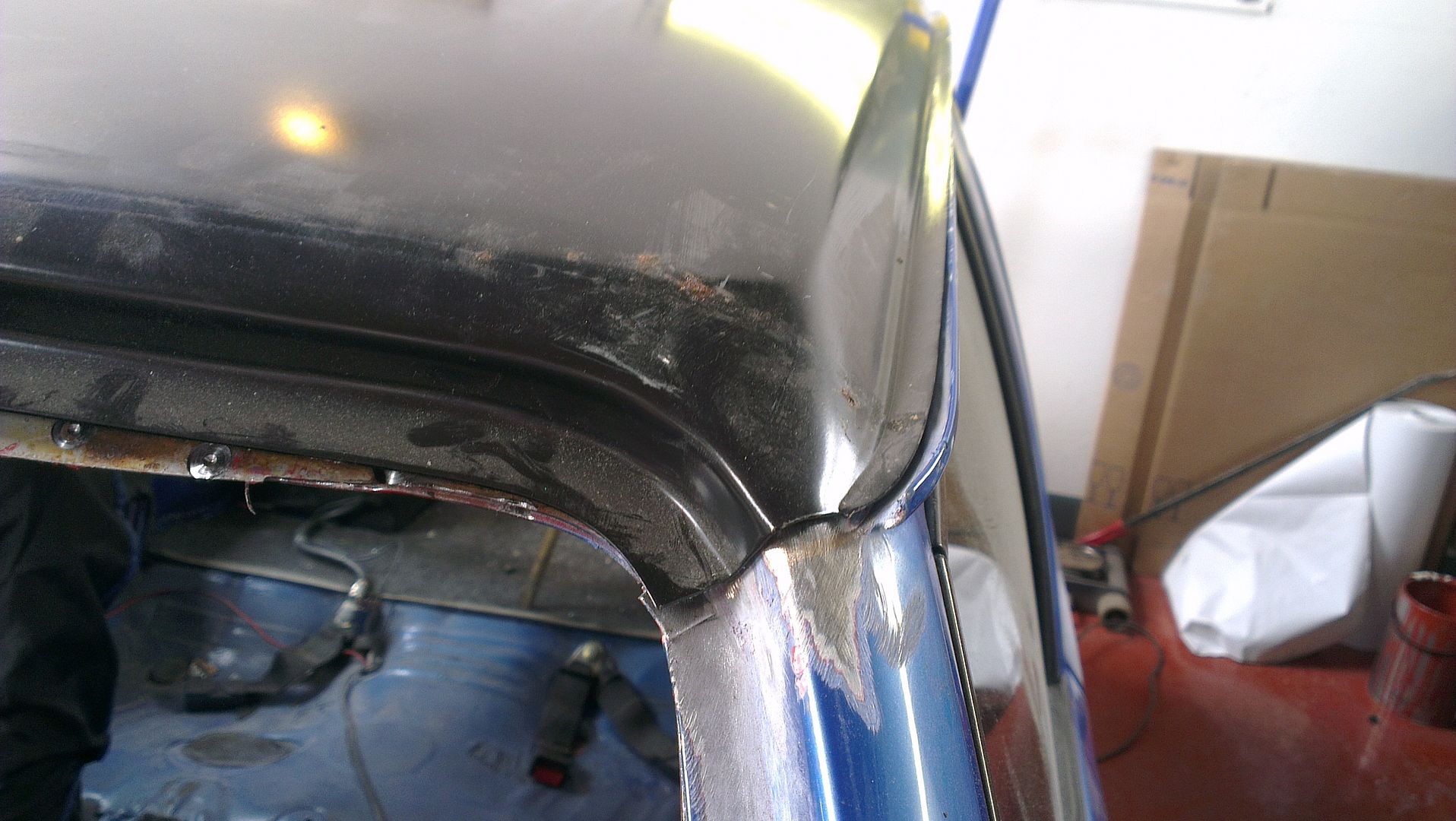

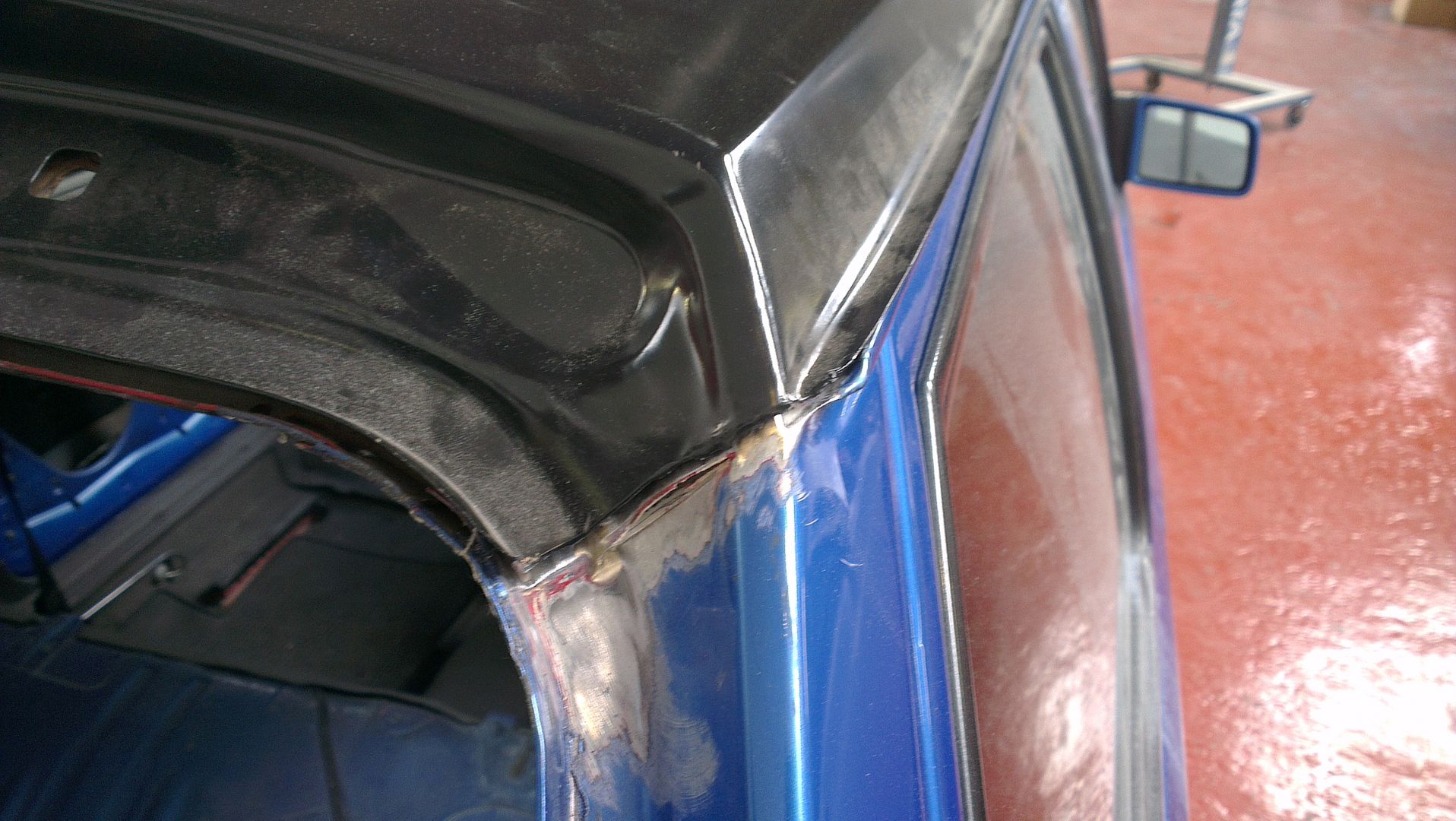

So start by cleaning all the joins off..
http://img.photobucket.com/albums/v3...ps869f394a.jpg
http://img.photobucket.com/albums/v3...ps1772602e.jpg
http://img.photobucket.com/albums/v3...psfaa4420d.jpg
http://img.photobucket.com/albums/v3...psaddc91d4.jpg

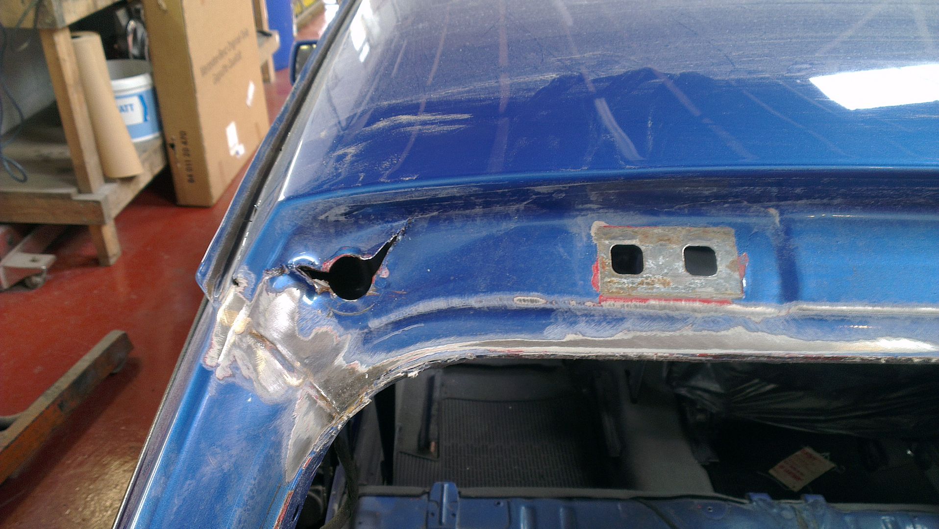

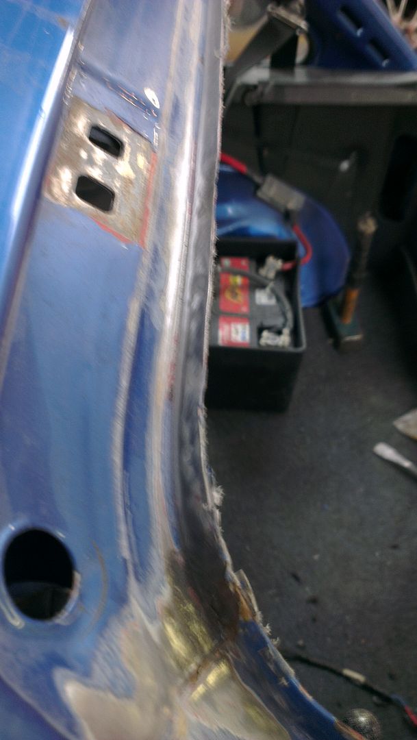

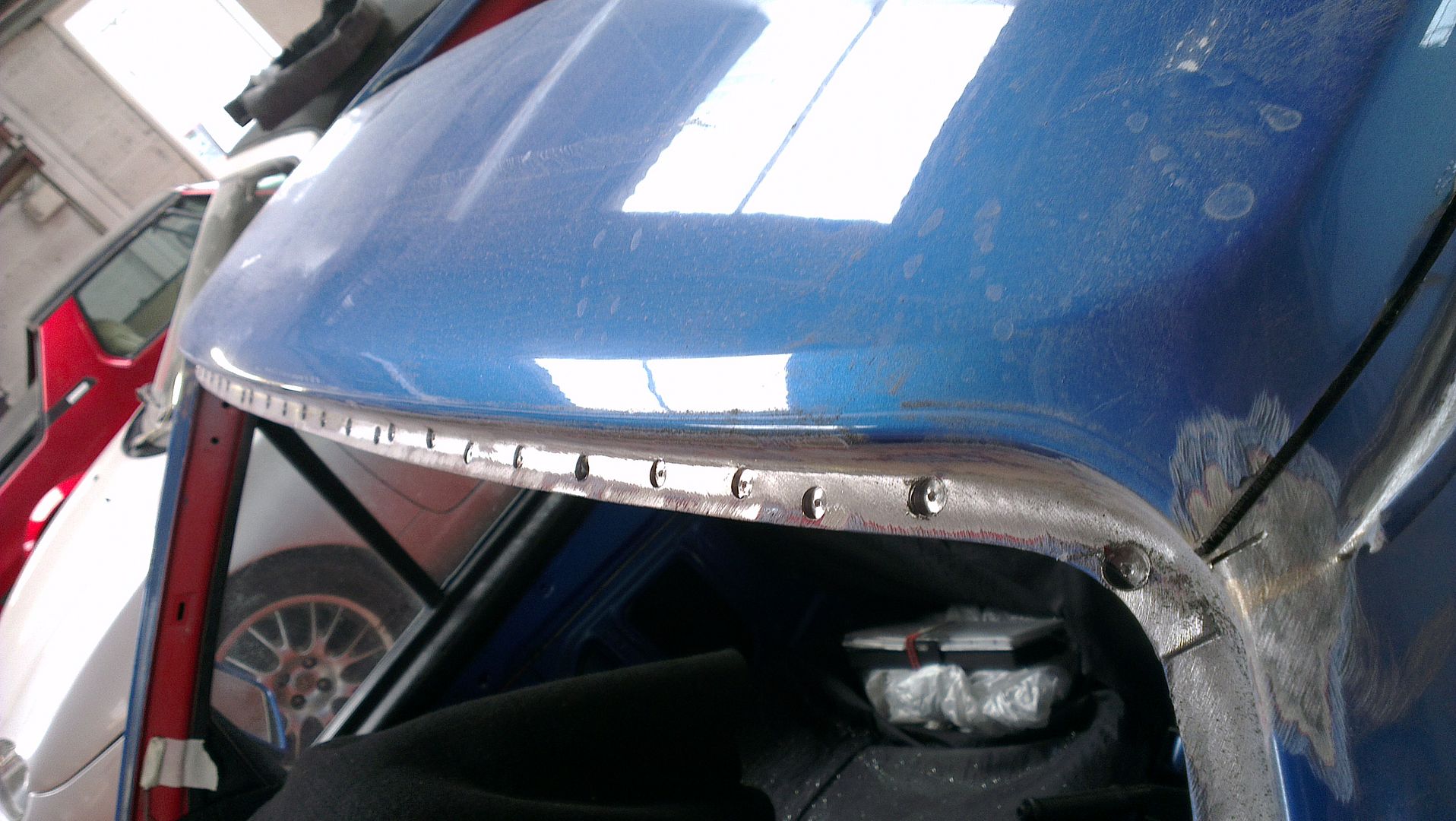

Now all the spot welds and bits can be seen. We can drill them out..
http://img.photobucket.com/albums/v3...ps909c6b9f.jpg
http://img.photobucket.com/albums/v3...ps5ebe0072.jpg

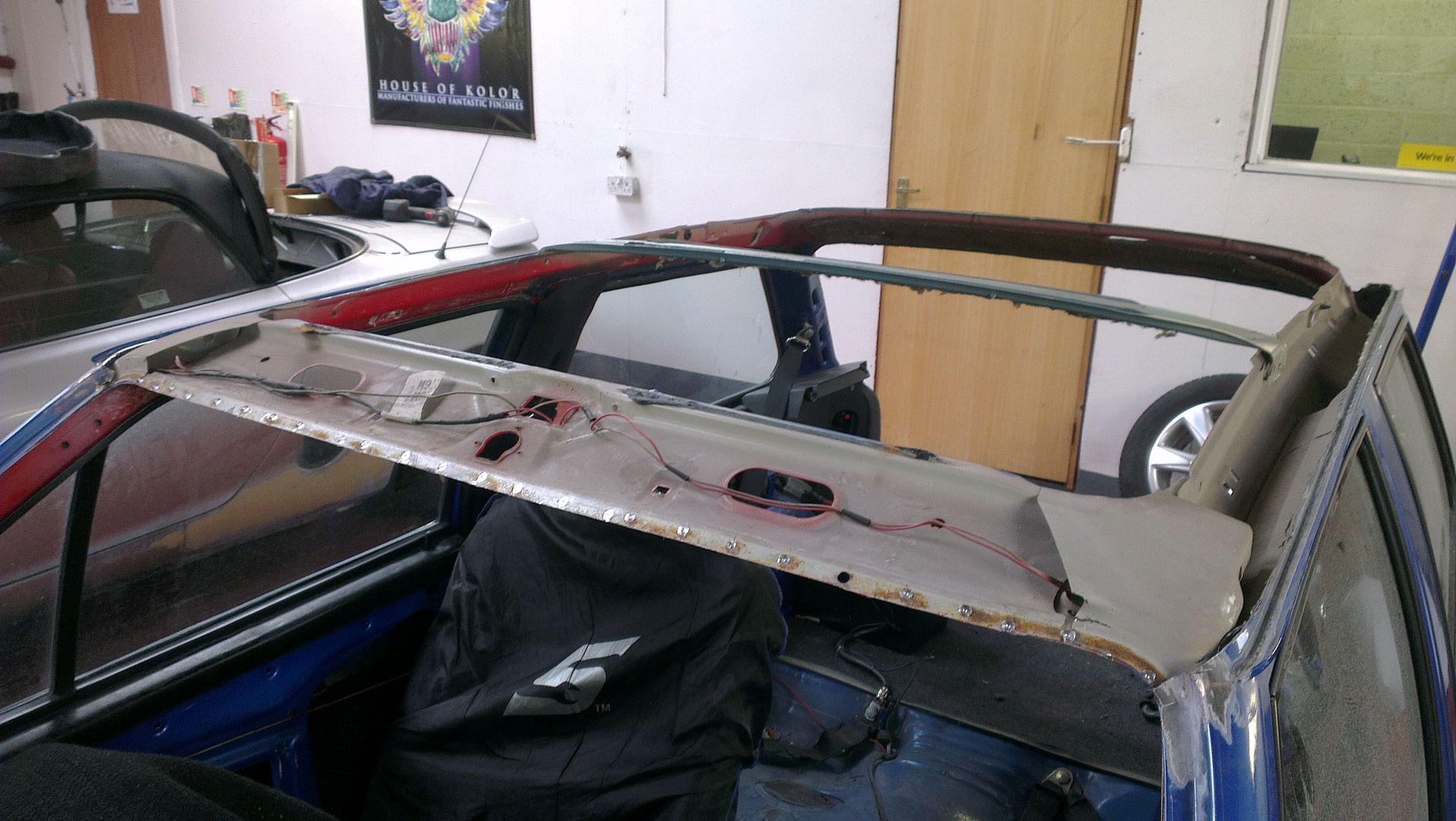

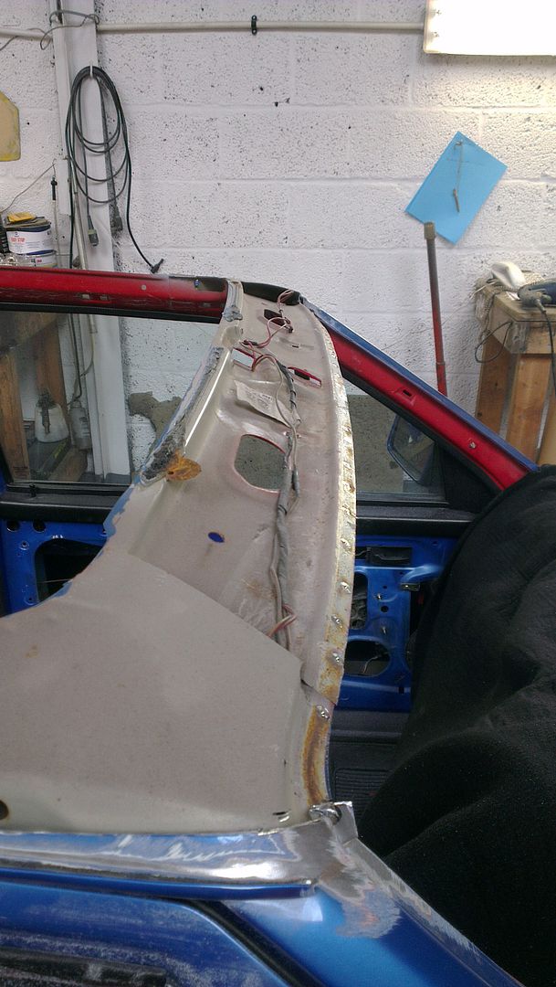

Then you start cutting...
http://img.photobucket.com/albums/v3...psd20df04c.jpg
http://img.photobucket.com/albums/v3...ps8ffa8882.jpg
Off...
http://img.photobucket.com/albums/v3...ps032bc38c.jpg
http://img.photobucket.com/albums/v3...ps3e4eb8ca.jpg
http://img.photobucket.com/albums/v3...psc9f100d4.jpg
http://img.photobucket.com/albums/v3...psa146aaf1.jpg

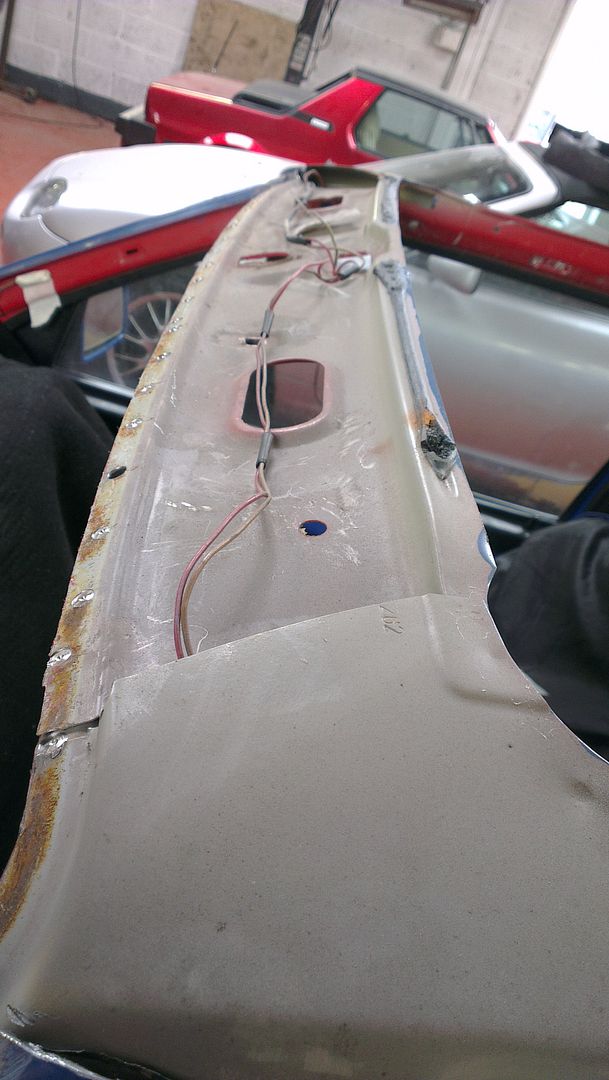

Bit i had to buy, will be welded in here. Handy holes to line up.
http://img.photobucket.com/albums/v3...psb20ae834.jpg

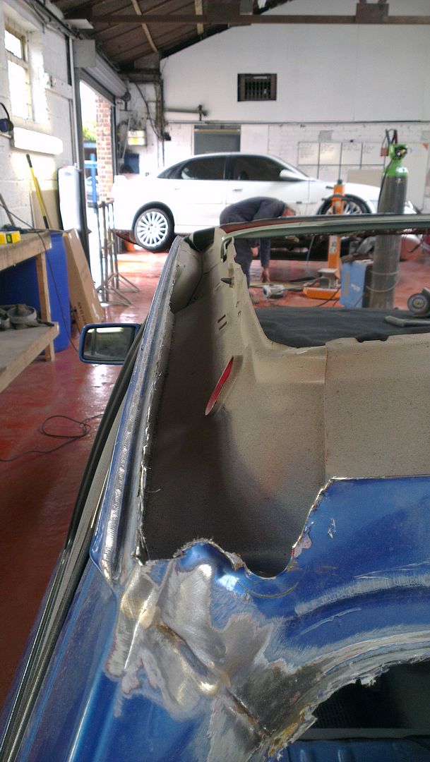

You can see here that the sides in the rails have been left at the mo,

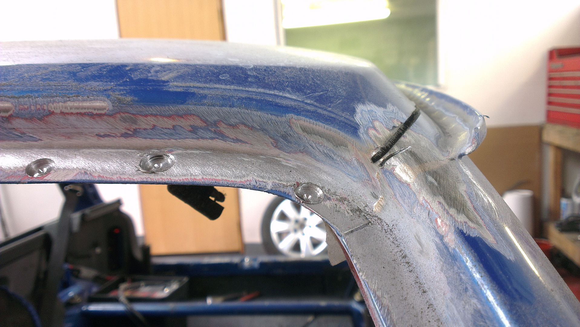

These are a rolled weld (a wheel the rolls along and welds as it goes) So cant really be drilled, so gonna have to grind the top of the weld off..

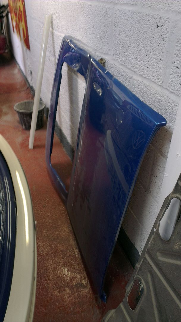

Old roof, gonna be used for metal to weld with and stuff...

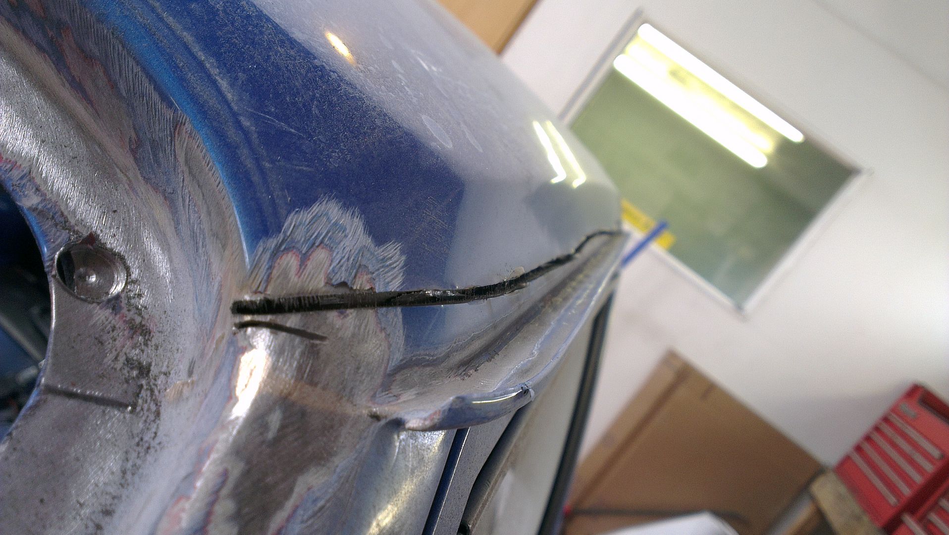

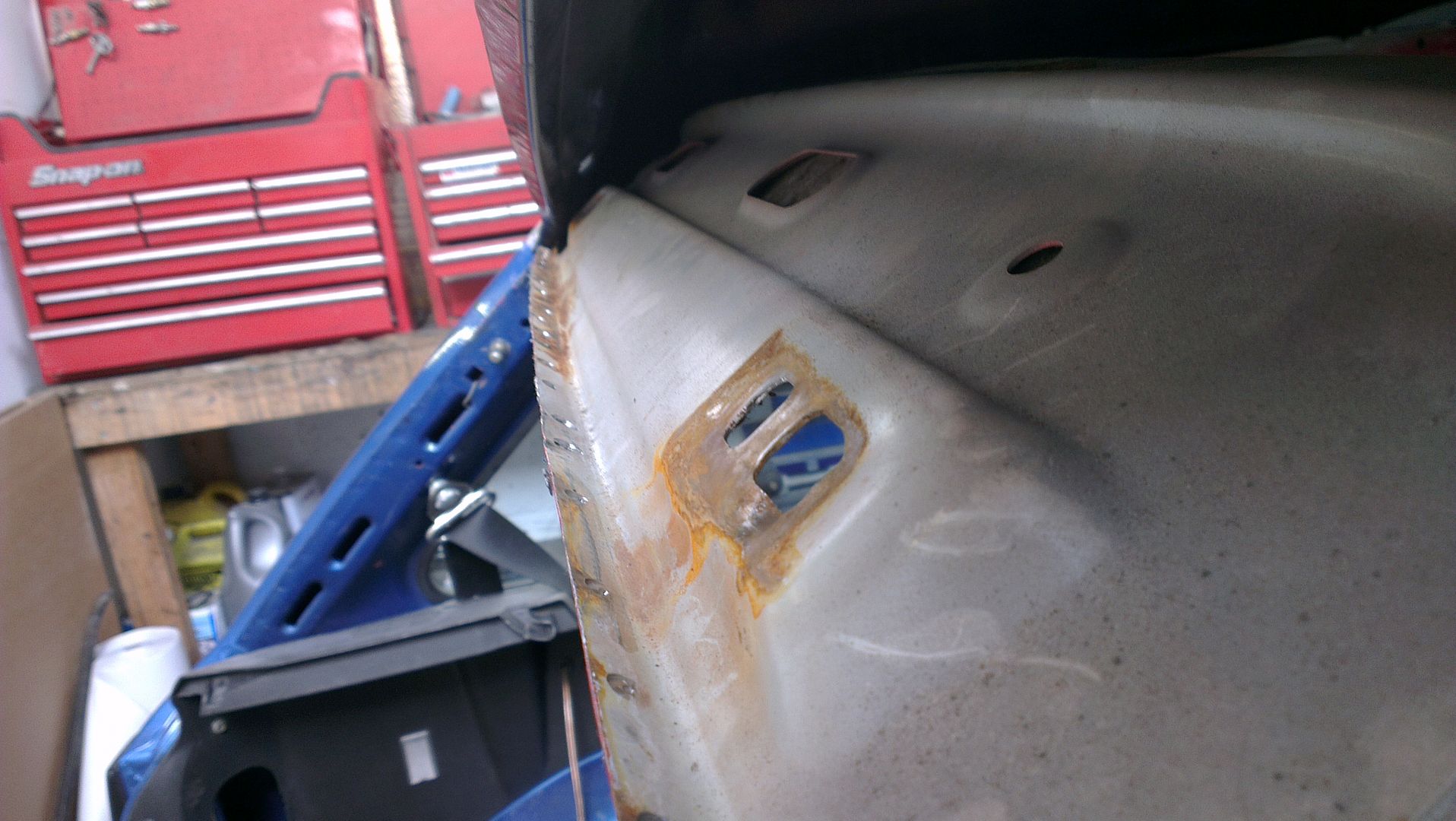

You can see here where water has got in...
All the bits like that have now been cleaned up, sealant removed and been etch primed. As metal bonda will be used on them again, then i'll give them a coat of paint once the roofs on.

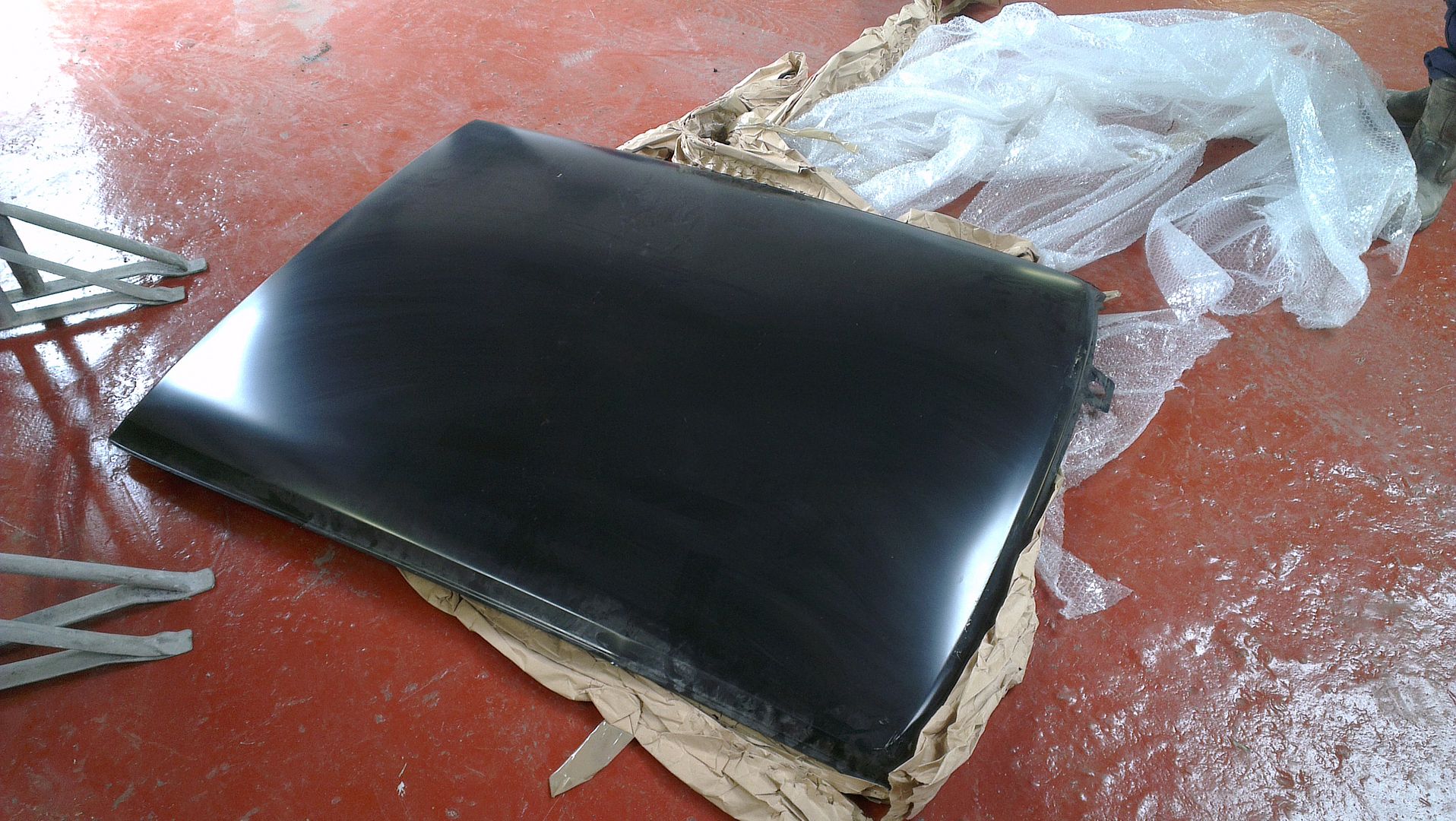

Got the new skin all unwrapped...
http://img.photobucket.com/albums/v3...ps01c2841b.jpg

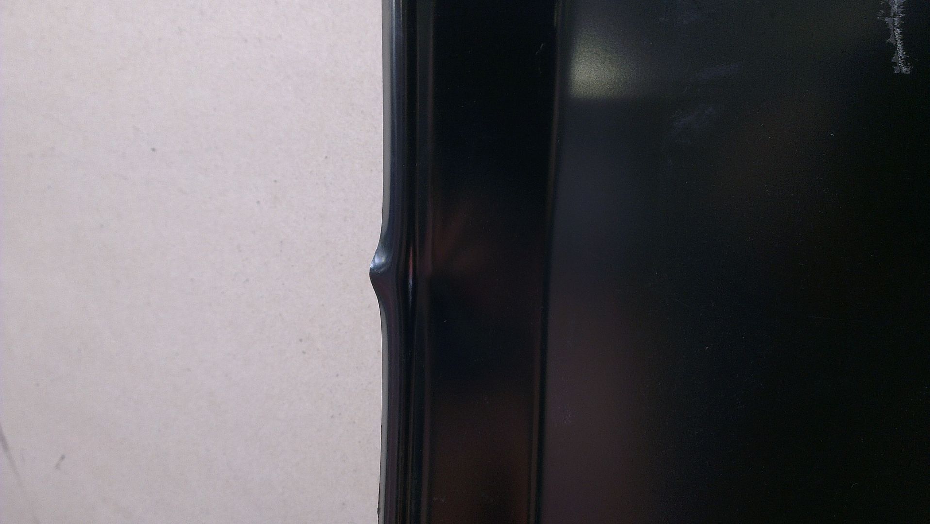

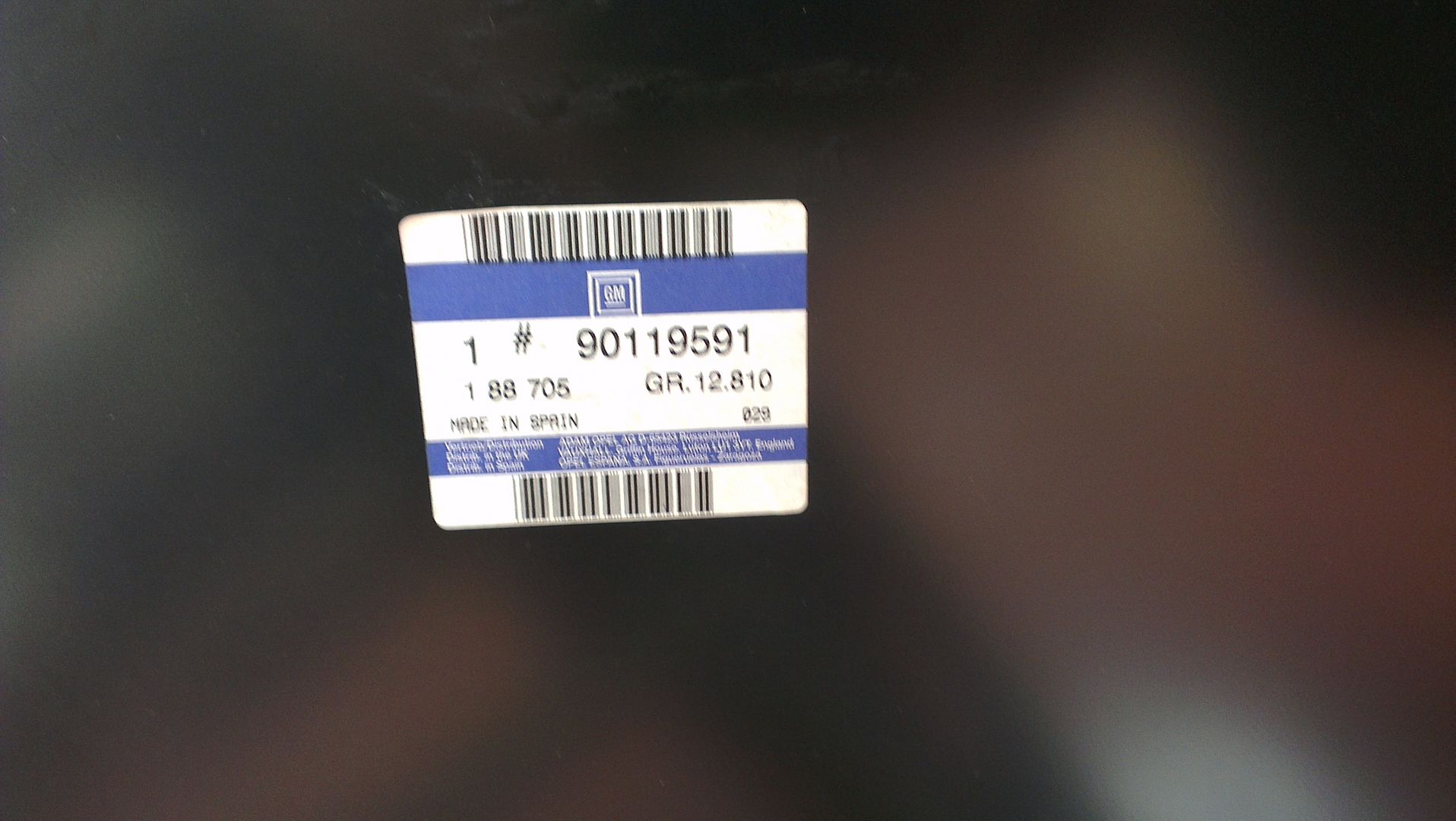

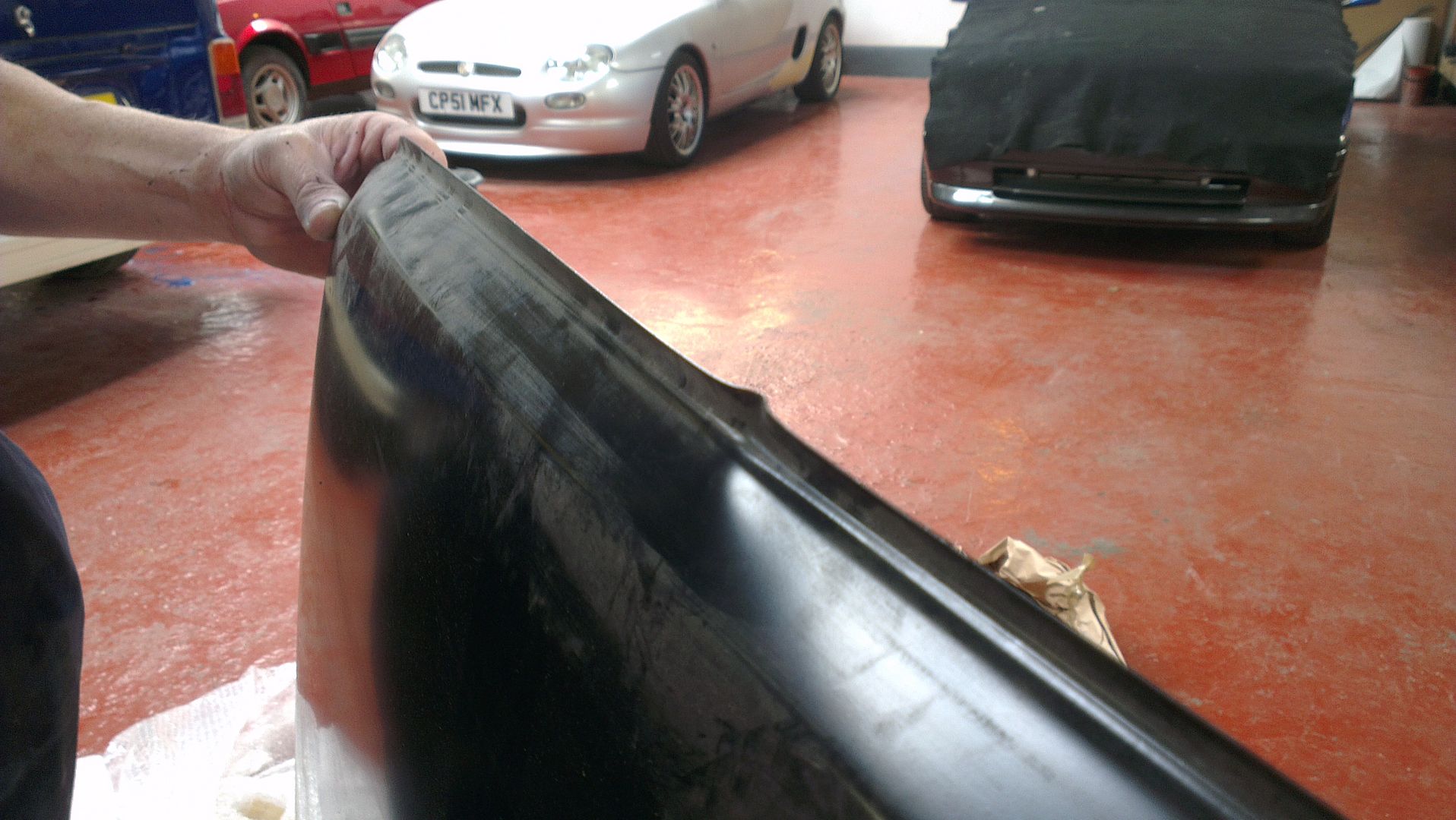

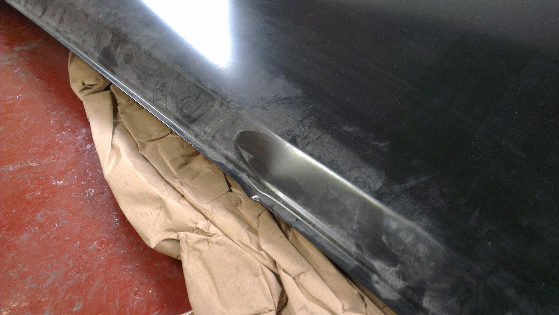

Found this :mad::mad::mad:
http://img.photobucket.com/albums/v3...ps1d408d5b.jpg
http://img.photobucket.com/albums/v3...ps4cbb2ec1.jpg
http://img.photobucket.com/albums/v3...psdd1ff806.jpg
Part number for anyone that might need it...
http://img.photobucket.com/albums/v3...ps487029af.jpg
Guess it's from where it's been stored over the years. Where really worried there would be one each side and it would be kinked thought the middle, luckily there isn't. (dent all the way across)

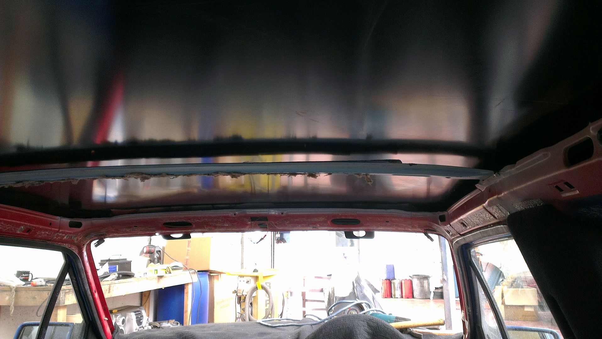

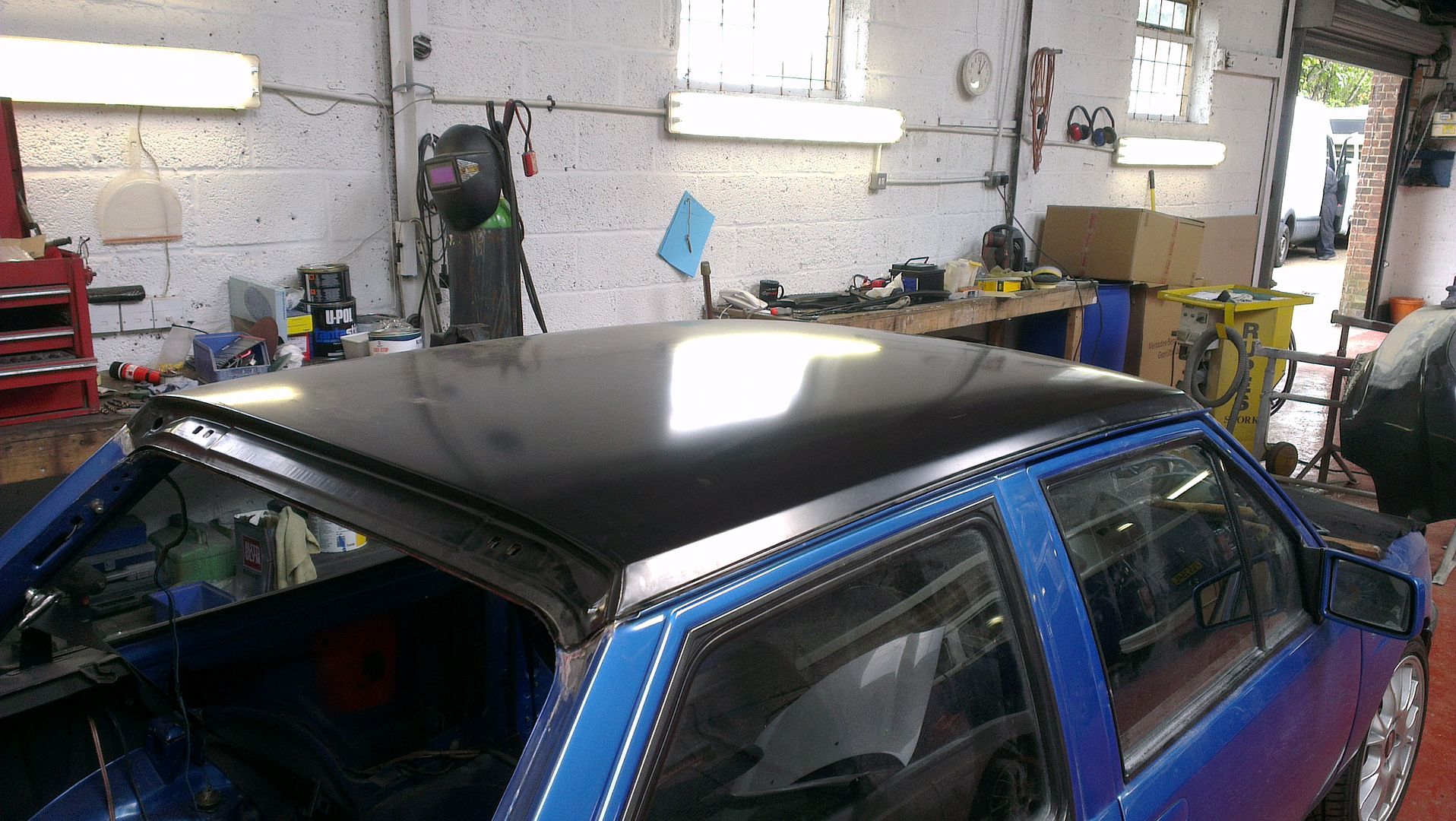

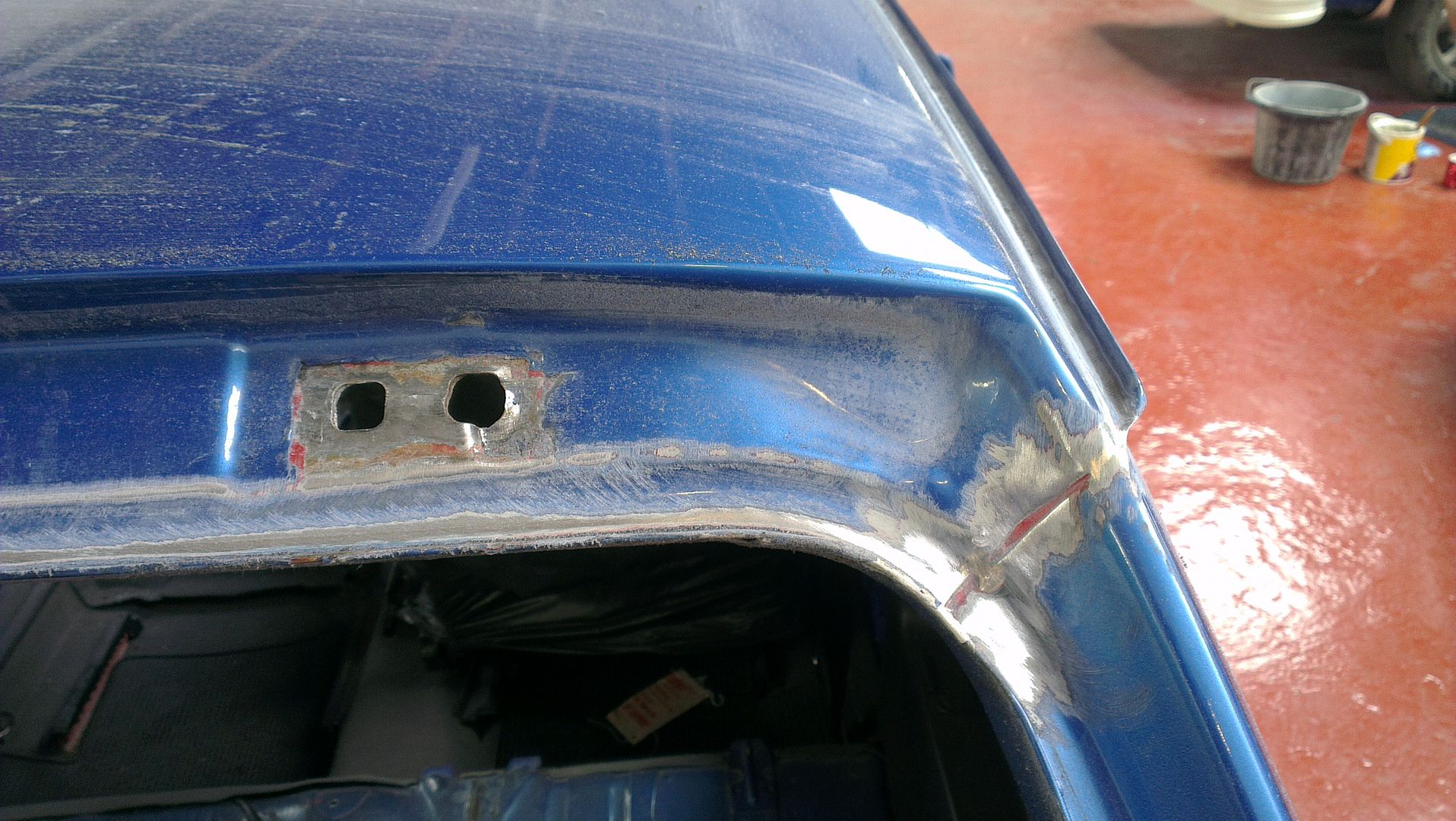

Test fitted.
http://img.photobucket.com/albums/v3...psf5c8a16a.jpg
http://img.photobucket.com/albums/v3...ps74845079.jpg
http://img.photobucket.com/albums/v3...psfe73a496.jpg
Now the skin isn't fully on but theres still a big gap... Hopping it will touch when the gutters are sorted and it's sat down all the way.

Cheers dude. So gutted the roof has two dents in it tho. But then again it wasn't really packaged.
Massive respect for attempting such a make or break task...looking very good..
I bet it's so annoying getting brand new gm parts that are very rare and they have dents ect in them! But good work man that's a big job
Thank you. It has been a worry.
It is very annoying. Got it so would be the best way, but then when you think that it was made in 1990 (from the sticker on it) then OCP got it who knows when, so thats 22/23 years old, 2 warehouses, 1/2 moves. No box or anything, thin cheap bubble wrap. It's a hell of a lot better than it could be....
