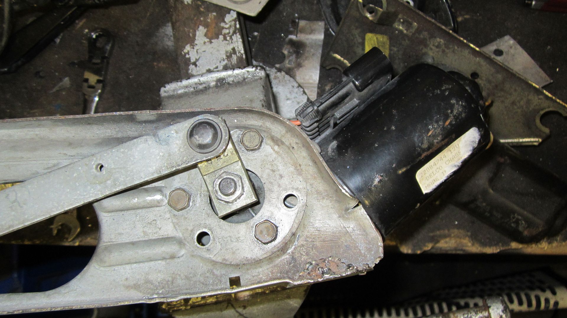

Think it's AX one, but can't remember... First new mod was to move the motor, as it hits the fan motor and or the header tank..
http://img.photobucket.com/albums/v3...psade9b51c.jpg

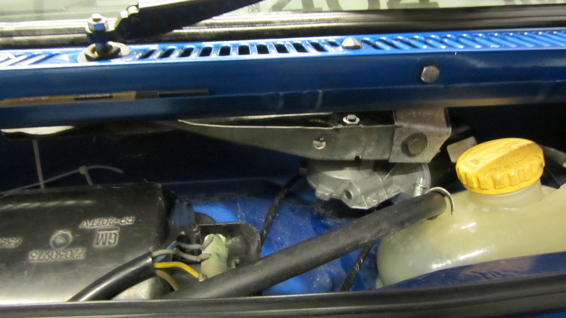

Then refit, this time i've dropped it down after seeing a few people have done the same, seems to improve the angle that spindle sits through the scuttle panel...

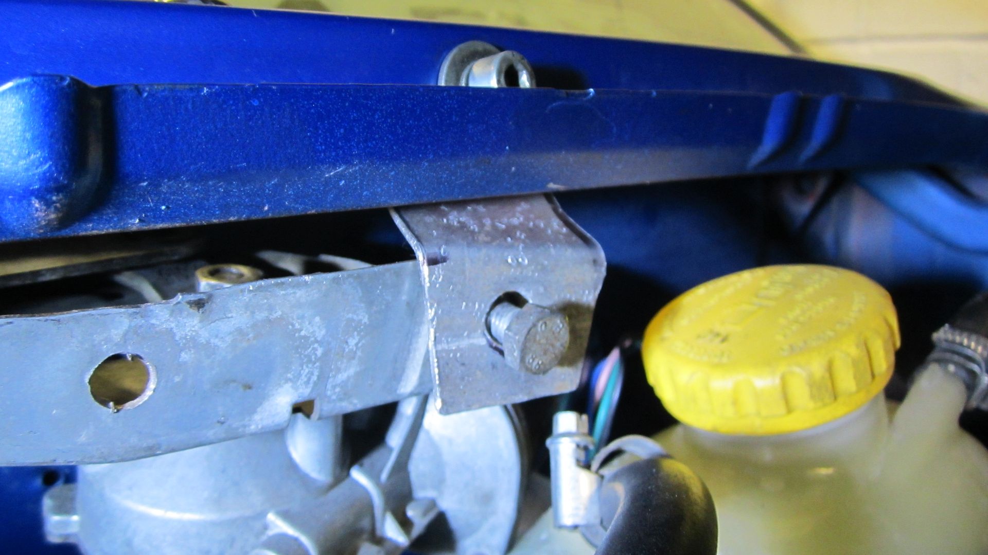

Made a mount,
http://img.photobucket.com/albums/v3...ps313784fe.jpg
Welded nuts on the motor and back of the mount, to ease fitting...
http://img.photobucket.com/albums/v3...ps59cd25ea.jpg
Tested a few times and had to reset the linkage a few times, but seems to be ok, but a bit of a judder on the way over...

The closer you can get the spindle to the angle of the screen the less the wiper will angle itself at either side of the sweep. Judder may be from that angle.

Yep i know, but that seems to be the best angle i can get.. Doesn't wanna move anymore... Think just a tiny bit would do it too.
