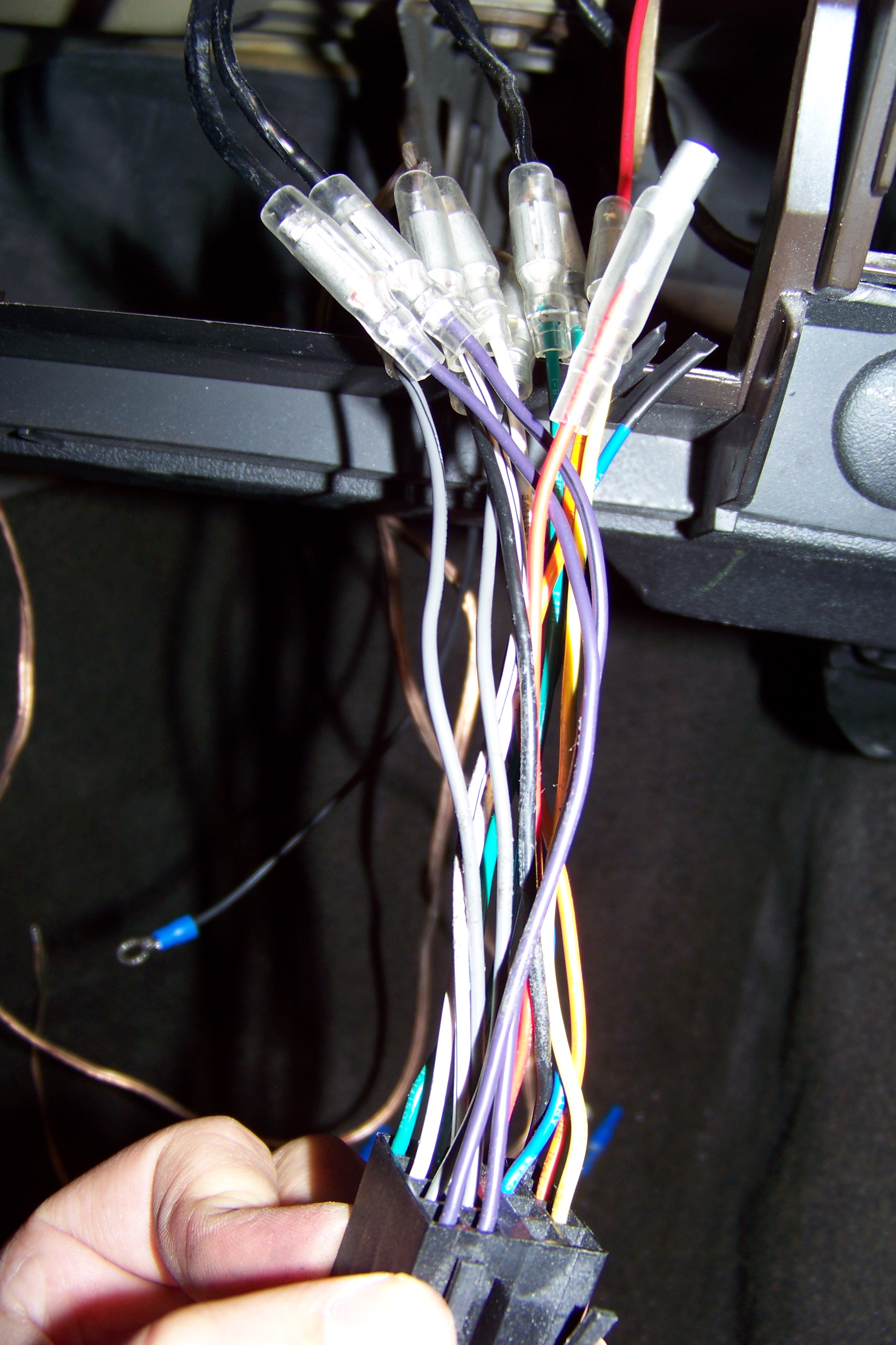

Anyway, moved on to the wiring. Stripped the rest of the old manky bullet connectors and replaced them with the lovely new ones till the were all replaced.
I then removed the actual stereo loom from the cars loom adaptor and wrapped that in fabric tape leaving the removable connectors and untouched wires open for future connections.

I was then left with the adaptor loom.
After fitting the new bullets

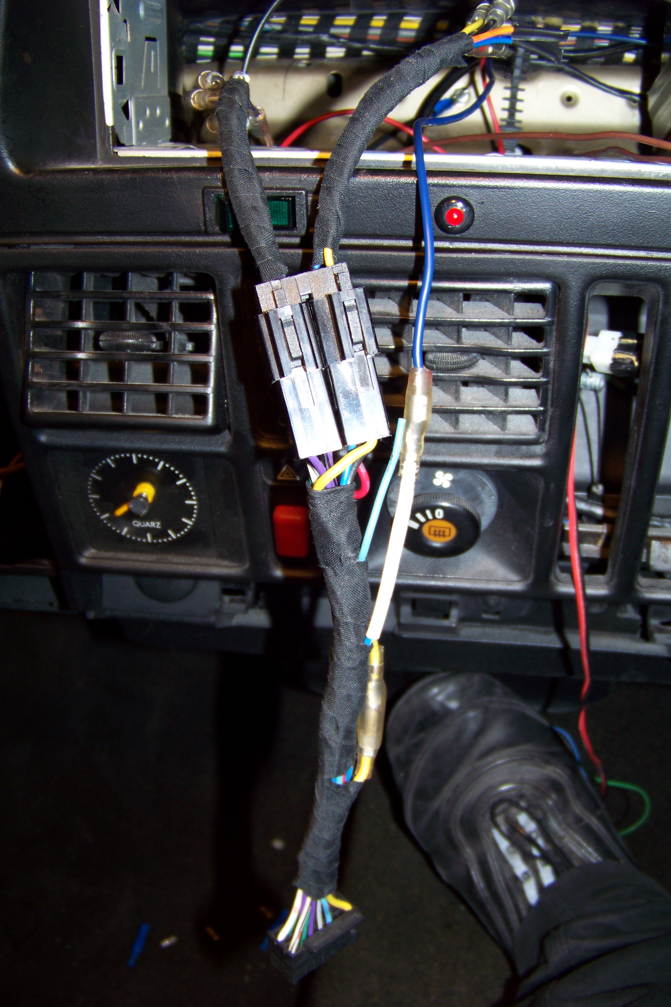

After wrapping the looms. I left the power side and speaker sides separate from each other incase of future work.
Both looms connected
https://images2.imgbox.com/c3/c7/r3wQMLVX_o.jpg
It has helped to reduce the overall size of the two looms and free up some space. Also managed to cut back the extra lengths of wire.

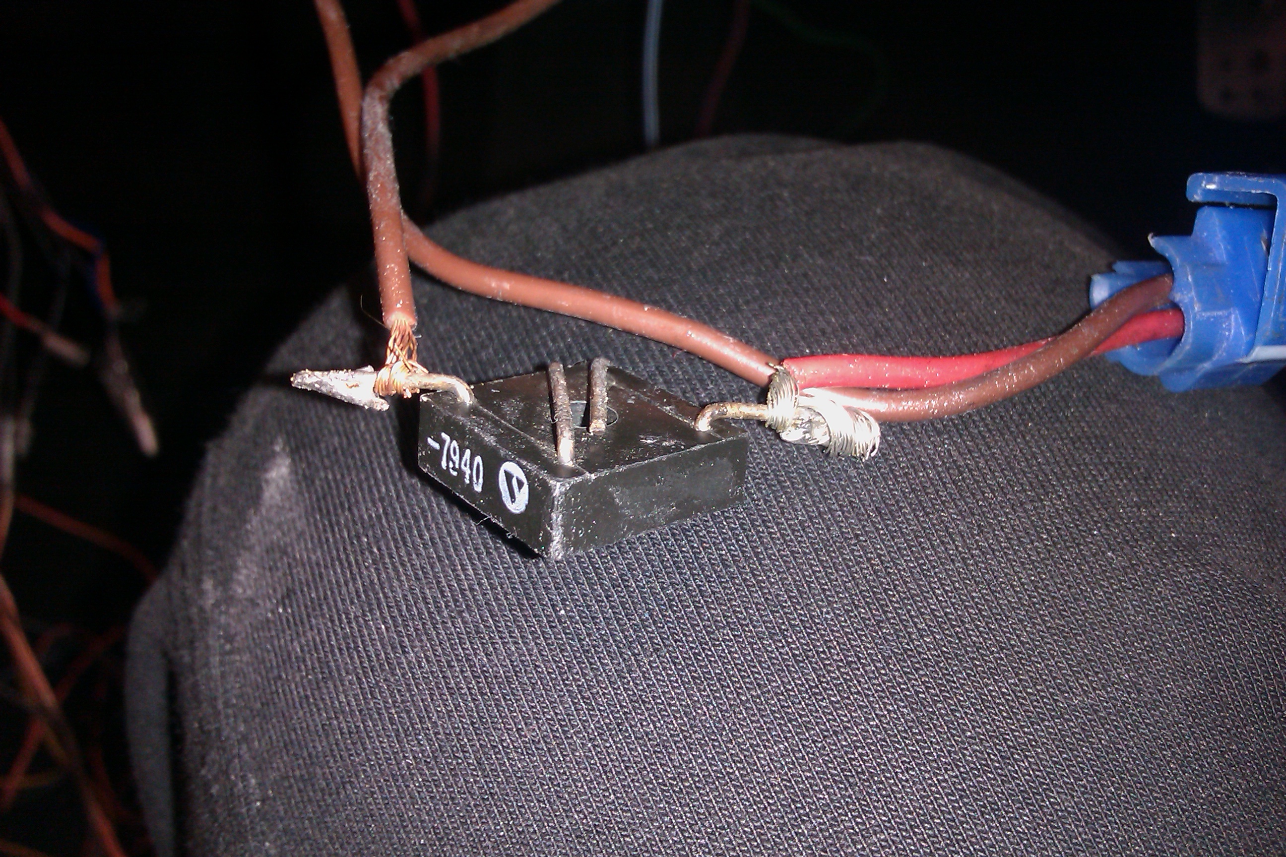

From my previous post, you'll be able to see a green switch just under the stereo (yes, the one that's not centered). That switch has 3 terminals. Two of which are in use. One of the terminals is connected to the back of the hazard switch. The other terminal connects to the stereo loom (power feed) via a scotch lock and this funny little thing (no idea what it is):
https://images2.imgbox.com/87/f4/jz6l7caq_o.jpg
Any ideas as to what it is? Do I actually need it? I have no idea what it does
Hopefully someone can sus out what it is and I can then make a decision as to whether it is needed to finish off the stereo loom, so I can then move on to the alarm loom... yay!

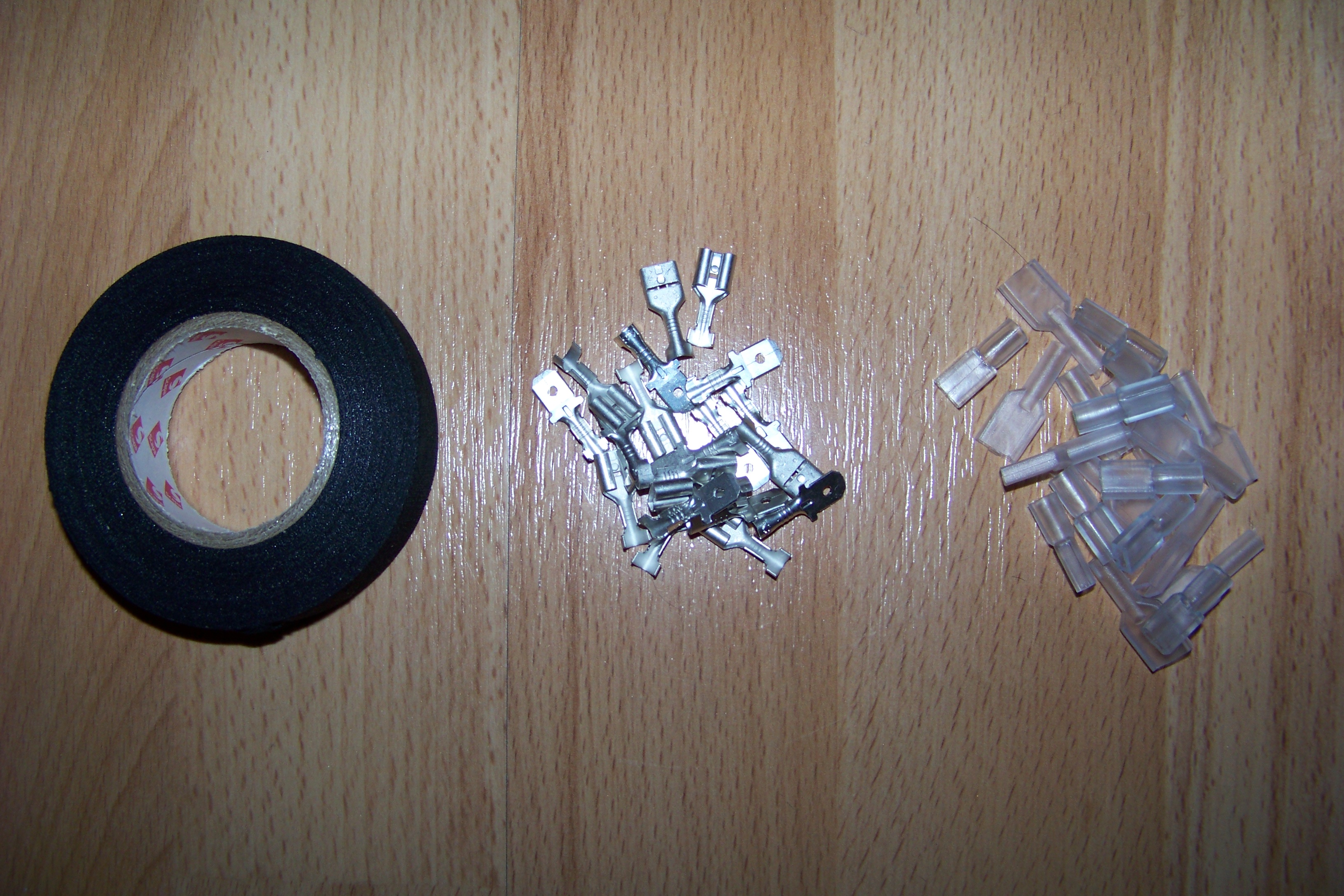

Got a few more goodies through the post, well only the bits that I had ran out of.
https://images2.imgbox.com/c6/2e/qbqJ4eim_o.jpg
http://img831.imageshack.us/img831/6084/1001930.jpg
More loom tape and an assortment of large and small spade terminals and their insulators.

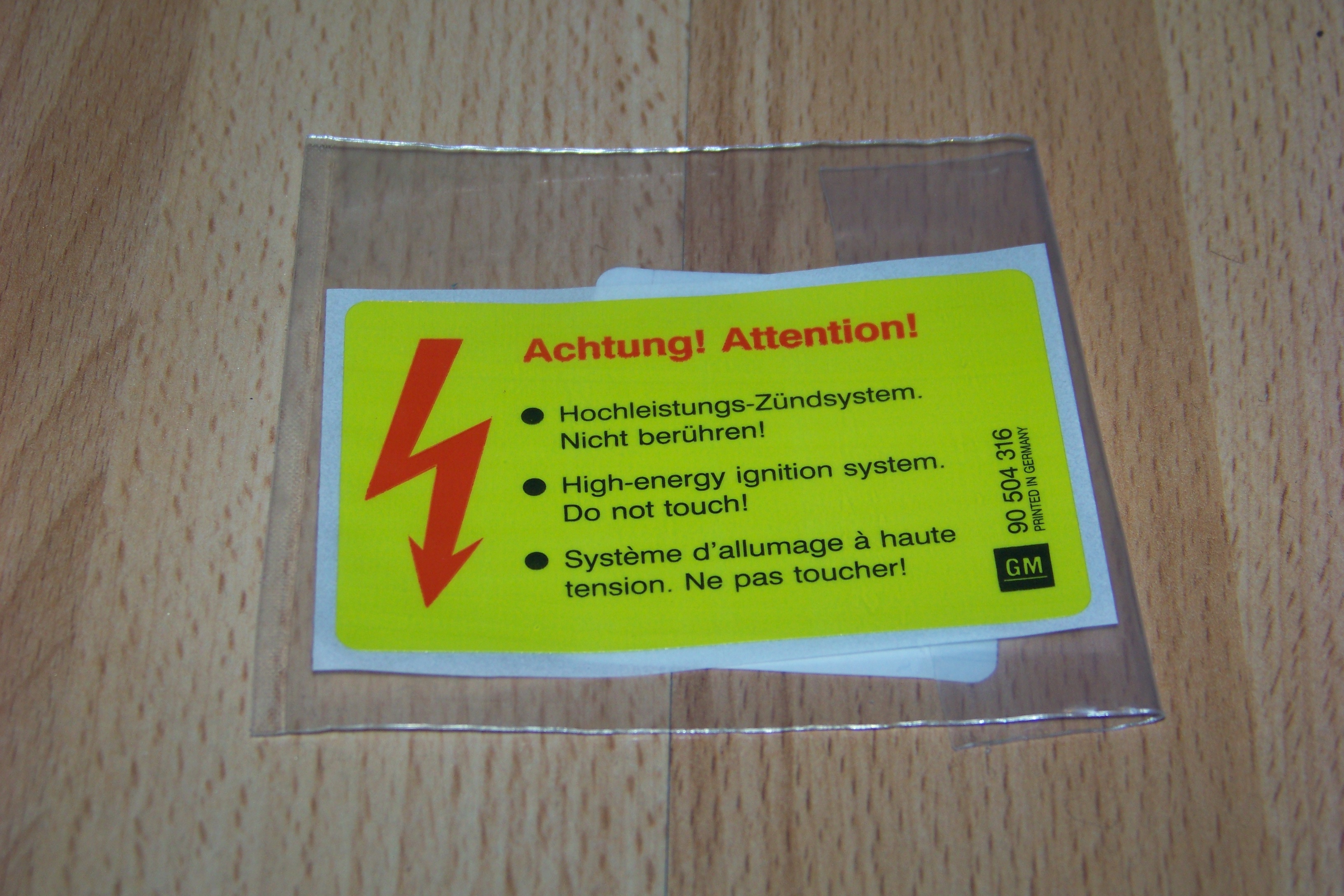

Then remembered that I had ordered something from Vaux, so I went to collect it.
Here's what it was
http://img693.imageshack.us/img693/2332/1001929z.jpg
https://images2.imgbox.com/c9/ce/qK3kNYTG_o.jpg
The warning sticker for the coil :) Tried to get the cooling fan caution sticker but they were NLS :(
