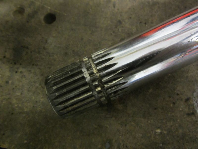

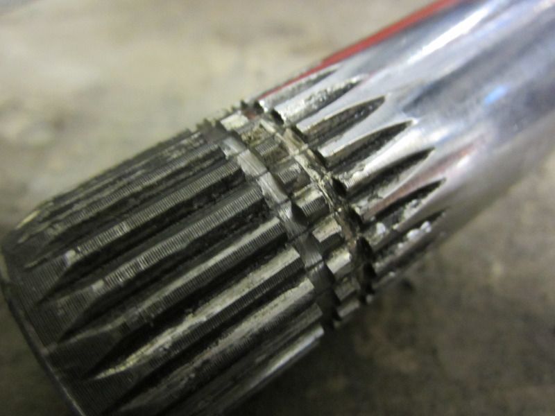

As i'm sick of the shaft and cv crap, I wanted to help it in anyway. So even after testing that i had good movement on the inner joint, i've had the circlip groove move out by 2mm.
http://img.photobucket.com/albums/v3...n/IMG_1410.jpg
http://img.photobucket.com/albums/v3...n/IMG_1412.jpg
Fitted in to the shaft, the old one is the top one..
http://img.photobucket.com/albums/v3...n/IMG_1413.jpg
Built the shaft up and refitted it.. Washed and waxed the arches while i was there.

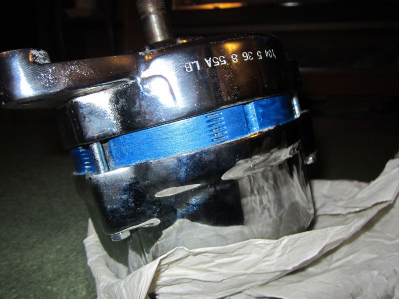

Now a factory alt just doesn't look that nice, so with Dan's help i stripped it down and sent it to a man to make it sexy..
All getting rebuilt with new bearings, bushes and contacts.
http://img.photobucket.com/albums/v3...eAltbuild2.jpg

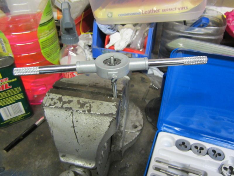

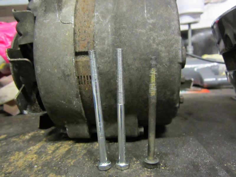

Got new bolts, which had to be cut and re tapped.
http://img.photobucket.com/albums/v3...eAltbuild4.jpg
http://img.photobucket.com/albums/v3...eAltbuild1.jpg

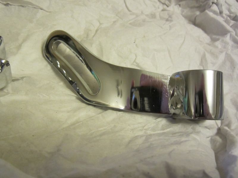

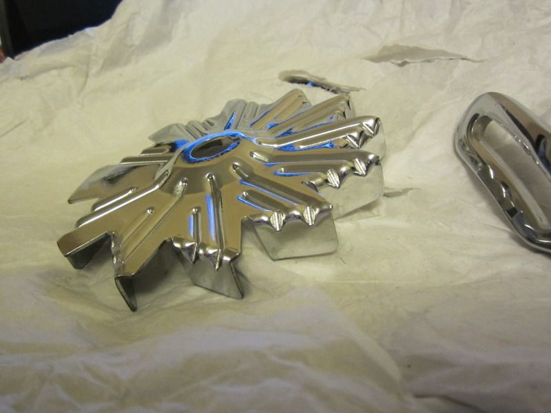

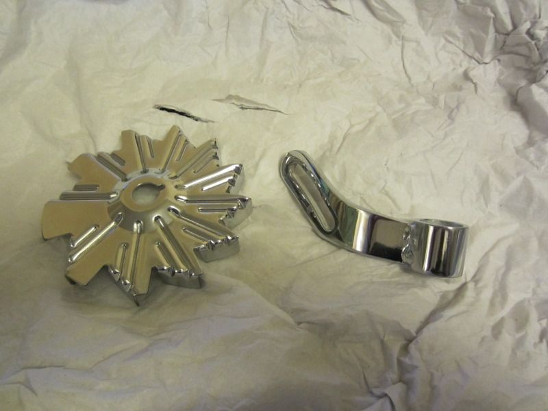

Casing was chromed, pulley and top arm.
http://img.photobucket.com/albums/v3...omebits1-1.jpg
http://img.photobucket.com/albums/v3...omebits2-1.jpg
http://img.photobucket.com/albums/v3...omebits3-1.jpg
But this left the middle bit looking dirty, so gave it a lick of etch primer..
http://img.photobucket.com/albums/v3...n/IMG_1416.jpg
Then a lil Arden blue.. To look better.
http://img.photobucket.com/albums/v3...n/IMG_1417.jpg
http://img.photobucket.com/albums/v3...n/IMG_1418.jpg
Now i just gotta try and fit it, which really wont be easy :(

love the alternator, something i need to do to mine as it doent look very nice how i painted it.
loving the attention to detail, but Benn will you ever be satisfied or have the week off? hope your well big fella
I painted one year back, after fitting and a few miles it looked poo. Then after seeing Matt's and a few other cars with them. Chrome just had to be done.

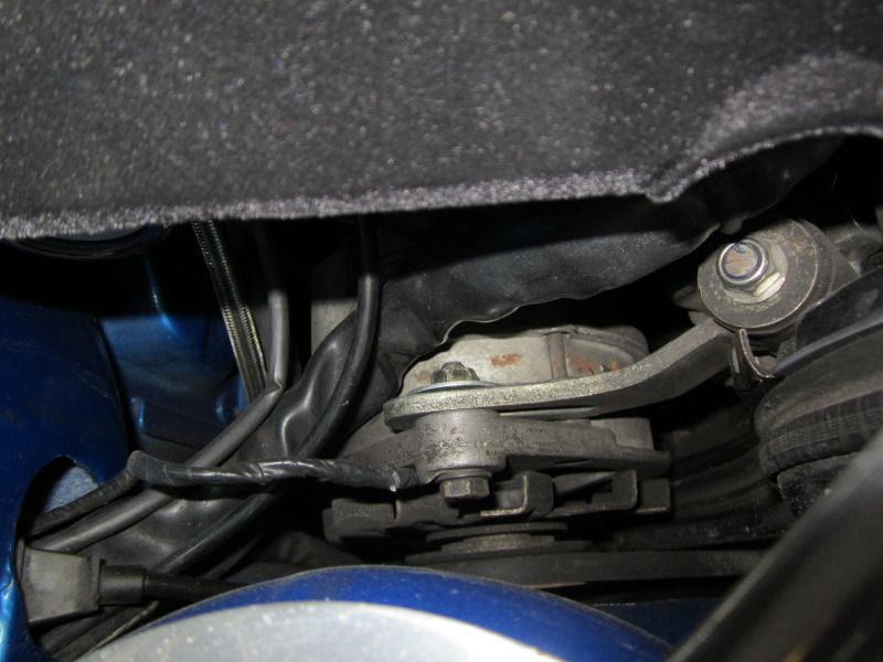

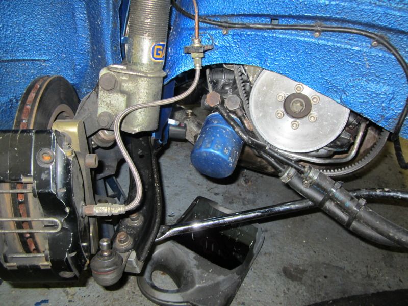

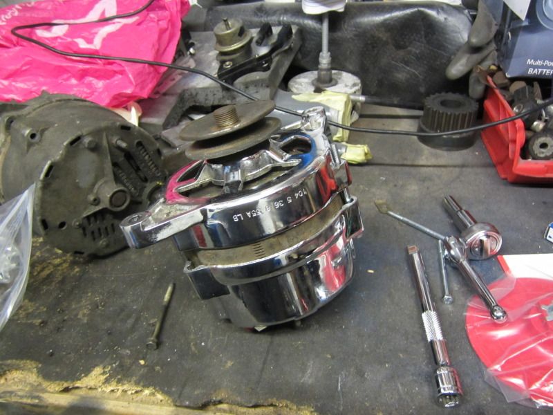

Alternator swapping time.. From the top... Seems a bit of a waste chroming it now.
http://img.photobucket.com/albums/v3...n/IMG_1422.jpg

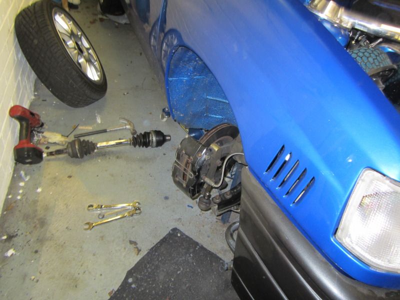

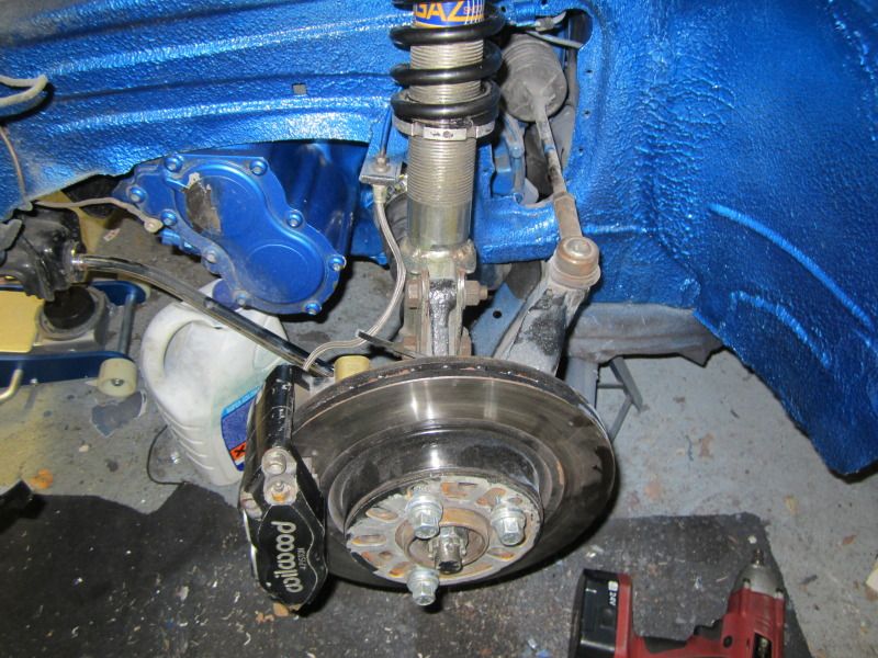

Found i need to get the shaft out to be even close to getting the alt out.. So i had to drop the car down, push it out, push it in but over to the other side..
Shaft out (bit easier as it's a half shaft) That wasn't enough the turbo oil feed was right in the way, so had to unbolt and push it to one side.. Or and unbolt the steering arm too :roll:
http://img.photobucket.com/albums/v3...n/IMG_1426.jpg
http://img.photobucket.com/albums/v3...n/IMG_1427.jpg

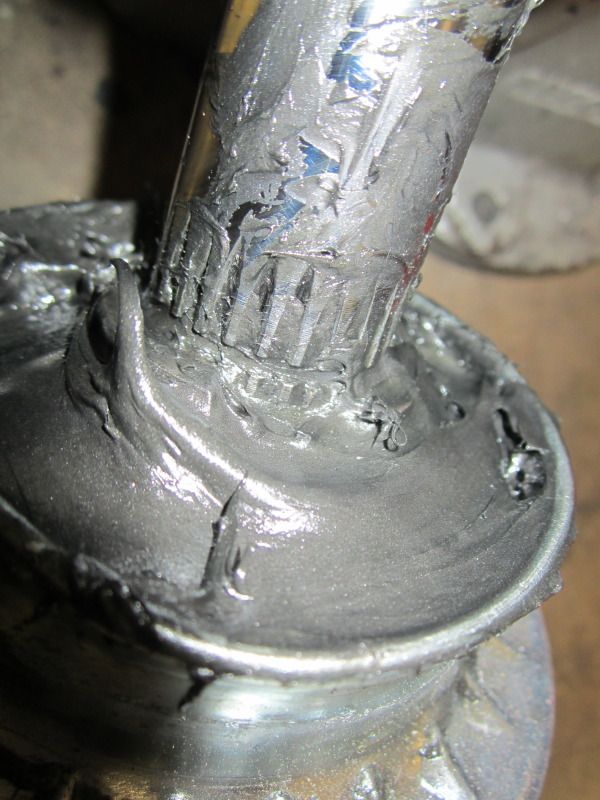

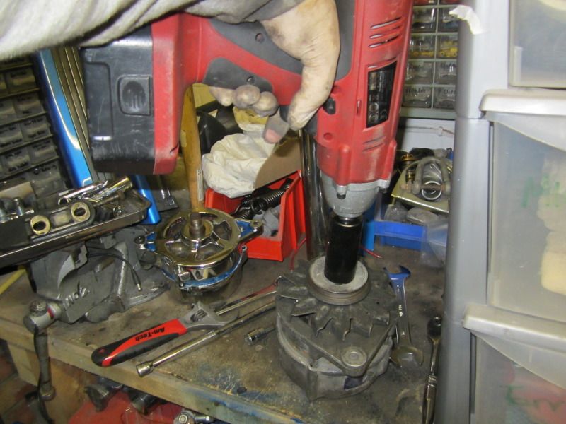

Unbolt the nut was a **** hole! Nut was so tight, allen key in the shaft was just getting chewed up.. The brain wave!
http://img.photobucket.com/albums/v3...n/IMG_1430.jpg
Straight off!

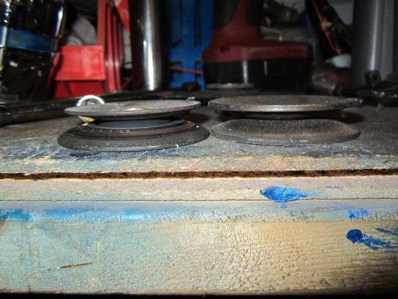

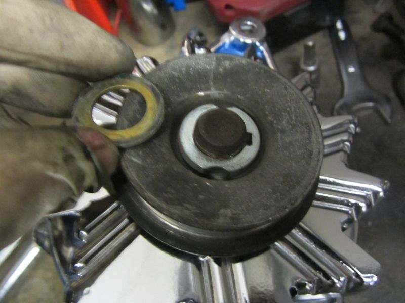

Now years ago, i had a prob with the alt touching the chassis leg, so Dan turned (machined) down my pulleys,nut and shaft. Gave me a good clearance. So i wanted to show that...
http://img.photobucket.com/albums/v3...n/IMG_1431.jpg

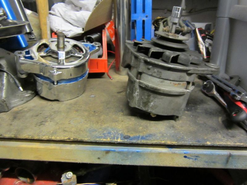

Oh, then i noticed that it's all a bit different.
The old alt has a keyway, the new doesn't. So swapped everything over..
http://img.photobucket.com/albums/v3...n/IMG_1432.jpg
The shaft looks shorter which is good.
Pulleys looks a bit poo tho. So had to paint them. Didn't wanna chrome them as it might chip/break off when the belts on.
