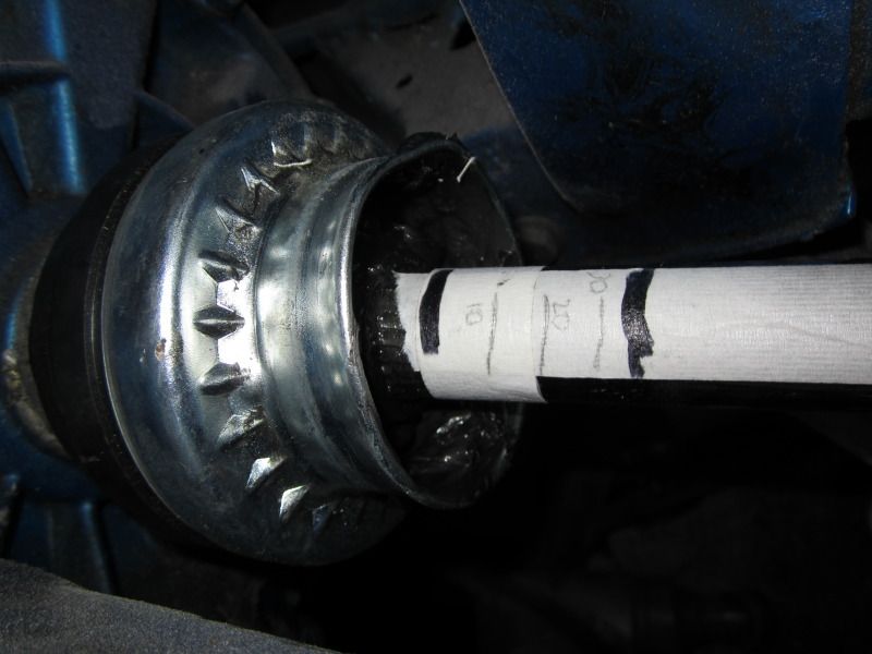

Small update,

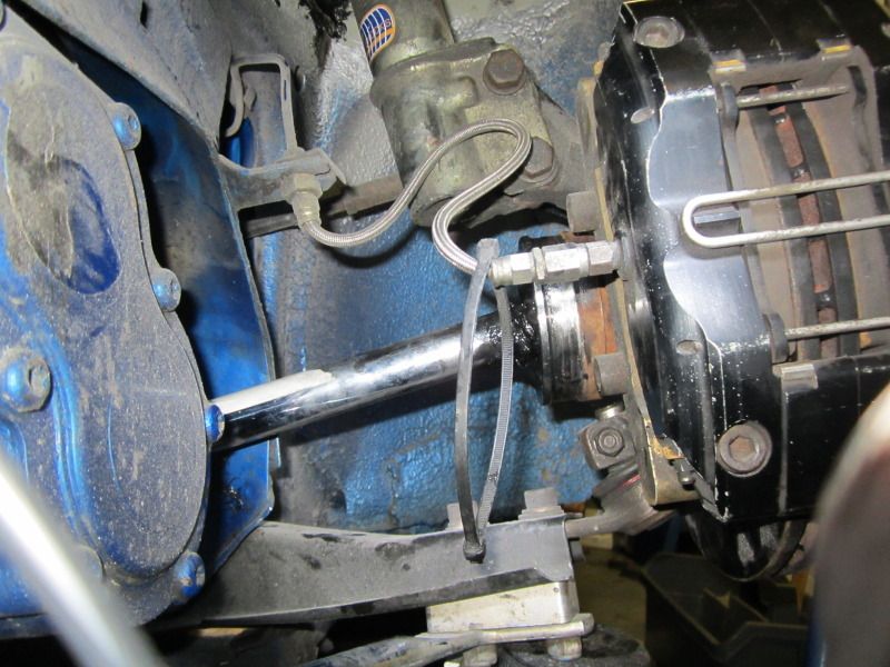

Removed the shaft, measured how much the joint moves on the shaft...
http://img.photobucket.com/albums/v3...n/IMG_1369.jpg

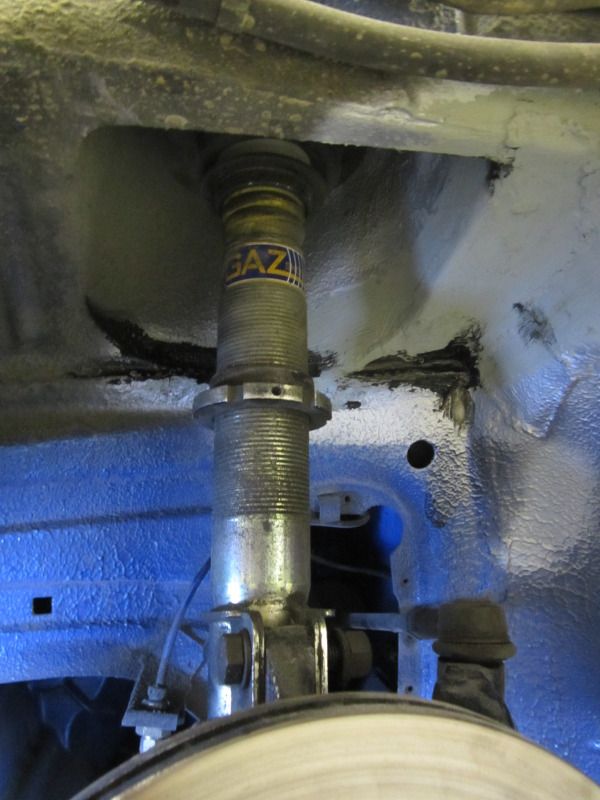

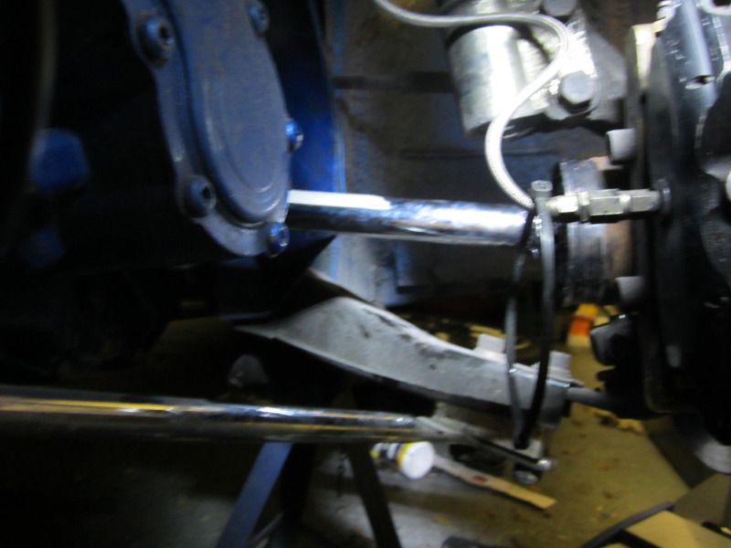

Refitted the shaft, jacked the leg up to the highest point it can (4 inch long spring)
http://img.photobucket.com/albums/v3...n/IMG_1375.jpg
Giving a shaft angle of this...
http://img.photobucket.com/albums/v3...n/IMG_1374.jpg

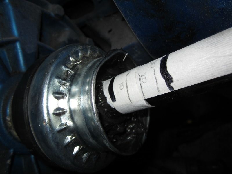

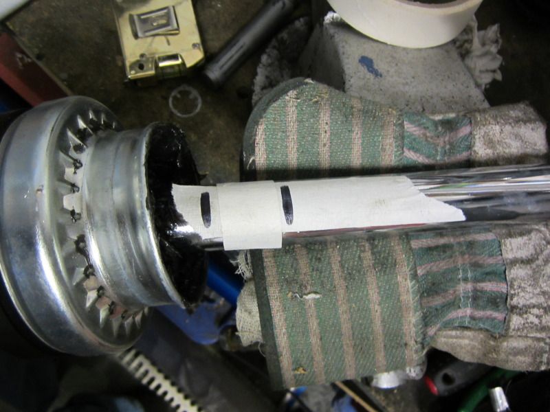

Joint plunged in fully..
http://img.photobucket.com/albums/v3...n/IMG_1377.jpg
And fully extended.
http://img.photobucket.com/albums/v3...n/IMG_1376.jpg
Giving me 15-20mm movment (hard to measure with where it is)
Leg dropped down to its full open lengh (9inch long spring)
http://img.photobucket.com/albums/v3...n/IMG_1379.jpg
Giving me a shaft angle of this (looks straight but isn't)
http://img.photobucket.com/albums/v3...n/IMG_1378.jpg

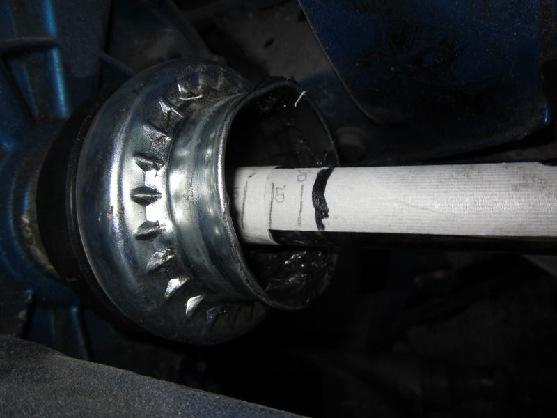

Fully in,
http://img.photobucket.com/albums/v3...n/IMG_1381.jpg
Fully out,
http://img.photobucket.com/albums/v3...n/IMG_1380.jpg
Giving me almost the same movement of about 20mm..
So that would mean that it's not the plug and extension that's damaging the cv joints yes? As they move in and out about the right amount...
That means it is angle that has damaged the cage, popping the bearings out and breaking the cv.
Thoughts?
