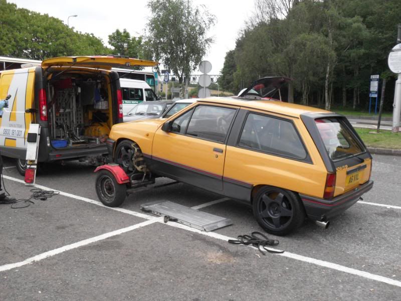

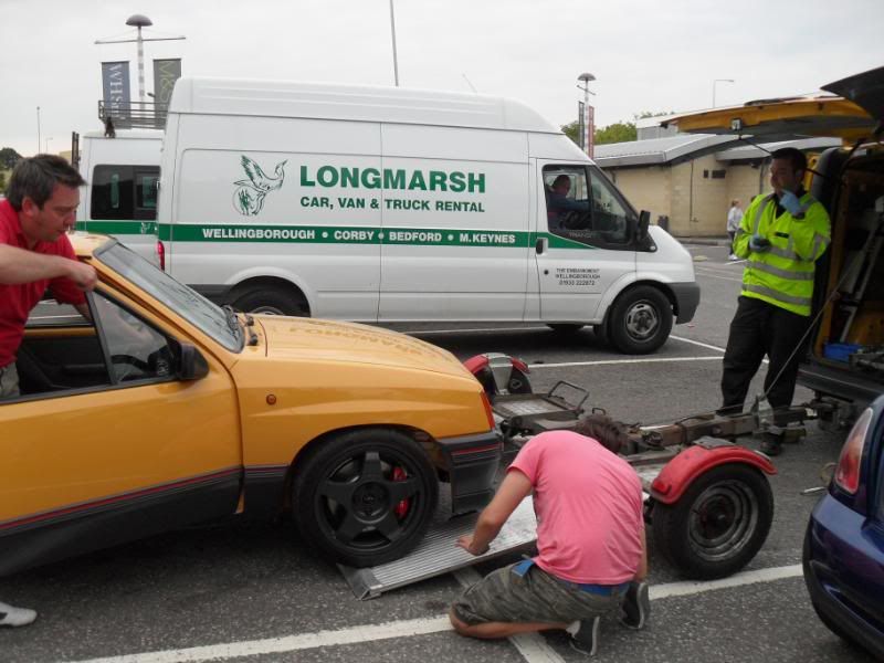

As great as the weekend was by the time late afternoon sunday came it was time to set off home. Off we went down the m1 which for fine until approx an hour into our journey when the battery gauge went down to a quarter and then shortly after into the red. The services were only a mile away so I planned to stop and take a look but seconds later I lost all power and ended up on the hard shoulder of the motorway! With the bonnet up their was nothing I could see obviously wrong so I gave Andy a call for help! Luckily he had just turned off for stoke a juction before so wasnt far away and came back to tow me into the services were I called the AA. Not long after they turned up we got a diagnosis of a dead alternator! I was quite shocked at that with it being brand new but obviously it was just a dodgy part. The car was then loaded up for the journey home.........
http://i84.photobucket.com/albums/k2...g?t=1311432672
http://i84.photobucket.com/albums/k2...g?t=1311432745
Good job the car isnt uber low as it just made it onto the towing dolley with minimum clearance! We then finally got home around 10.30pm sunday night due to the above. Huge thanks again to Andy and his missus Emily who turned around and came back to help us. :) However that was'nt the end of sundays epic fail......... Upon arriving home the AA chap was a little slack unloading the car and caught the front bumper which pressed onto the lower return lip of the front panel. Even though the damage was very minimal I was very annoyed and got all the necessary details from the guy to put in a claim. Pics of said damage.......

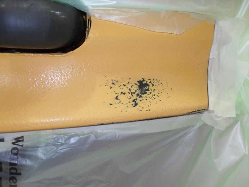

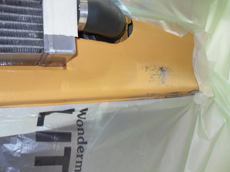

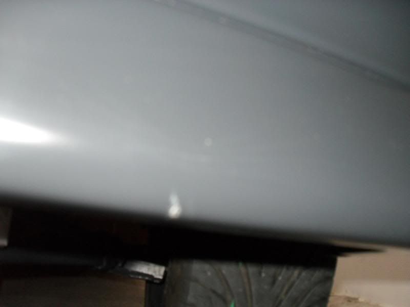

Poor picture but the bottom edge of the bumper was gauged and a small stress fracture of the plastic was above it........(Look for the white lines that spread horizontally either side of the gauge)...........
http://i84.photobucket.com/albums/k2...g?t=1311433283
In this pic you can just see were its pushed the lower return lip of the front panel upwards.......
http://i84.photobucket.com/albums/k2...g?t=1311433424
The worst part was how the bumper was sat as it had been pushed well out of alignment and was practically touching the bottom of the headlight which made me suspect a bent carrier.........

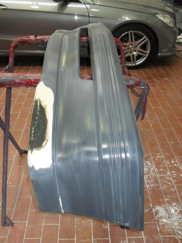

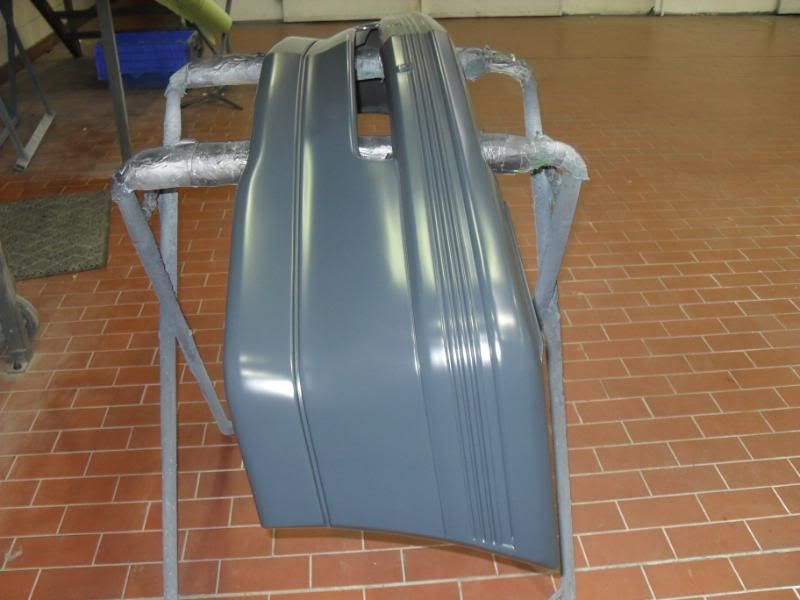

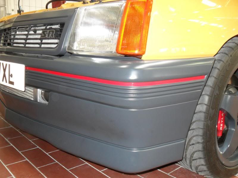

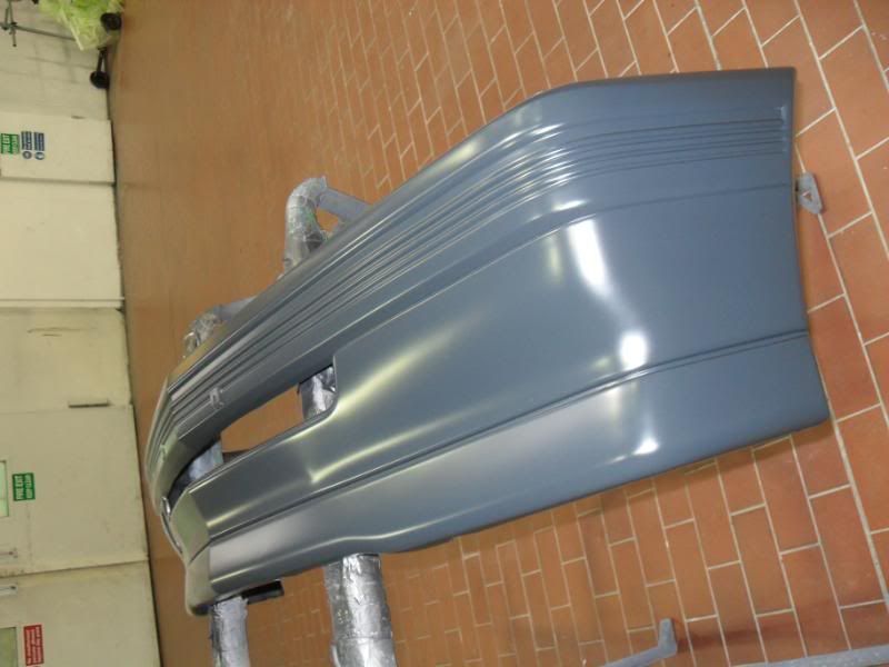

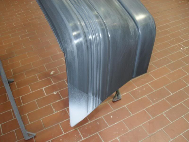

In early the following morning I got the bumper off and prepared it ready for my foreman to repair. Stress fractures can sometimes be a little difficult and need to be properly repaired. We used a cutting discs to slot the small cracks so they wont spread any further later and then use a flexible plastic filler to fill and level it.........
http://i84.photobucket.com/albums/k2...g?t=1311434458
This was later rubbed down and primed up. At the same time I repaired a small nick in the other side corner which I had damaged myself whilst the bumper was sat in the garage last year........
http://i84.photobucket.com/albums/k2...g?t=1311434532
http://i84.photobucket.com/albums/k2...g?t=1311434642

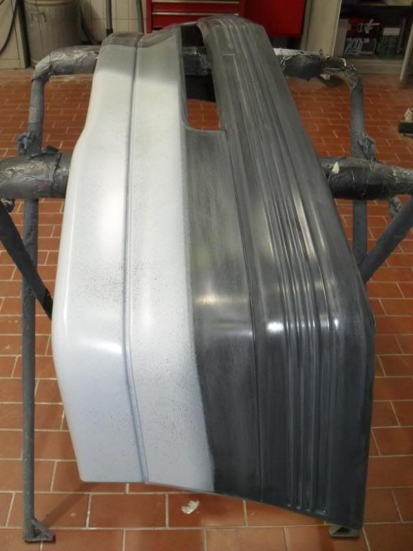

The primer was then blocked level and I got the bumper re painted.......
http://i84.photobucket.com/albums/k2...g?t=1311434749
http://i84.photobucket.com/albums/k2...g?t=1311434801
As good as new................
http://i84.photobucket.com/albums/k2...g?t=1311434835
http://i84.photobucket.com/albums/k2...g?t=1311434988

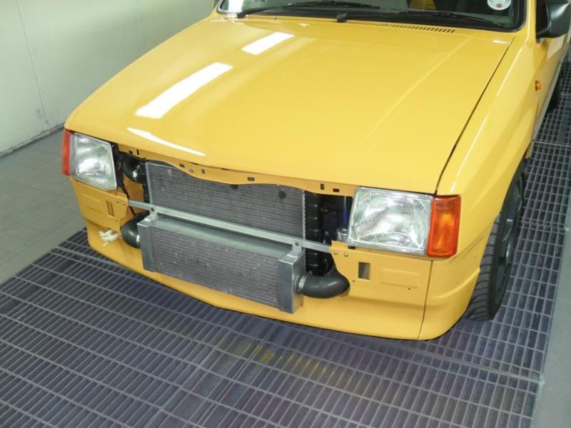

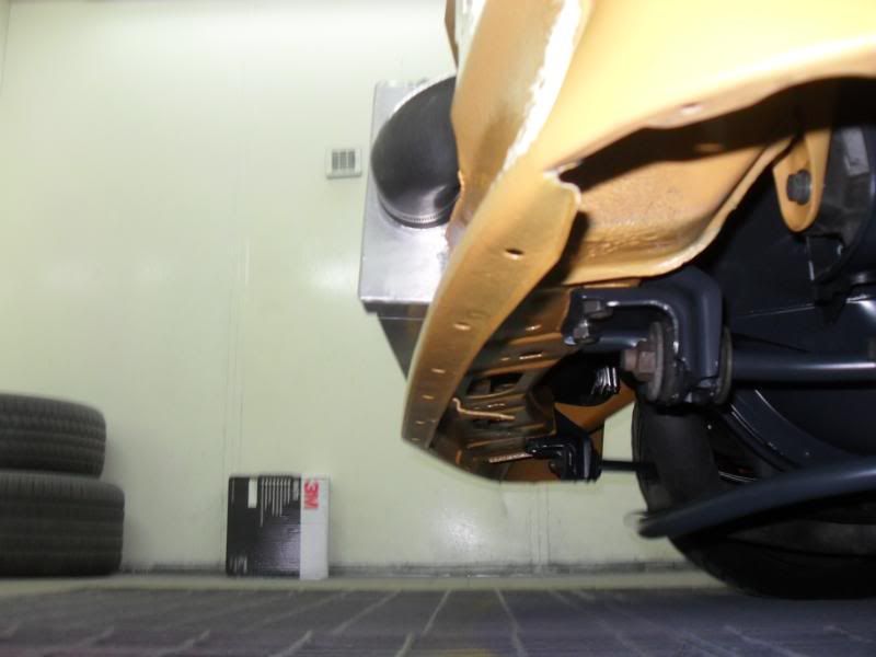

Next us was the front panel so we got the car up on some stands giving us enough room to use a slidehammer and gentley pull the return lip back to were it should be. We also noticed that when the lip had been pushed up it had put a small bulge into the front facing part of the front panel so that had to be tapped back down too. As my foreman is a superb ex panel beater he managed to do this with no need for filler. Just a gentle tap from his hammer and dolley and it was almost their. All I needed to do was give it a block to take the last of the high spot out and level it up perfectly.........
http://i84.photobucket.com/albums/k2...g?t=1311435136
http://i84.photobucket.com/albums/k2...g?t=1311435463

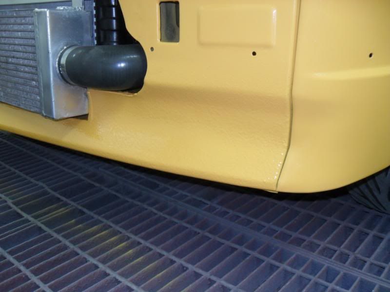

With that sorted I gave the repaired area a coat of overpaintable stone guard and left it to dry so it could be painted the next day. I also called in to see Joe on here to buy another bumper from him as it was complete with a straight iron just in case mine was bent. Cheers Joe! :)
The following days saw the lower section of the front panel repainted..........
http://i84.photobucket.com/albums/k2...g?t=1311435696
http://i84.photobucket.com/albums/k2...g?t=1311435734
http://i84.photobucket.com/albums/k2...g?t=1311435757

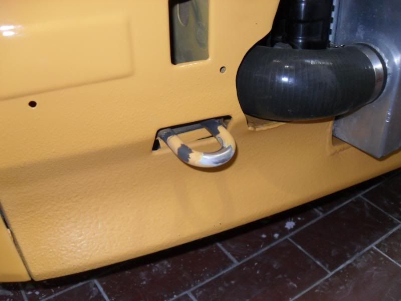

The towing eye also had to be repainted from were the towing bar had been rubbing against it...........
Before...........
http://i84.photobucket.com/albums/k2...g?t=1311436230
After.......
http://i84.photobucket.com/albums/k2...g?t=1311435786

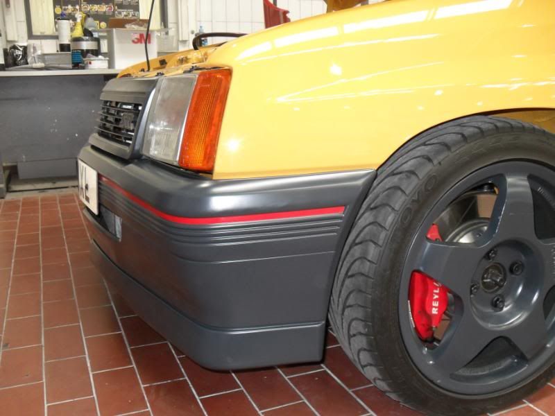

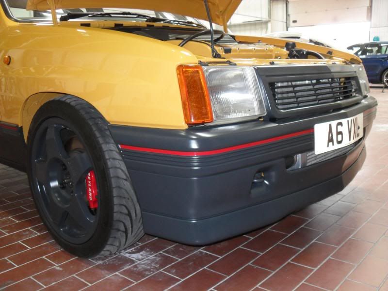

The bumper then went back on and I added the pinstripe before getting the plate and grille back in...........
http://i84.photobucket.com/albums/k2...g?t=1311436411
http://i84.photobucket.com/albums/k2...g?t=1311436527
http://i84.photobucket.com/albums/k2...g?t=1311436554
As luck would have it the iron wasnt bent so it was just re adjusted and the bumper then lined up perfectly again. Phew! :) A quick wash and it was time to go back home.........
