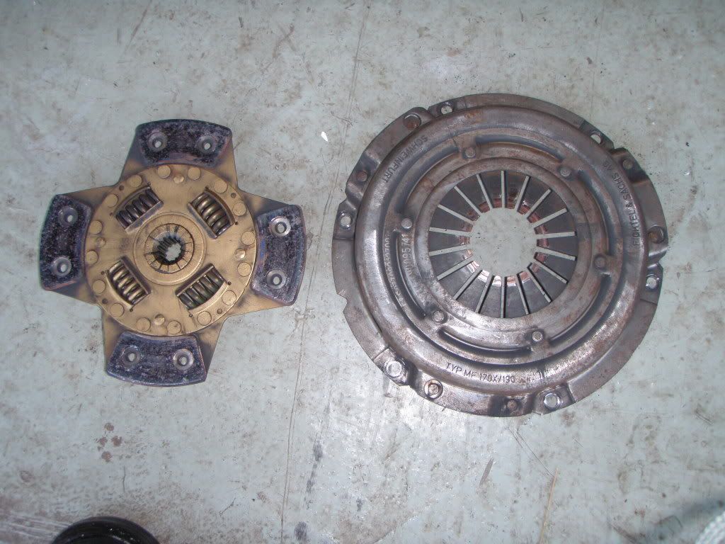

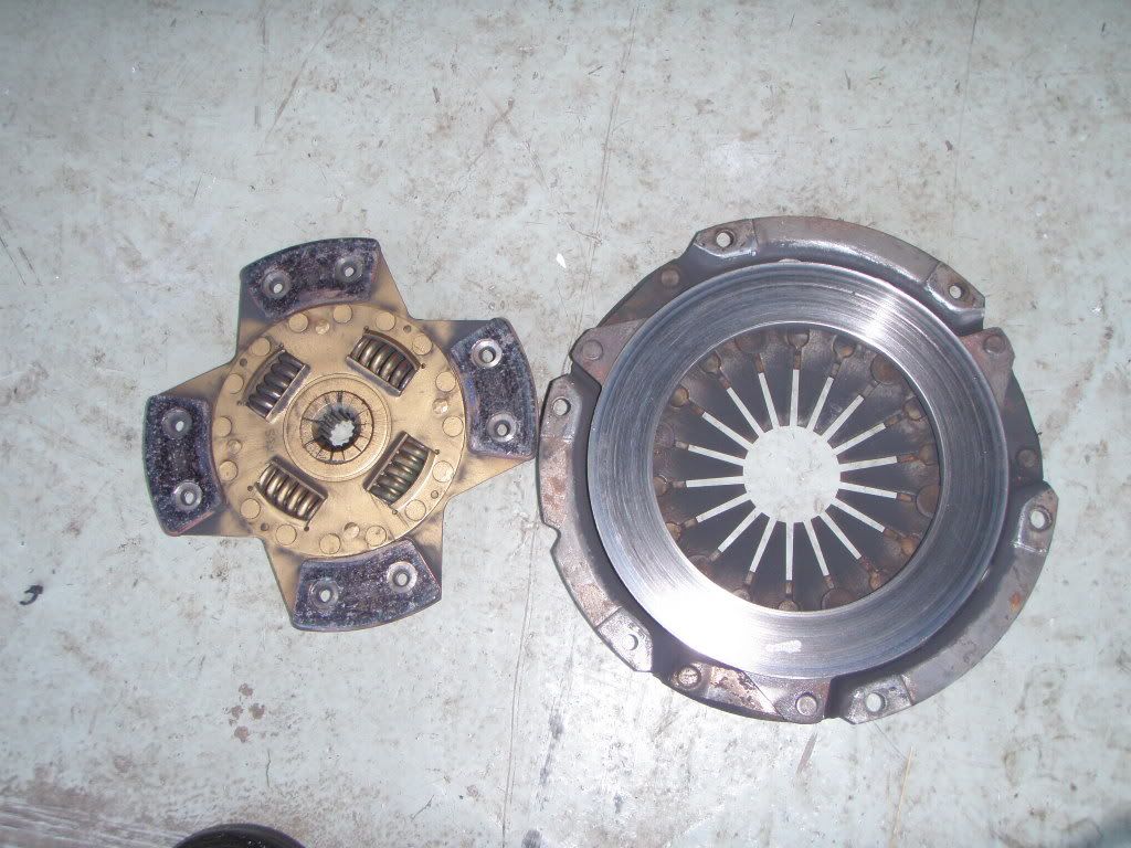

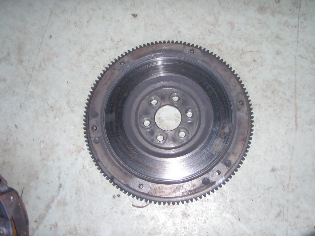

A few photos of the flywheel and clutch which have been in the car for the last 2.5 years of my ownership (and I suspect since the car was built in 1998);
http://i285.photobucket.com/albums/l...ort/002-69.jpg
http://i285.photobucket.com/albums/l...ort/003-72.jpg
http://i285.photobucket.com/albums/l...ort/004-61.jpg
On closer inspection the flywheel is showing signs of excessive heating, and there are a couple of hairline cracks showing, so it's definitely time for a replacement. The clutch plate is breaking up as well.
I'm going to have TTV make me up a billet flywheel, and Superclutch are going to make me a clutch, the only thing I need to decide now is whether to go for a 7.25" or a 5.5" clutch.

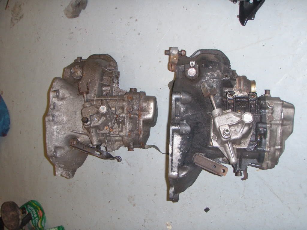

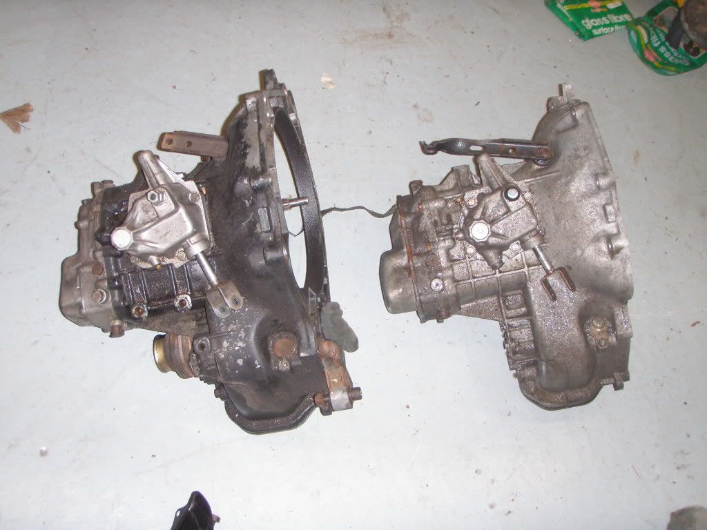

At the moment I have an F10 gearbox, with Quaife straight cut close ratio gear cluster and Quaife ATB. This still used the standard helical type CWP.

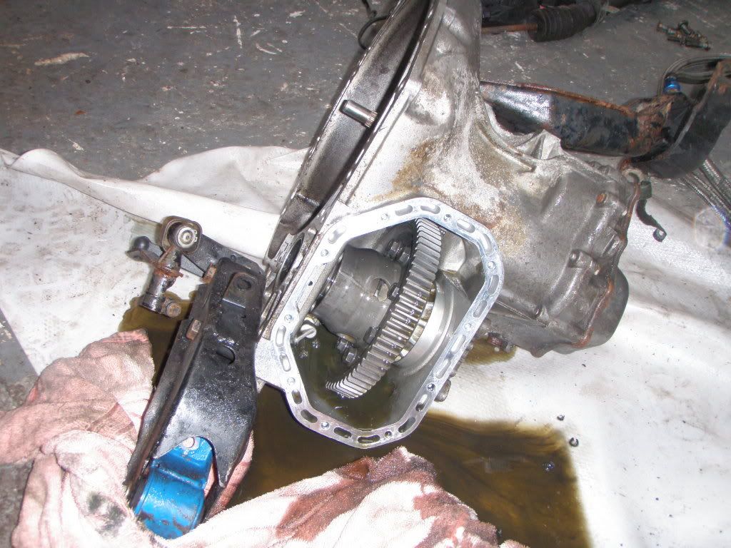

The F10 has always been on the margins of the torque it can handle, although it's survived very well considering. But I've been starting to think that traction could be improved with a plate type LSD instead of the Quaife one.

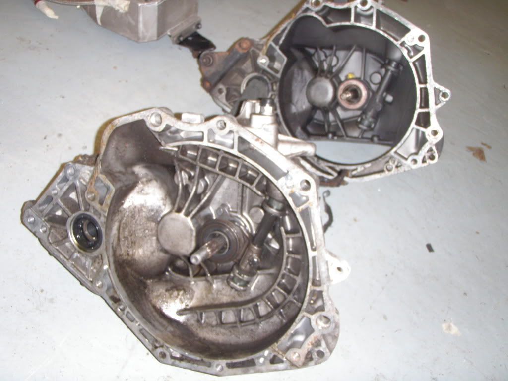

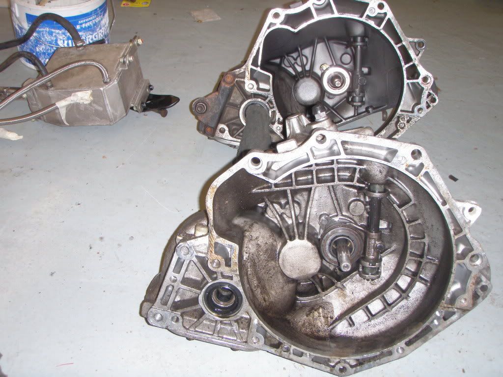

A few weeks back I bought a Corsa rally car, which has an F15 gearbox in it, with the stronger Quaife SCCR gear cluster fitted, and the straight cut final drive. But even better it has a Tran-X LSD in it on 55/90 ramp angles.
So that is going to get fitted ready for the new racing season;
http://i285.photobucket.com/albums/l...ort/005-51.jpg
http://i285.photobucket.com/albums/l...ort/006-54.jpg
http://i285.photobucket.com/albums/l...ort/007-46.jpg
http://i285.photobucket.com/albums/l...ort/008-41.jpg
http://i285.photobucket.com/albums/l...ort/009-40.jpg
I was worried that the F15 would be heavier, but in fact they weigh precisely the same, which is great news. There are some interesting differences between the casings when you compare them............the F10 'box is the one which has been painted black.
shocked they weight the same, most bits look noticeably bigger on the f10
can you lighten the casing at all by drilling holes in the bell housing part or removing webbing etc?
with the amount of power going thru it, i'd say leave the gbox castings well alone.
