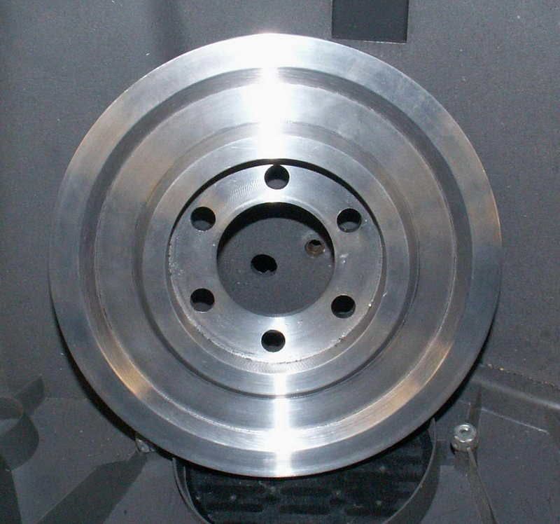

I then contacted a mate who gets his dad to knock up alloy pulleys to make up a set (top and bottom) with a deeper
single V which will hiold the belt a lot better.
Here's the bottom pulley :-
http://i2.photobucket.com/albums/y15...a/pulley1a.jpg
And here's the clearance between the alternator pulley and the chassis leg , close but about right for a nova 16v conversion!
http://i2.photobucket.com/albums/y15...a/pulley2a.jpg

is that the guy off astra mk1 forums joff? making those pulleys
Yep, chap called Graham , lives a couple of villages away from me. Currently rebuilding his C20LET into his Mk1 Astra . He put a couple of rods through the side of his block a while back and is rebuilding his engine to a similar spec to mine!Quote:
Originally Posted by novashed
He was just doing bottom pulleys but I asked him if he could look at top ones and hey presto a week later we're sorted!
