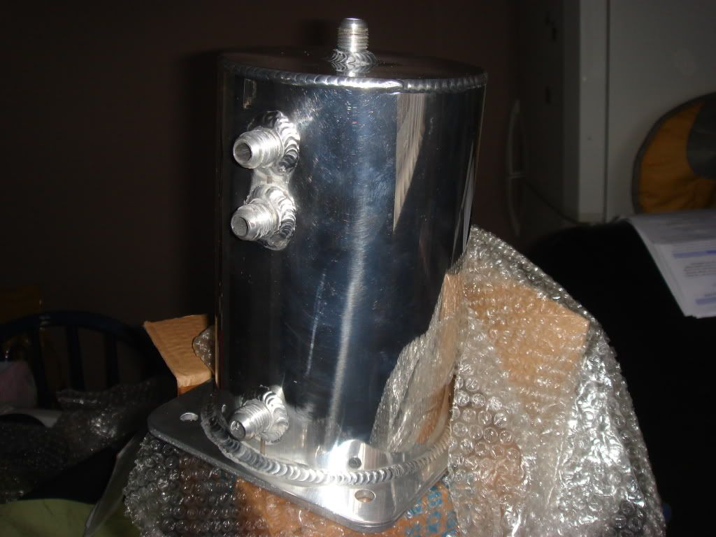

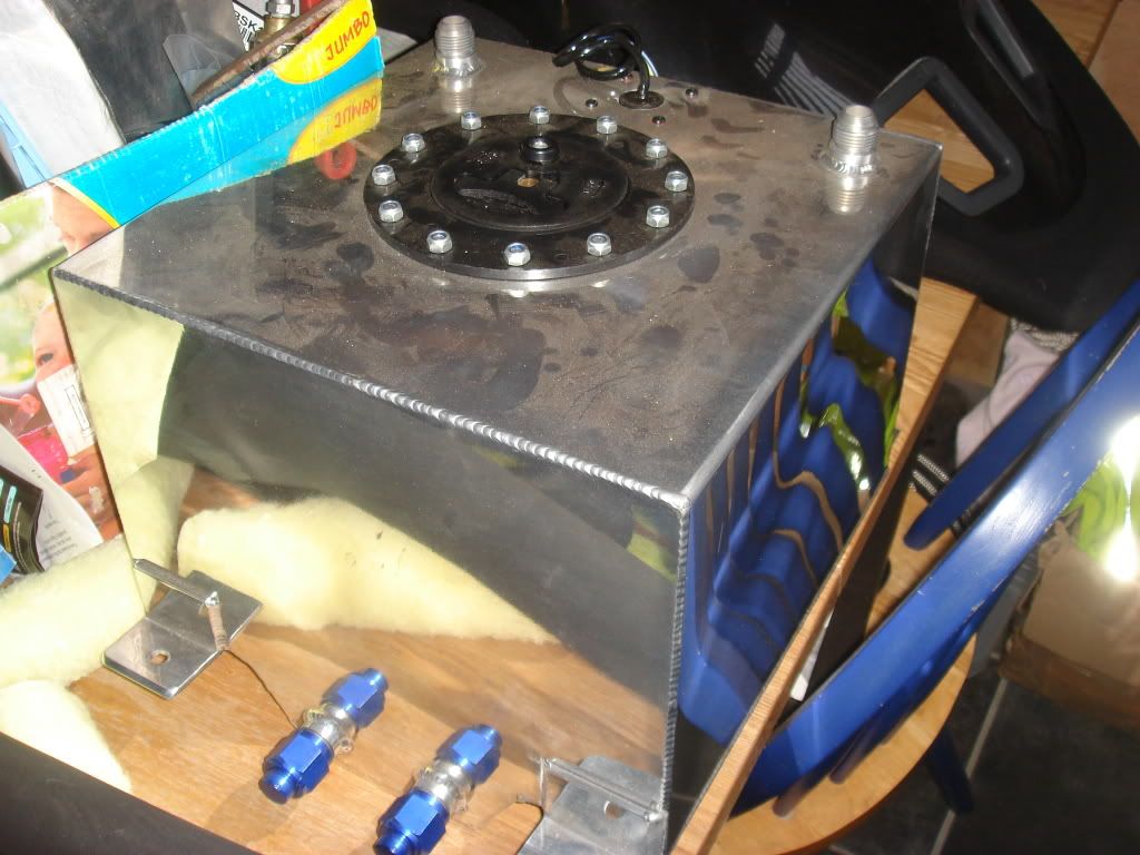

My new tank
http://i761.photobucket.com/albums/x...0/DSC03200.jpg
swirl pot

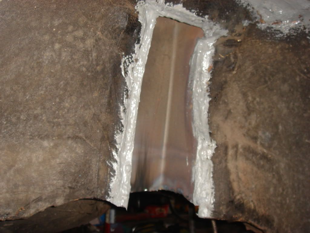

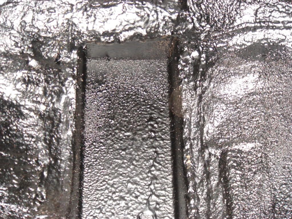

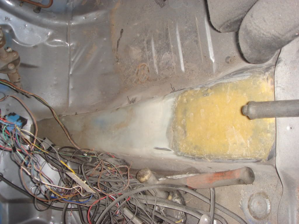

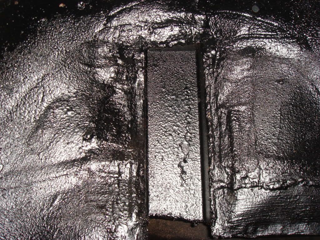

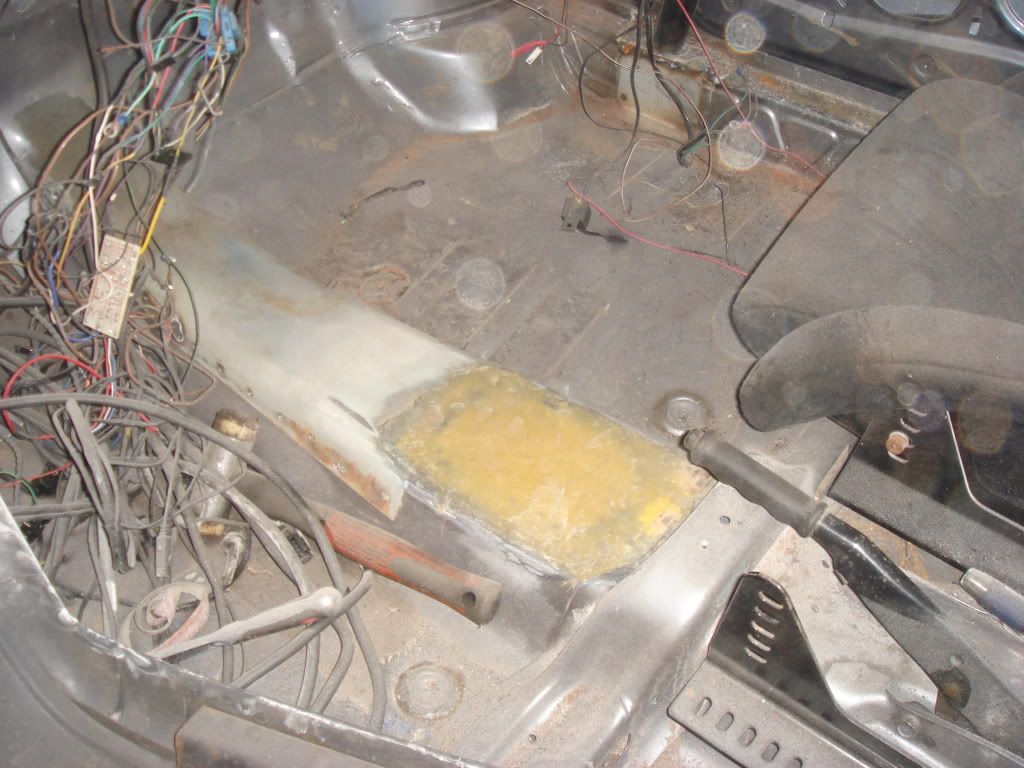

Smoothed the tunnel over for the internal shifter
http://i761.photobucket.com/albums/x...0/DSC03193.jpg
http://i761.photobucket.com/albums/x...0/DSC03194.jpg

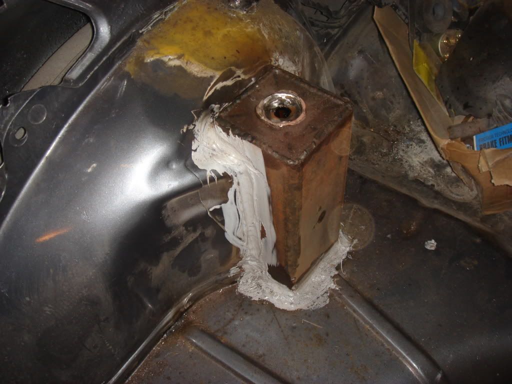

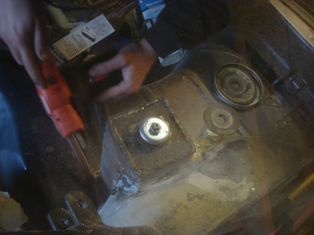

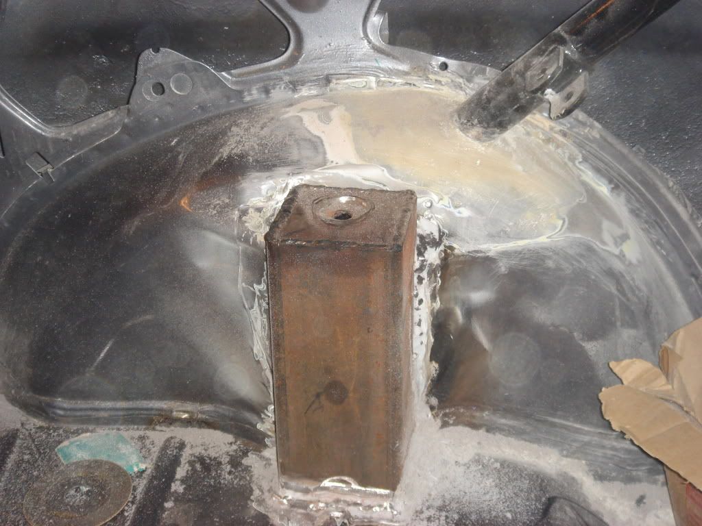

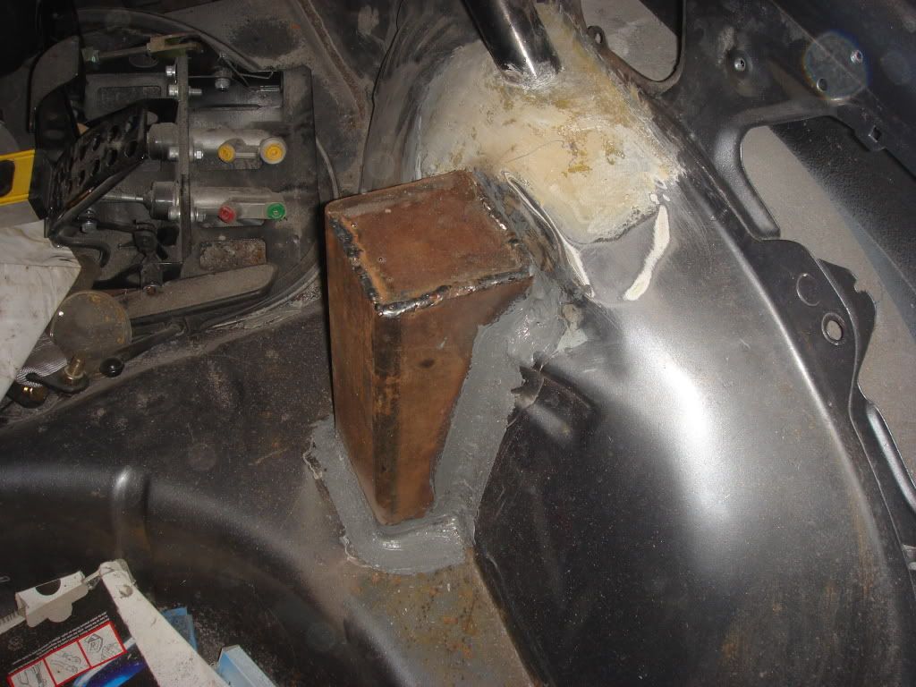

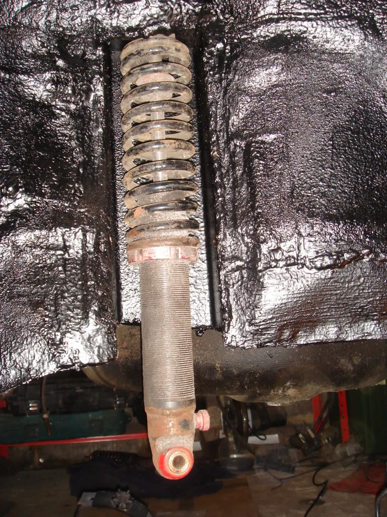

I have also got the turrets just about finished just have to shutz the drivers arch, make the bracket for the axle and job done.
http://i761.photobucket.com/albums/x...0/DSC03184.jpg
http://i761.photobucket.com/albums/x...0/DSC03181.jpg

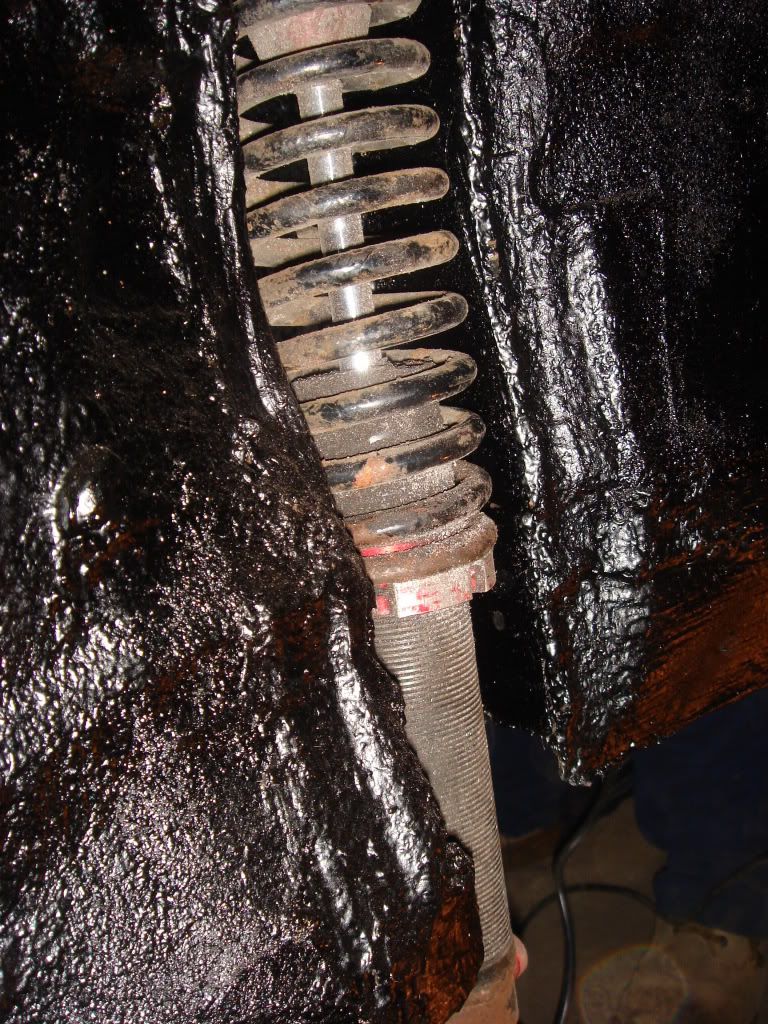

Nice work those turrets look good. Have you tested the angle of the shock when the beam is on at the chosen ride height to make sure they clear?
I havent made the bracket that goes onto the axle yet that will be the next job :thumb:Quote:

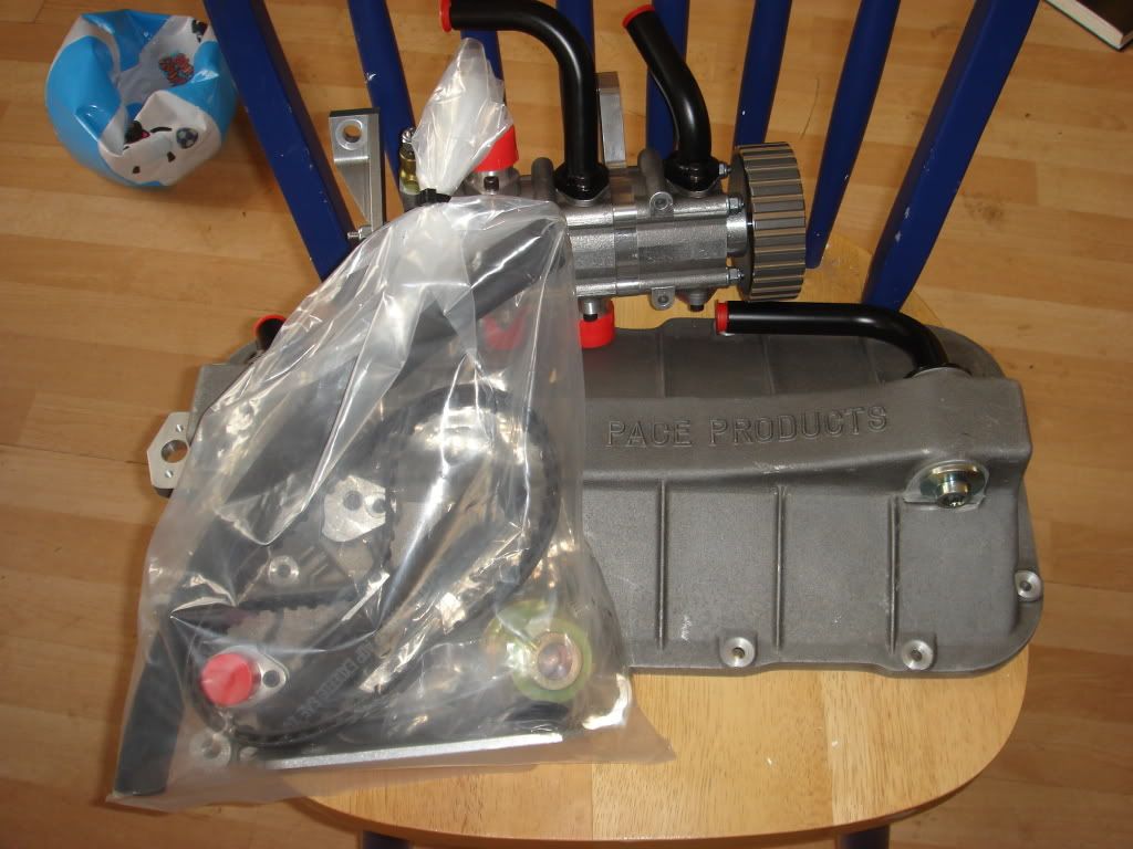

I picked up my new dry sump kit.
http://i761.photobucket.com/albums/x...0/DSC03218.jpg

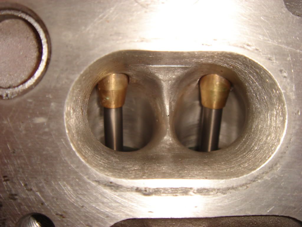

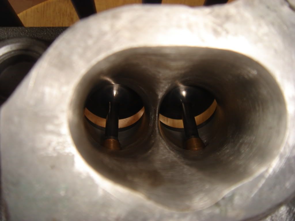

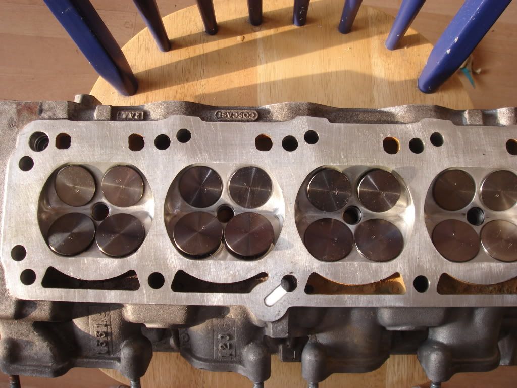

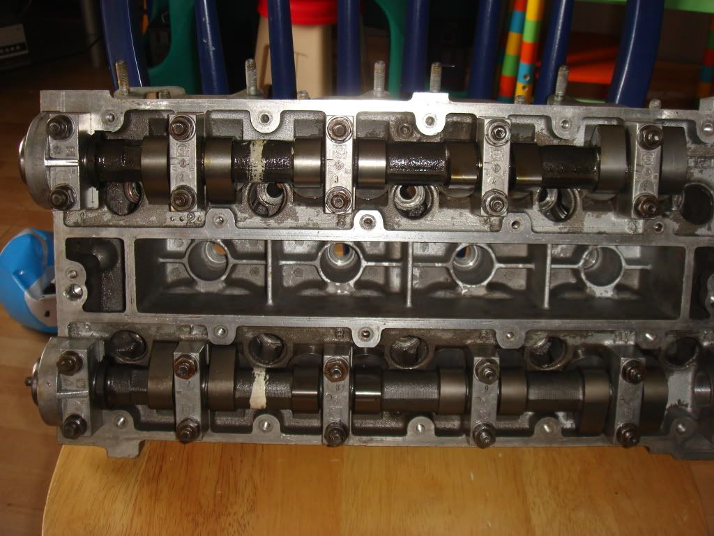

And the new addition to the engine the big valve head. Its got +2mm wasted stem REC valves, colsbro valve guides piper double valve springs solid lifters shimed up to suit the piper cams
http://i761.photobucket.com/albums/x...0/DSC03217.jpg
http://i761.photobucket.com/albums/x...0/DSC03216.jpg
http://i761.photobucket.com/albums/x...0/DSC03214.jpg
http://i761.photobucket.com/albums/x...0/DSC03209.jpg

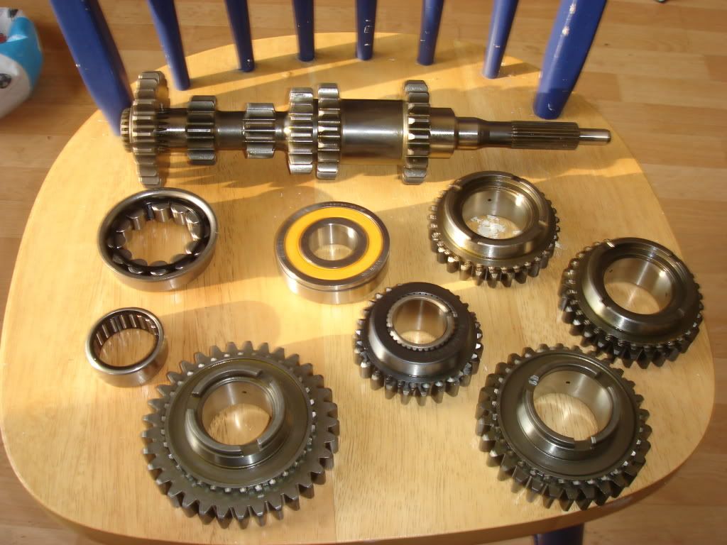

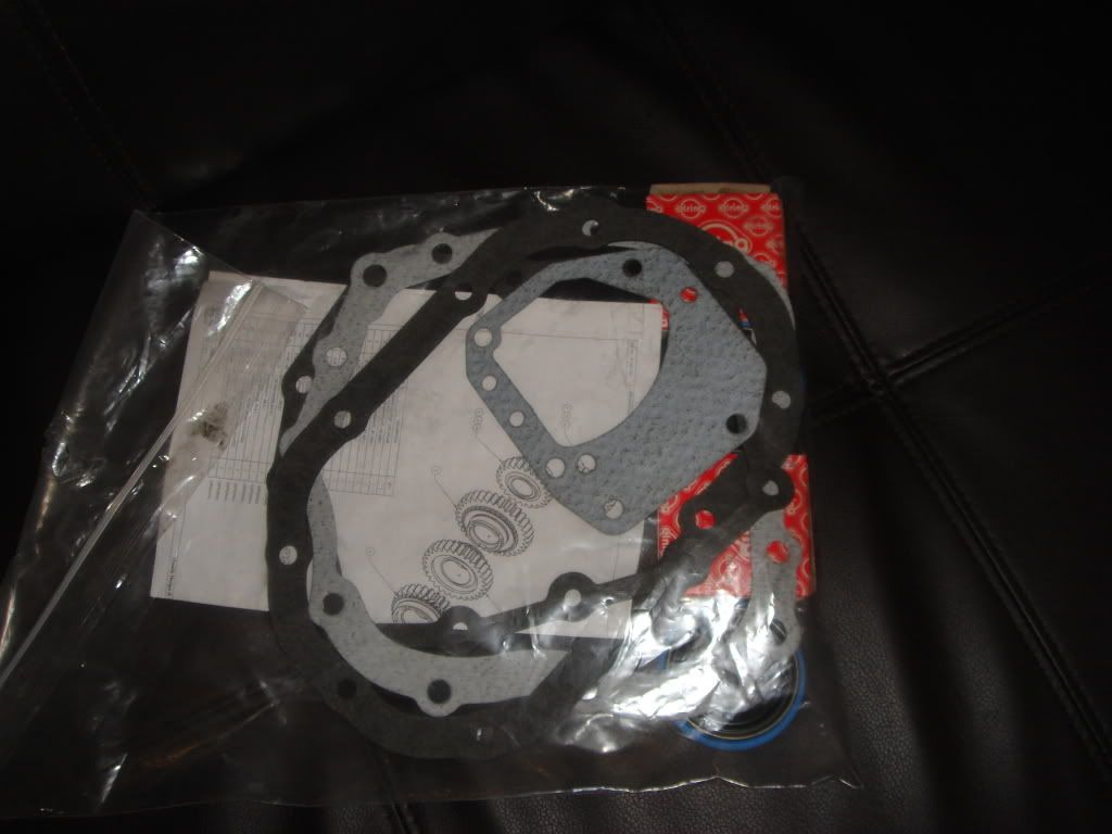

Then it was off to joelms mates to collect the new quaife SCCR gear kit
http://i761.photobucket.com/albums/x...0/DSC03207.jpg
http://i761.photobucket.com/albums/x...0/DSC03219.jpg
