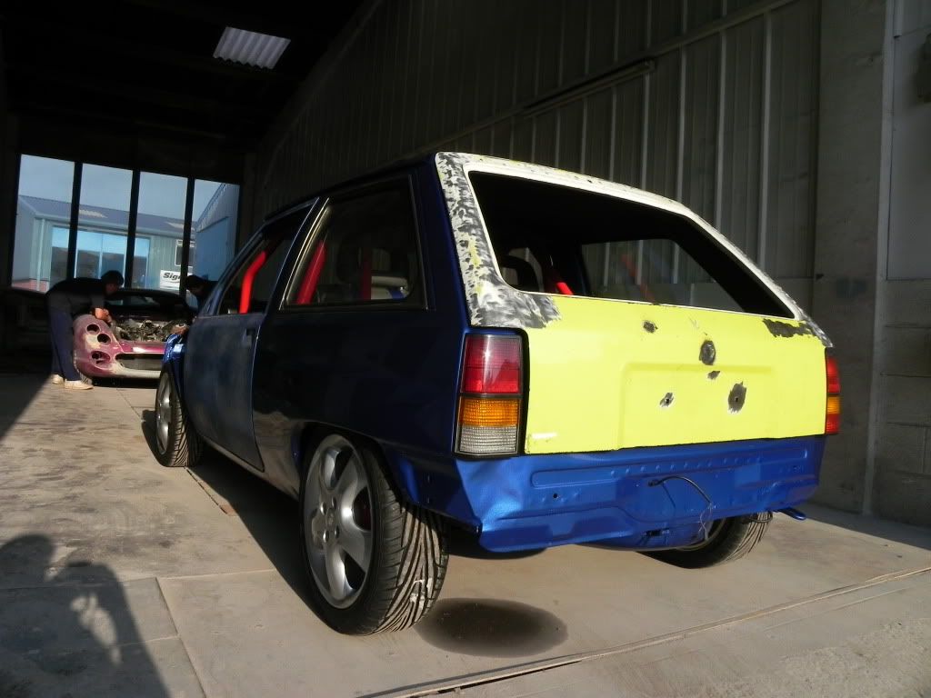

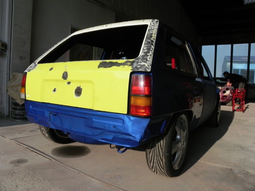

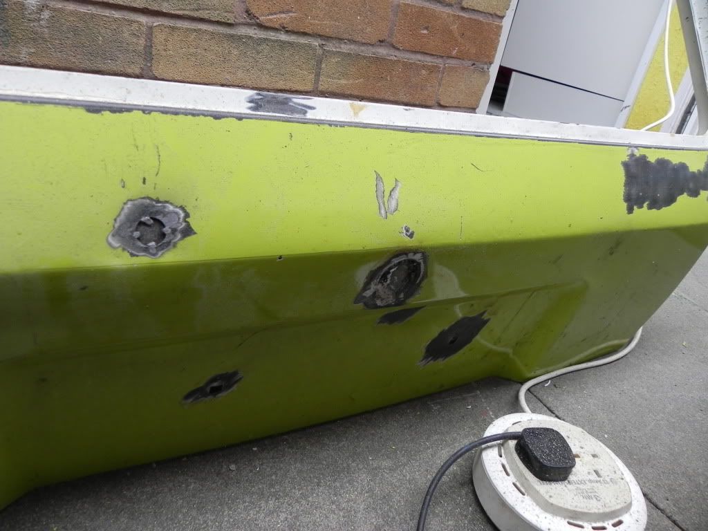

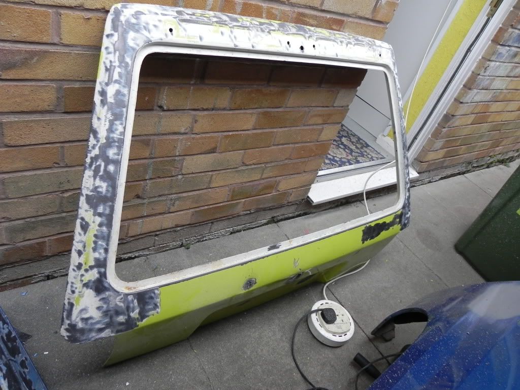

this is going from a couple weeks back now, the deadline to get it to the bodyshop was lurking so i started it clean up some of the panels. the tailgate needed to be welded up and to clean off all the sticky stuff where the old spoiler was attached to it.
http://i193.photobucket.com/albums/z...8/DSCN3730.jpg
http://i193.photobucket.com/albums/z...8/DSCN3731.jpg

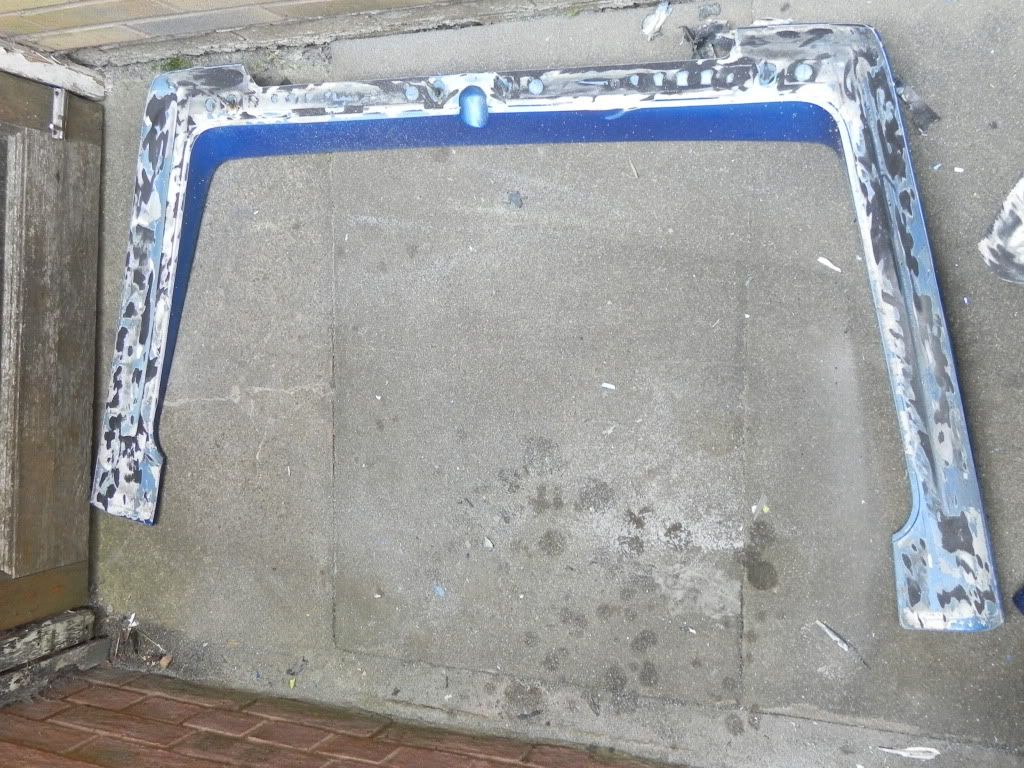

cleaned up the back of the spoiler ready to be stuck down to the tailgate.
http://i193.photobucket.com/albums/z...8/DSCN3729.jpg

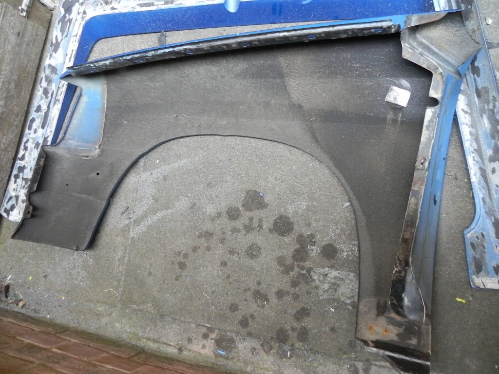

also wire wheeled and jet washed the sealer and dirt from the inside of the wing. the insides being painted so needed to be clean.
http://i193.photobucket.com/albums/z...8/DSCN3732.jpg

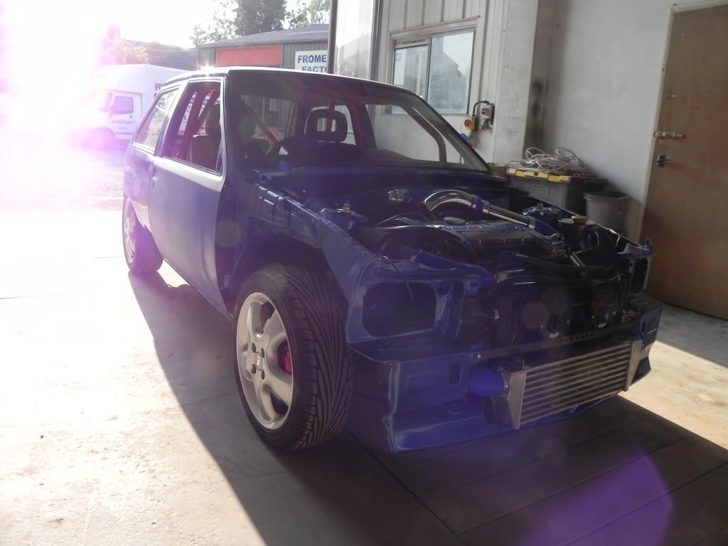

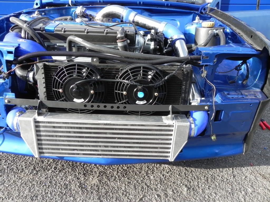

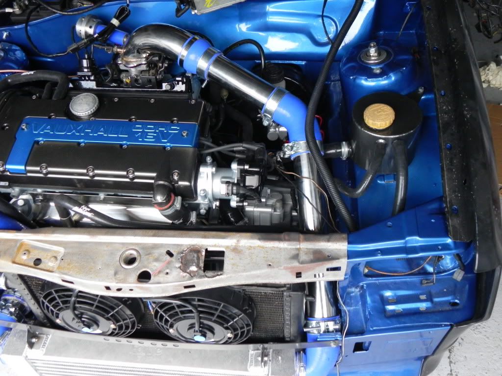

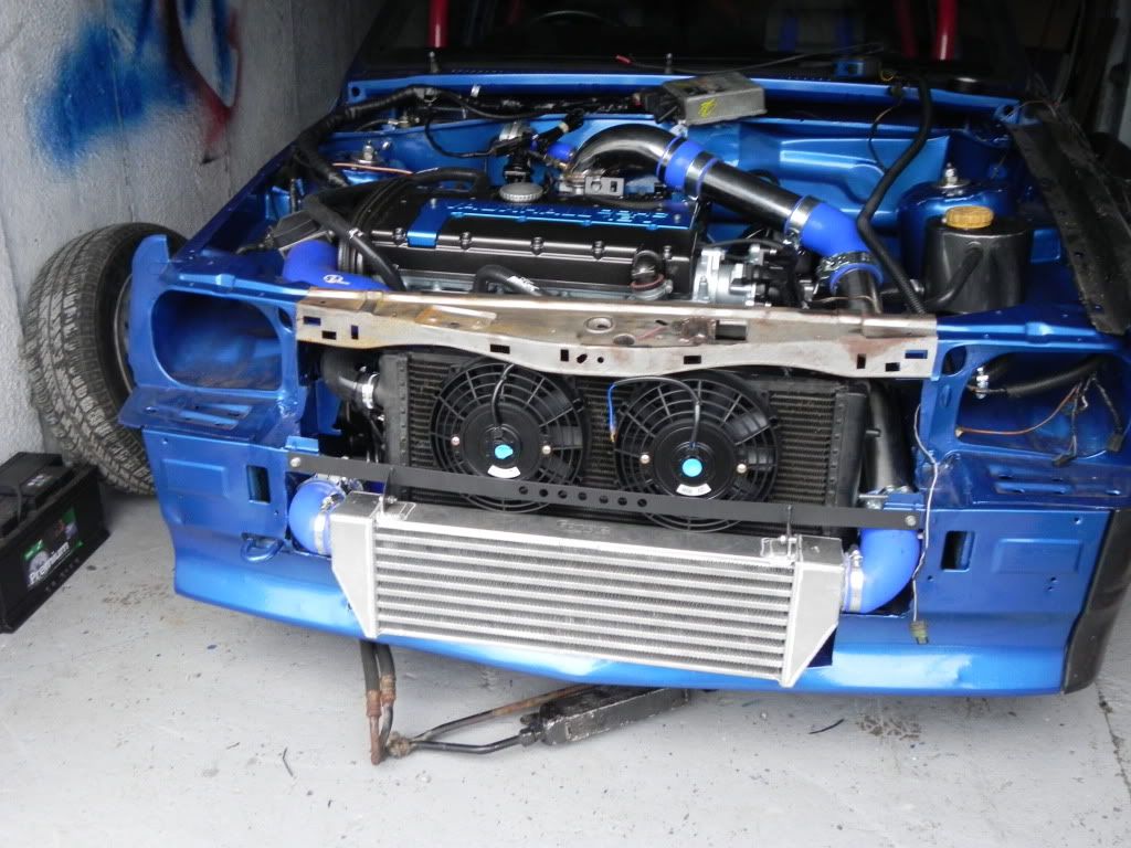

havning both fans i fitted them onto the radiator. the intercooler mounting bracket had to be modified slightlyas it was a bit taught on the fans. both wired up to blow air through the rad.
http://i193.photobucket.com/albums/z...8/DSCN3733.jpg
http://i193.photobucket.com/albums/z...8/DSCN3747.jpg

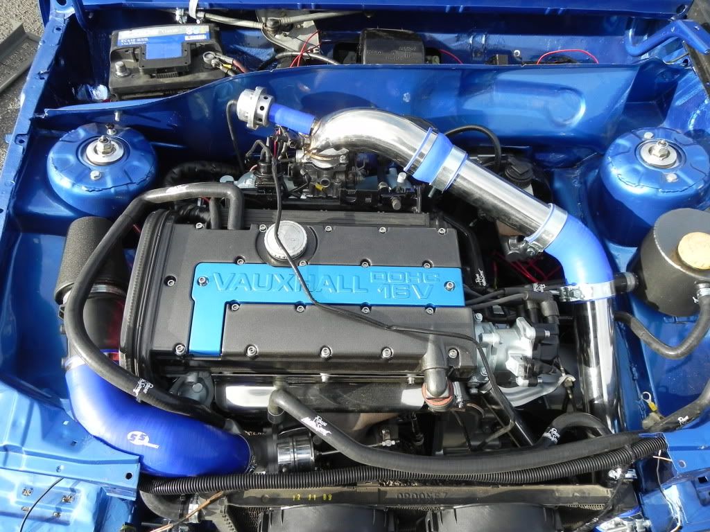

boost pipes finally fitted securely
http://i193.photobucket.com/albums/z...8/DSCN3734.jpg

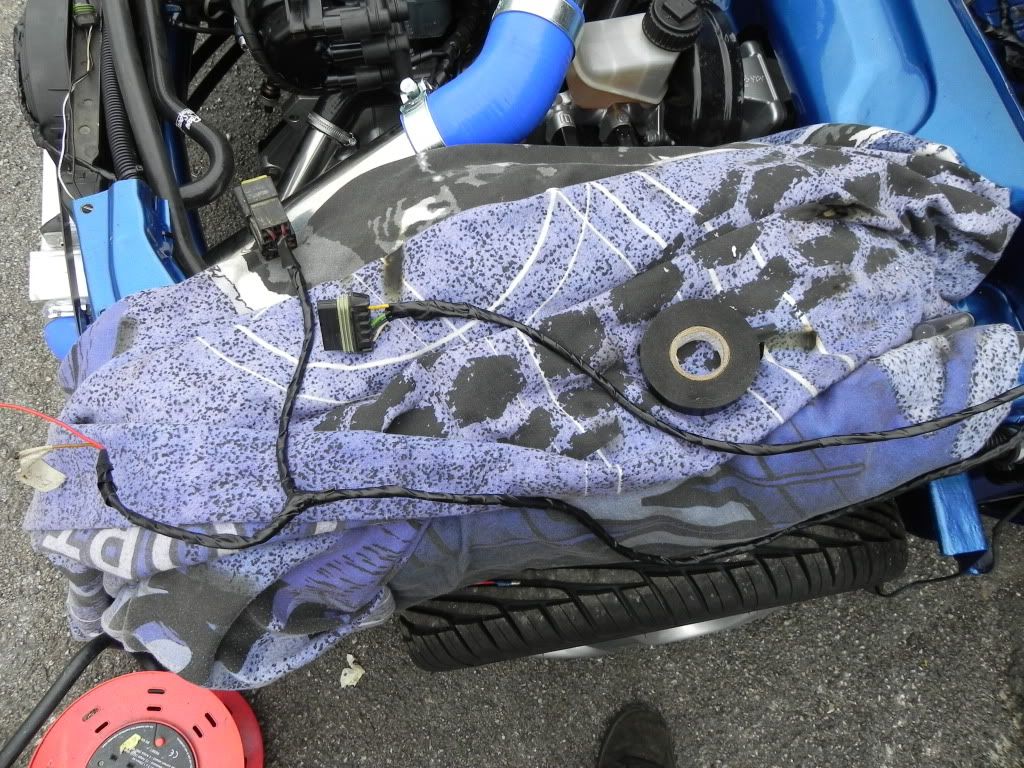

i decided how i wanted to run the engine loom, after seeing how edd had done his i gave it a go. the loom plug is the worst part to get into any hole. using a hole saw i cut 2 holes then elongated it to suit.
http://i193.photobucket.com/albums/z...DSCN3745-1.jpg
its a very tight fit getting all the loom through the hole and to the right of the brake pedal, but after half hour and a broken back later it was in place.

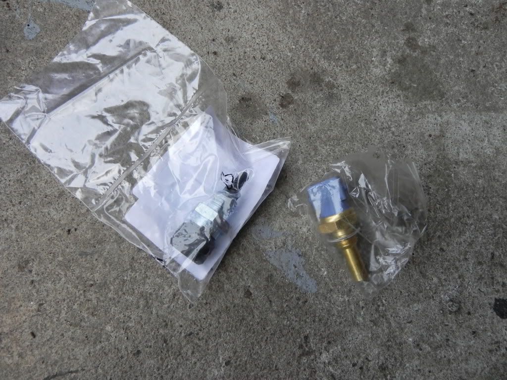

trying to sort out my engine problems i ordered a new pump, coolant and air temp sensor.
http://i193.photobucket.com/albums/z...8/DSCN3761.jpg
http://i193.photobucket.com/albums/z...8/DSCN3760.jpg

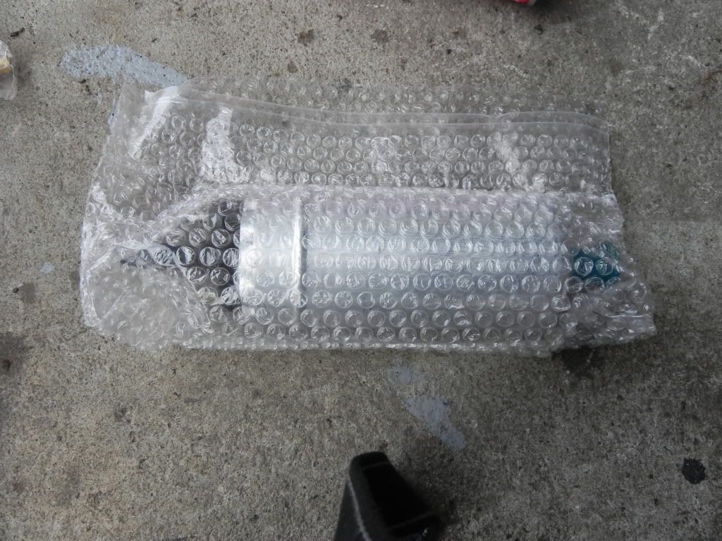

i tested the pump on a battery before i fitted it, the pump didnt work. but i thought id get it on just incase it needed some fuel to help get it going. it was worse than the other pump i had so thats got to go back.
i now have a sytec pump which works off a battery (havnt tested on car yet) and a new fuel rail reg as i mine is still the XE one.

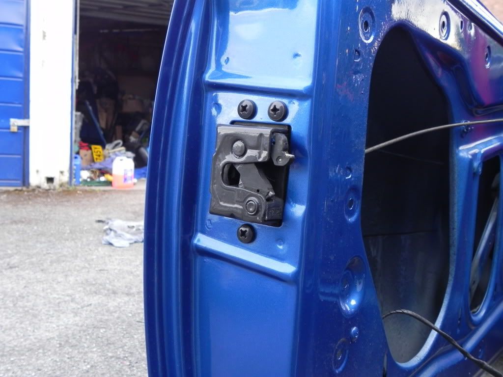

whilst inbetween all that ive painted the door catches in the same grey as the fuel cap, window surrounds and skirts.
http://i193.photobucket.com/albums/z...DSCN3744-1.jpg
