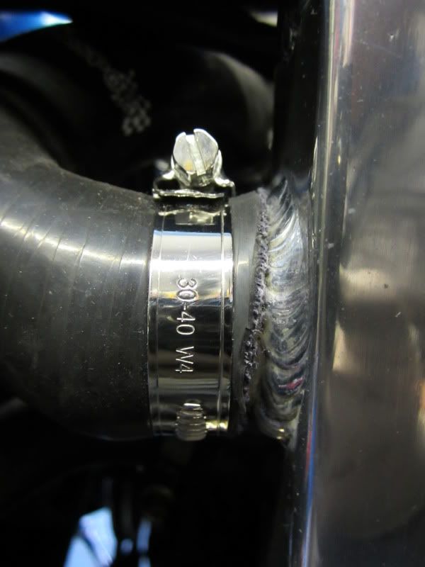

Do you not need to add another ridge to the pipe to help stop it sliding off?
I would be nice, and i will get one added, but for the mo it will do.
So Started Sunday off with a bit of re-polishing... My metal part of the water pipe had become really dull
http://img.photobucket.com/albums/v3...n/IMG_0759.jpg

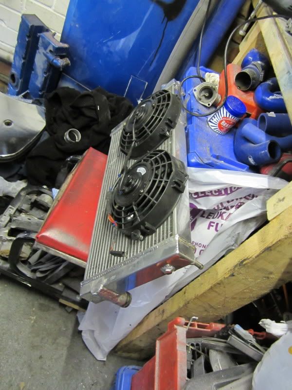

Got my rad out, cleaned up and ready to fit.
http://img.photobucket.com/albums/v3...n/IMG_0760.jpg
Rad fitted, polished jubilee clips fitted (thanks to Old Man Jimbo perfect again.)
http://img.photobucket.com/albums/v3...n/IMG_0763.jpg

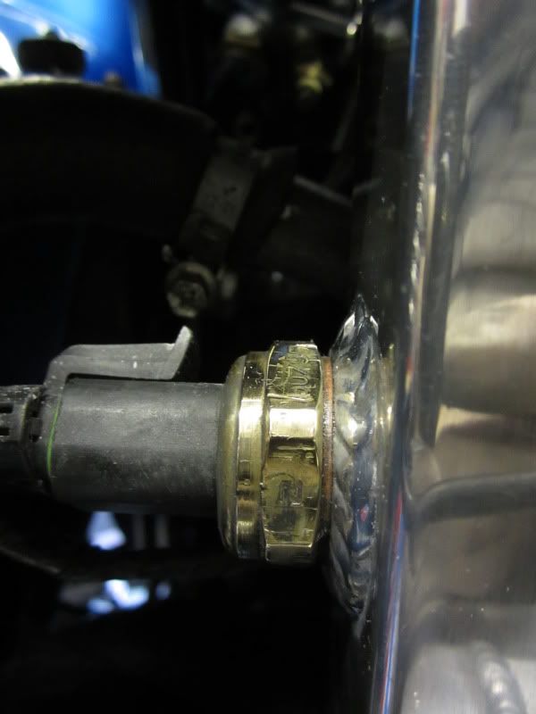

Found the rad switch was leaking, so took it out, cleaned it, polished the brass bit, refitted with some sealant on it.
http://img.photobucket.com/albums/v3...n/IMG_0766.jpg

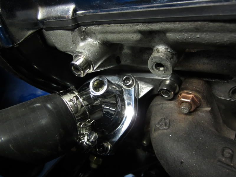

Stat pipe fitted,
http://img.photobucket.com/albums/v3...n/IMG_0768.jpg

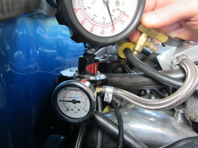

Next was time to start it, decided to start it with the old ecu in, adjust the fuel pressure and then swap to the other ecu. Primed the engine till the oil pressure came up. Then started aafter getting fuel in.
Then stopped as the fuel rail was leaking. Found the end plate was lose. Wouldn't seal. (this one just one i found and used as it was polished) So Dan set to stripping it down so we could swap it to the rail i had on the car before strip down.. All changed over we tried again.
Running, checking fuel pressure... Dan had a nice fuel pressure tester.. So we checked that which is 100% right to my gauge on the fpr.
http://img.photobucket.com/albums/v3...n/IMG_0774.jpg
Happy that's right.... Gauge is bag on. Vid is while running.
