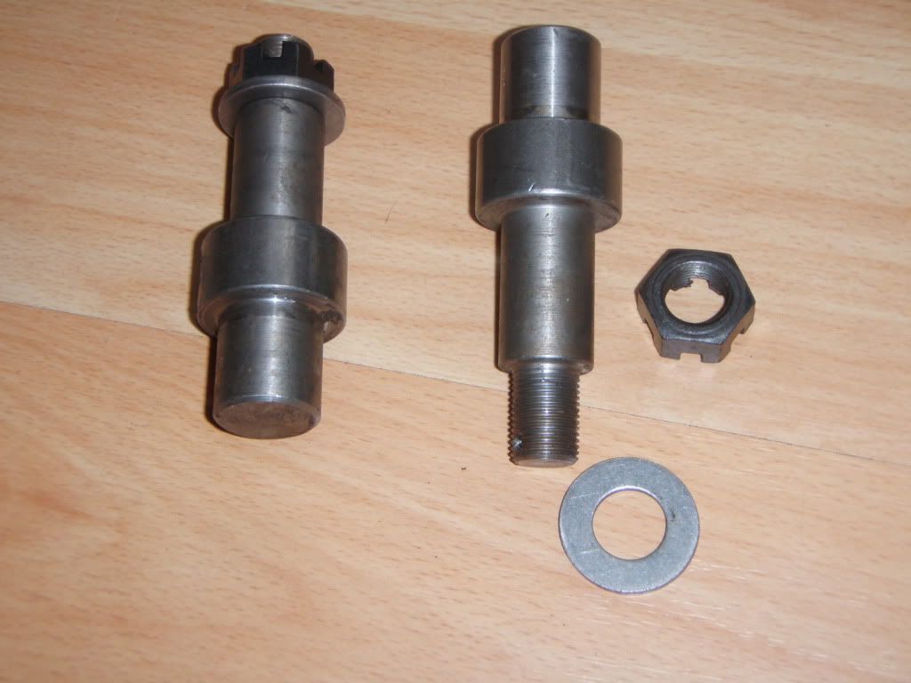

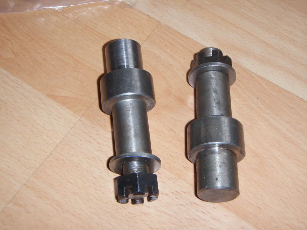

These have just arrived in the post - a pair of 22mm diameter Mini stub axles designed for use on trailers using Mini hubs (bargain buy - thanks to Mowgli for the link!);
http://i285.photobucket.com/albums/l...cort/020-9.jpg
http://i285.photobucket.com/albums/l...cort/021-6.jpg
They are exactly the same length as Nova ones, but having had a try with them, and some measuring, I find that the plan to machine down the Nova stub axles has been thwarted.........the Nova stub starts off at only 16mm diameter (just after the thread ends) and then tapers out to larger.
But it needs to be 22mm all the way from the thread backwards.
So, I'm now thinking that it would be possible to cut the flange part off a Nova stub axle, and weld these Mini trailer stubs onto them.
I'll need to take professional advice as to whether welded will be strong enough, but I'm sure that a weld properly done would be as strong as a solid piece of metal. That will also avoid the problem of having to get it hardened, as presumably these stub axles I've bought are already done.
The only other alternative is to completely machine new stubs from scratch.............but that will no doubt be a more expensive route.
Any expert thoughts are of course welcome.

colin, re the welding.. as long as you get someone to make them good & straight, the joint could be no worse than whats already on a nova rear beam.. or get a sleeve machined so you can still bolt it to the 4 holes, and weld the mini stub inside it
