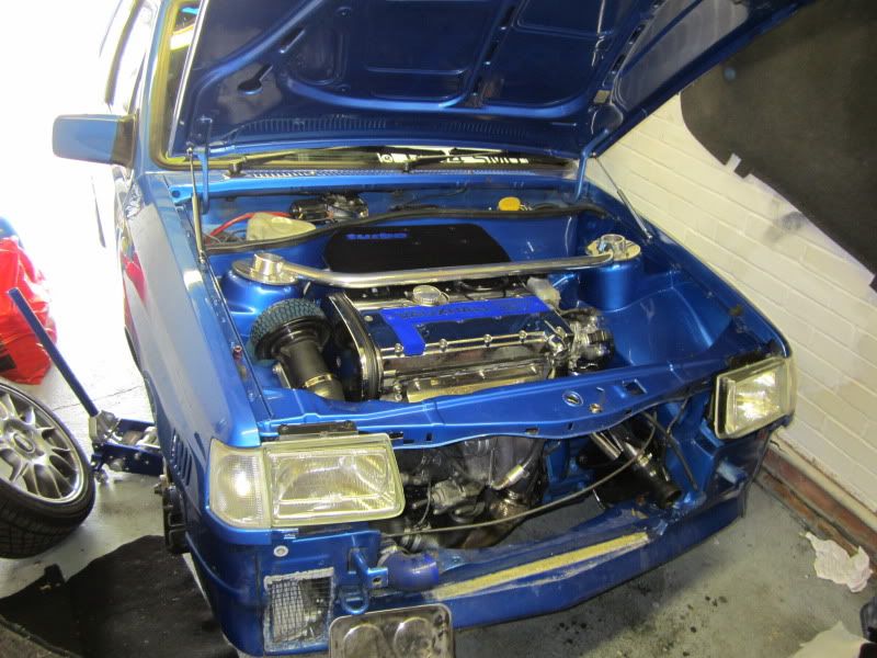

Front coming apart...
http://img.photobucket.com/albums/v3...tripdown29.jpg
Nice collection building up behind the ic..lol

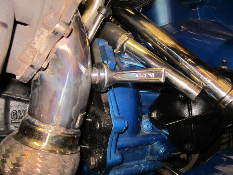

Made this after seeing Gareth at WCC using one.. Very handy when the rads in..
http://img.photobucket.com/albums/v3...stripdown6.jpg
This are a **** to get out...
http://img.photobucket.com/albums/v3...stripdown7.jpg
Remember kids, set jubliee clips up so you can still undo them when under the car/every things in the car.
http://img.photobucket.com/albums/v3...stripdown8.jpg

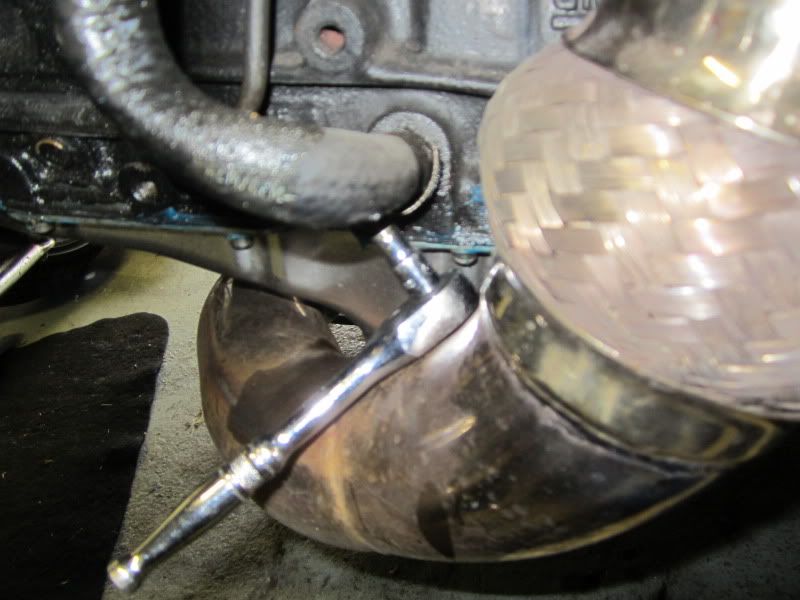

Turbo off.
http://img.photobucket.com/albums/v3...tripdown11.jpg
This is the breather that goes to the turbo inlet, which has water in it, is this normal from condensation?
http://img.photobucket.com/albums/v3...stripdown9.jpg
Which means i get a build up here in the re-circe(sp?)
http://img.photobucket.com/albums/v3...tripdown15.jpg
Surely not a good thing....?
Now the exhaust side looks ok... No oil or anything, Which i thought there would be as i get smoke on idle..
http://img.photobucket.com/albums/v3...tripdown13.jpg
Turbo outlet.. A bit oily but not to bad... For the amount of oil i get in the pipes...
http://img.photobucket.com/albums/v3...tripdown23.jpg

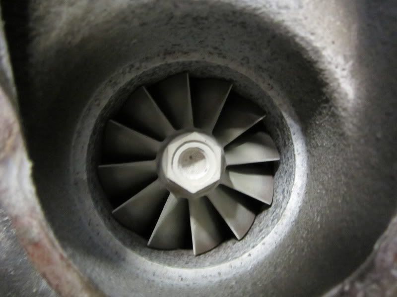

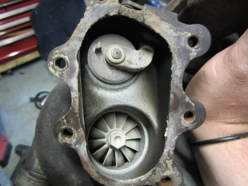

Hhhmm something been in there?
http://img.photobucket.com/albums/v3...tripdown16.jpg
Damage on the impellers..
http://img.photobucket.com/albums/v3...tripdown17.jpg
But it drove fine, made boost fine...
Exhaust side, all clean, just whiteish soot.
http://img.photobucket.com/albums/v3...tripdown20.jpg
http://img.photobucket.com/albums/v3...tripdown21.jpg
Left it there, ready to strip the pump off....
